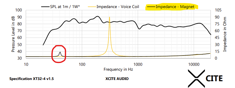

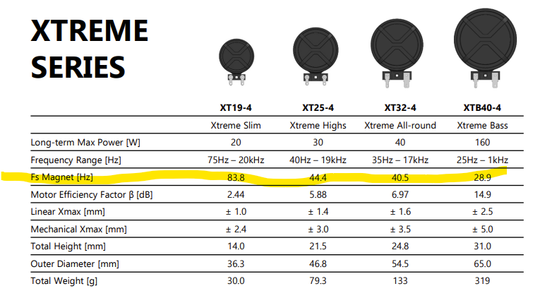

A bit more feedback : (what a pandora's box you've opened!!)
1/ On the FR angle response, there's a small circle tailing me around but not near the cursor ??

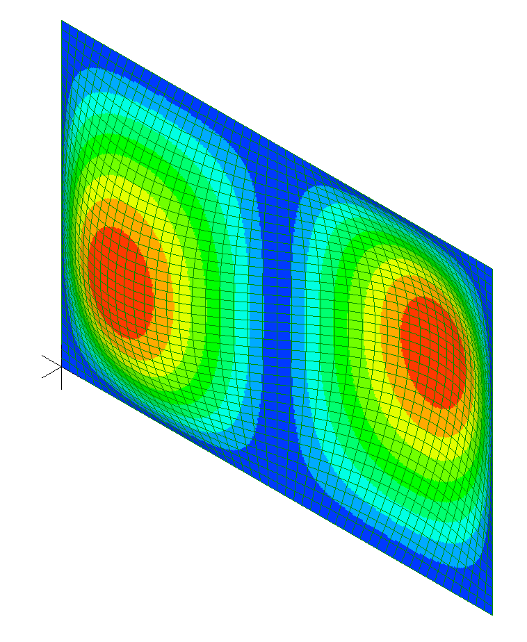

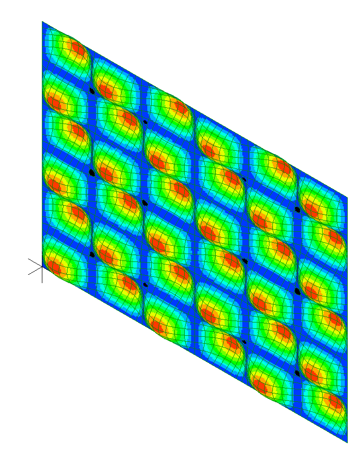

Steve,When exciters are close, this does not necessarily mean that they are in phase throughout their frequency response.
They can be inphase, out of phase or anywhere in-between these two phases.
This puzzled me at first.
But if you think of the stationery exciter as being inphase with the panel at its position and the other exciter bouncing around out of phase at its position on the panel.
The reason this seems unlikely to me is because exciters bounce like that is only when they are driven at very low frequencies, close to their "magnet" fs. At least, that is my experience. For the larger exciters (20W+) that frequency is usually under 50 Hz, though for smaller exciters it's usually a little higher, like maybe 100 Hz.
But at such low frequencies, the modal shapes of the panel typically look something like the first image below. That is, the antinodal areas are quite large. So in order for the two exciters to be at locations that are out of phase with each other, the exciters would have to be pretty far apart. If they are close together, they are either at locations that are in-phase, or are at locations that don't have much displacement, like say on either side of the blue centerline.
At higher frequencies, the modal shapes look more like the second image. At such frequencies the issue you describe is far more likely (inevitable maybe), as the antinodal regions are much smaller. Hence the out of phase regions are much closer, and two closely placed exciters could indeed be at location of different phase. However, such frequencies typically are far above the exciter magnet resonance, so would not be likely to cause an exciter to bounce like that.

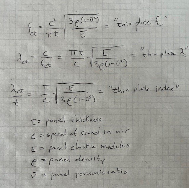

@EarthTonesElectronics
Dave,
Concerning the challenge for the model when the plates are very thin, and the number of modes starts to explode, would it be possible to use "infinite plate mobility theory" to speed up the calculation without too much loss of accuracy? I will readily admit I'm out of my depth here, but I thought I would mention it in case it's useful.
I guess the idea would be to use the modal model at low frequencies, but when the number of activated modes becomes sufficiently high, you would switch to using infinite plate mobility to model the response.

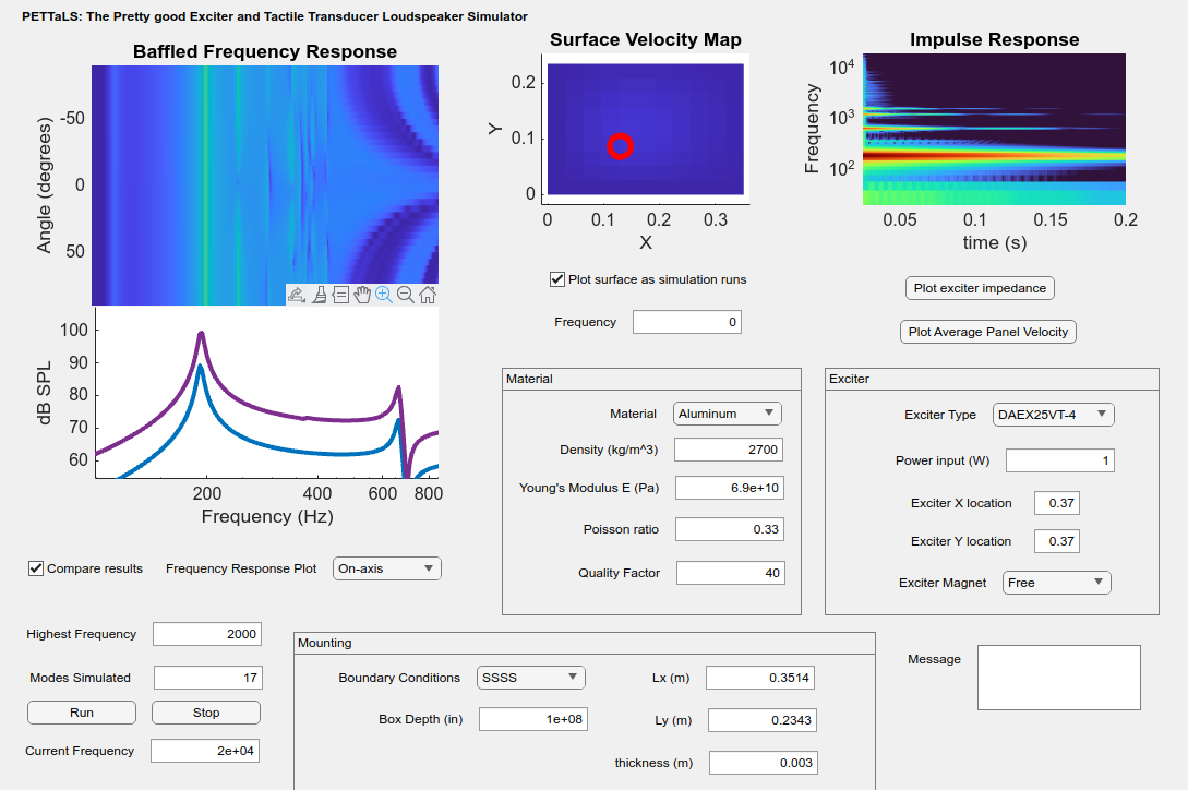

Hello Dave,
One question about your simulator...
Below is a panel, in blue force driven, in pink with a DAEX25.
In my mind, to drive the panel with a force is a bit like driven it with a current source. When it is an exciter it is voltage driven, with a voltage to get the power specified (supposing to use a kind of normalized impedance?)
From that, I expected to see higher resonance peak with a force. In a voltage driven exciter, the back emf gives a better control of the panel.
Am I wrong somewhere? Probably...
Christian

Christian,What does that mean in words of coincidence frequency? I mean, if the coincidence frequency becomes then very high, it might not be a use case as then the speed of the waves in the plate would be (too?) slow? It happened my panels were too thin, they don't work.
Christian
Sorry, I'm not certain what you are asking, or even if you are asking me, or more likely Dave?
What I was referring to was the fact that if the plate is very thin (or even very low modulus, or very high density, or some combination) then the number of modes between 20 Hz and 20 kHz is much larger than for a thicker plate. Since the model presumably works by summing the contributions of all the modes, it may run very slowly when there are so many modes with contributions to add up. So my question had only to do with the way the model operates on such a panel, not regarding what the actual performance of that panel would be.
But I too have wondered if the panel can be too thin. For example, what happens when the panel is so thin that the panel wave speed at even 20 kHz is far below the speed of sound in air? I suspect (as I assume you are also thinking), that the radiation efficiency would be poor in that case. But is that correct?
Eric
Yes, for sure, I've already got this on my list of things to work on eventually (but time is finite, unfortunately). Large sandwich plates would take way too long to simulate without crossing over to a non-modal set of equations at some point.@EarthTonesElectronics

Good point - the "point force" nowadays is more of a "point" than a "force." It's got the same electrical model as the exciters, but just without any resonance and without any coupling shape. It'll be interesting to add the pure force (or current source) in and see how it compares.@EarthTonesElectronics

Hello Dave,Good point - the "point force" nowadays is more of a "point" than a "force." It's got the same electrical model as the exciters, but just without any resonance and without any coupling shape. It'll be interesting to add the pure force (or current source) in and see how it compares.
Clear. I understand it is a king of "ideal point force exciter". So it supposes you have chosen an electrical resistance and a force factor for it? No inductance?
Eric
I see your point.
From my paper about panel materials, I see : A.f0.fc = c²
fo being the first mode
fc the coincidence frequency
c the speed of sound in the air
A is more or less the panel area depending on the edge conditions
The thickness is somehow resulting or let say the parameter to adjust fc and A the parameter to adjust f0..and the simulation time will follow.

The bouncing of the exciter is a resonance effect that takes at least a few cycles to build up, so any transient is irrelevant to this effect, I feel certain.Where is the pistonic (pulse) action and the PIP.
These pictures are too simplistic.
Showing only dml standing waves.
For all practical purposes, the only direction that the panel deflects is perpendicular to the plane of the surface. Deflections of the panel in any other direction are smaller by orders of magnitude.The panel will be flexing in all directions.
I'm not sure what you thought I meant by "magnet resonance". But what I was calling "magnet resonance" is what Xcite refers to as "Fs Magnet" in their specs. That refers to is the frequency at which there is a peak in the impedance measurement (when the impedance test is performed by attaching the exciter foot to a rigid body without constraining the magnet). In the curve at the bottom, I circled in red the peak at 40.5 Hz corresponding to the Fs-Magnet of that exciter. Fs-magnet for any exciter reflects the frequency at which the exciter tends to really bounce, and corresponds essentially to the resonance frequency of the magnet mass combined with the spring constant of the spider. In fact, it is the bouncing of the exciter at this resonance which causes the spike in the impedance curve, by creating "back EMF".You make it sound like the exciter is suffering from magnet resonance,
I do think that the properties of the panel itself can slightly shift the frequency at which an exciter will bounce, but other than that, it is not the panel's motion that causes the exciter to bounce. What makes an exciter bounce is simply driving it at a frequency close to its Fs-Magnet.

Dave,Thanks for the great feedback everyone! I've recompiled with a few changes added in, and you should be able to re-download easily from the Google Drive link if you want to:
- A stop button to kill execution if the simulation is taking too long.
- On that same note, a field that shows you how many modes you're simulating based on the frequency and panel setup. Once this gets above 1000 modes, the simulation starts to slow down big time.
- The surface velocity appears for each simulated frequency as the simulation runs. It's fun to look at. This slows down the simulation, so I also added a checkbox to turn it off.
- each line in the frequency response comparison is a new color.
I finally had time today to load the new version and I'm having great fun with it. I really do love the "real time" surface velocity map. It is mesmerizing to watch and so far I don't mind that it takes longer to run! It would be nice if the frequency "counter" was closer to the velocity map, like above or below it, or even overlaid on top, so you could more easily see what is happening at each frequency.
I have the same comment as Eucy about the frequency limit setting. It's annoying when you set it to a value and then it reverts back to 2000 Hz. Once you change it during a session I think it should stay fixed until you change it again manually.
It's running more reliably for me than the earlier version too it seems. But sometimes there are still odd delays, like when I request an impedance plot. Sometimes it comes up immediately, and other times it takes like 20 seconds. There is also sometimes a delayed reaction to the run command as well by 10 or 20 seconds, and other times it starts immediately. A few times I ended up pressing "run" a second time because it seemed like nothing was happening, then pressed the "stop" (for some reason), and then saw it immediately start up again, as if it was actually running twice simultaneously because I had hit "run" twice.
I'm not sure what we should expect to be able to do with the graphs that show up on the "normal" screen. With the "auxiliary" plots like the impedance plot, the zoom and pan etc functions seem to work mostly, but they never work for me on the SPL plots.
I do wonder if some of my issues are more related to my crappy old computer than to your software.

Eucy,2/ The dropdowns work on the FR angle graph but the 3d etc don't work on the velocity map and when you pick the 3d button, it won't change back to pan ? (edit - after clicking on the dropdowns in the angle freq graph, I can no longer interrogate it with the mouse - no box appears)
What is the "3d" you are talking about? I don't know if it works for me because I don't know what it is!
I agree it would be nice to have realistic Q factors for materials built into Dave's the model. But I'm not sure it's a huge hurdle if we don't. I say that because the height and sharpness of the peaks in the impedance curve are extremely sensitive to Q factor. So the key for us modelers is to have an impedance rig of our own. Then we can get a pretty good idea of the Q of any particular material my comparing an actual measured impedance curve to the result of Dave's model, and just iterate the model with different values of Q until the height and sharpness of the impedance peaks are similar in the model and measurement. I don't think it's too critical to be "exact" with the Q value, you just need to be in the ballpark I think. As Dave has noted previously, Q isn't really even a constant for real materials, so there is no exact value anyway.4/ The Q factor is of high importance to practical material selection and it would be good to get some more data on realistic figures for often used materials like plywood (however, the damping will of course be significantly affected/modified by chosen surface treatments - a matter discussed at depth in this forum)
This does mean we need at least a sample panel of the material in question, and REW with an impedance rig, however.
