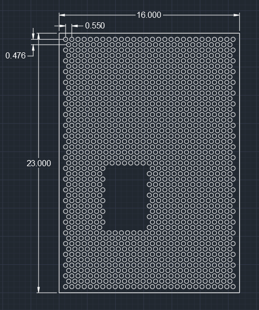

Thanks a lot for your valuable feedback and suggestions. I will ask a friend for help, testing the panel / taking measurements. Initially the plan was to use 3.2mm thick plywood for this panel since I can get larger sheets (24"x36"). Thinner plywood (2mm or 1.58mm) I can get only in smaller sheets sizes (12"x36"max.) If you feel that 2mm might be already a bit to thick, I could go for 1.58mm instead, but in that case I would need to downscale my panel size to 490x300mm if I want to keep the same proportions and take the max out of that plywood sheet. What do you think? Should I stay with my initial plan or would you downscale and go for the thinner ply? Since I haven't got any experience in building DML's, I will gratefully follow your advise. shidoThe first words that come to me are : "Whaou! Audacious".
My main advice would be : proceed by steps. If you can, test the panel in open back conditions to evaluate the properties of your composite. If you have the possibility, a directivity measurement is a great tool to evaluate the coincidence frequency and the panel self damping. From them depends how the response of axis is . My (current!) opinion is to have the coincidence frequency as high as possible, if possible out of the audio range. A 2mm plywood is a bit to thick for that. There is a risk with a light and stiff composite to have the coincidence frequency too low. I am not able to predict something about the damping...
With the back side load, the response in the mids might change. Maybe some EQ will be needed.
Keep us informed

This sounds like a neat idea. I like your honeycomb composite panel idea. I considered doing something similar at one time but never actually did it. I found this drawing I made (in January 2020), which looks similar to yours! I can't recall for sure but I think my idea at the time was to use wood veneer for the face, rather than fiberglass, but the concept is the same.
I do agree with Christian and Steve with respect to the basic idea of testing some prototypes before going all-in on a particular design. Start with a single panel in a crude frame and see how that sounds, and then proceed from there.
I also agree with Christian concerning his "coincidence frequency" comments, but to be honest I would not concern myself too much about that if I were you. It is what I consider a second or third order effect, to be concerned about after you have sorted out more basic things like frequency response and efficiency, Maybe worry about that on your tenth design!
Concerning the composite panel itself: Have you made fiberglass composites before? In your description, you refer to "adhering" the fiberglass fabric with PU. What is not clear is if you understand that in order to work properly the fiberglass fabric itself has to be completely saturated with resin (PU or epoxy). I have only experience with epoxy resins, but I understand that there are PU resins that are also made for this. If you are not familiar with composites, there are great videos here:
https://www.easycomposites.co.uk/learning
Also, I would suggest making the the honeycomb openings as small as possible. It looks to me like yours are about 15 mm wide. I fear that is too long a distance to span with a thin fiberglass skin. When the fiberglass is on the compression side of a bending wave, it may buckle, and not provide the stiffening that you want. The openings in aramid honeycombs for composites are typically on the order of 5 mm. You may want to get as close to that as is practical.
Concerning the mounting of your panel to the frame, I would suggest that you plan to try many different configurations, rather than simply planning to mount at the two corners you have chosen. I think more mounting points will work better, and likely the best is attaching the panel to the frame around the entire perimeter using a soft foam or double sided mounting tape. The main benefit of attaching the panel around the entire perimeter is an increase in SPL at lower frequencies. I have done many test which show this, including these two:

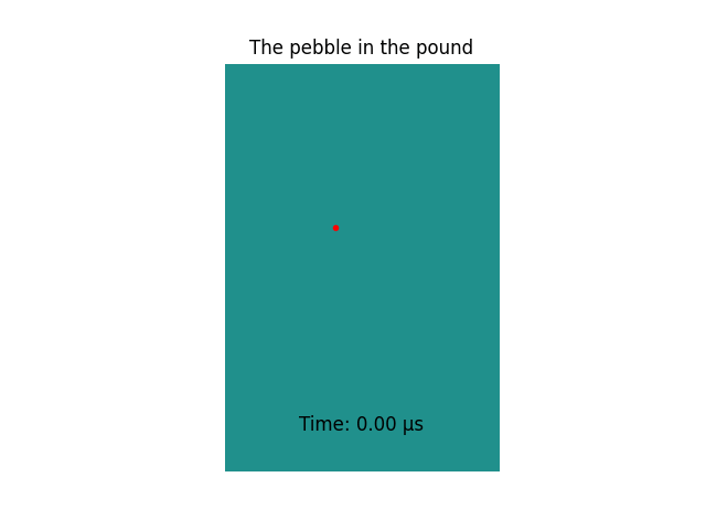

The pebble in the pound...
I had under the dust of my hard drive a Python script written beginning of last year to simulate the transient of a plate under an impulse... The exciter is at 2/5 of a rectangular plate simply supported. The test case is not very realistic as there is no damping, the exciter is a point, the panel is force driven (it is not an exciter driven by a voltage)... but it is encouraging. See it as a curiosity.
It is an animated gif file. It seems accepted as format. Maybe need to be downloaded? The exciter is at the red dot.

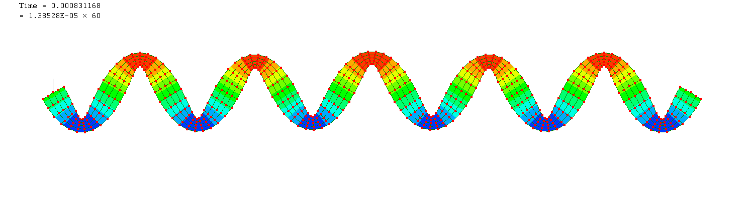

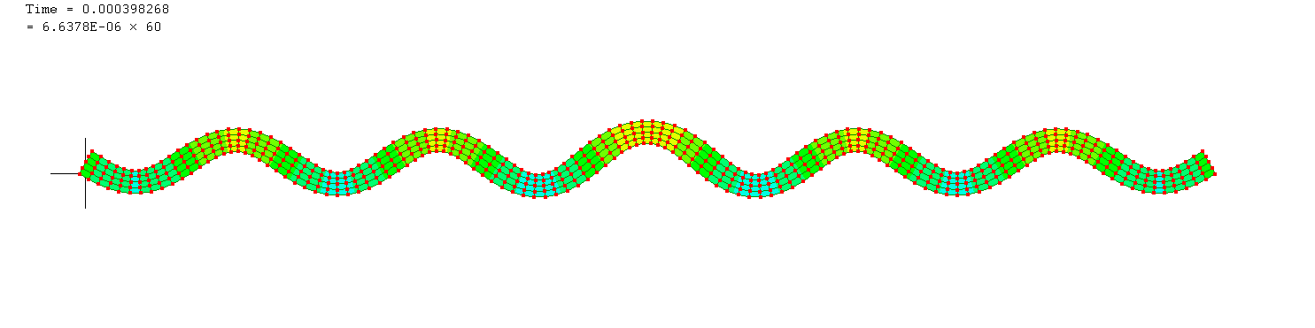

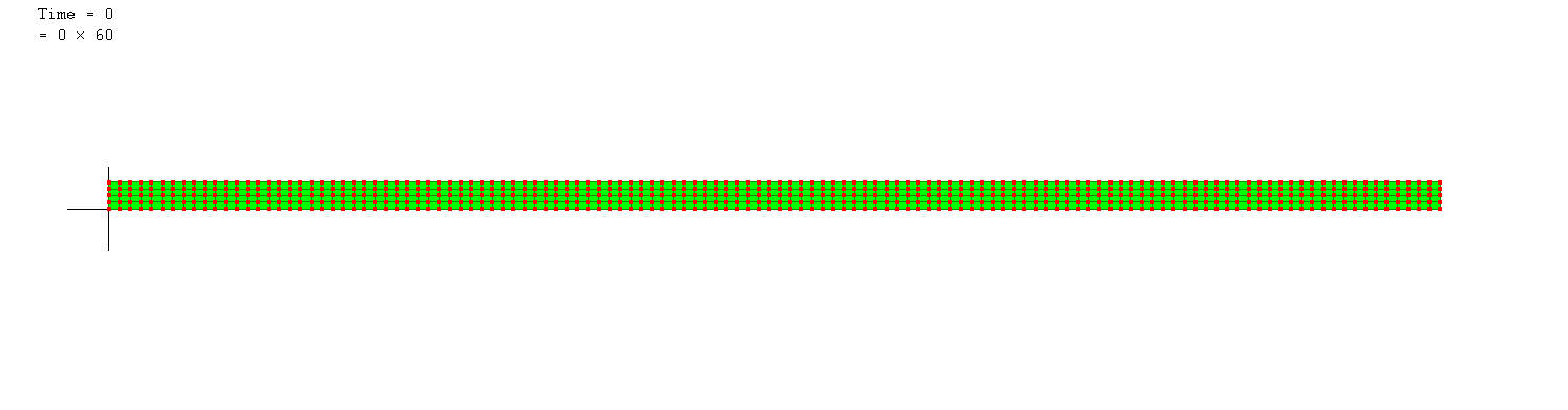

Christian,I had under the dust of my hard drive a Python script written beginning of last year to simulate the transient of a plate under an impulse... The exciter is at 2/5 of a rectangular plate simply supported. The test case is not very realistic as there is no damping, the exciter is a point, the panel is force driven (it is not an exciter driven by a voltage)... but it is encouraging. See it as a curiosity.
That is very cool! I did some modeling of the transient earlier this year using the "dynamic response" mode of LISA. Also without damping. But I was only able to do a beam model. A plate required too many elements and the model couldn't handle it. Also, I never figured out a way to share the ouput.
What was the nature of your impulse? Could you drive it with a sinusoidal force?
What I did with my beam model was to drive it with a sinusoidal point force at various frequencies and driving points. It was neat to see how the behavior differed when the driving force was at a natural frequency and when it was not. It would be a good test of your model to drive it at some of the natural frequencies calculated by theory (or model) and see if the theroetical modal shapes start to develop. Also, it would be interesting to see how long it really takes to go from PIP to modal.
Eric
It is a very short half sinus (50µs). My idea is to input something as close as possible of a very short pulse (Dirac?) in order to get an impulse response and then use an FFT.What was the nature of your impulse?
Seems possible as the driven force is described over the time. It is an iterative simulation based on time. A variant of the finite difference method we shared some months (more than one year!) ago with Paul.Could you drive it with a sinusoidal force?

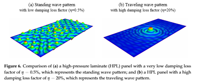

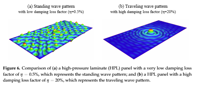

Thank you for posting these two pictures.You describe them as if the there is a sequence in time in which the PIP happens first, then DML. And that is correct in a way, but I'm not sure if it's meaningful way. That is, if you imagine that there is no signal to the exciter, and then instantaneously a signal to the exciter, then yes there is a short period of time when there is PIP response of the panel, and which lasts approximately until the first reflections from the panel perimeter make it back to the exciter, after which it arguably becomes "DML action". That time period will vary somewhat depending on the panel material, its size, and the frequency of the signal, but generally it's likely to be well under 10 ms. As an example, I estimated that for one of my cf/balsa panels at 500 Hz, the time period would be about 2 ms. Is that period long enough for our auditory system to perceive it? I don't know, but I'm skeptical that it is.
Also, the signal to the exciter doesn't actually start suddenly from silence. Except at the start of any track, there is always some earlier signal to the exciter, and hence, residual DML action, in the panel. So while it may take 10ms (or 2ms) for the DML action to catch up to the signal at the exciter, at any arbitrary instant the panel already has residual DML action which is the result of the previous exciter signal. And if the damping is low, those reverberations can easily last 100 or even 200ms or more after the original signal. So I would say that there is always "DML action", it's just a question of how far back in time it comes from.
My view is that the transition from DML action to PIP action is not so much one that happens as a function of time, but rather happens as a function of frequency. That is, at low enough frequencies, where the panel velocity profile looks like the top two images in the figure below (from one of Dave's publications), the panel behavior is "DML", while at higher frequencies, where the panel displacement becomes localized around the exciter, (see lower right image at 10k), that panel's behavior is PIP. Of course, at intermediate frequencies (like 2k below) it is a combination of both.
I don't really think that is possible. My understanding is basically that increasing damping mainly acts to shift the transition from DML behavior to PIP behavior to lower frequencies. This is shown in the image from Zenker, which compares the behavior of a panel with low vs. high damping values. With low damping, the behavior is "standing wave" (i.e. DML), while with high damping the behavior at the same frequency is "traveling wave" (i.e. PIP).
So I don't really think you can get "large quantities" of PIP without also having high damping.
Eric
They clearly show dml action on the left picture, but on the right the dml action has been damped or killed by the damping.
You can clearly see the pistonic pulse in the centre of the exciter area, then the waves moving out from this.
But even the waves are being damped by the damping.
By doing this, You have created a bending wave panel with pistonic action in its central excitation area.
Not a dml panel, which has to have all three , to operate properly without constraints( if using an exciter).
How much of pistonic, bending wave, and dml is produced by the panel can vary depending on the panel material .
A light bending panel will produce a larger pulse in the cone area than a very heavy rigid wood panel
So when I say I like to have large quantities of all three, I mean ideally a light flexible panel without damping.
Steve.
That's what I was assuming. Great work.It is an iterative simulation based on time. A variant of the finite difference method we shared some months (more than one year!) ago with Paul.
Christian, I seriously think this could be a really valuable tool for visualization of the panel motions, including transients. Of course it's easy for me to say (since you have to do the work!) but if you can solve the equations without damping, you can add damping without too much trouble, right? You are already solving the equation below using the first two terms, if you can do that, adding the "b" term is pretty trivial, isn't it? (Not for me, but for you!).
I think it would be very interesting and informative to see what several cycles (say 10?) at various frequencies across the audible range would look like in your simulation, especially if you could include damping.
I did that with my LISA beam dynamic model, and it was pretty interesting, but very limited because I could only do a beam, not a plate, and could not include damping. I'll share some output from that model in a second post, if I am able to figure out how.
I'd love to see you do more with that transient model. Of course, modeling how the plate moves is only half of the full simulation, but half is still a lot.

The first action on a panel using an exciter is the pistonic action not the PIP.You describe them as if the there is a sequence in time in which the PIP happens first, then DML. And that is correct in a way, but I'm not sure if it's meaningful way. That is, if you imagine that there is no signal to the exciter, and then instantaneously a signal to the exciter, then yes there is a short period of time when there is PIP response of the panel, and which lasts approximately until the first reflections from the panel perimeter make it back to the exciter, after which it arguably becomes "DML action". That time period will vary somewhat depending on the panel material, its size, and the frequency of the signal, but generally it's likely to be well under 10 ms. As an example, I estimated that for one of my cf/balsa panels at 500 Hz, the time period would be about 2 ms. Is that period long enough for our auditory system to perceive it? I don't know, but I'm skeptical that it is.
Eric
Without the pistonic action and the PIP, there can not be any dml action.
So the PIP is very important, crucial even, no matter how miniscule the time window.
Are you saying that the next note on a musical instrument will not be hear because the panel is already vibrating.
We already know this is not the case.
Steve.

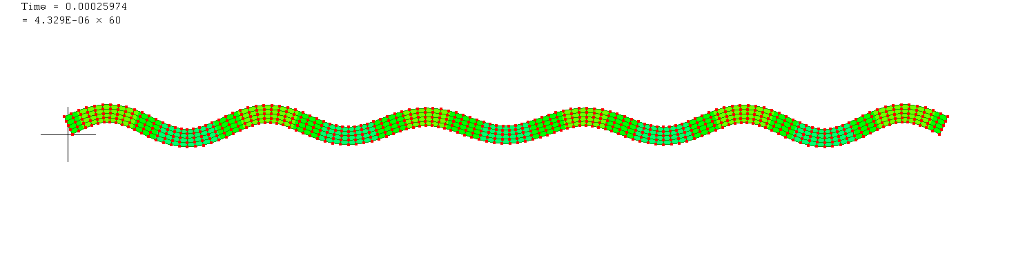

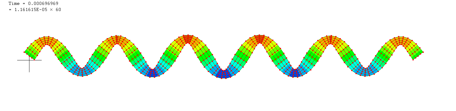

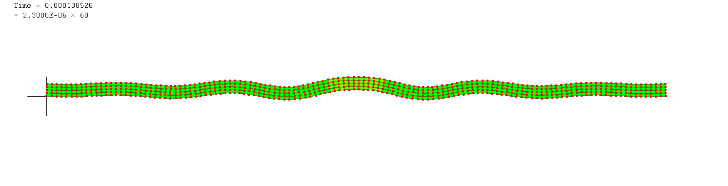

Christian,
I couldn't upload a movie of my LISA beam transient simulation, but here are a few still pics from it from start to end.
The "panel" has properties similar to plywood, 25 cm long and 5 mm thick on simple supports. In this case it's driven at the center by a point force at 11.55kHz, which is natural frequency of the 11th mode. It still has PIP-like response in the second image below at about 0.14 microsec, but by 0.26 microsec it already has the mode shape established, which just grows larger in amplitude after that (as you would expect at a natural frequency).
It would be so neat to see you plate version, in motion, in a similar simulation.
Eric

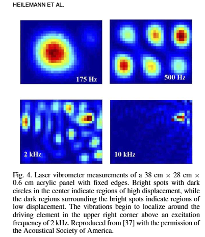

I think you have forgotten the video I posted on this forum some time ago.In my view there is no question that there is indeed "interference" in both the panel and the air. But what is the nature of that interference and what would it sound like?
I think that at least part of the reason that the "in air" effect seems dominant is mainly because "in the air" is where our ears are. That is, our ears are in a particular place in the air at some distance (and more importantly angle) from the panel. And since the peaks and dips due to interference of the waves in air occur at particular, fixed places, we can hear those peaks and dips, and hear them change if we move our ears (or mic) from one place to another.
But the interference that occurs on the plate is of a different nature. Here I think it's useful to consider two cases, low frequency and high frequency, or as Dave would call it, the modal (low frequency) and statistical (high frequency).
At low frequency, I think it's likely there would not be any real interference as long as the exciters are close together and driven in phase. If they are far apart, or driven in opposing phases, then the effect would depend on the position of each exciter relative to the nodes and antinodes of the plate's natural frequencies. And the effect would essentially be to selectively drive different sets of modes at different levels.
But at high frequencies, when the plate is no longer modal, then I suspect the effect on the plate is different. In that case I think the movement of the plate looks something like this: (try the second link if the first doesn't work). Note, the simulation shown is not actually a panel, but rather light wave, but I think it is still applies, at least qualitatively.
https://en.wikipedia.org/wiki/Wave_interference#/media/File:Two_sources_interference.gif
https://en.wikipedia.org/wiki/Wave_interference#:~:text=When the two waves overlap,net displacement at these points.
There are certain angles on the panel where there are stationary nodes (no motion, blue-green in color) and other intermediate angles on the panel where there are nodes and antinodes that move radially from the center out. So if our ears were on the panel, we could probably hear the difference between various locations on the panel. But our ears are not on the panel. So the only way we would hear that effect is if that pattern on the plate is somehow translated into some pattern in the air. But is it? And what would it look (sound like)? How would we detect it? I don't know.
In principle, Laser Vibrometer might be able to detect this behavior on a panel, but I don't know if the resolution is good enough. Likewise, the velocity map in Dave's model might also, but again the resolution of the model may not be sufficient. And still there would be the question of whether or not the pattern on the plate is even translated into a pattern in the air that can actually be heard.
Eric

Killed is a harsh word. Is it killed? Or mitigated? Or controlled? Or even remedied?on the right the dml action has been damped or killed by the damping.
That would indeed be the point.But even the waves are being damped by the damping.
I don't really care what it's called, only that it reproduces recorded music accurately.By doing this, You have created a bending wave panel with pistonic action in its central excitation area.
If you are saying that the pistonic motion of the exciter initiates the bending motion of the panel, I agree. But in the region of the exciter, the panel itself is bending as much or more than in any other region. So I think it's wrong to say that the panel's action is pistonic there. Pistonic means "moving as a rigid body" (i.e. without bending). The exciter itself is arguably pistonic, but the panel itself is certainly bending, and clearly not pistonic.The first action on a panel using an exciter is the pistonic action not the PIP.
Not that it won't be heard, but rather that it can be muddied by the overlap of the old sounds with the new. That is, unless the resonances are adequately controlled.Are you saying that the next note on a musical instrument will not be hear because the panel is already vibrating.
Eric

Dave,
Both your model and laser vibrometer results show that the panel velocity profile becomes localized at high frequencies. It seems to me that there could be a couple of different mechanisms which could all result in that localization:
One is the effect shown in Ben Zenker's paper, when the damping is high enough so that a traveling wave pattern is set up, instead of a standing wave pattern.
As second possibility, however, could arise from the fact that (even without high damping), at high frequencies multiple modes are excited. And all those excited modes have antinodes at or near the exciter location. So near the exciter, all those modes will be in phase with the exciter's motion, and have relatively large velocity there. But once you get far enough away from the exciter, it seems likely that the velocity will tend toward zero, simply because some of the excited modes will be "in-phase" with the exciter, and other will be "out-of-phase" at any particular location far enough from the exciter. And hence, the average velocity in this case would also diminish as you move farther away from the exciter. I suspect this is what you consider to be the "statistical" region, If I am not mistaken.
And finally the third reason is the "drum" effect caused by the exciter's diameter.
But considering the first two cases. Is there a difference in the sound radiation characteristics of the two? Do the two cases even exist in reality? And if so, does your model "show" that difference in any way?
Thanks,
Eric
Dave,
Thanks,
Eric
Well, because my simulation is a modal one, this is in fact exactly what's happening. I don't ever simulate traveling/evanescent waves on the surface - the localized pattern arises from the constructive overlap of many modes being actuated in that particular way. For those familiar with DSP theory, the wider bandwidth something gets (in this case, bandwidth refers to k-space, or wavenumber space), the narrower it gets in the transform domain (e.g. the actual vibrational pattern). So the more modes that are actuated at once, the narrower the vibrational shape becomes, and at high frequencies many modes are being actuated at once.As second possibility, however, could arise from the fact that (even without high damping), at high frequencies multiple modes are excited. And all those excited modes have antinodes at or near the exciter location. So near the exciter, all those modes will be in phase with the exciter's motion, and have relatively large velocity there. But once you get far enough away from the exciter, it seems likely that the velocity will tend toward zero, simply because some of the excited modes will be "in-phase" with the exciter, and other will be "out-of-phase" at any particular location far enough from the exciter. And hence, the average velocity in this case would also diminish as you move farther away from the exciter. I suspect this is what you consider to be the "statistical" region, If I am not mistaken.
I'm happy to say that I've made the free version of PETTaLS available here: https://sites.google.com/d.umn.edu/profdaveanderson/pettals
You'll have to request access for the download - this is mostly so that we can be made aware if any companies are interested in the software, and the University can follow up with them. You'll also have to download the matlab runtime environment as part of the installation process. This installer also only works on Windows right now.
The free version only has three exciter types (point source, DAEX19CT-4, and DAEX25VT-4). Someone asked me about Xcite models, and I'm planning to get to those (and others) eventually - right now we have a giant pile of Dayton exciters that we're working through measuring and verifying.
On that note, I'm hoping to also release the expanded version soon that'll include a ton of different exciter models, the ability to simulate multiple exciters independently on the same panel, the model for sandwich boards (though it's probably still too simple for Eric), additional boundary conditions, stands, movable weights, etc.
I'll make some videos about this version at some point - one thing to be aware of is that I have the program default to setting the bandwidth at only 2kHz after most changes. It's possible to set the simulation to a very large, very thin panel and at a 20kHz bandwidth this can take hours to run. It's best to step up the bandwidth from 2kHz and make sure that the full 20kHz bandwidth isn't going to take forever.
