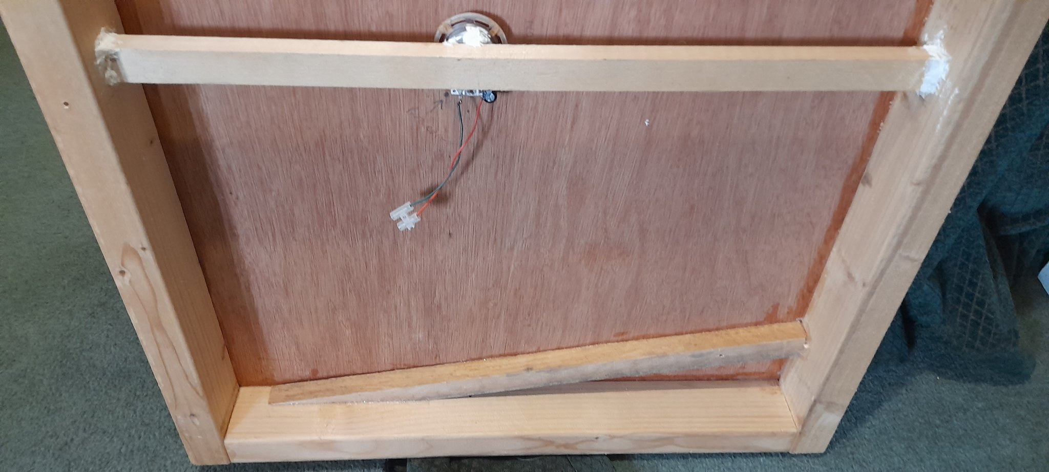

I guess that would be ideal, although it seems like at least initially supporting them from the back with a screw in the hole in the back did make them balanced enough to avoid distortion. But at the first event I did they played for a couple of days a string suspension that was not precise and sufficient to hold them completely level. And that seems to have caused distortion that can no longer be helped by neither supporting them or placing plates horizontal.Hi Leob
The only way to guarantee no sag load on the assembly is to find the balance point of one of the exciters and arrange your mount detailing to suspend the group on that axis. Practically, that'll mean insetting your group mounting plate partway along the exciter housing
Should be easy enough with your printing method

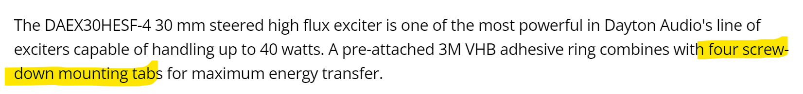

According to soundimports where I bought the exciters:
Code:
The screwhole on the Dayton Exciters is for production purposes and not meant for mounting. A free hanging exciter is a perfect viable construction. The sagged suspesion is probably caused by aging over time and use. Xcite invested a lot of time in optimizing the suspension (spider) and will probably have less aging.

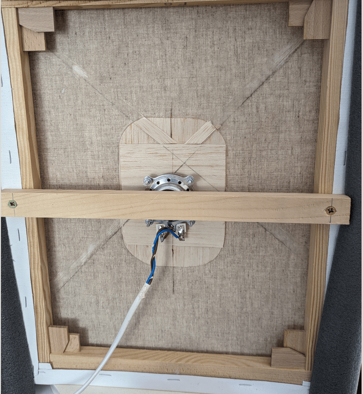

Thanks Eric,Leob,
Can you remind me what exciters you are using?
Also, can you point me to your post(s) showing what your bracing looks like? I to
ok a quick look myself for them but couldn't find them easily.
Not sure I can be much help, but I'm happy to look it over and see if anything comes to mind.
Eric
I'm using DAEX30HESF-4
https://www.diyaudio.com/community/threads/dml-pa-systems.390363/page-8#post-7309172
Will have to take som pictures of my latest design as well...

The DAEX30HESF-4 has a hole in the middle back with M6 thread.

Hi Leob
Have you considered what exactly is moving to cause the sag?
It would seem highly unlikely that the coil would sag under its own mass alone, therefore there must be a load on the coil caused either by the downward sag of the panel itself relative to your mounting, or flex in your mounting, which by the position of the mount, would induce a couple, or moment, thereby displacing the coils.
Given the low mass of the foam panel, I suspect that twisting/flex in the mounting is the culprit.
Obviously, with a perfectly rigid brace securely screwed to the rear of the exciters, and a panel which doesn't shift downwards over time, there should be no shear or torque on the coils to cause distortion.

Not sure where you got that I was warned in advance Steve?
But that doesn't really matter. I spoke to the seller/distributor, and they have stated that they should not need support. If they say I have used it correctly if I used it unsupported, of course I blame the exciter if it breaks from being used unsupported?
But it is great if the community here has a workaround for the defect and people that have read the 11000+ posts here can avoid experiencing the same issue.
Leob.@jaxboy
Hello Jaxboy
Here are pictures of my canvas.
To summarize :
The nuts you can see at the exciter are not used here.
- I put a tension in the canvas thanks to the triangular keys a each corner of the frame
- I applied 1 layer of watered wood glue at the back of the canvas
- The pad is made of 2 layers of 1mm balsa. One 15x10cm then a 10x10cm with the grain in perpendicular direction of the first one
- I applied a second layer of watered wood glue including over the pad (I don't remember if I applied it also at the exciter position...)
- The exciter was glued to the pad with epoxy in dead center position
- For the spine, it is a simple piece of wood. The back of the exciter is aligned with the back of the canvas frame so no additional blocks were needed. there is a double side tape between the exciter and the spine.
Hope it will help.
This was a panel Christian made with a rigid spine support.
This subject keeps popping up.
It has been done like this for a reason .
This is an very old panel I have posted many times on this forum.
Steve.
