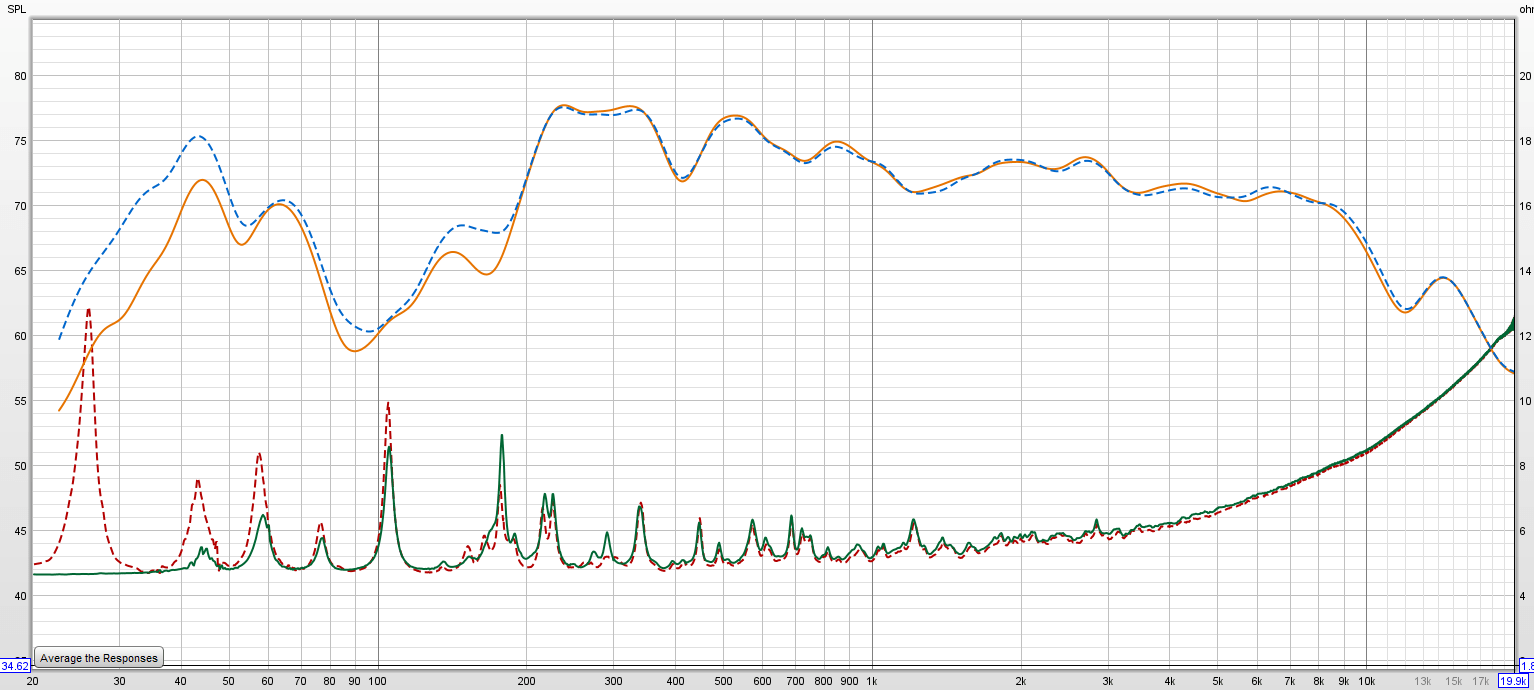

Hello Eric,Below are the results of a second test that I just performed, comparing SPL and impedance curves with and without a brace supporting the exciter. In the new test, I used a panel with a much lower fundamental frequency (about 43 Hz) than the panel in the previous test (about 100 Hz). The panel in the new tests is a 48"x18" panel of 14 mm thick XPS.
The dashed lines are the results with no brace, and the solid lines are the results with the brace. As in the previous test, the addition of the brace eliminates the impedance peak associated with exciter's mass and spider (at about 25 Hz in this case). Interestingly, the addition of the braces reduces height of the first several panel resonances as well.
Concerning the SPL, there appears to be some increase in bass output without the brace, particularly below about 60 Hz. In the previous test there was a similar (but much smaller) effect.
For me, evidence is building that the addition of brace does not increase bass output, but rather may actually decrease it. That said, I wouldn't consider the elimination of the brace to be a meaningful improvement to this panel, as to me this panel is really only "useable" above about 200 Hz (if at all).
These results demonstrate another thing that I've observed fairly consistantly (but has nothing to do with the brace). Which is that if I build a panel with a fundamental frequency of about 80 Hz or higher, there is a chance (with the right aspect ratio, right suspension and right exciter placement) that the SPL response can be reasonably flat above the panel's fundamental frequency up to at least 5 kHz (or even 15 kHz). But If I build a panel with a lower fundamental frequency, I inevitably end up with a big gap in the frequency response between the fundamental and about 150 to 200 Hz. So while tuning the panel lower allows significant bass output, it's not what I consider "useful" output, The present panel is a good example of that, with the large dip in output between about 50 and 200 Hz. For this reason I've pretty muched stopped even trying panels like this where the fundamental is below about 80 Hz.

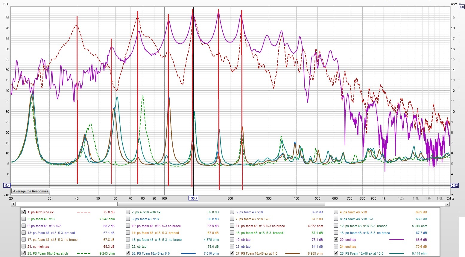

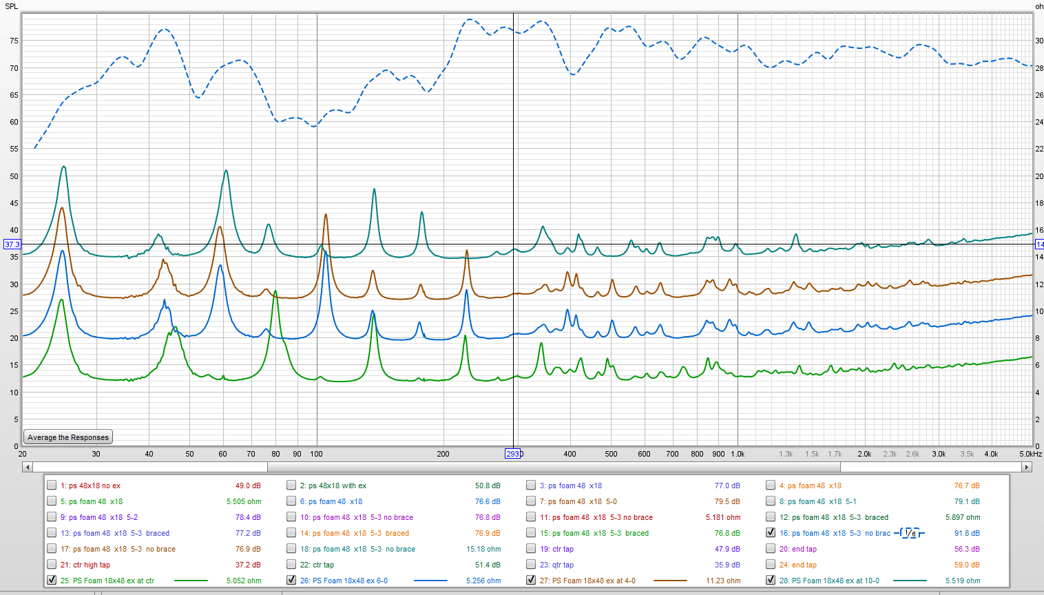

Now that I have the impedance jig, I use it in parallel with just about every SPL measurement I take. As it turns out, the information from the impedance test is very similar to that from my tap tests. That is, the peaks in the response (in either case) correspond to the natural frequencies of the panel. Also, like in the tap test, the driving location is very important.
That is, in the tap test, as you recall, if I tap a location on a panel that is at an antinode for a particular mode, there will be a peak in the SPL response (close mic) at the frequency of that mode. But if I tap at an antinode for that same mode, there will be no peak in the SPL at the corresponding frequency.
The same thing happens in the impedance test, when you move the exciter around. See below the impedance test results (solid lines) for the same PS foam panel, with the exciter at four different locations on the panel. In each curve (offset for clarity), the peaks occur at (nearly) the same frequency, but the size of the peak varies. The peak at the lowest frequency (25 Hz) is always the same, because that's the resonance of the exciter itself. But the peaks at about 45, 60, 75, 105 Hz, etc, all vary in height depending on the location of the exciter. These peaks are the 1,1 and 1,2 and 1,3 and 1,4 modes of the panel. Note that the 1,2 (60Hz) and 1,4 (105 Hz) and 1,6 (175 hz) impedance peaks all disappear in the green curve at the bottom. That curve corresponds to the exciter at the very center of the panel, which is node for all of those (1,even) modes. Hence, those modes are not activated, and no peak in the impedance is evident.
Do note that the impedance peaks (especially for the fundamental at around 45 Hz) do shift around in frequency a bit. This is the effect of the exciter itself on the panel's natural frequencies. In the tap test (no exciter), the fundamental appears at about 40 Hz, so the presence of the exciter shifts it higher by up to about 6Hz (exciter at center). Note also that for the higher frequency modes, the influence of the exciter location on the frequency at which peak occurs is diminished. For example, for the 1,5 mode at 136 Hz, the peak occurs within +/-1 Hz regardless of the exciter location.
Regarding the "hole" in the SPL between 50 and 200 Hz: I have no doubt there is some effect of room modes. I have convinced myself that the room has a mode at about 120Hz, and that dip is evident for this panel as well. I'd have to do some more investigation to test if the rest of the dip could be the result of other room modes....
Eric
This plot compares two tap test results (the upper curves, without exciter)), with impedance test results for the same panel with the exciter at varous locations. The correlation is hard to ignore. For the lowest frequency peaks, the natural frequencies in the impedance results are at slightly higher frequency than the corresponding peaks in the tap test (due to the influence of the exciter mass and stiffness). But at higher frequency modes the natural frequencies are virtually identical in the two tests.
So both tests provide very similar information. Tap testing is a little better for fitting and refining my finite element models of panels and estimating their elastic properties, because no exciter is needed, and it's much quicker to simply tap/mic different locations on the panel than it is to remove and reattach an exciter.
But the impedance curves have a nice flat baseline which makes plotting easier, and have less noise in the data at the extremes of the frequency range. So both tests have their place.
