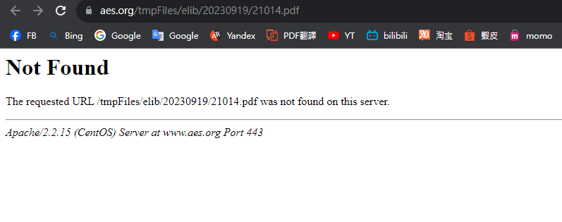

Hello Andre,
Try that one : https://www.aes.org/e-lib/browse.cfm?elib=21014
Or search for aes.org + 21014
Seems we can't access directly to the link given by Eric.

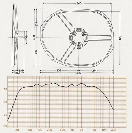

It is a rather flat cone. Here is a FR of the JA5004 in this family.
More than 5kHz... Possible without entering in DML with such a surface ?

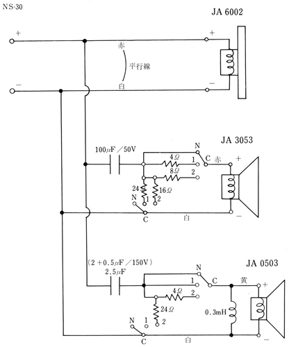

Extract : the crossover of one of the speaker of this NS family. The elephant ear speaker is not limited in its bandwidth. The medium is in LF.

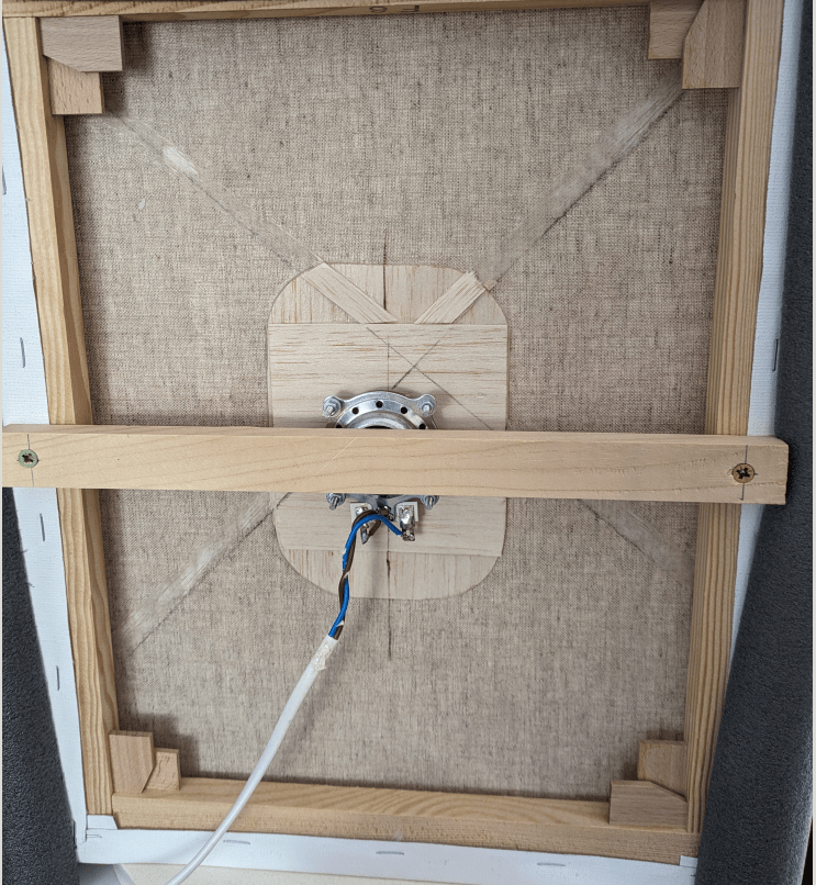

Hello Jaxboy

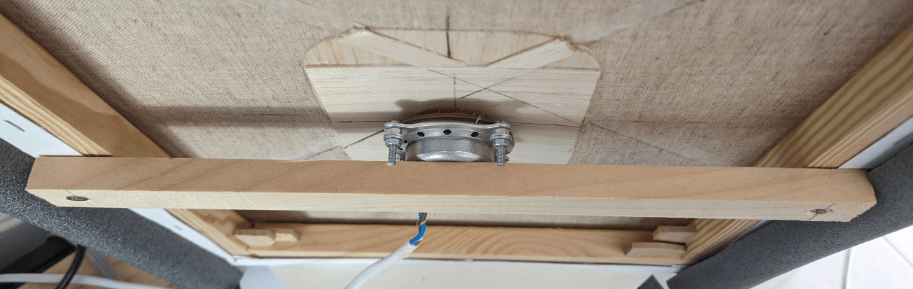

Here are pictures of my canvas.
To summarize :
Hope it will help.
Hello Jaxboy
To summarize :
- I put a tension in the canvas thanks to the triangular keys a each corner of the frame
- I applied 1 layer of watered wood glue at the back of the canvas
- The pad is made of 2 layers of 1mm balsa. One 15x10cm then a 10x10cm with the grain in perpendicular direction of the first one
- I applied a second layer of watered wood glue including over the pad (I don't remember if I applied it also at the exciter position...)
- The exciter was glued to the pad with epoxy in dead center position
- For the spine, it is a simple piece of wood. The back of the exciter is aligned with the back of the canvas frame so no additional blocks were needed. there is a double side tape between the exciter and the spine.
Hope it will help.

My canvas looks in effect exactly like yours, as I used yours as my model, and I really like them. Instead of balsa, though, I used a similar-sized piece of paneling that I sanded on both sides so it was just a hair thicker than just the center ply.Here are pictures of my canvas.

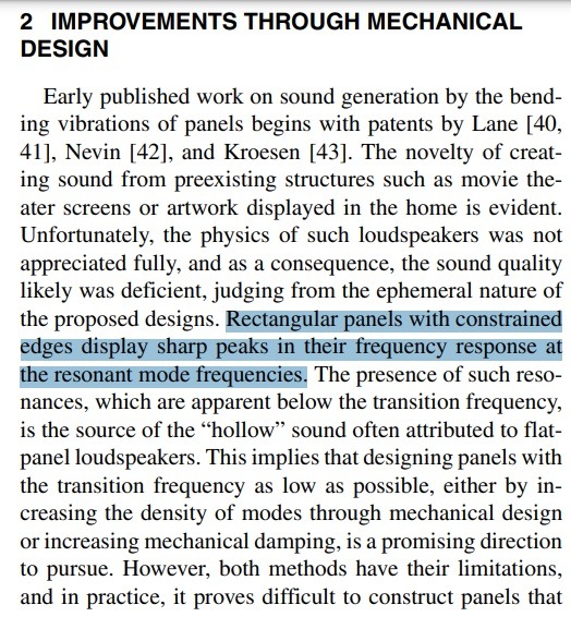

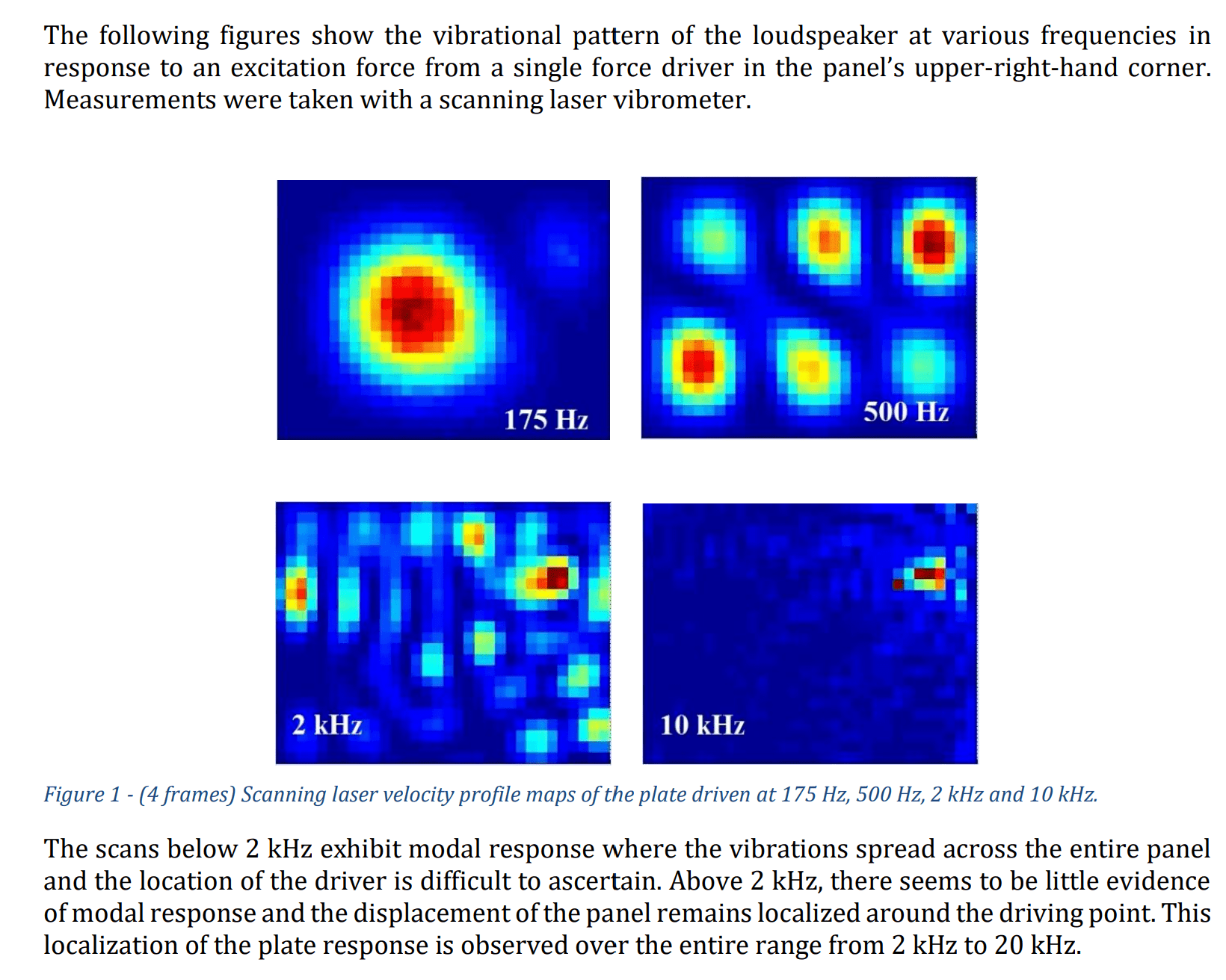

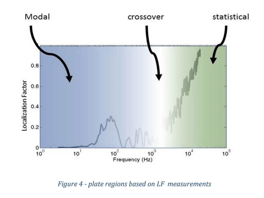

That paper led me to this one by the same authors:
https://pubs.aip.org/asa/poma/artic...Measures-of-vibrational-localization-on-point
This paper is one of the most intriguing (and mercifully short!) papers I've come across in a long time. This figure is central to the paper:
And they end up splitting the frequency response into two regions (figure below), "modal" below a crossover frequency and "statistical" above the crossover frequency.
It reminds me of a discussion we had on this thread some time back concerning the different frequency regimes of a DML. I wanted to look back at that but couldn't figure out how to find it. Any body think they can? (Christian??).
I enjoyed that the paper is so short, but one thing I wish the authors wrote more about was the implications of this crossover frequency on the characteristics of the sound produced in each regime, say in terms of directionality, phase (correlated/uncorrelated), etc.

Hi Christian
Can you upload it again?
I can't open it???

Hello EricThanks for providing a working link Christian.
Eric
I will try to find a time to make research (no sure of the result...) and for sure to read this paper.
What I understand behind "crossover frequency" or "transition frequency" is it is the same concept as "Schroeder frequency" for acoustic in a room.
Below this frequency, the separation of the mode is important so when a frequency is played, only one mode is working. The resulting FR is at the image of the modes with peaks and valleys
Above this frequency, several modes will play for a given input frequency. The result will be a smoother frequency response (sort of mitigation between modes).
One can read the transition frequency is a statistic approach showing where the modes have enough overlapping to smooth the FR.
So not a strong physical definition but a metric to describe the behavior of the panel (the room).
The recommendation in the paper you linked (not this last one, the one before) is to have this transition frequency as low as possible.
As it is directly linked to how the modes are located over the frequency range, the drivers (design parameters) are the panel dimensions, the panel ratio, the material choice, the boundary conditions (suspension).
For a room, there is a relation between the reverberation time which is quite easy to mesure and the Schroeder frequency. For a panel, I don't know...
Christian
