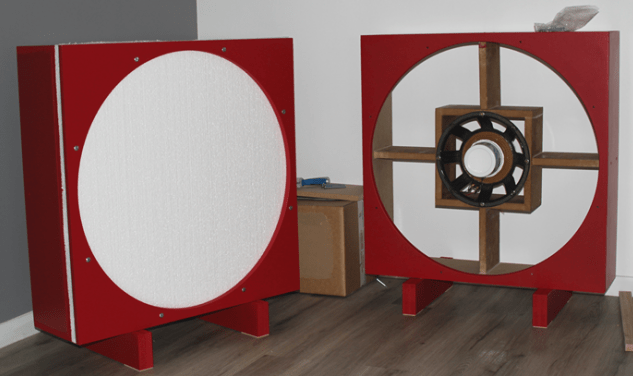

Christian,
I've taken a look at Infraflex, it's mighty interesting, and at the same time, mysterious with some of the design choices (presumably due to trial & error, like you said). I'm purely going by the pictures shown in this website: Infraflex: an attempt at synthesis (forum-hifi.fr) so please let me know if any changes have been made since then.
1. The way the speaker works with the polystyrene. It seems they've fashioned a (plastic) cap to transmit the vibration from the coil. The cap seems small and makes contact with only the panel center, so I wonder if it can provide optimal coverage for energy transmission. In comparison, I look to the Japanese, in particular, Sony APM drivers and observe how they did it. Here's the link to internals of a Sony APM-33W woofer. You can see that a special bracket is placed at the coil, from which 4 metal (aluminum?) legs adhere into the diaphragm, approx. in 4 directions. I assume it's not only a way to distribute energy evenly but also to combat resonance modes in a square diaphragm. Can the same method be used for Infraflex?
2. How the polystyrene panel "stays" in the box. Is it held by some sort of clamp or simply glued at the edges? Unfortunately, the available pictures are too blurry for me to know.
I don't follow very often what happens on this topic. I took notes about it not really more. I will see when the time of decision for a solution for the bass will come.
In the Infraflex, the exciter is a "disassembled" woofer. the membrane is removed. So as the basket (frame) of the woofer is kept, to fill the gap, the distance in the woofer axis direction, between the membrane and the voice coil a part is added. You can see in the right side of the picture below where the infraflex is shown without membrane. You can see also the woofer frame. This part was made by reusing the plastic pot in which cream or yogurt is sold. I read somewhere some DIYer fill it with expended foam (polyurethane). So the membrane is not driven by legs as in the Sony example but by a cylinder with a small angle that extends the voice coil.
The polystyrene part is square at about the dimension of the finished infraflex (the red square shape below). The membrane is glued in sandwich between 2 square pieces of "wood" having each the circular opening. So the EPS is fully clamped. The left view is the infraflex finished. In the right one, it is before having the membrane and the outer face part.
I have in my wish list to test it. This design has an incredible advantage to offer a huge emitting surface in final volume compatible with a large room. A 1m side perhaps too big for me but 07 to 0.8m might be possible.

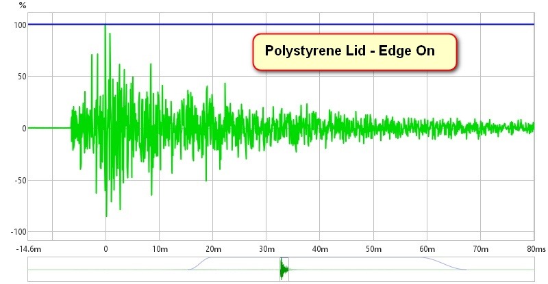

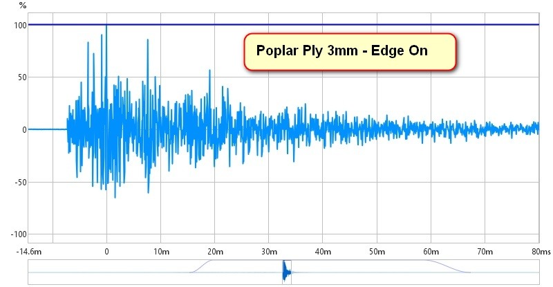

Has anyone here tried this... running cone drivers for direct sound along with DML's for ambience/holographic/spaciousness ? I tried it last week and I can't see me going in any other direction...... at least not until the next new shinny (old) thing comes along 🙂
So far.. I like it with the DML panels edge on, meaning the edge of the panel is facing the Listening Position, the face of the panel is directed at the walls.
I got the idea from this thread at ASR, the thread starter is a bit cryptic in his wording so someone deciphered it in this post.
https://www.audiosciencereview.com/...aveguided-speaker-combined.27988/#post-969627
I'm thinking that the "loudness" of what follows the initial Impulse Response is what gives a DML panel it's ambience/holographic/spaciousness ?
Here are 3 Impulse responses to compare a 2 way cone/dome speaker and 2 DML panels. The Polystyrene lid comes from the polystyrene box the local fresh fish supplier gets their fish delivered in. It seems quite dense.

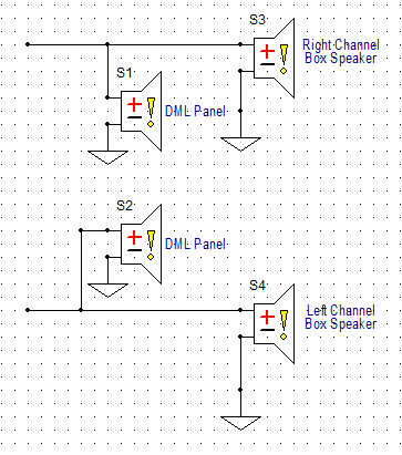

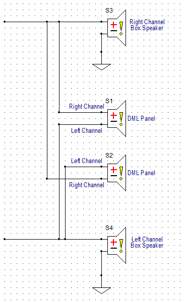

Hi Dean,
The link in that post does not describe how the panel is wired...
Is it a mono mix of the left/right? Is it a centre channel mix? Or is it a left-minus-right mix?
If I had to run a system like that, my preference would be for two DML panels placed flat-on 1 or 2 metres behind the listening position, one wired left-minus-right, and the other right-minus-left. This should give you maximum ambience without running a full-on surround-sound system.
Theoretically the only difference between two cone speakers wired like this, one-channel-minus-the other, would be their phasing, the one being 180° out of phase with the other one. But DMLs, producing a diffuse wave-front, the phasing is of almost zero consequence, and what this setup might produce is a more diffuse, ambient sound-stage behind the listening position with the DML panels disappearing from the ear, leaving only the ambient sound.
But if you really want to try the system described in that link, then it might be better to run two DML panels edge-on, one behind each box speaker, connected directly to each box either in series or parallel depending on the final load impedances and amplifier capability.
