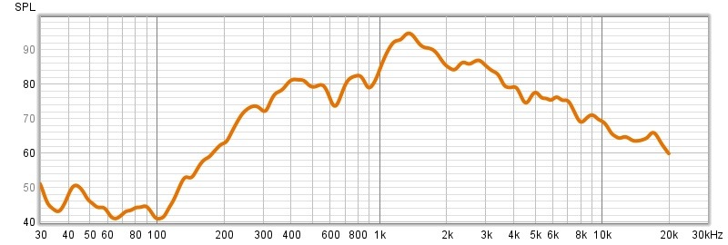

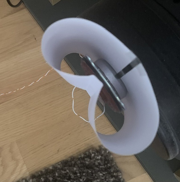

Did anyone consider a rubanoide style of ‚dml‘ ?
I know this will never be Fullrange so this is the wrong thread.
But I just wanted to post this idea.
I made a very quick and dirty test model.
it is just a sheet of copy paper 15x20cm stuck on a dayton exciter.
this is in no way optimized. It leaves much room for investigating in best size, best material/coating, coupling, damping.
I think the rubanoide looks very promising.
even this one does sound quite nice
paired with an ob bass

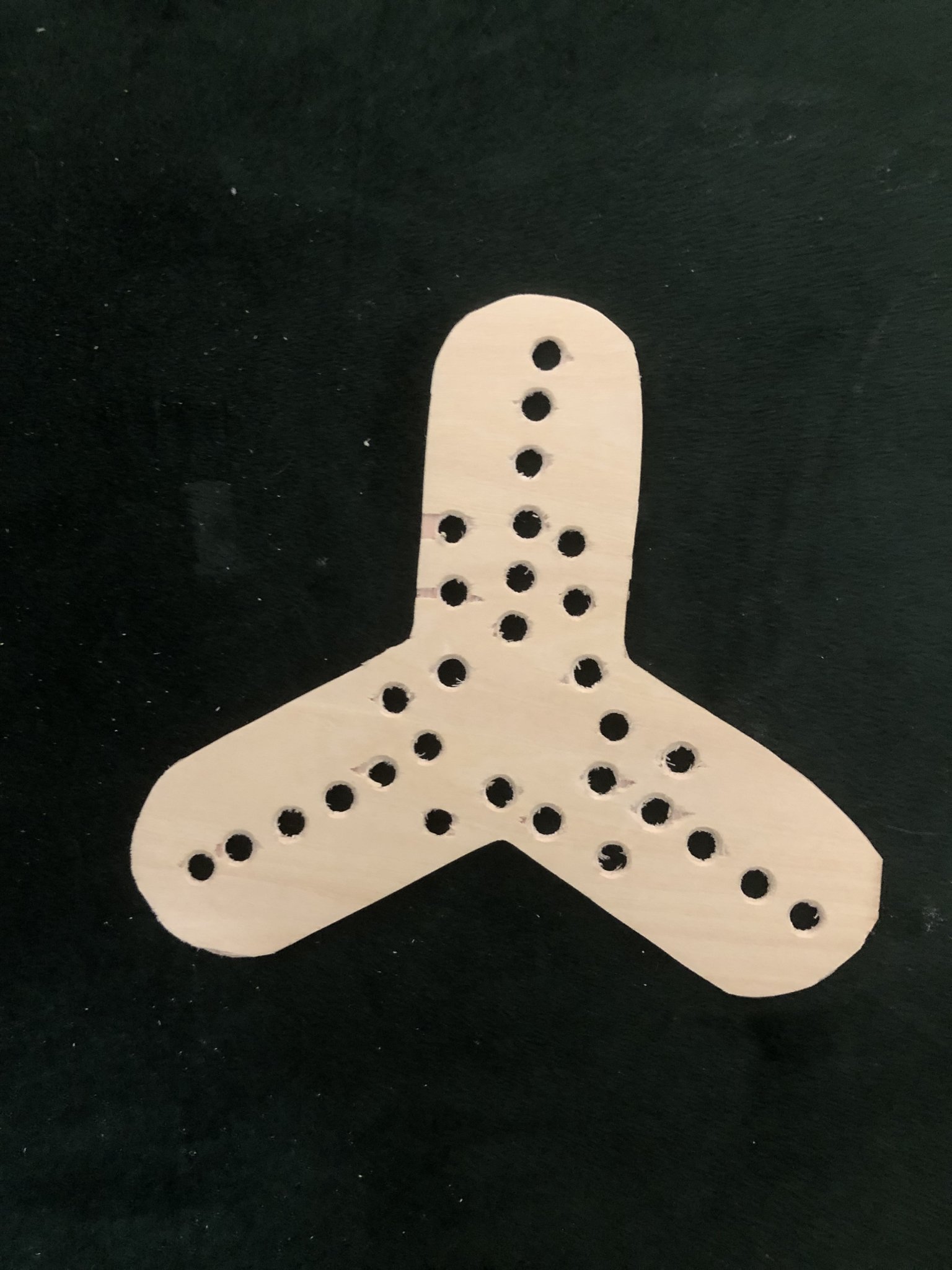

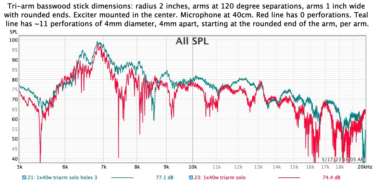

0 vs 11 perforations per arm:
The trend is that the SPL variation is reduced, the peaks and troughs are flattened, and the amplitude of the SPL is increased.

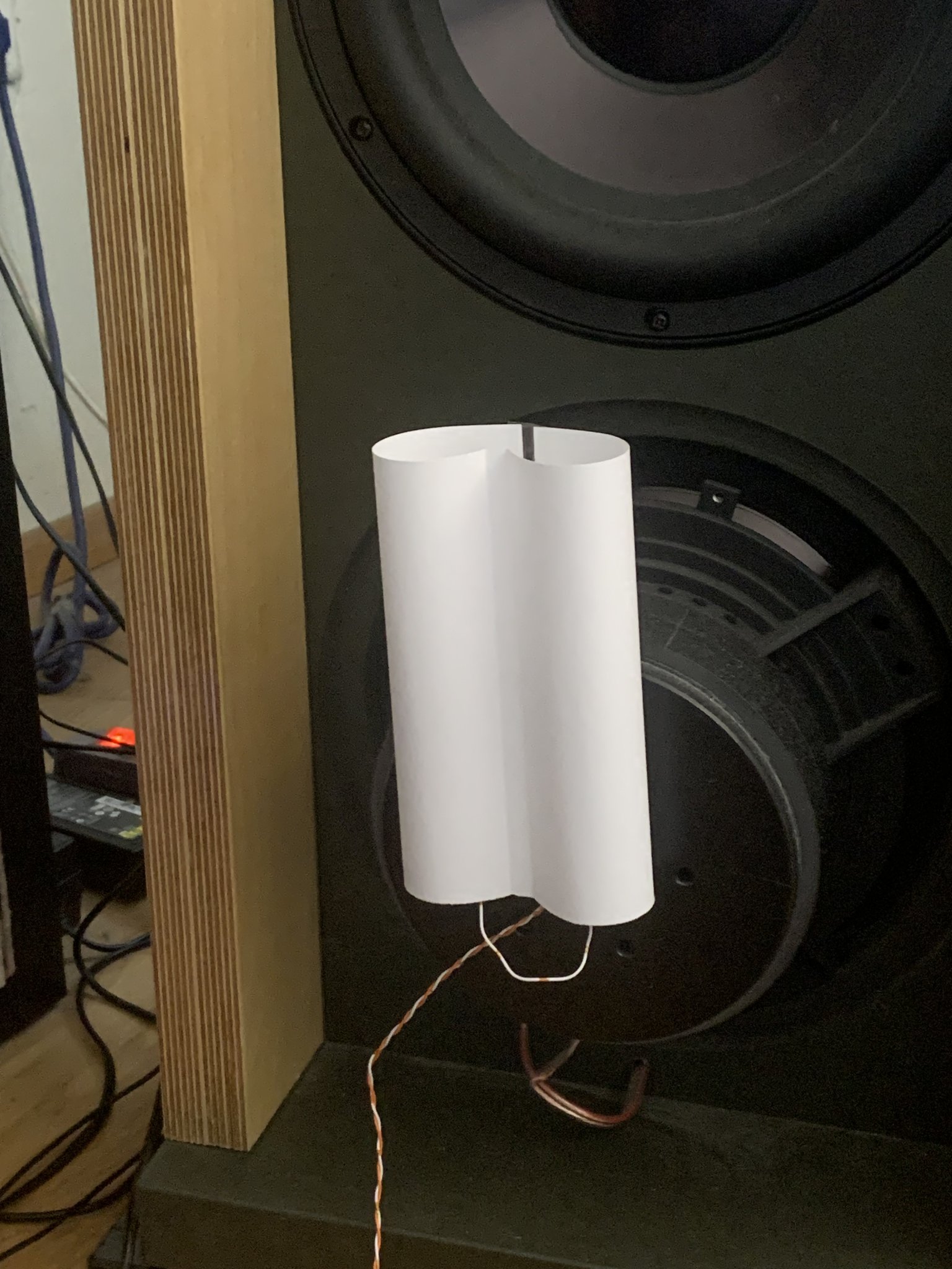

This was greatly promoted by member @chdsl, who has since disappeared. Starts around post #7,527. Search functions can help you.Did anyone consider a rubanoide style of ‚dml' ?
yes I know, but all these are based on the self wound flat coil which makes it difficult to build. I coupled the paper to an exciter. Paper is much lighter than the dml panels regularly used. should give plenty hights. The curved shape gives some practical stiffness.
what is the free no load curve?
The Rubanoid drives the whole long edge of the active surface.The curved shape gives some practical stiffness.
The problem in this design is that the paper is being driven by only one point. It looks like it cannot deliver bending wave action, and probably not HF.
It might work better if you used a light but stiff structure along the edges that touch the driver?
yes, that is my intention. This is one of the things to elaborate. a proper coupling to the exciter. and also to fix the outer edges. This was really a 2 minute check if this is possible at all. exactly the paper is driven at two points as the exciter couples with a ring.
