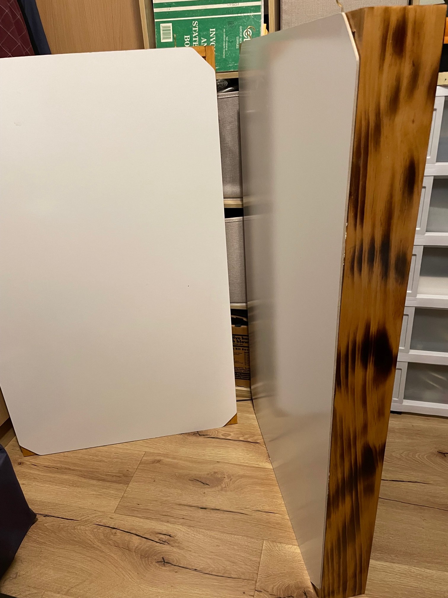

I also tried using XPS panel from our "big box store" in Australia (Bunnings) but their XPS foam is about 1/3 of the density of the foam used by the guys you see on American Youtube Channels and its not as good , the sound is doughy .
After testing a few materials my final product is 3 mm thick MDF laminex coated board , the sound is crystal clear , i didnt do any tests but at a guess i think they would cover 100 Hz up to around 12,000 - 15,000 Hz that i can hear.
The frames are 90 x 19 Pine with an LPG heating torch waved over them for effect , with 2 coats of Polyurethane , The 3 mm MDF is attached with double sided VHB tape , and two 40 watt exciters mounted at 2/5th , diagonally almost opposite each other on each panel.

i tried 3mm , 5mm and 6mm thick masonite and MDF , I went with the 3mm because the sound was clean and sharp over the thicker panels however that test phase was with a single 40W exciter , Its possible that multiple exciters on a thicker panel might fill your lows but with energy transfer kinetics being what they are , i would expect more losses on the thick high density panel.
I didnt try Twinwall as Andre is using.
I considered using 3mm plywood but made an assumption that with it being a slightly lower density than MDF that it might lose a little sharpness but that depends on what coating you use if any , there are too many variables if you bring coatings / PVA etc into the picture , My MDF has no coating other than laminex on the front.

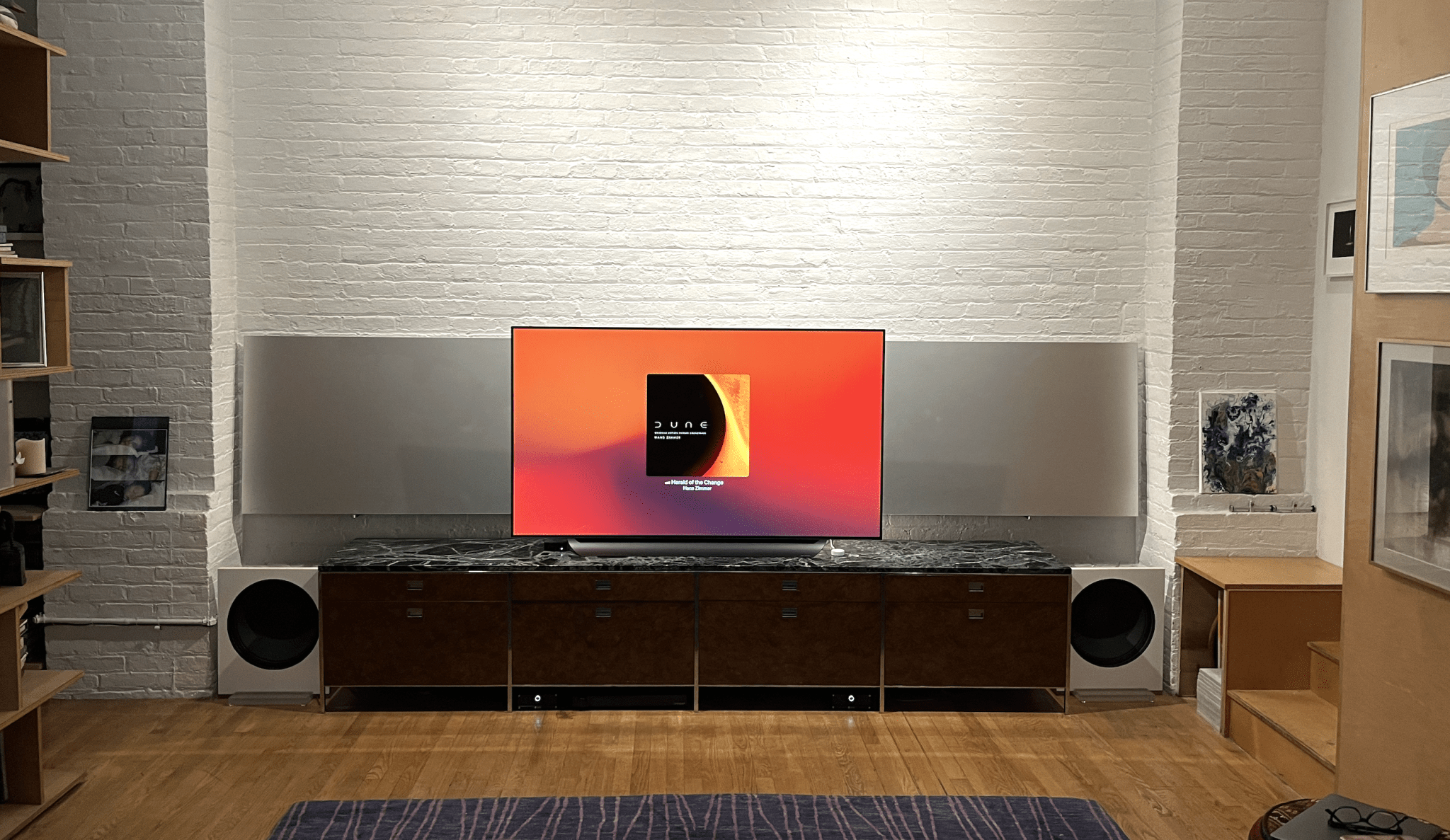

One confirmation question... From what I have read here and elsewhere the diffusion pattern for DMLs generally speaking is near hemispherical in front of the panel (and at the back as well) for all frequencies. Therefore it does not matter whether the long edge or the short edge is oriented vertically. In other words it does not act like a line array even for higher aspect ratios.
Most seem to be orienting them vertically but I suspect that has to do more with available space and not with sonic performance.
Agreed?
I've had great success with horizontal panels. My current application has a pair of approximately 6' panels stretching across a 12' wall. You can find photos in earlier posts.

I formed an opinion that MDF was harder than Ply based on me pushing my thumbnail in to both , The Ply had a just discernible dent while i couldnt make any impression on MDF at all , Ply being alternating cross plys it should have a higher structural strength but i didnt test its sound qualities.
The sound is awesome on one speaker , but the other has resonance / rattle at certain frequencies because where i have used 4 mounting screws back to the spine , i have 1 or 2 screws not tensioned evenly , If i cant get rid of that noise by adjusting the threaded rods i will have to redo one speaker by cutting off the exciters and do them again with fresh superglue.

I looked for the photos but you have a gazillion posts just in this thread 🙂
Always happy to share photos of the kids...
Note: TV now has a pair of Thrusters on the back and serves as a center channel.
Aluminum panels rest on dense foam supported by L-brackets and lean at an angle against another bit of foam against the wall.

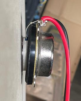

For example @Andre Bellwood posted above that he uses the DAEX25Q-4 which is an arm design and based on his reports they work well. However he is using four of them on a large panel so perhaps some damping is not an issue; this is assuming the damping is across the response and not localized.
Yes, I chopped off the legs and removed the plastic housings (utterly useless additions) to get the magnets mounted hard onto heat sinks to improve heat dissipation. Nothing to do with damping.
I suspect that any difference in sound with and without the legs will be psychological. There's no difference in measured performance.
