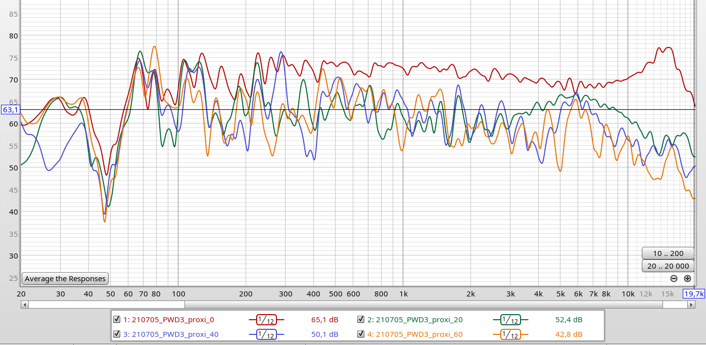

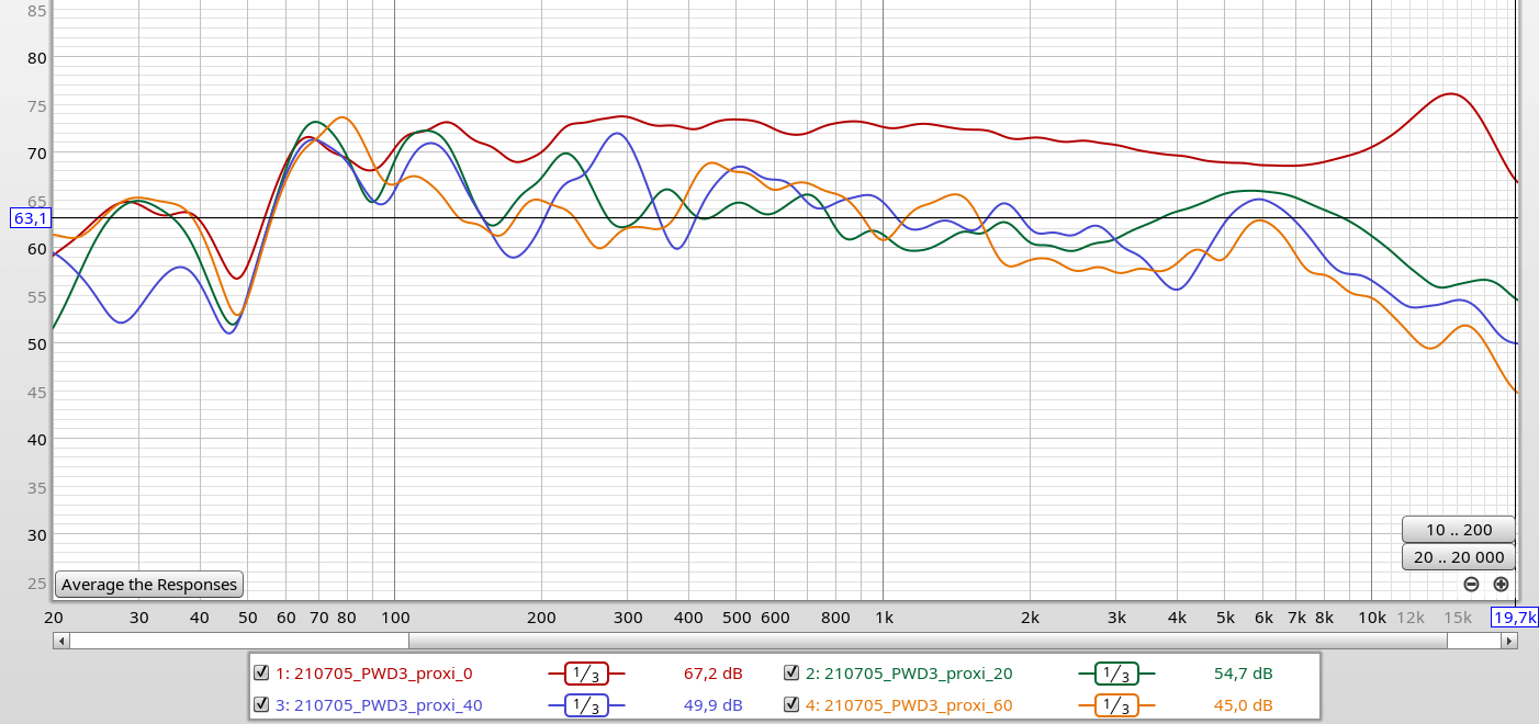

I found in my files those measurements : mic @2cm from my plywood panel at the exciter and then 20, 40, 60cm. 60cm is close to the edge. I think I already posted them. I found also in my files a comparison at 18cm for EPS based on your measurements (not easy to transform in a table your pictures!).
Below 1st is 1/12oct smoothing, 2nd is 1/3oct showing a constant increasing attenuation with distance and frequency.
In your mearsurements, in HF I don't understand why after being attenuated, the level increases again.

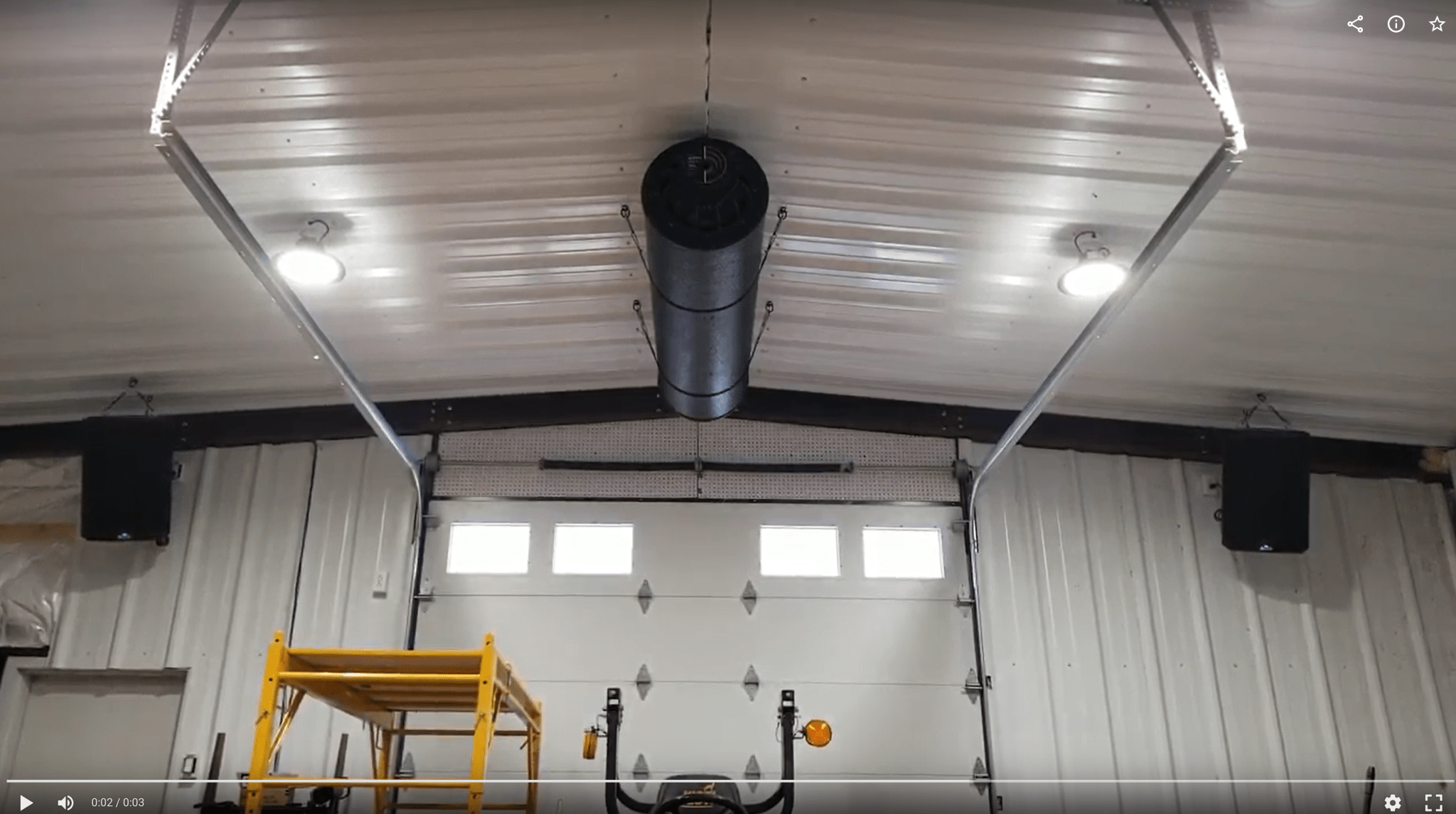

I'm currently using two 1,400 x 450mm panels for semi-outdoor live PA. Each panel has 4 x 20W DAEX25Q-4's in a crescent cluster. The panels cross over at 200Hz to a sub, and are plenty loud enough, and when I wire them for stereo, you can get a pristine sound stage even at 20m away (65ft?). For more laid-back indoor performance I use them as-is without cross-overs or subs.Thanks. I should have mentioned I am going to keep the subwoofer and can cross it over actively with a 4th order (LR) filter on both sides. That is what I am doing now at 100 Hz.
I was guessing based on what I have read here that a large part (see what I did there) of the sound of the DML is due to their large effective size. Since I have a large space, would a larger panel (in a larger room) not be more desirable? The listening position is up to 40 feet from where the panel would be hung so in that sense it is more like an outdoor setting (minus the walls) and not so much a media room or near field setting.
I sometimes use them at home as hi-fi to play background music when entertaining guests. I've been through a few decent hi-fi systems in my past, and none of them would deliver the sound or experience I get from these.

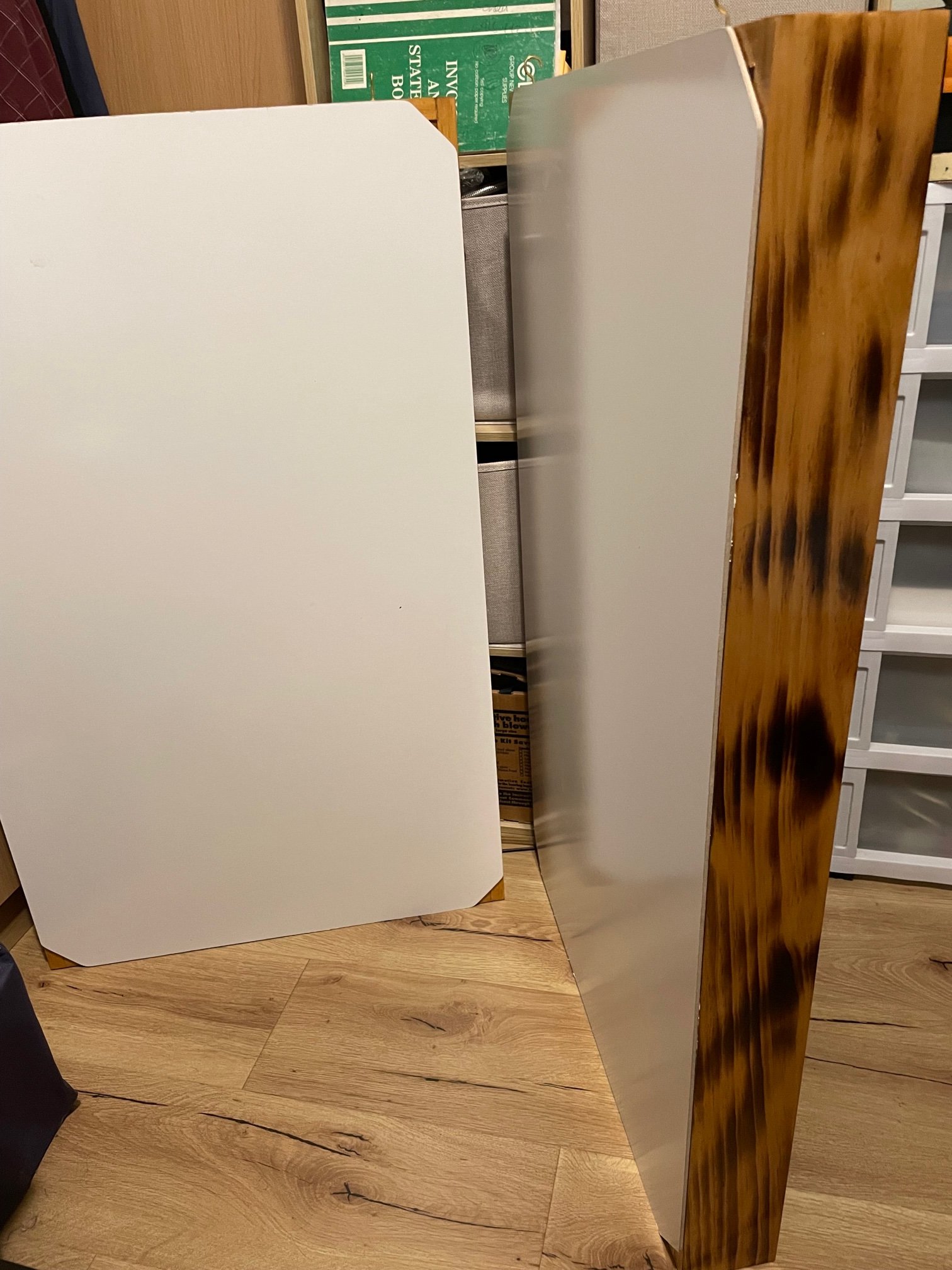

My first ones were with DAEX30HESF-4 , they overheated and the membrane diaphram sagged causing a pretty crap sound , i thought Dayton would have stopped making these because i can see on the newer designs they addressed the issue , yet DAEX30's are still being sold 🙁
I will be buying either DAEX32EP-4 , or EX32EP2-4 to replace the first ones because they both have a steel spider that prevents sagging of the body versus the axis of the voice coil.
I wish Dayton had the honesty to withdraw the first product , thats $ 160 AUD for four of them i wasted.
I also tried using XPS panel from our "big box store" in Australia (Bunnings) but their XPS foam is about 1/3 of the density of the foam used by the guys you see on American Youtube Channels and its not as good , the sound is doughy .
After testing a few materials my final product is 3 mm thick MDF laminex coated board , the sound is crystal clear , i didnt do any tests but at a guess i think they would cover 100 Hz up to around 12,000 - 15,000 Hz that i can hear.
The frames are 90 x 19 Pine with an LPG heating torch waved over them for effect , with 2 coats of Polyurethane , The 3 mm MDF is attached with double sided VHB tape , and two 40 watt exciters mounted at 2/5th , diagonally almost opposite each other on each panel.
