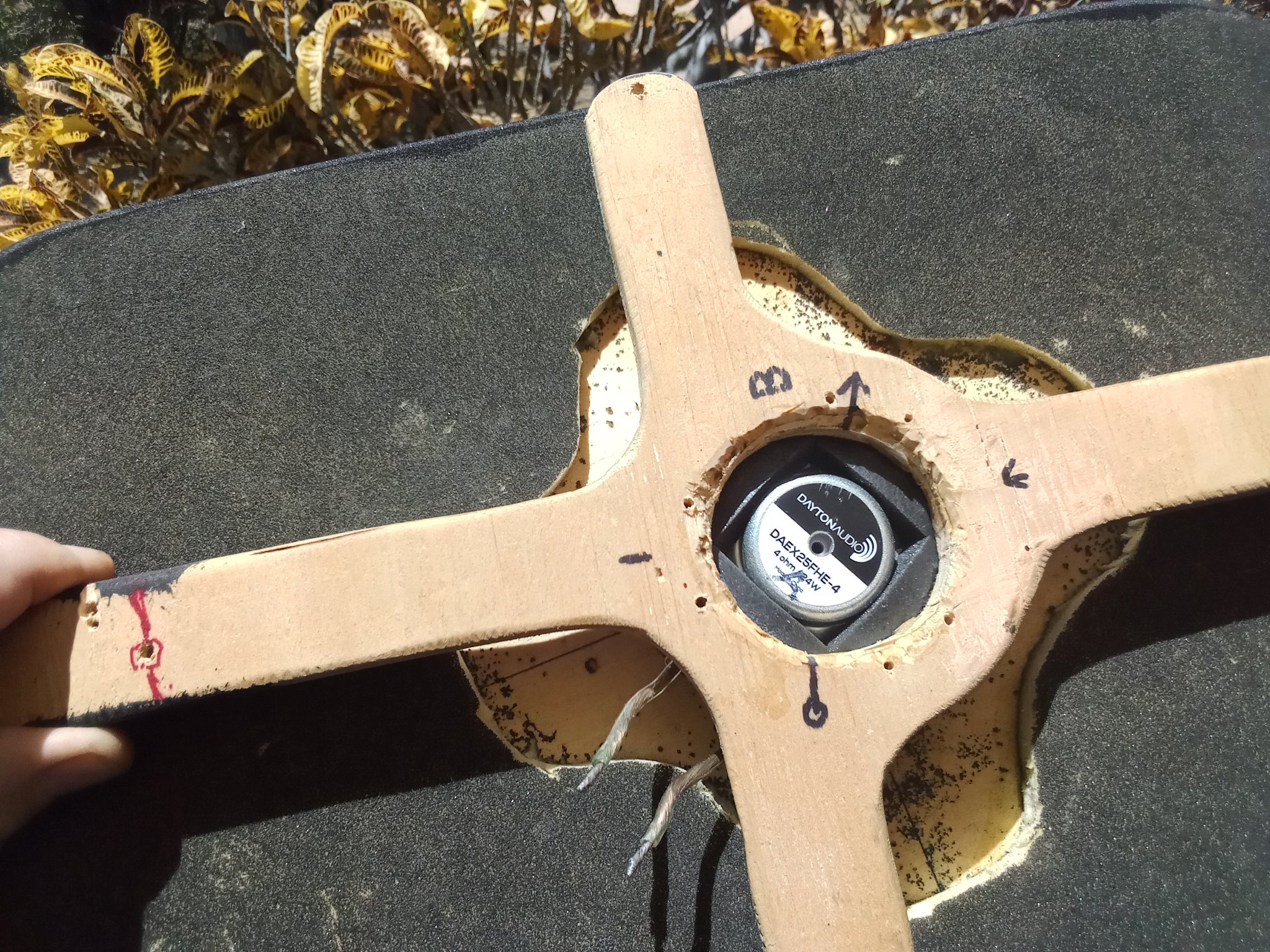

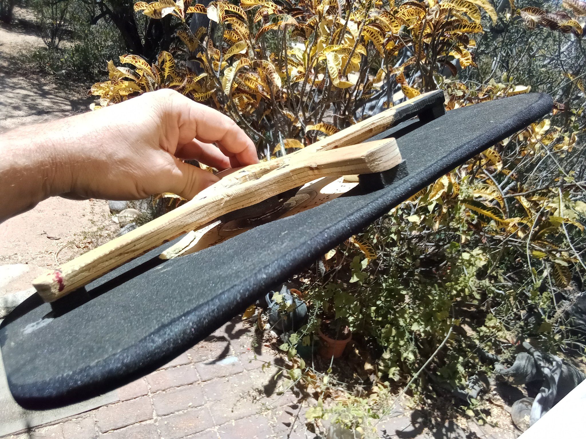

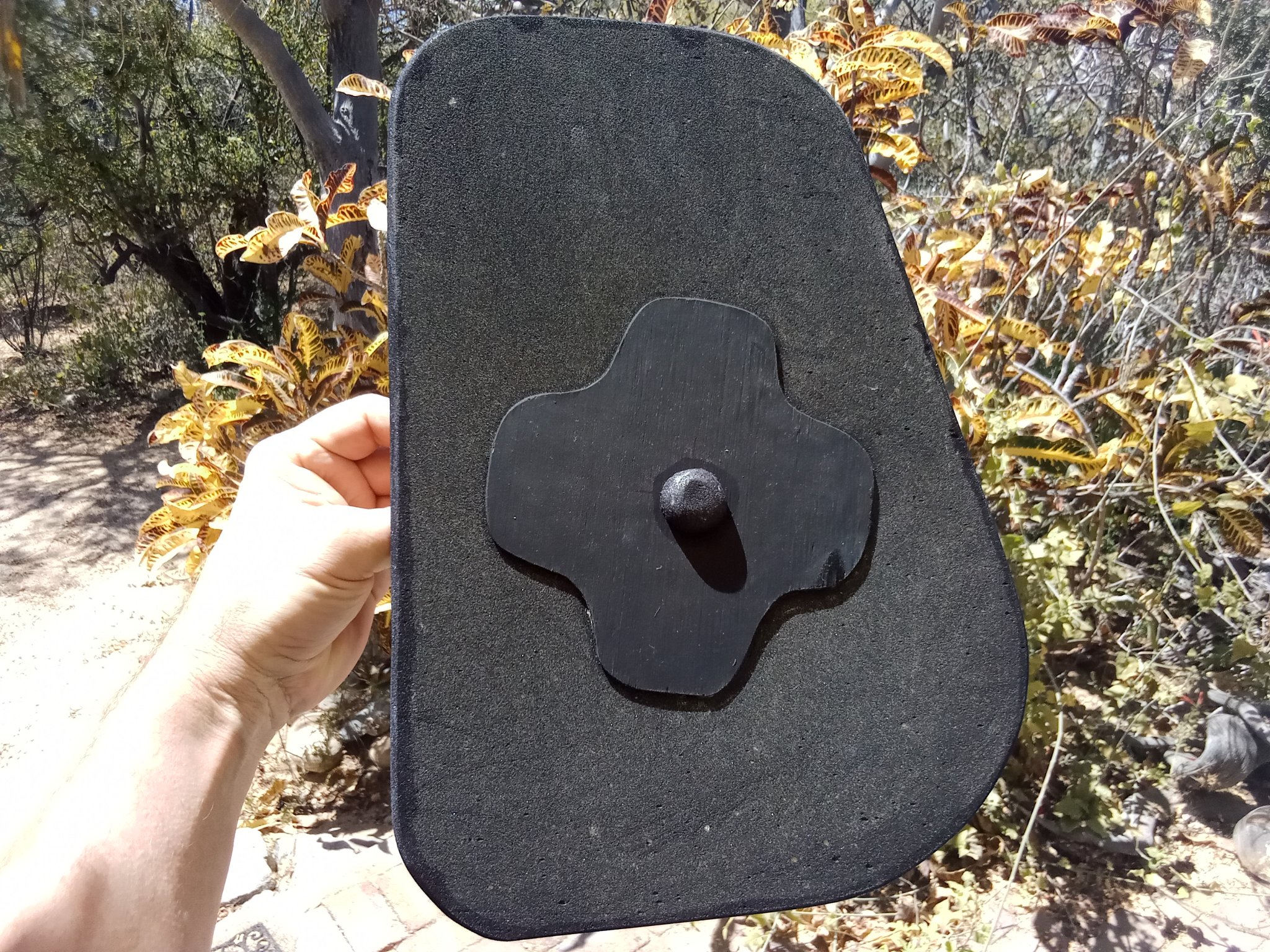

So I've re-visited these wood+poly panels I made a while back. I cut them down to 1 x 1 1/2 feet to center the wood section a little better. I super glued the window foam around the rear of the exciter to block the holes that run around the frame of the 24FHE's. The thickness of foam was also perfect to glue to the wood spine for support adding flex that I feel can't hurt when dealing with thin wood panel material to help quall harshness. The outer "arm" foam pieces are the last install that I like to use for support over time (I'll take the hit on damping).
The center "buttons" on the front are stuck on there with a double sided tape that I stuck to my pants first so they would be easier to remove later. They are made of the same poly foam as the outer panel and are there for more harshness nasties coming from the voice coil area, per Steve, I hope?. If you zoom in on the side shot you can see how I use the silver tape on the board and on the exciter mounting circle so that 5 minute epoxy can be used between the two and the entirety can be removed later. Remember to scuff both faces before epoxy.
I did an A-B test beside my pair of straight poly foam panels that I have been enamoured with for the past few months. I used those panels as a template for re-sizing these wood+foam panels so testing is pretty much equal except for the rear holes being covered which is a first for me.
My go to song for A-B testing is Eric Claptons, Change The World. Well, this just changed my world because I can hear what I've been missing in the clearness of his voice, the guitar twings, and all of the different percussion instruments used. The symbols when they come around are cleaner.
For sure the exciter being placed on the rear of the pure foam panel lost some clarity having to travel through that 1/2" of softer foam compared to the thin hard wood. I guess more "bright" is the term, nothing wrong with the poly's, these are just cleaner in my book. May get tired of them, who knows?
I haven't tried my wood-canvas panels with some of these 24FHE's yet, but this seems to be the same principle just not much bass as people seem to be getting from those (seems to be the canvas being attached all around to the frame has a lot to do with that). Now off to listen to Howard Jones , No One Is To Blame for starters ahhhh David Essex, Rock On yeah!!!!!
