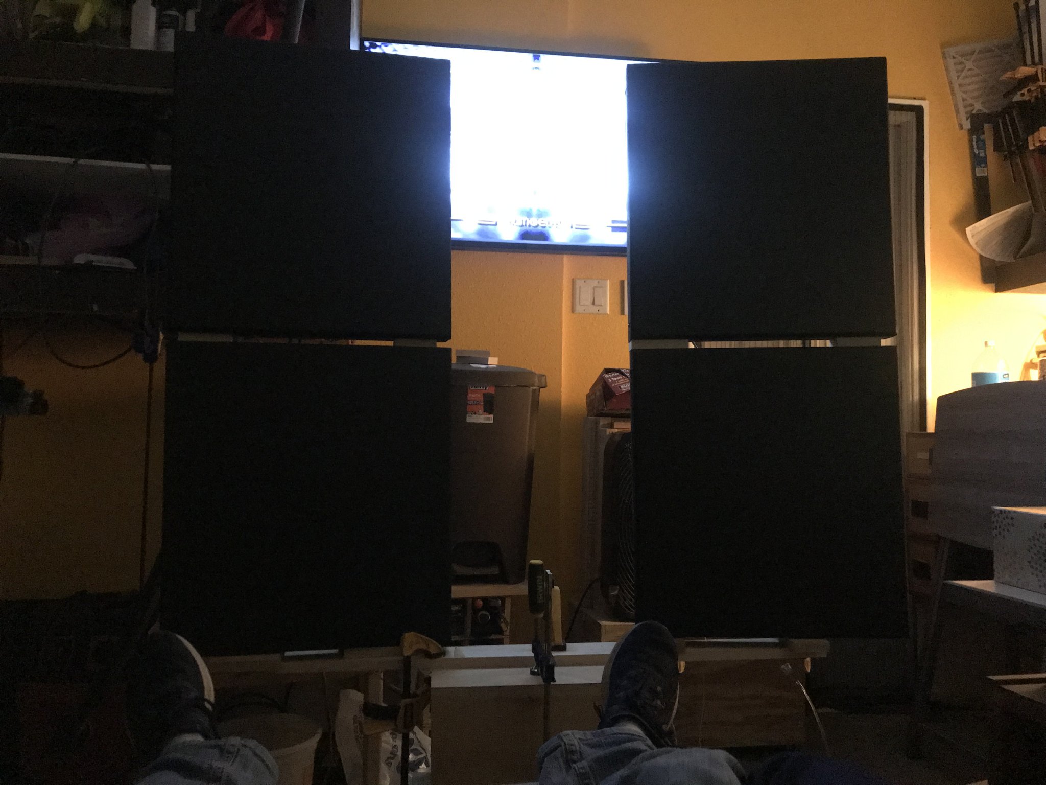

Spedge,
I didn't say I can't tell the difference, and I hadn't stumbled across your recording in this sprawling thread. My third panel is done, glue dried overnight and tested it this morning. It sounds better than my second panel (mounted), was leaned against the first panel and I had it in mind that it is a few inches out from the second, and has panel one behind it. The bass is better; or at least, thicker. So I did the test of picking it up and moving it to the wall. It definitely does make a difference, but doesn't make it sound like speaker 2. Then I dismounted speaker 2 and put (unfinished) panel 4 behind it. Speaker 3 still sounds better to me, speaker 2 is a little punchier though and at about the same volume level. I don't think there is anything wrong with it, my guess is that they are two versions of the thruster exciter, the newer version that twists off the base sounds a little better. I'll confirm that by sundown as I have a final panel to build with the newer thruster version.
So yes, distance from the wall definitely made a difference in the test this morning, I will have to do some experimenting with damping once I get other factors under control and see if a little space is worth sacrificing.

The final speaker with newer style thruster is ready and it sounds as good as it's partner, so I have a functional pair. putting them on little stands on my desk at angles from the wall; yeah, phenomenal sound, huge bass, no sub support. they sound so good that I'm going to have to bring in my (unused) floor-standing Energy speakers and compare on the weekend; or at least soon, I'm really curious. have some ideas to angle them and bring out a little.
the longer term plan has always been to either use these, or build another set that I can move out into the room and listen from my recliner and even use for temp home theater in that position.

I ordered a thruster overnight from Amazon, so I replaced the underperforming unit and sure enough, problem solved, all 4 speakers sound good, so the first test with all 4. I have a little dayton 30w driving one set and Fosi "100w" driving the other, I'll probably buy another Fosi over the weekend just to have something and then think more about amps.
It's definitely the wall of sound I was hoping for. I'm going to be doing a hell of a lot of relaxing over the weekend and listening.
I have an idea for a simple wall mount, maybe will even finish it this weekend. But the wall is secondary now after having listened from my recliner. The only bad thing about them is they block the view of the tv.
Maybe will work on getting my recording set up for a sample.
