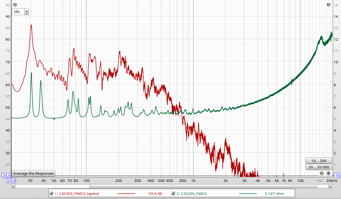

Hey, that’s neat Christian. A lot of the peaks do seem to coincide. There are fewer really big clear peaks in the tap test. Probably you would need to move the microphone around to different positions in the tap test to capture all the same natural frequencies that the impedance test picks up.@Veleric
Impedance measurement with a tap test (panel knocked at the exciter position with an eraser at the end of a chop stick).

Christian, now I’m wondering if the impedance test doesn’t also give a good way of assessing damping? It would be interesting to see if different perimeter treatments with significantly different known levels of damping result in different size peaks in the impedance test.Hello

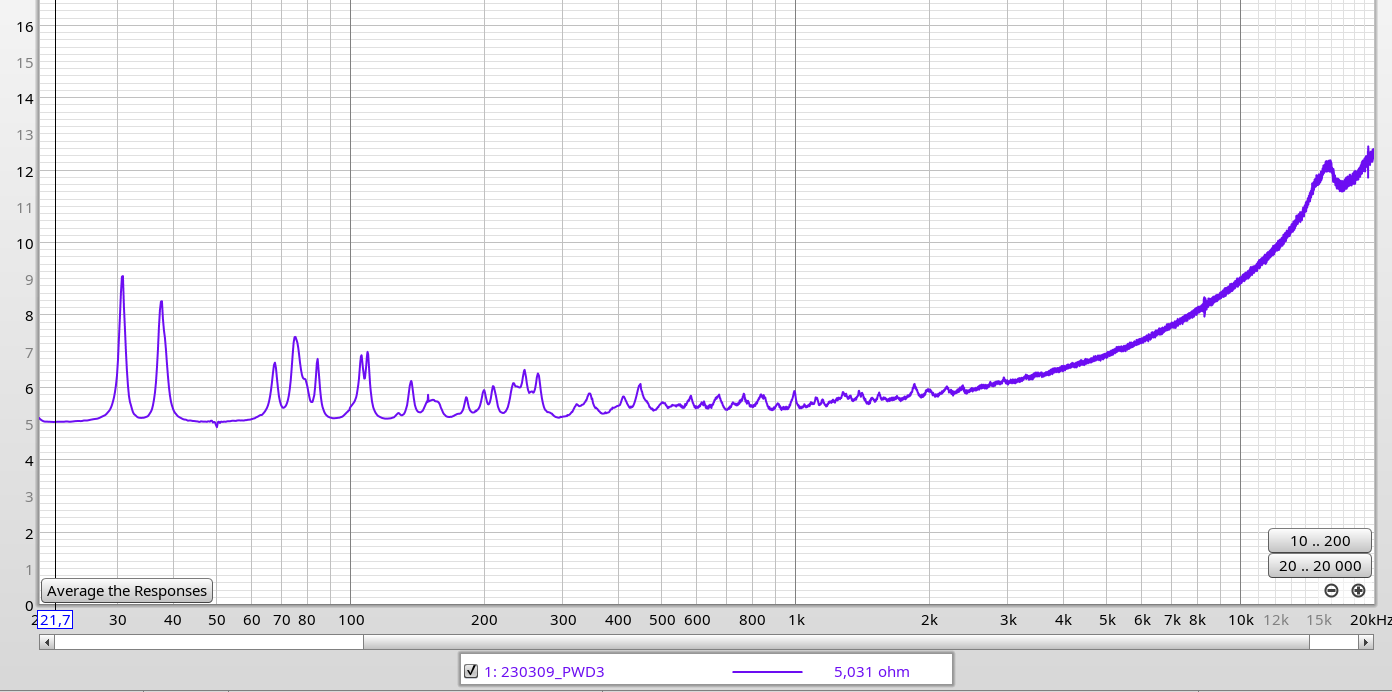

Just to share a new impedance measurement.
The quality of the measurement was improved compare to the previous one. Here the source is an USB DAC able to drive low impedance headphone (USB Audiophonics Sabre) that feeds a 100 Ohm resistor (see REW doc). The measures are sent to the line inputs of my old Audigy 2NX with a short shielded cable. The result in noise is just acceptable probably because of the 5V switching supply of the Audigy. The laptop is on its battery.
Below the impedance of one of my 3mm poplar plywood panels. No conclusion from the measurement for now. The goal was to have a set up with less noise and to have a first view of a panel impedance.
Even if the plywood is relatively heavy and damped (not so sure!), there are many "spikes" on the impedance curve where resonances are.

Hello EricChristian, now I’m wondering if the impedance test doesn’t also give a good way of assessing damping? It would be interesting to see if different perimeter treatments with significantly different known levels of damping result in different size peaks in the impedance test.
This my expectation too to get damping data from the impedance. At the peaks, spring and inertia (mass) effect compensate each other, the damping makes the heigth of the peak (over simplified). I am working on that.

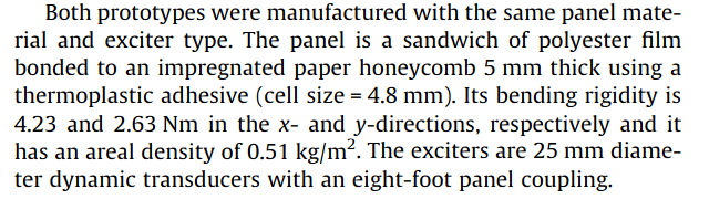

This paper is probably also among the ones showing the best membrane characteristics (bending stiffness, areal mass, FR...) : light, stiff but not too stiff, orthotropic. Does it inspire the most skilled of us in material?This paper discusses multi exciter equalisation - equalisation of the whole panel proved unsatisfactory, so they resorted to equalising each exciter.
https://www.researchgate.net/public...xciter_distributed_mode_loudspeakers/download
What is "an eight-foot panel coupling"?

Christian, they don't show photos, but I assume each exciter has 8 frog legs to mount to the panelWhat is "an eight-foot panel coupling"?
