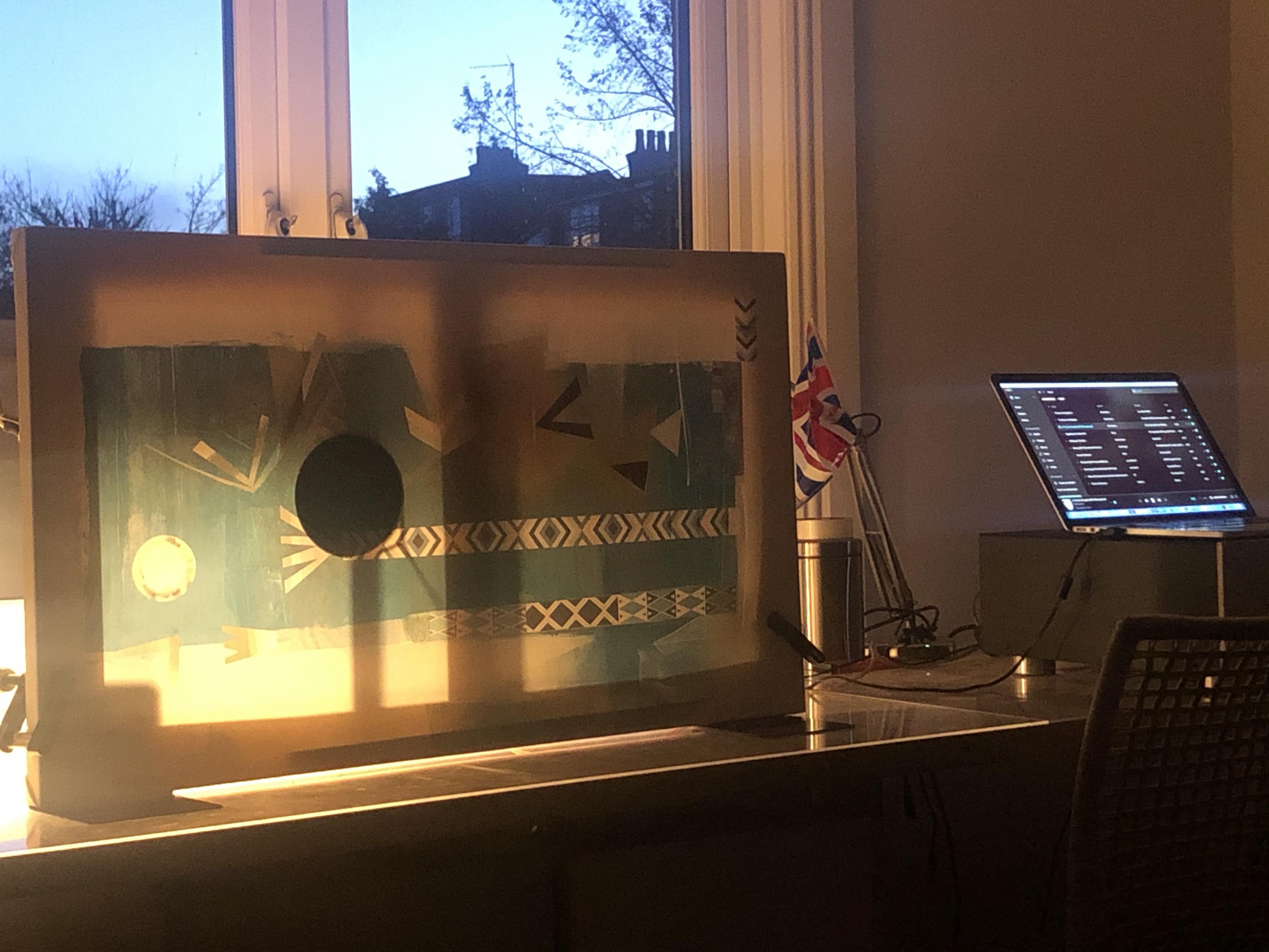

Canvas experiments.
So as the sun was going down on Great Britain

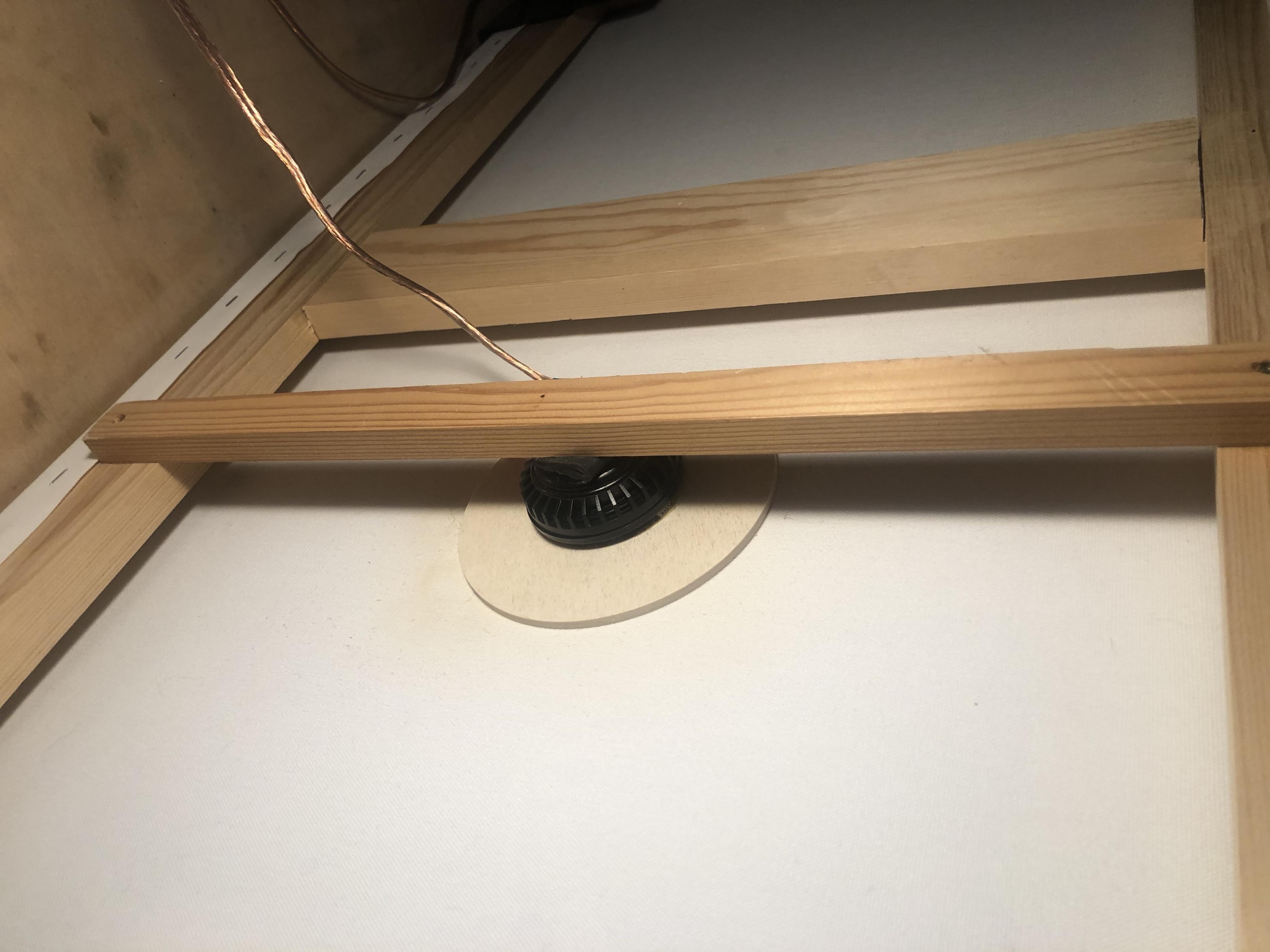

... for what feels like the last time, I thought I would try the canvas frame technique and share thoughts. I had a print I was given by an artist that I was not to keen on, his other work is great and I have bought a lot from him, but this one is not his best. I had to hand an exciter and about an hour so gave it a try. I fixed the exciter to a brace and used a 120mm ply disc as per the recipe.
First thoughts are:-
All the DML benefits are there, lots of clarity and attack, pretty smooth response similar to my ply panels, very engaging sound.
You get bass! I measured it down to 40hz. This is recessed compared to the midrange but this was just a first try so any deficiencies are down to me.
Your frame and brace needs to be well built and attachment to the exciter need to be solid. A lot of energy gets passed to the frame and I had some buzzing and rattles when I turned up the power. How much energy? Well the frame started ‘walking’ across the table on really bass heavy tracks e.g. Basshead from Far East Movement.
The canvas needs a good tension to perform well, I used inserts between the frame and the canvas to increase the tension and I got best results with a taught canvas which sounded 'drum-like' when tapped with a finger.
So its a very promising method and I look forward to exploring it further

@ BurntCoil..
I would suggest filling the gap where the canvas meets the frame on the inside to get rid of most or all of the "Buzz" problem. The frame is chamfered to the outside to avoid putting an impression in the canvas of the inside edge of the frame. A healthy bead of clear silicone sealer around the complete outer edge inside the frame where it meets the canvas works great and it isn't seen from the front. Just be certain the silicon sealer has good contact to the canvas and the frame..
I had an issue with the outer edge of the circle. A small bead of silicone sealer around the outer edge resolved it..
