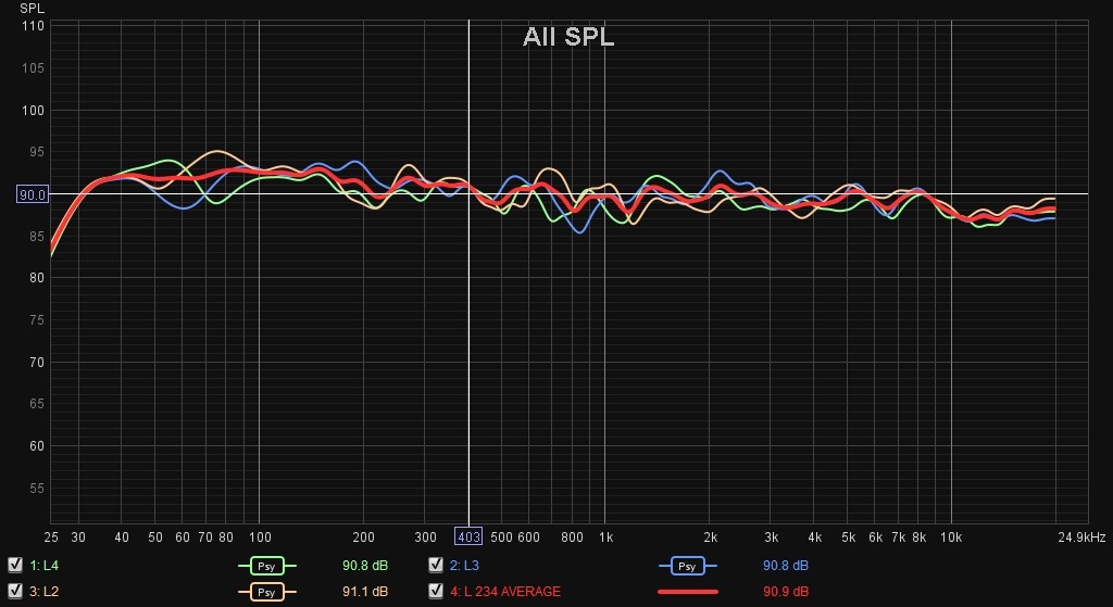

The importance of multiple measurements.
Thanks to Steve's suggestion, I did some measuring at different places in my general listening position, a two seater couch. With mic placement in three different positions (about where my head would be), there are three very different response curves. Averaging them out seems to be important in not being overly influenced by a single reading when doing active EQ.
The image below shows three readings and an average (thicker red line).
Thanks Steve.Lordtarquin.

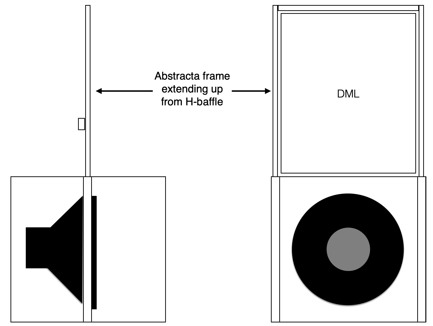

For an an earlier effort, I used an H baffle with an Abstract frame on top of it (see attached sketch). One could freely hang a DML panel from the top of the frame or use one of the Abstracta clip solutions to secure the panel (with foam between clip and panel).
One could also (if required) use a cross bar to support the exciter.
Lots of options. Easy to assemble.

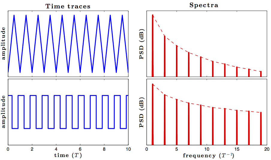

lordarquin, On your post 8903, do you have the distortion curves for the equalized FR response curves?
It would be interesting to see what a swept triangular wave would produce a FR with the same equalization settings.
The reason for this is a triangular produces more harmonics than a sine wave an is better than a square wave on the transducer.

In my initial design (it was pre-Covid!) I had a rather ungainly arrangement which allowed anything from minimal 'hanging' to quite close coupling with the frame. On balance, I found attaching the panel to the frame gave the best results. I always seemed to end up with bits of the panel distorting quite badly with the simple hanging arrangement. Those panels were 400 x 550mm or thereabouts, either 3mm poplar ply or EPS.For an an earlier effort, I used an H baffle with an Abstract frame on top of it (see attached sketch). One could freely hang a DML panel from the top of the frame or use one of the Abstracta clip solutions to secure the panel (with foam between clip and panel).

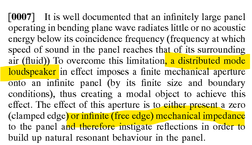

Many so-called gurus had misdirected the people, by making them believe that the free hanging, rectangular panel with unsupported edges as the distributed mode loudspeaker (DML). Only, that was just the membrane, but not the distributed mode loudspeaker (DML). Just like the cone of the conventional speaker driver. Cut the surround off, and you'd hear the difference.
But, that rectangular panel becomes a distributed mode loudspeaker (DML) only when it covers certain criteria, the most basic being,
The above information is for us newcomers and for those, who are still thinking of making a distributed mode loudspeaker system. NXT had more than 40 scientists and engineers working there, some of whom later moved to Tectonic Labs together with the NXT intellectual property. There's absolutely no reason to reinvent the wheel. You don't really need to make large radiator panels, you can even make an efficient one of A5 size! The recipes are given in those patents and in a few more.
Anyway, the idea is to make a distributed mode loudspeaker, but not an uncontrollably wobbling, flapping sheet.

But, you'd never find any mention about a bare radiator panel (a bare sheet) freely hanging from strings, or about an unsupported panel anywhere in it, or in any other patents, for that matter.
As it turns out, even Azima viewed a free edge panel as a distributed mode loudspeaker.
From this patent:
https://patentimages.storage.googleapis.com/ea/0e/93/9583fcf9a1db27/US20020044668A1.pdf
