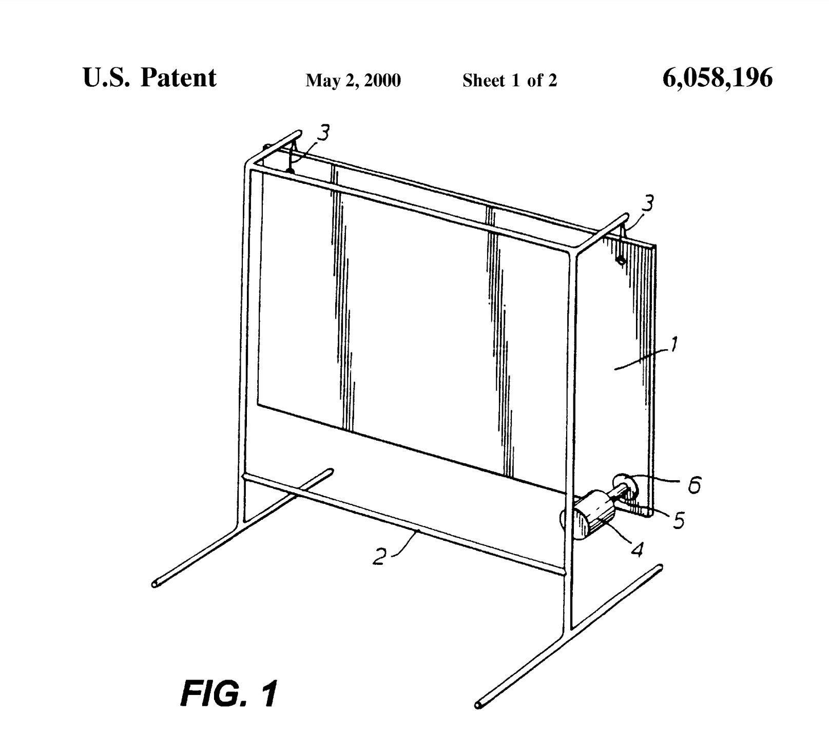

All this is from that NXT patent.
The first point reminds me of the 'under damping' of the Göbel patent.
Reactions: lenta
But, you'd never find any mention about a bare radiator panel (a bare sheet) freely hanging from strings, or about an unsupported panel anywhere in it, or in any other patents, for that matter.

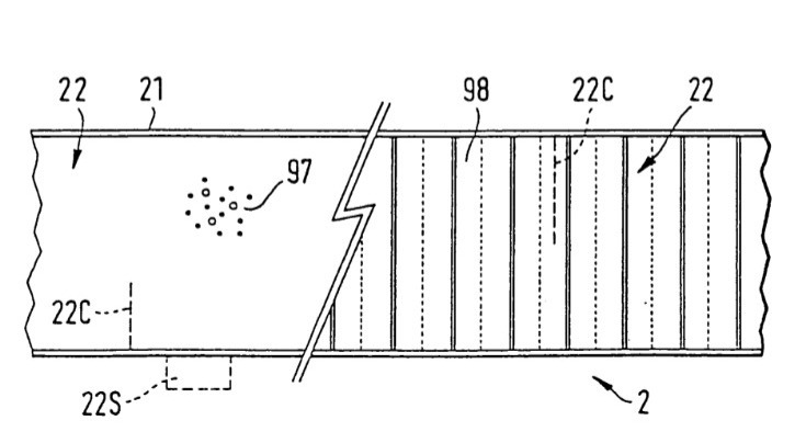

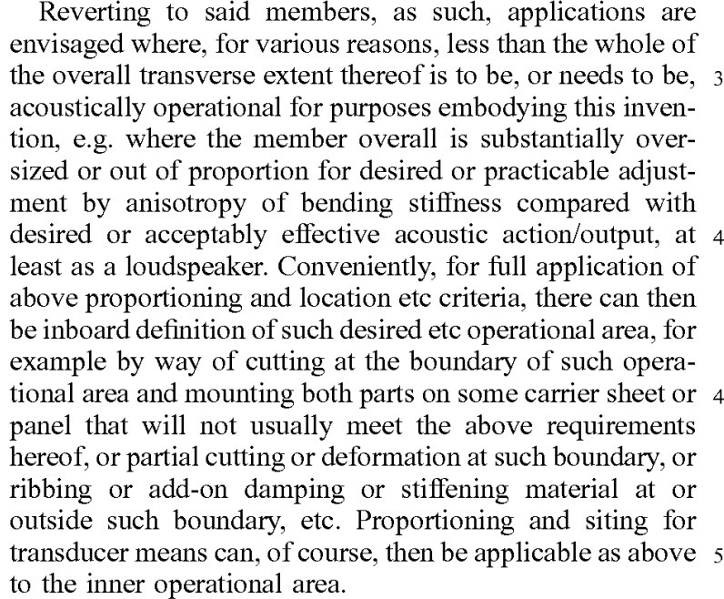

And, further on damping...and cutting...
Other measures, indicated dashed in figure above, include cutting partially (22C) into the core (22) through one skin (21) or adding damping or stiffening material/members (22S) as inner framing at least partially about the intended operative area, thereby reducing some of preferential size for the panel member structure concerned.
Two materials are shown here, to illustrate the idea.
The radiator panel is a rigid lightweight laminated sandwich-type panel having a core (22) e.g., of rigid plastics foam (97) or cellular matrix (98) such as a honeycomb matrix of metal foil, plastics or the like, with the cells extending transversely to the plane of the panel, and closed by opposed skins (21), e.g. of paper, card, plastics or metal foil or sheet.

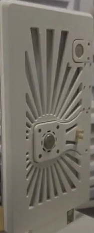

I'd have made the radiator panel about 560 mm x 360mm, so the whole loudspeaker would become about 600mm x 400mm, and about 50-60mm thick. Would be compact and probably hi-WAF. But I won't go for the grills. The back will be completely covered and damped. Maybe some bass-reflex holes on the side. Or, maybe use the golden ratio 1.618, they say pleasing to the human eye. 🙂 Fixed on the wall like a picture. NXT was talking about shallow enclosures. #8,733

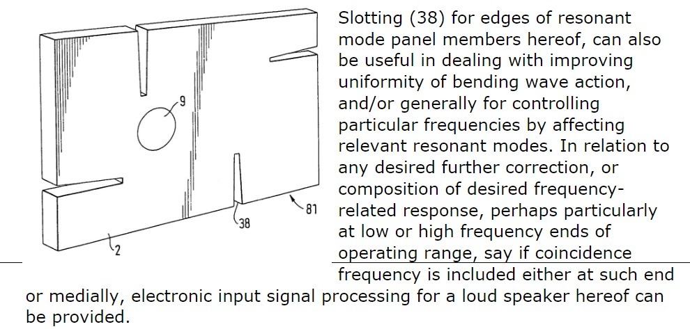

Here's another mention of cuttings (it is in the patent I linked)
It is a NXT finding. I have no knowledge of the scientific reasons for that, except what NXT says. 🙂
Thank you, this is the one I found in the patent you linked. Have you seen other places mention of cuttings?

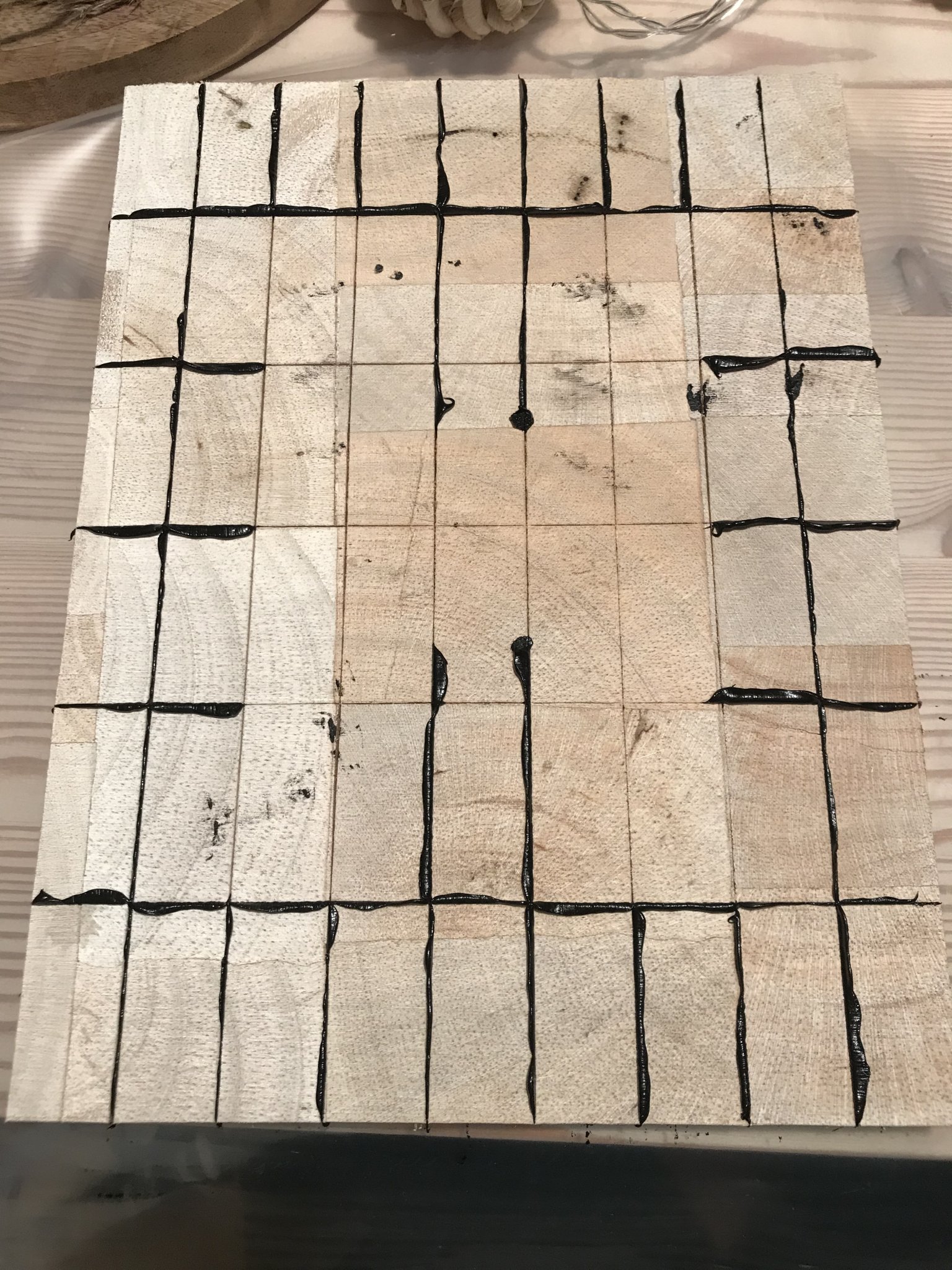

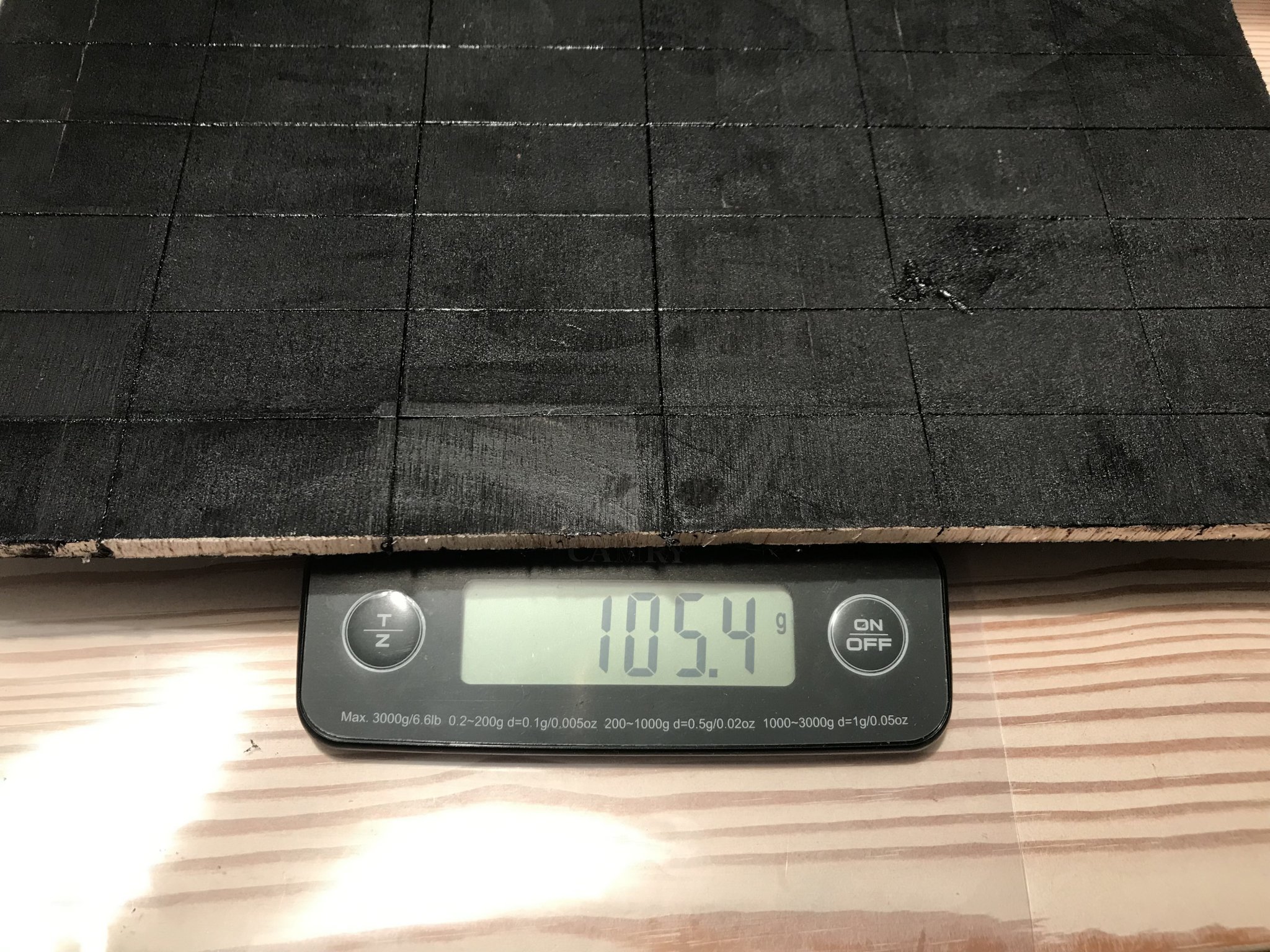

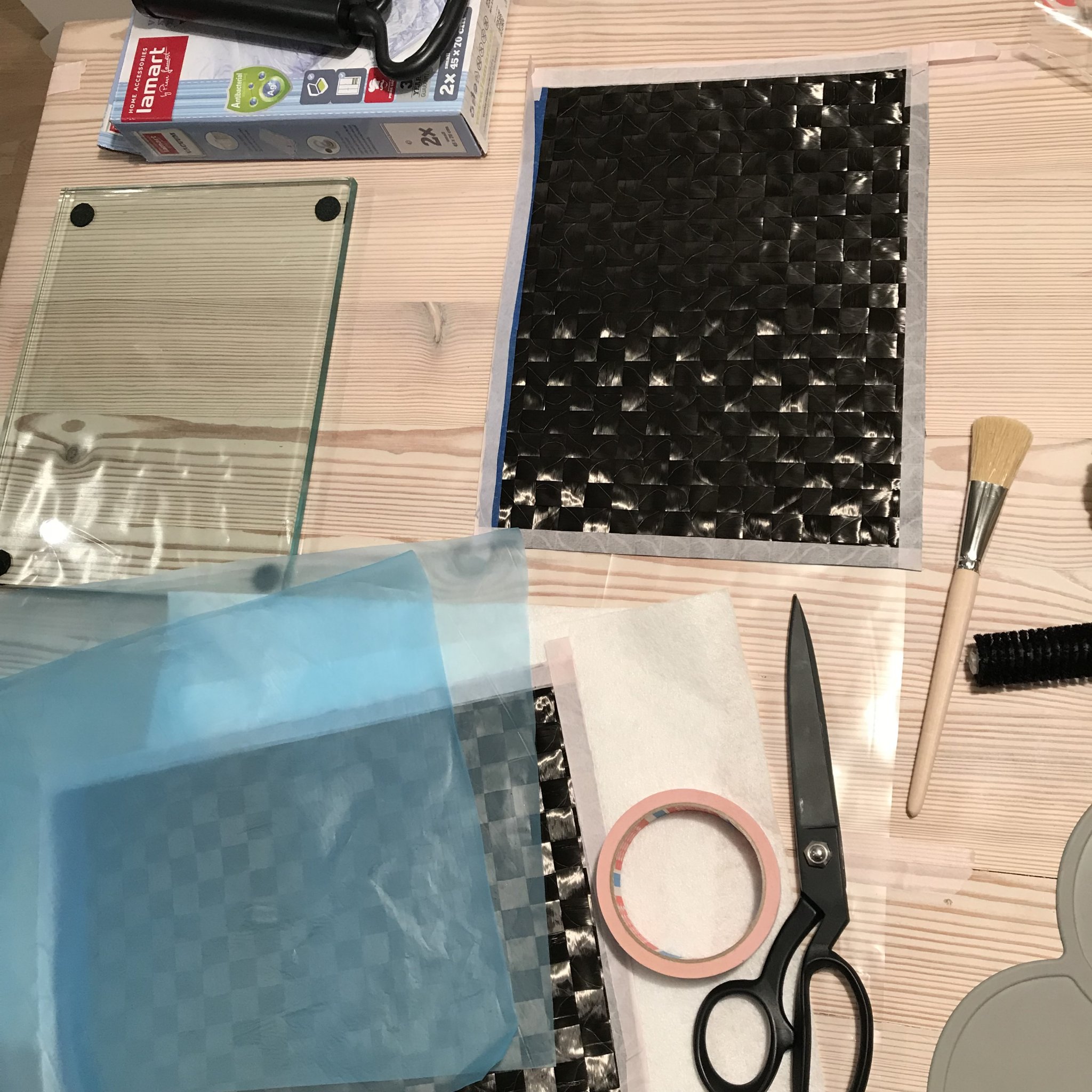

I filled grooves and cuts with polyurethane sealant. On another panel also sealed the end grain balsa pores with it.
