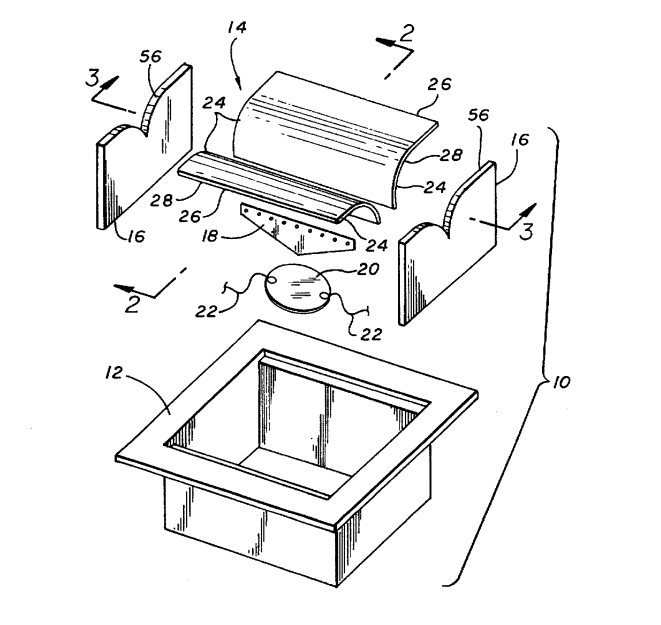

and, here is Paddock's patent image in March 1998.
Anyway, both are interesting, as they are curved DMLs. Only the similarity is uncanny, even after 69 years!

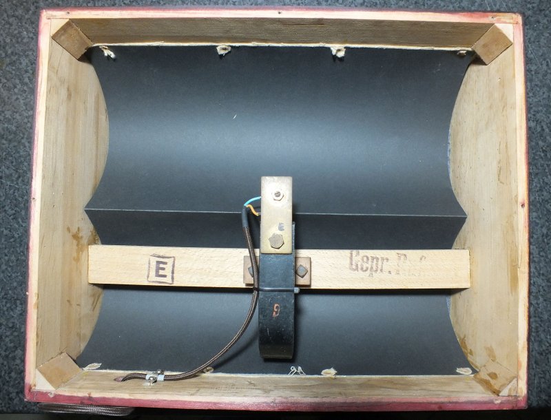

Few more images of insides of an Arcophon, the 1924-1929 folded panel DML.

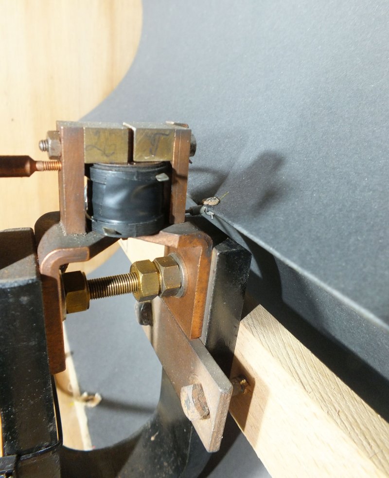

A point transfer of sound to the edge of the folded curved panel. The U-magnet is below the central line, and the coil is above the end of U-magnet. The sound transfer point is on the bottom plane of the coil. Wish I could find some technical info on this intriguing vintage machine. A Linny before Haddock was born!

The paper diaphragm in the pictures, looks very new to me ?
Damp conditions in lofts and sheds are usually the most damaging things for old cone paper speakers and the like.
I should think that the exciter armature moves very little and may even move up and down instead of back and forth?

For now from the pictures, I can't figure out out this exciter is working, what is it architecture.
@chdsl : from the data you are collecting, can you make a schematic showing how the Arcophon motor act?

I can't either, so I am still searching for details. The steel structure is too stiff to vibrate, and at 180 degrees to the magnet. The steel spike reminds me of the gramophone needle.Good question Steve.
The 2nd video in #7,601 shows another working speaker, but only the front. The bent panel is fixed stiff along the perimeter. I have never seen one. Also, I was so surprised finding this Arcophon speakers in the internet. Well, the sound waves travelling in a panel, and curving even amplifies it was there all the time in the past, even before the cone speaker was 'found', even before Haddock or the French guy were born. Their 'invention' could be the bottom part of the transducer, rather than the top part, that is, the bent curved panel, membrane. Linaeum simply died, and Rubanoide didn't even make it commercially.
