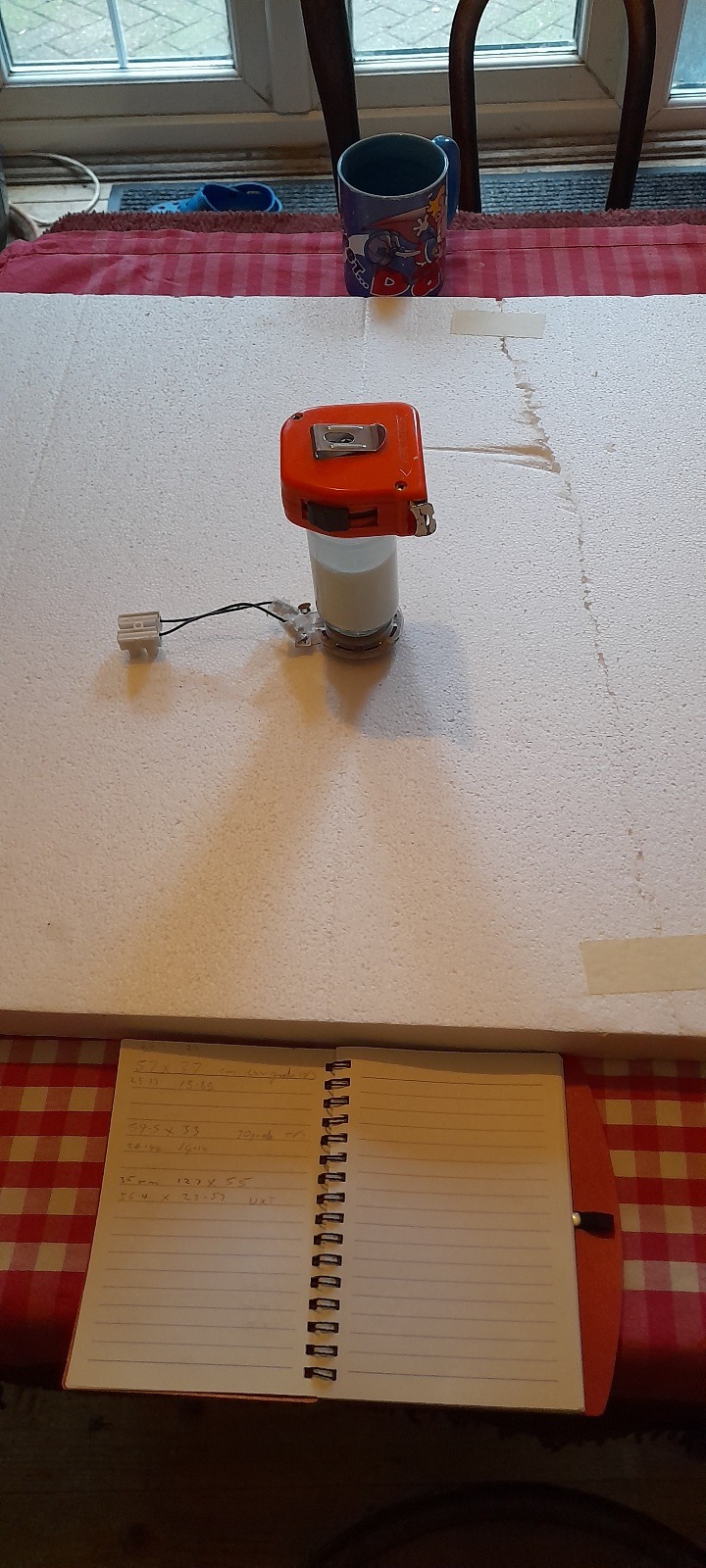

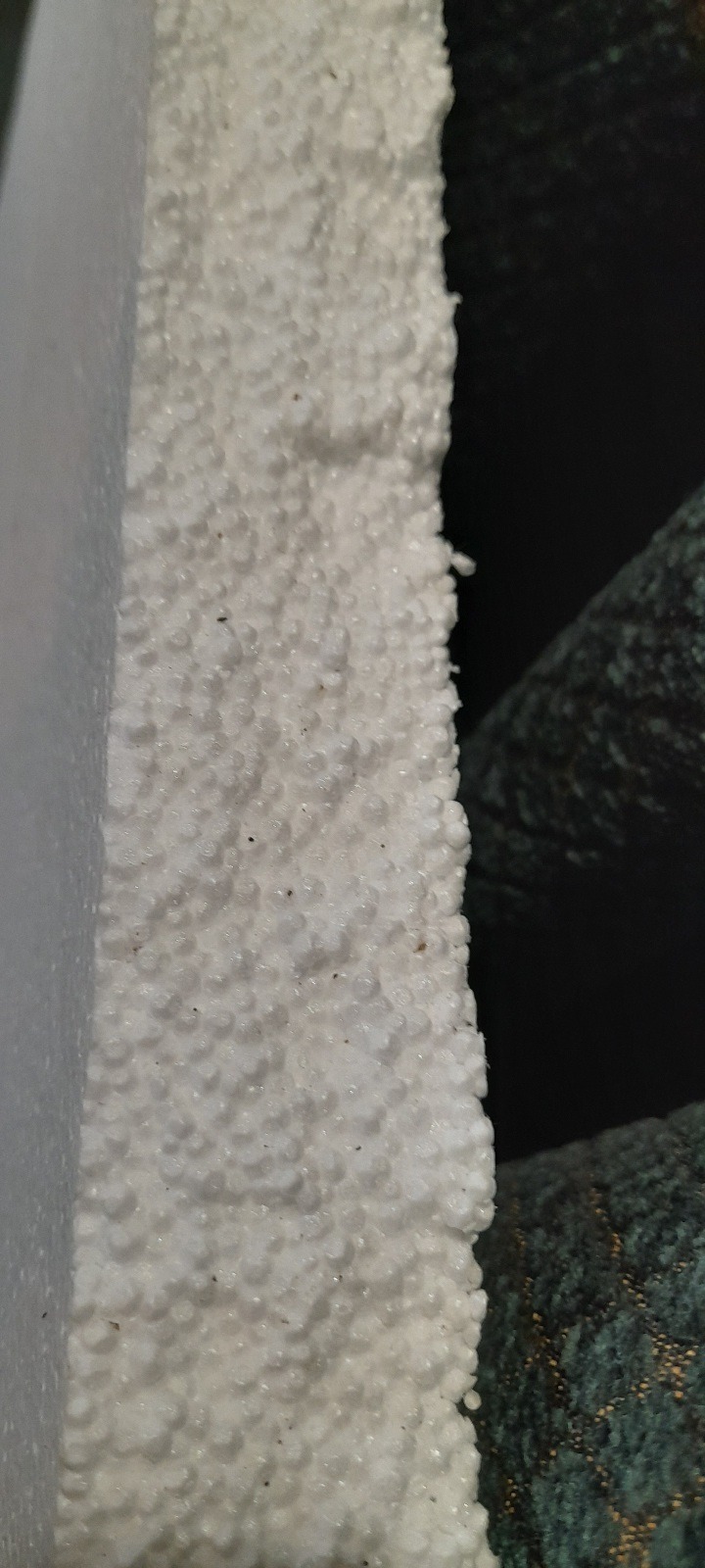

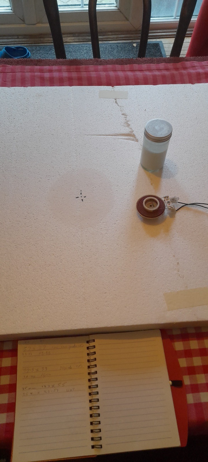

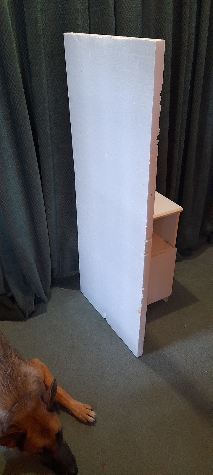

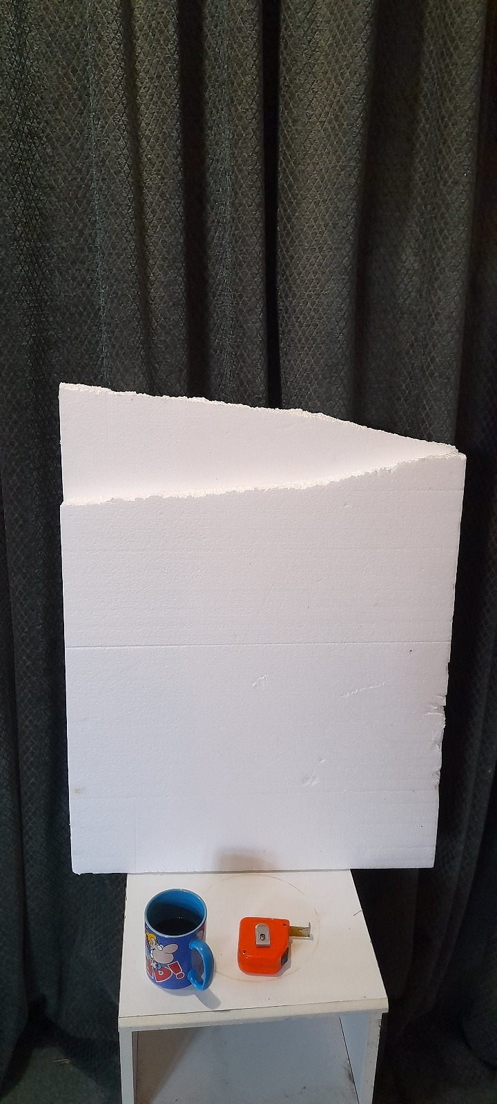

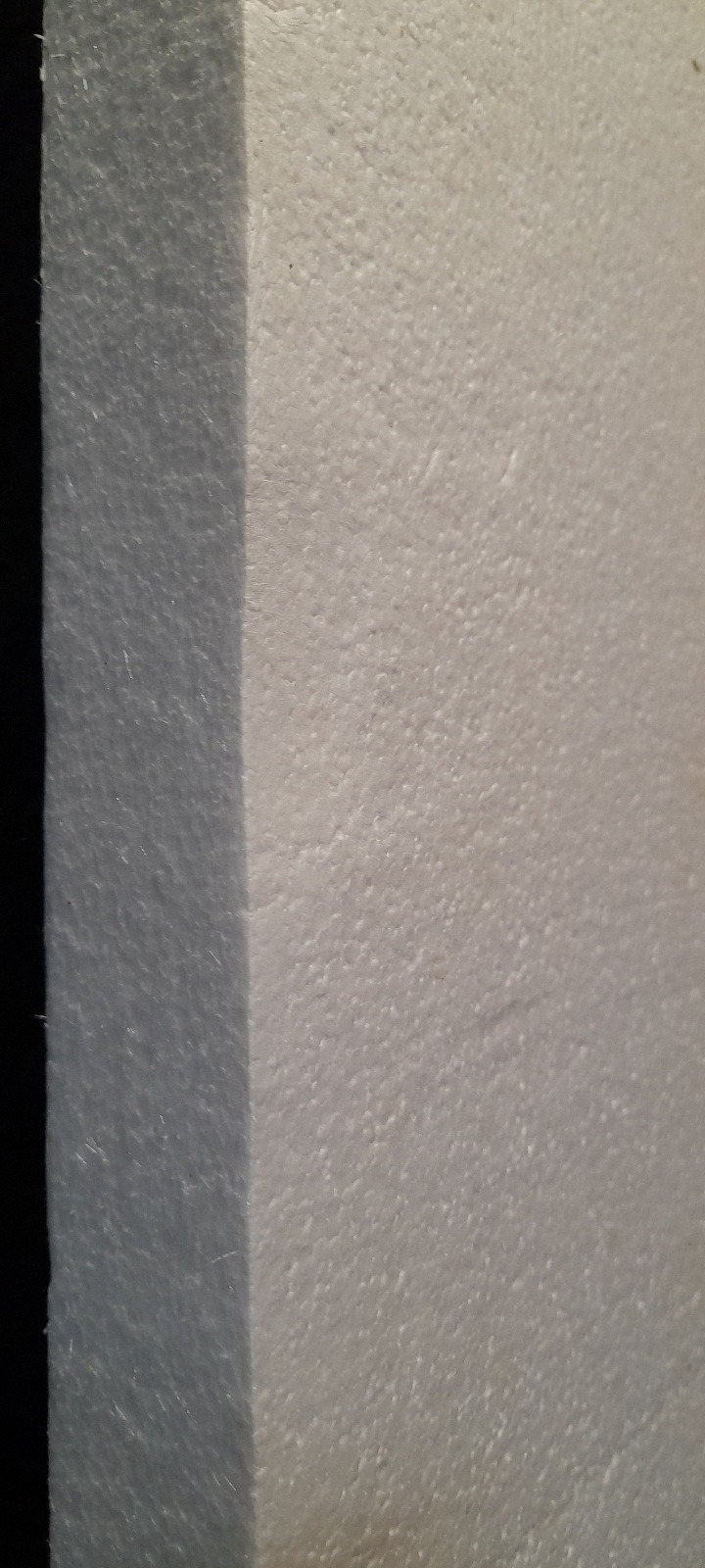

Oops again, I forgot the pictures, too many distractions.This is a EPS panel I found a couple of weeks ago in a skip.
It has been drying out after all the rain we have been having.
I was going to make two panels out of it to compare with the proplex.
But I think I might first glue the two halves together for a 127cmx55cm x35mm panel and see what I get.
It is not a high density EPS but it does have small tight beads.
If you zoom in you can see them.
It will be interesting to see what the hf will be on the raw panel and then with some of my tricks.
Will there be a difference?
What works on my 5mm EPS might not work on the 35mm.
I do have a 50mm panel in my loft but I felt that was a little excessive.
I intend to get back to my roots and build my final EPS panels, the ones I will use permanently in my room.
Steve.
Steve.

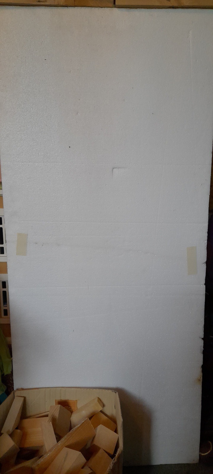

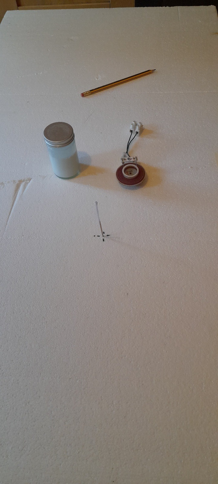

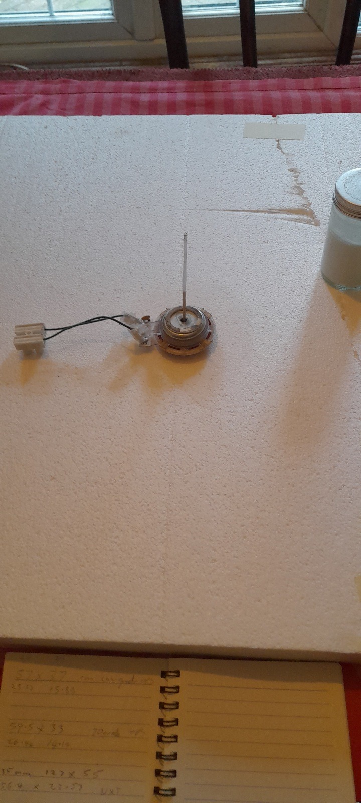

Pic 1
The small EPS beads inside the panel before applying 50x50 mix PVA.
Pic 2.
With a good splashing of PVA.
Pic 3.
With masking tape holding the panel tightly in place, with wood blocks on top to help.
The kids are coming over this afternoon , so I don't hold out much hope of the panel staying in one piece 😳
Steve.

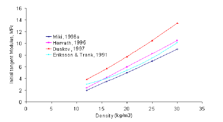

The range of density seems standard.
If I understand the compressive stress is the limit in compression of a material while the young modulus describe the elasticity in the linear region which is what is involve in plate modes.
I search a little bit and I found some papers showing a linear relation between the density and Young modulus.
See the example below from Selected Engineering Properties and Applications of EPS Geofoam
This kind of papers are about EPS Geofoam. Do you know if it has specific properties compare to what we can find?
By the way, it is consistent with what I have in my notes : about 5MPa for a 15kg/m³ EPS. There is an important dispersion.
We could start from a simple relation like E = rho/3 E in MPa with rho in kg/m³ or more optimistic for the high density E = 2.rho/3 -5.
We'll see where it leads.
More data will be need as the coating change the characteristic. Coating add mass. I measured 0.06kg/m² for the EPS above changing the areal mass from 0.3kg/m² to 0.36kg/m² with 2 layers of coating on both sides. Is it thin, thick... no idea, no reference.
It changes also the bending stiffness which can be translated in E changing from 5Mpa to 8Mpa (big impact!)
I would like just encourage again to have more density or areal mass measurements but also bending stiffness or Young modulus estimations. 2 methods were shared here : 3 points or tap test.
Christian

First picture shows the area around the exciter I coated in thin mix of PVA .
The second is the cocktail stick and tube I use to slide the exciter into position , I also use this to make holes in my panels.
Third picture is with the exciter in position.
The fourth is with a little weight to push the coil into the EPS a little, for a good bond.
The panel join feels pretty strong now , but I shall try and restrain myself from listening until tomorrow ,if I can 🤗
Steve.

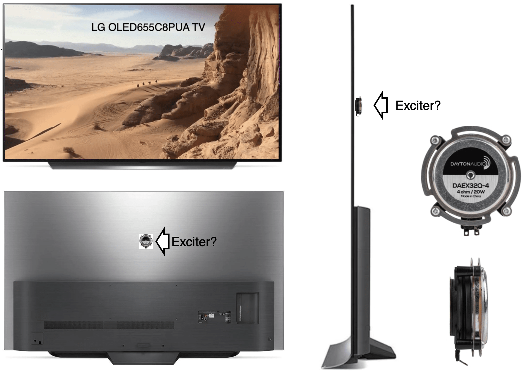

Some of the current discussion on this thread re: cantilevers and my wife flying to Toronto this afternoon, leaves me some time to experiment this weekend.
Please advise if you think this experiment sounds nuts.
I've spent a lot of time with my new set of Abstracta frame + 3mm baltic birch DMLs that I have on either side of my TV.
I've now started wondering about adding some kind of center channel to help clarify voices particularly in films.
I've got an LG TV (see attached image). The side view shows how its screen (some kind of plastic/acrylic) cantilevers up from the its base.
The freely cantilevering area measures 57" wide x 19" high (3 to 1).
I've got an extra Dayton Audio DAEX32Q-4 exciter.
Can anyone recommend a temporary (easily removable) way to attach the exciter?
And again, please advise if you think this experiment sounds nuts.

What goes on before?
Eric
aagas.
Does your TV already use exciter technology?
I have no idea if magnets are OK with tvs now days?
Is that sheet metal at the back or plastic?
Steve.
Steve.
