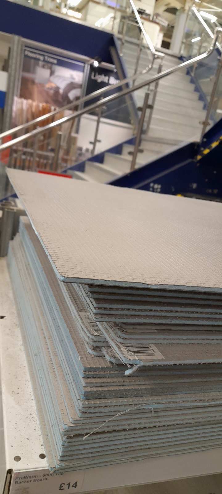

I was looking through my photo album and came across these pics.
The first is a material in wickes I bought years ago, except this is a 5mm panel.
Mine was a 1cm panel and much more rigid.
This one feels more flexible and would be a better option, the 1cm panel had a very hard sound to it that I did not like.

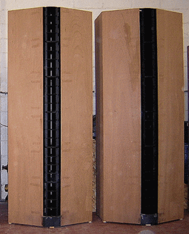

I mentioned this long ago in this thread. Harold Beveridge had his speakers set up in his home to the sides of the listening area. Left and right of someone sitting in the center of the room facing the listener's ears.
I spent an after hours evening at the old Stereo Exchange on Broadway in NY back in the 1970's where a group of us tried the same configuration.
Pretty amazing. At one point in the evening we set up a subwoofer in the center of the room, sat on it and listened to the Beverages. Even more amazing! (We also tried sitting of the sub woofer with Stax headphones).
