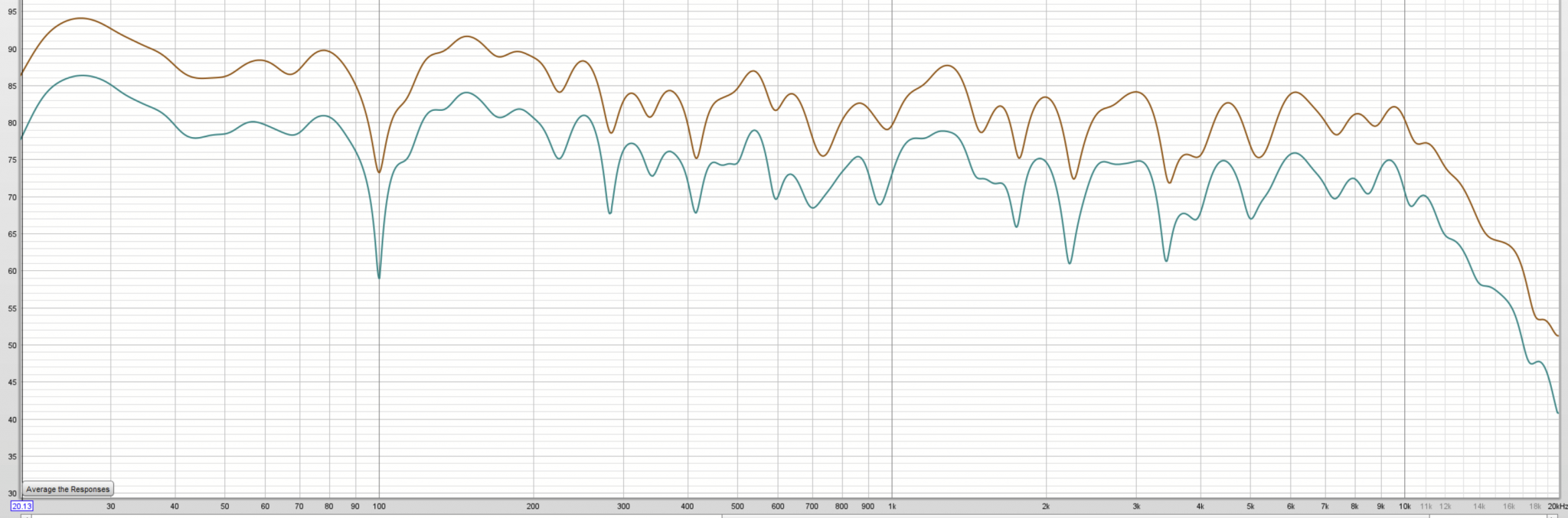

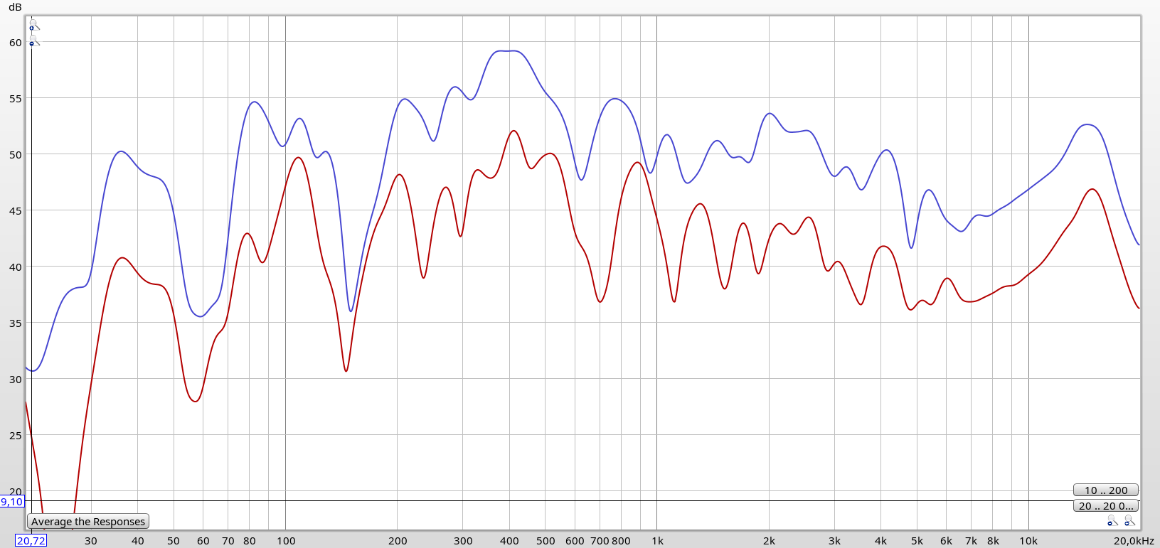

Ok, finally some noteworthy update.
I received my UMIK-1 microphone and I could not wait until the final missing exciters arrive and decided to do some testing with the other 4 exciters, that I already have.

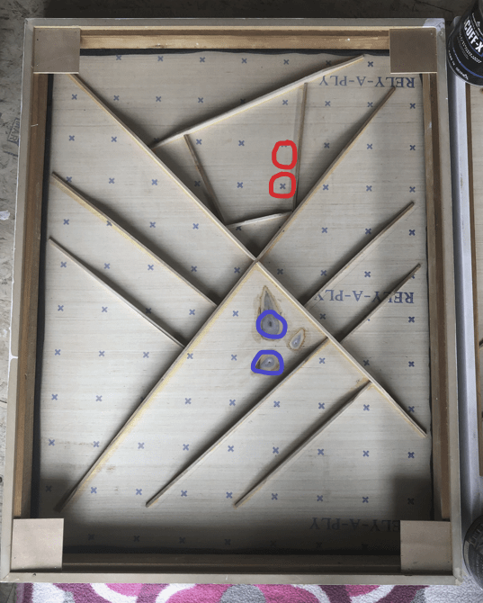

So, the setup was like this;
Two guitar braced 3.2x4ft rev ply panels with exciters in different positions for better comparison.
Panel 1 had the two exciters on the blue markings, which are two of the epoxy filled carved spots.
Panel 2 had the exicter at the red markings, where nothing was done to the wood surface.
I have never done something like that before and forgot during the first test to upload the calibration file for the microphone,... therefore I have no idea how reliable the following picture is.
all following graphs are done with 1/12 of an octave smoothing,.. I hope that is ok/standard here?

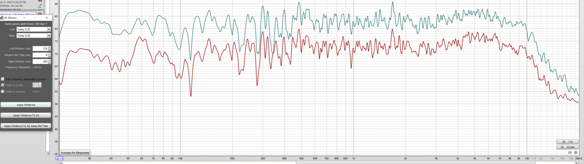

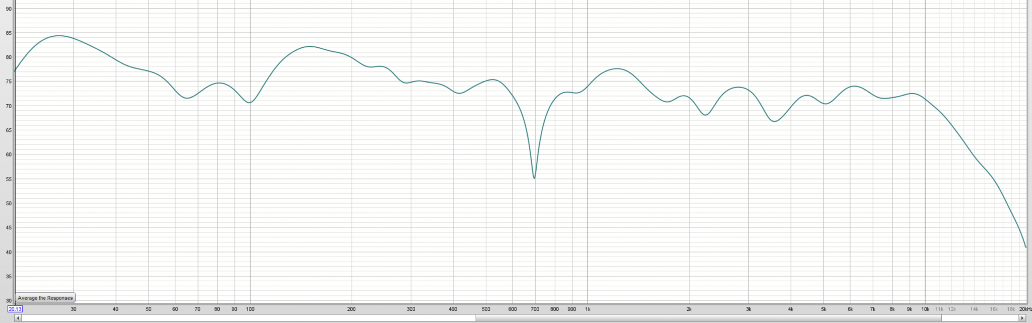

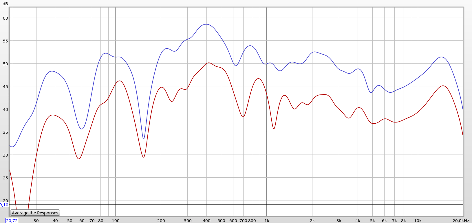

I placed the mic 40cm from each panel and did a sweep and tried to compare the positioning of the exciters on both panels. (pink curve, is the red exciter position, and red curve is the blue exciter positions). The subwoofer on the ceiling was turned off.
This was truely a surprise and my first thought was : "What a waste of money for the subwoofer i just built for these panels".
Then I installed the mic's calibaration file and dabbled a little and thought that it might be more representative to record 2 meters away from the panels.

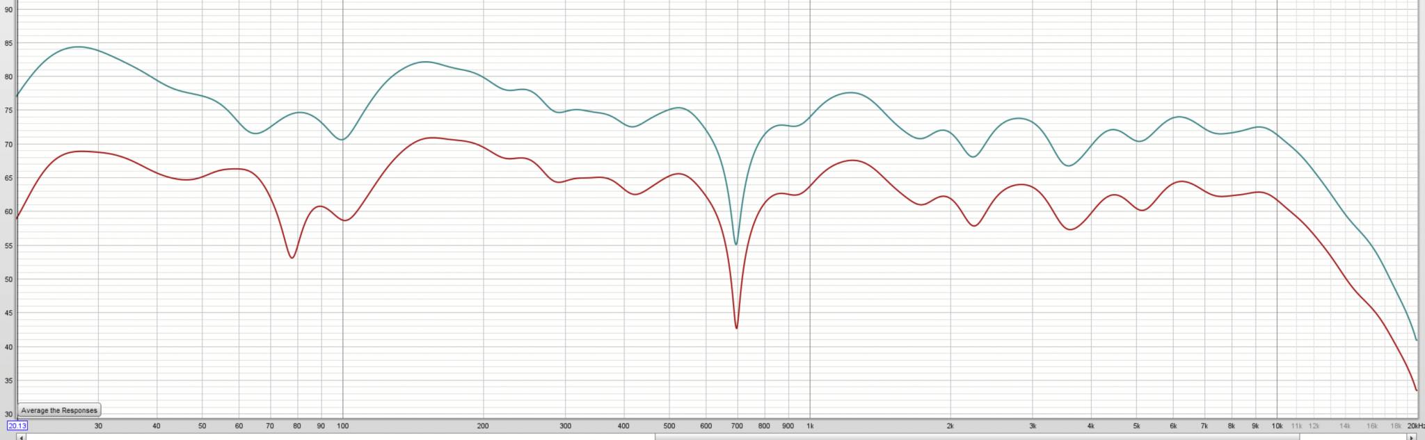

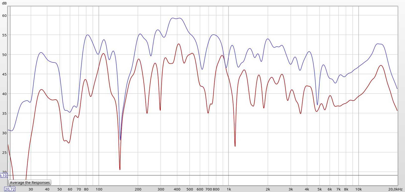

Meanwhile I had also noticed the resonances in my room and prepared to put foam sheets behind the panels to avoid backwall reflections.
The result was as follows.

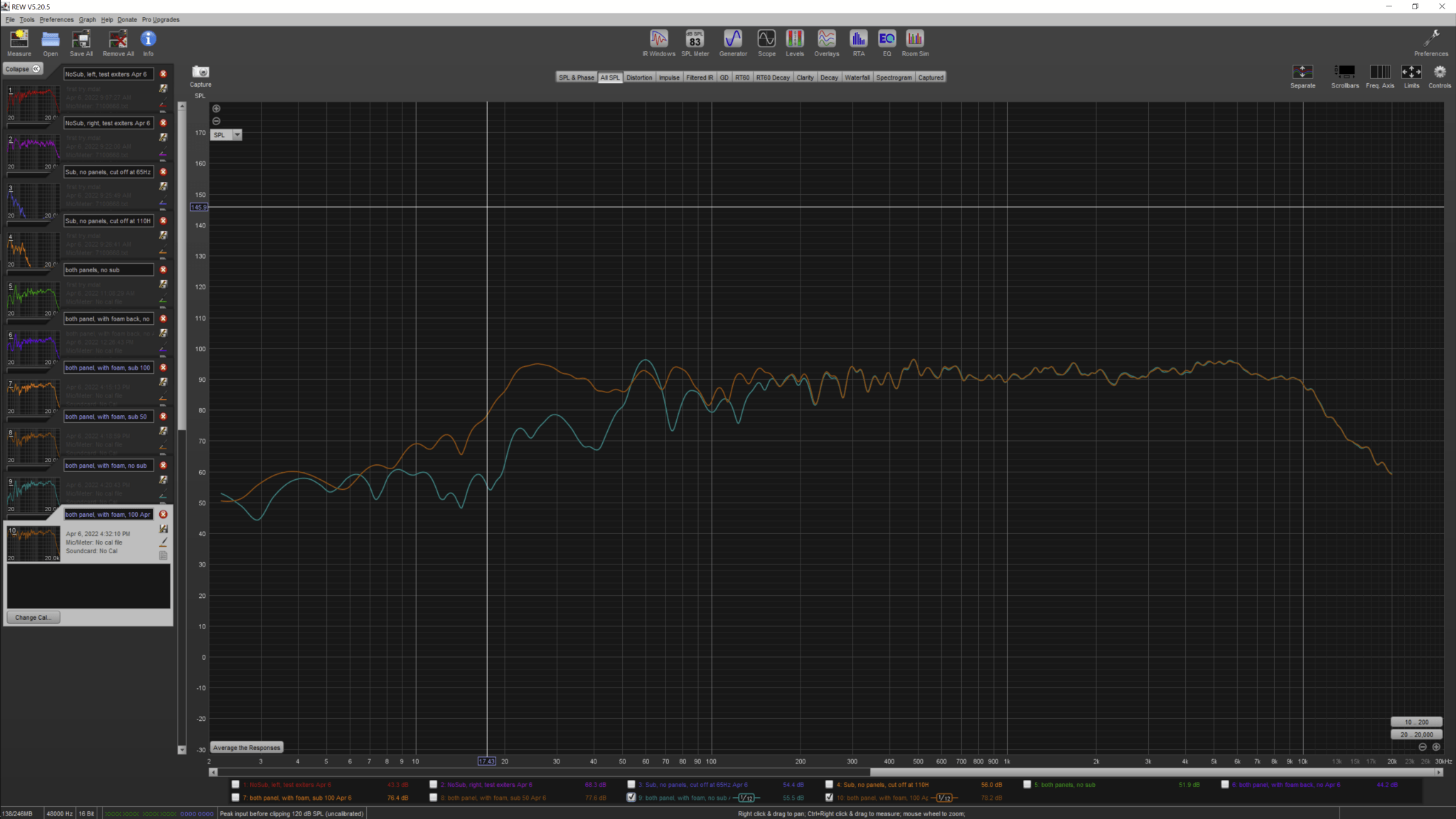

Here, both panels on, green without and purple with 1 inch of foam with 4 inches distance from the rear panel surface), mic 2 meters away from the panels, subwoofer off.
Unfortunately, the volume knob was not identical to the above test., but you get the idea, I moved away from the panels and the bass response dropped.

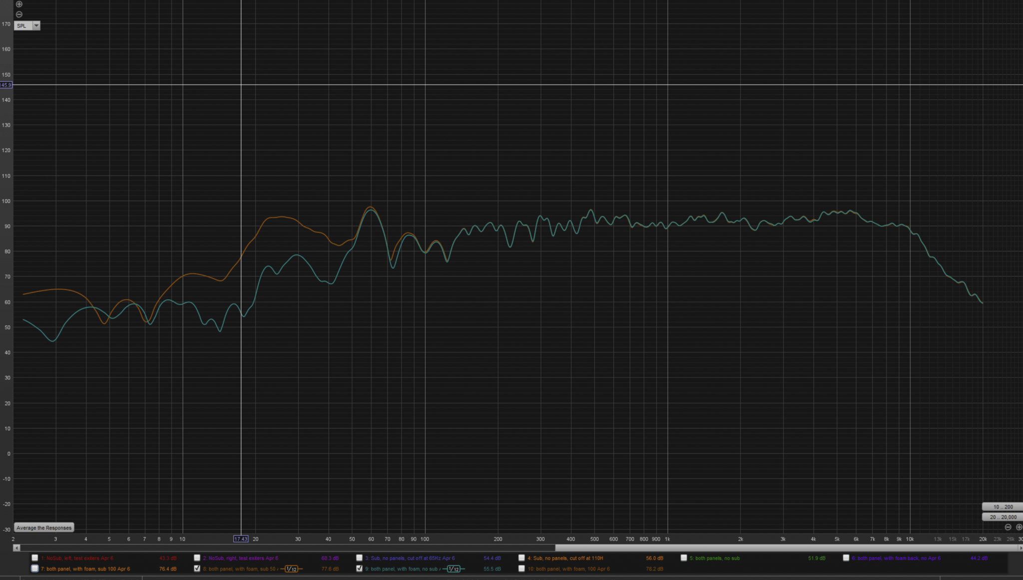

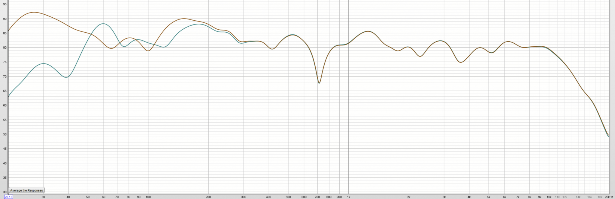

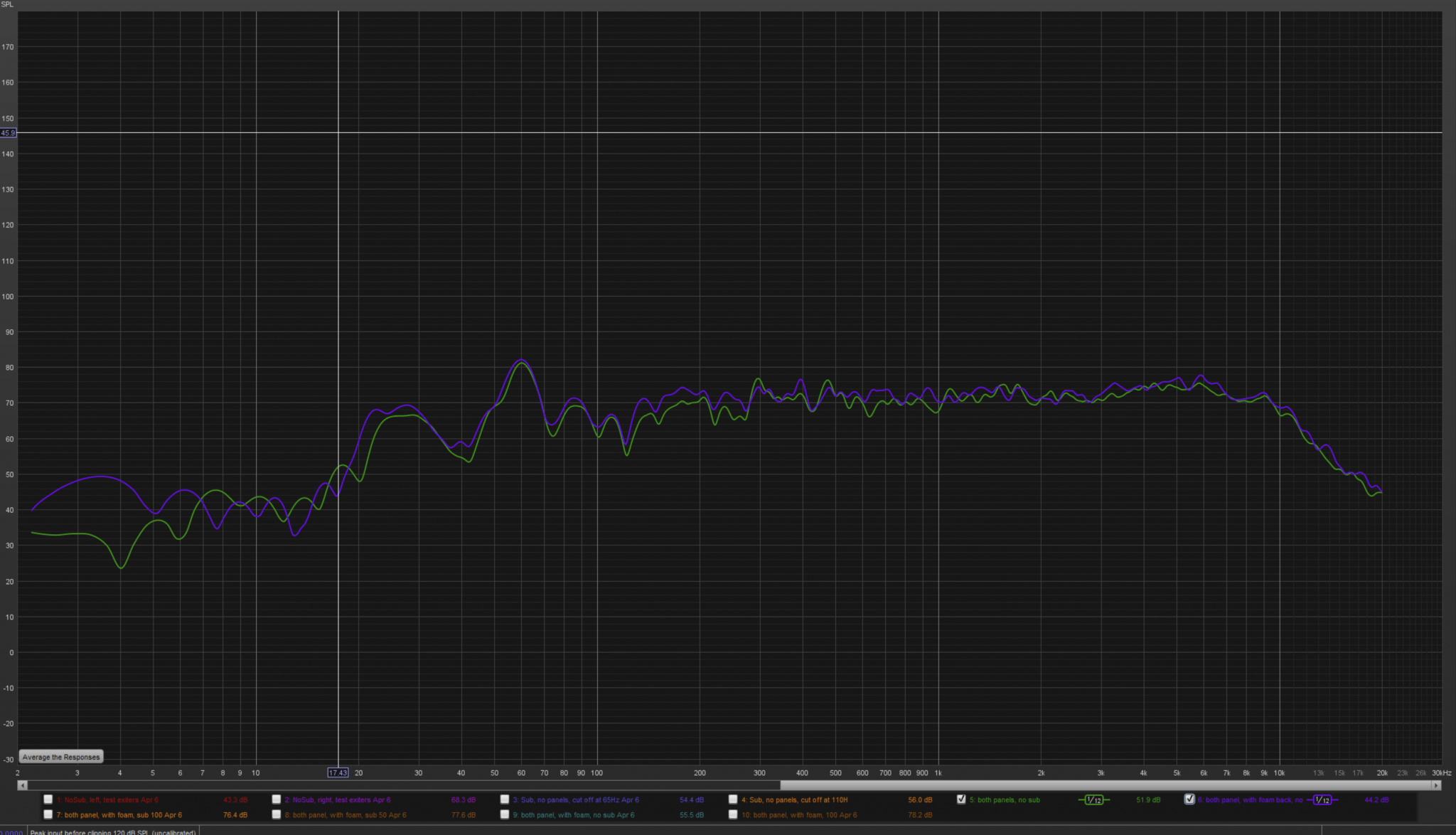

then I wanted to see if I can now add the 10" subwoofer to fill in the blanks. and the result is as follows.
Green no sub, orange with sub and a 100 Hz cut off frequency .

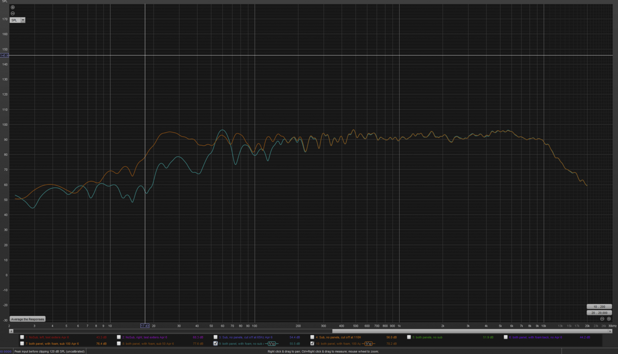

And as a comparison in orange with the sub and a 50hz cut off frequency compared to panel only in green
and this is actually an intersting finding. If the panel does not have to work too hard in lower frequencies, then the exciters produce more output in the whole range above the cuttoff frequency....
Clearly this room has resonances that need to be treated. And yet, I can tell you that these panels sound amazing. and I was totally impressed by their bass response and the high resolution in the range from 50-100hz.
The main flaw, however, is that male vocals, lower strings of guitars and bass drums sound a slightly hollow (super slightly and dependent on the recording). I'll have to find a way to add 1-2db and smoothen the range from 70Hz to 500Hz.
What I have prepared is a spine, but I'll wait for the other exciters to arrive. I hope that it will give the exiter the ability to better push against the panel and hereby add more meet to the lower ranges.
All in all,... man what a bang for the buck! Especially because it looks like I won't have to spend money on an EQ or dsp!!!

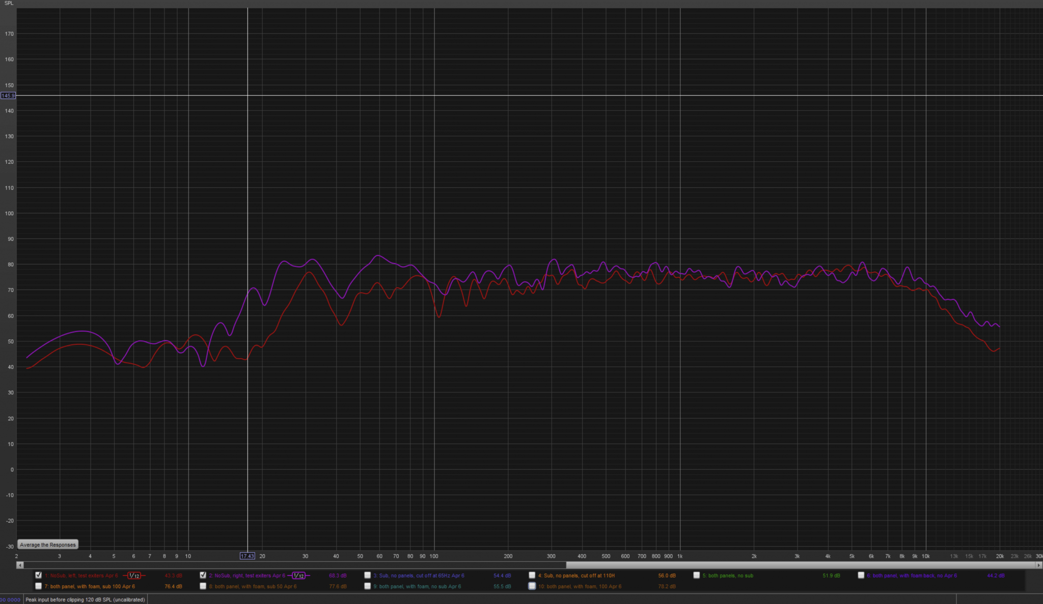

Sebastian,
I see from your charts that there's significant drop after 10 kHz - almost 30dB / octave. Most exciters double and grow exponentially their impedance after 10 kHz, resulting in a drop of SPL.
Would a Zobel network tuned at 10000 Hz be of any help?
Most of us don't hear too much above 13000 Hz (don't want to talk about my age), but there are plenty of harmonics up there that will help in 'sculpting' the tonal range.

Could you post the FR with a more "standard" (sorry it is more my standard than something discuss here) with a 20..20kHz horizontal scale and something like 80dB (or a bit less) in vertical and if possible not in dark mode (not so good to be read in the post)?
About smoothing there is also no standard discuss here. I think we all apply what we judge ok to show what we want to show... 1/12 is ok. I have posted many FR at 1/6 and currently I use frequency dependent window (see Tools > IR windows > check box frequency dependent window) set at 5 (similar to 1/6oct) or 10 cycles
For the distance as if I remember your panels are quite large 40cm is too close for a general view. 2m is better for vertical panels in a standard listening situation.
I don't have the time right now to have a more detailed look but seems promising.
Christian

Sebastian,
Hello Sonnar,
yes, the drop is really bad, but I will not bother until my other set of exciters arrived.
I did not expect the current setup to do much above 10Khz because the exciters I use have nothing to offer in that range.
Right now I have the following two wired in series:
https://www.daytonaudio.com/images/resources/295-240--dayton-audio-daex30hesf-4-specifications.pdf
https://www.daytonaudio.com/images/resources/295-230--dayton-audio-daex32ep-4-specifications.pdf
Christian
I hope I made the correct adjustments.
This is both panels with sub, 100Hz cut off, 2 meters from the panels, and 2,20m from the sub.
The result with 5 cycles
This is yesterday's graph and todays with 10 cycles layed next to each other:
And to make that complete.
Both of yesterday's graphs adjusted with your settings and 5 cycles.
Panels with (orange) and without sub (green):
Sebastian
Looking at this actually, I turned the sub down a little and this looks better.Hello homeswinghome,

Waouh!Hello homeswinghome,
Sebastian
I think when you started to post here, nobody would have bet on your design!
Your measurements are simply impressive.
As comparison below are my plywood panels (45x120cm 3mm thick). Far to be as flat as yours!
Now we all are going to ask you how you proceed for bracing!
Do you have set to "no smoothing"? I mean x cycles frequency dependent window but no smoothing... before was 1/12oct no frequency dependent window. I think both are active but no matter, the overall quality is here.
Seeing the difference in high frequency you might try a capacitor in parallel to one of the exciters (some µF). With that this exciter will be shunted in HF letting the second one working alone. The drawback might be for your amp which will drive 4Ohms in HF. With a solid state amp or even a class D is not a problem. For a tube amp I don't know.
In addition to the straightness of the FR, what is incredible is the bass extension despite the bracing
I really don't understand how you came to the braces position...
Really please teach us.
Christian
5 cycles frequency dependent window (blue was 2m outdoor, red was 1.5m indoor)
10 cycles frequency dependent window (blue was 2m outdoor, red was 1.5m indoor)
10 cycles frequency dependent window + 1/12 oct smoothing in FR (blue was 2m outdoor, red was 1.5m indoor)
Well, this is when I uncheck that box.Waouh!

Hi Sebastian,Hello Sonnar,
And my goal is to have two of the following wired in series:
https://www.daytonaudio.com/product/1184/daex25shf-4-steered-high-flux-25mm-exciter-20w
My amp is a TU-8300 from Elekit and it only provides 6Watts max per channel at 8Ohms.
The current setup with the 40Watt exciters rocks the whole house and the 200 Watts 10" inch sub has trouble to fill in the gaps for these large panels.
Unfortunately, an organ, or a drum set will still need a little more power from this system to sound real. I have not tried to listen to orchestra music, but that will probably ask for a bigger amp and maybe 4 of these panels and definitely a much bigger sub.
However what I really like about these speakers is that you can really crank them up and they are not tiring the ears as much as e.g. my Cornu spiral speakers. The mids and heights are very charming.
We will see where this journey will end. So far I am very pleased.
I'll try to find the posts on Zobel networks,.... I never heard of them. Thank you!
Sebastian

Ok, let me try to give you a rough idea about this. Just briefly, because I decided to provide a proper pdf document with all decisions I made that led to here.
1. I read this forum on and off for quite some time and identified the outlier approaches as well as the commonalities among everyone's experiences.
2. I tried to find research papers that would support the topics/ techniques that I identified in step 1.
3. I decided to do a very naive approach and do things similar but still different. (e.g. the foam suspension was done by many, but not like this.)
4. I tried to find the principle of DML in other applications and found the top of a guitar. Here, based on the naive approach, I asked myself, if luthiers do that for hundreds of years, why question it and therefore just give it a try.
5. I did some research on the principles of guitar bracing, the different sound quality of ply wood oppose to tone wood.
6. I did not try to fight material sourcing constraints and just went with what I was easily able to get and moved the fancy solutions, like tonewood, composite boards and such into the future. First a proof of concept, then the real deal.
I can't really teach what I did, but I can provide the sources that I took as a basis so far, document in pictures what the panels look like now and explain the steps how I built them.
Because these forums are going over years and so much information gets lost, or is hidden in 300 pages of posts, I'd like to bundle my experience in a document once I think I reached a milestone, so that others do not have to make the same mistakes, or can take individual steps and repeat/test them on their own panels.
But, I'll have to do some reading about speaker measurement so that I can be sure that what I record and what I derive from the recordings makes sense.
All this is probably not what you asked for, so here is the main answer in respect to guitar bracing.
I googled guitar bracing and tried to find as many different bracing types as possible. There are many sources that explain how they sound different.
I picked a Yamaha classical guitar bracing because I assumed that nylon strings need more support in the higher registers than steel string guitars.
Here is a good article about the different types:
https://www.thisisclassicalguitar.com/bracing-styles-for-classical-guitars/
What I did is I picked one, then I marked a the 3/5-2/5 position on the panel with a pen so that I could ensure that no brace would cover that spot. Now, I took the longest wood braces (one of those that shape the main X) and set that diagonal over the panel. The second long brace was positioned from the other corner on one side to the golden ratio position of the opposite side of the panel. I decided to not have a symmetrical cross on the panel to avoid unwanted resonances and a greater variety in possible tones (at least I naively assumed that would be the outcome). Then I just eyeballed the angles and distances of the leftover braces and glued them also to the panels.
Once the glue had dried, I looked at the guitar bracing picture and eyeballed the carving that I'd roughly had to do. Once I was done, I held the panel up in the air by holding it between two fingers and I started to tap the panel at different spots, and voila, I was able to hear many different tones. And then I put the foam on, and glued the panels onto my frames,...
I wish I had easy access to 3mm ply sheets in that size, but 5.2mm had to suffice. I can imagine that bracing, if done right can allow you to make much bigger panels, without fear that the panels bend once you hang them into a frame.
I assume that a main part of my panels' struggle in the 70-150Hz region is due to the center cross brace. It avoids the first mode and second mode, I think. I'll try to make that less rigid once I have the new exciters in.
Next step, once the new exciters are on, I'll lay the panels on the floor and put sawdust or sand on them to see what the patterns look like at different frequencies and then I'll try to change the sound output for individual frequencies.... that'll be a fun.
Ok,.. that is it for now.
In short, no science only naive following of what has already been there.
Sebastian
