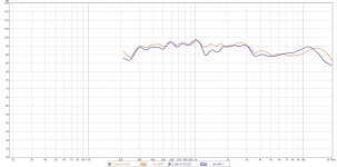

I was looking at the canvas art panel last night and realised that with all the cracks in it that it was not rigid at all in fact it was very floppy.
So I decided in a very quick decision to glue an exciter on to a brand new canvas panel with a brace at the back to support the exciter.
And that was it,nothing else just the canvas and the exciter.
It only took about half an hour to find and saw the wood for the brace and to put everything together and glue.

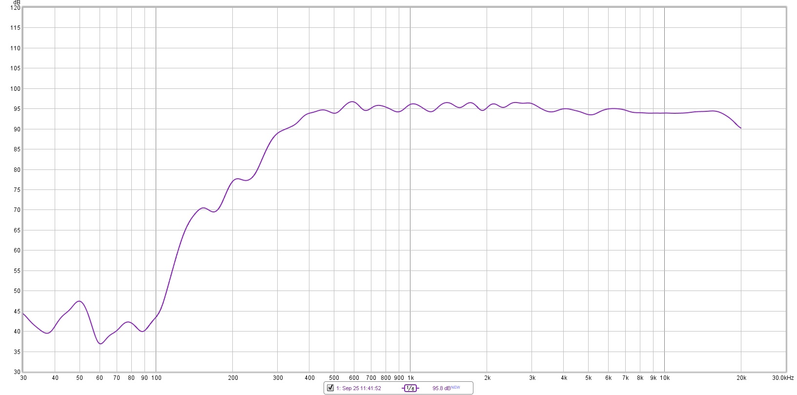

I have not had time to assess the sound yet but took some quick pictures of the panel and a response at 12inches.
This panel rolls off at about 300hz which is handy as this is the normal roll of on my TLS,so i xo the panels to this so no overlap anymore.
Hopefully I'll get a chance to listen tonight
Steve.

1) the coil on the naked panel was a test panel ,so I glued the coil in the centre to see what would happen,the response looks pretty good so as yet can't see any problems.
I did offset the exciter on the ply panel which I mounted in the centre of canvas panel , but i was thinking of mounting both centrally as the canvas absorbs the vibrations from the panel ? reducing the panel reflections ? I think?
It's worth trying just to find out what the difference is.
2) with the canvas panels I've made so far ,I've had no problems with the corners .
3) as long as the tape is up to the job of supporting your exciter I see no problem.
For short term mounting you could use G clamps to hold the spline in place and glue the exciter to the spline (or use tape) this will take all of the weight off of the exciter canvas mounting and be easily movable.
4) I have taken measurements at 1m but this is not of much use to me.
I take near field measurements to see what the panel is outputting and 3m into the room where I sit ,to see what is actually happening in the room.
1m is good for recording music as it minimises room responses ,but is not the real in room response.
Listening to the panels at 1m is very similar to wearing headphones.
Actually when listening to dml panels from directly between the panels I can't tell the difference from the headphones.
Steve.

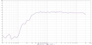

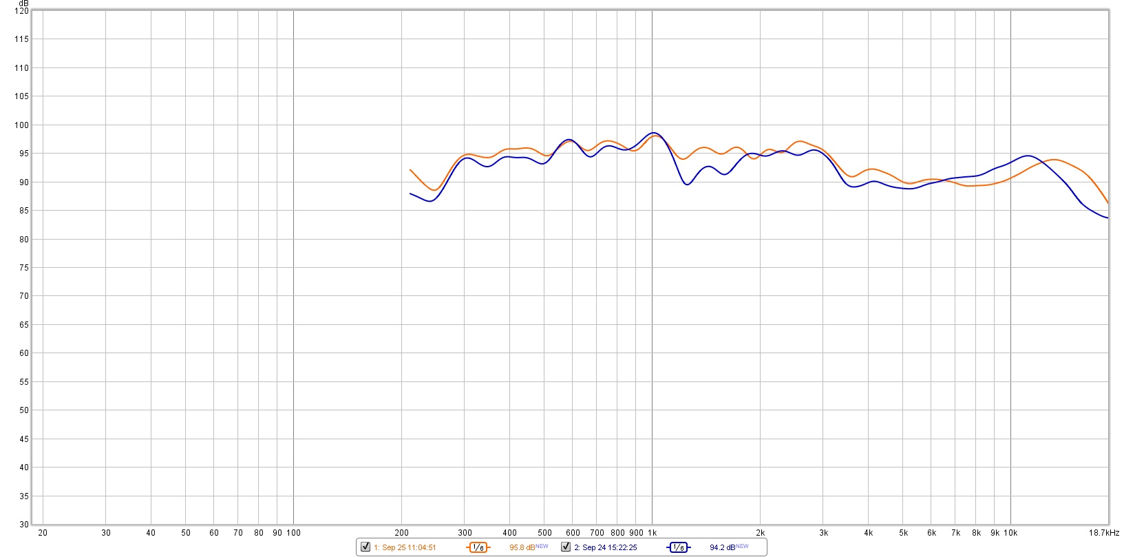

I have now compared the frequency sweeps of two different exciter mountings on my art canvas / ply panels. In the attached image, the blue line is using double sided silicone type tape, and the orange line is where the exciter is glued to the 10x15cm plywood.
EQing the tape version is tricky due to the double trough. The glued version, on the other hand needs a little work between 300 and 3000hz, a broad boost between 3khz and 13khz and finally some extreme treble lift.
The second image shows the frequency sweep with EQ and also an LR24 high pass crossover @ 300hz. Extreme HF is a tad down, but not bad at all. This of course gets me thinking about whether using UHD EPS instead of the 3mm ply on the art canvas panel may give just a bit more HF extension. Only one way to find out I suppose...
