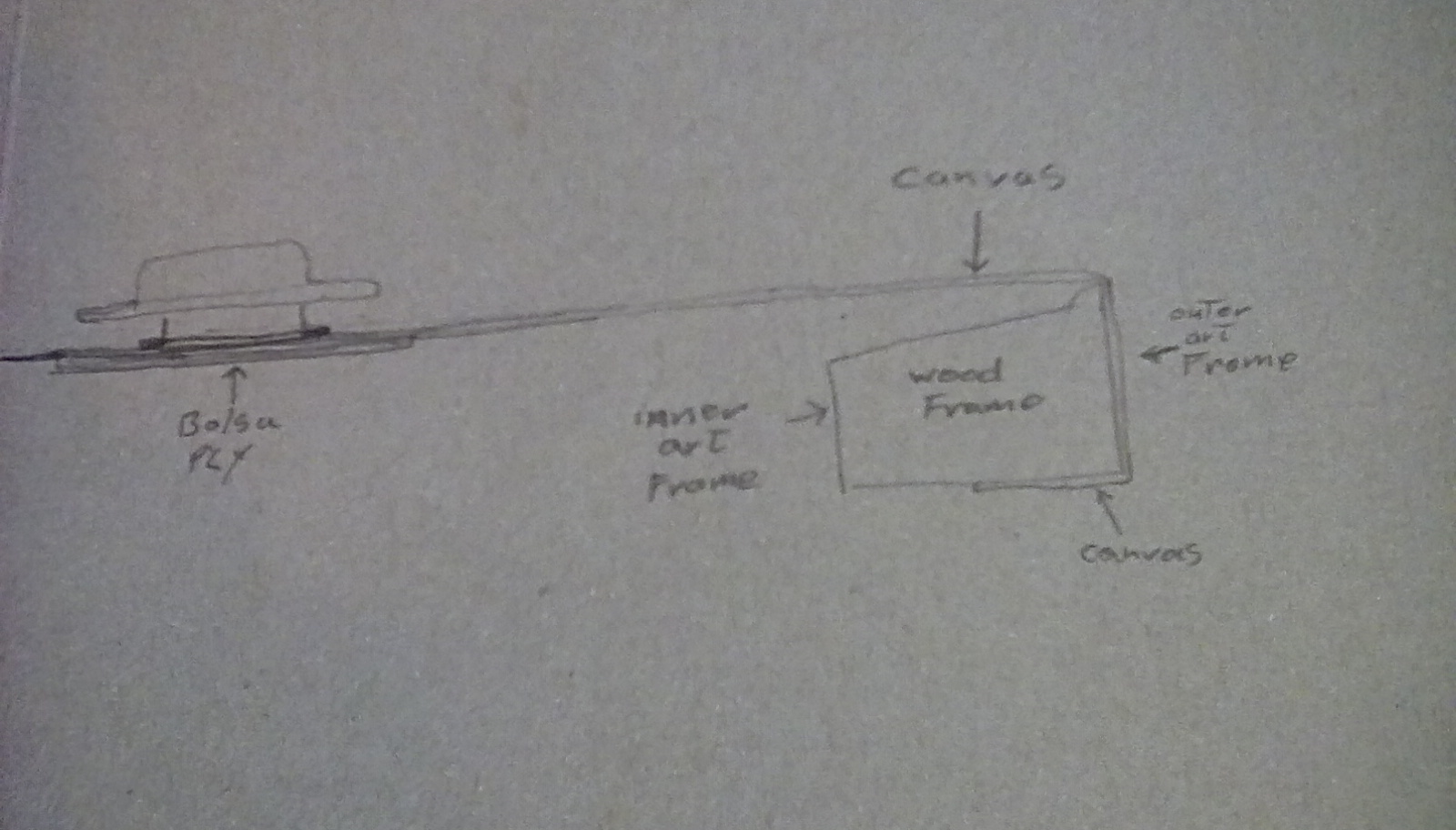

Here is a quick drawing of the frame of the art panel I have,I have no idea if all art frames are designed like this?
Not to scale obviously,art is not was never easy for me.
This seems to work well with no problems ,so far?

It was a square frame so I was very lucky to get the frame that I did.
I'm sure you could make it work by pushing rubber or some sort of beading between the frame and canvas which would help stretch the canvas as well ?

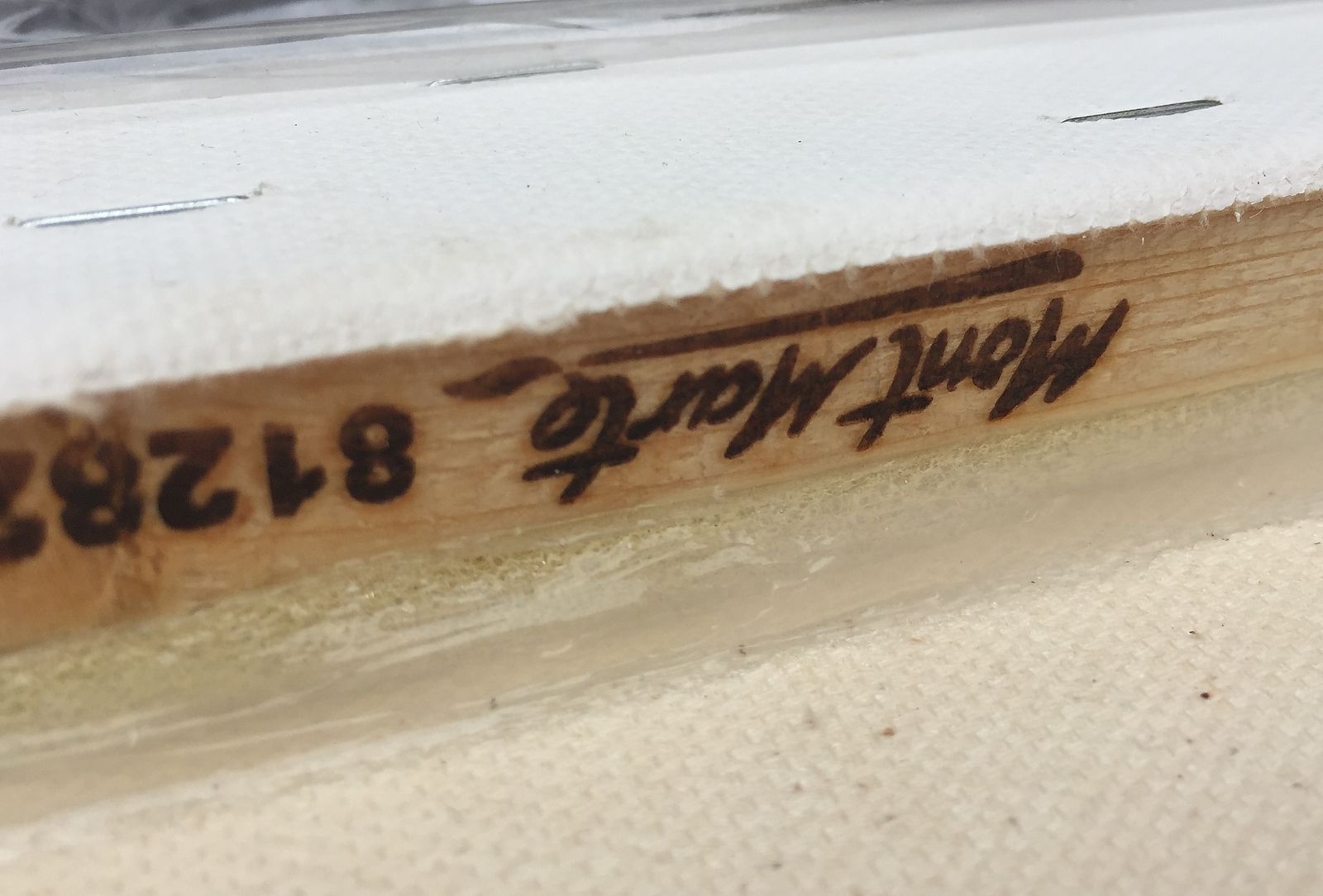

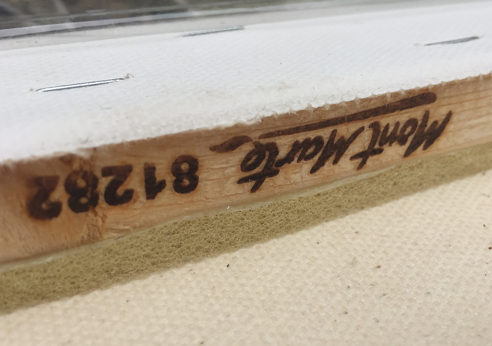

- For starters I jammed between the canvas and the wooden frame a self adhesive 6mm Open cell foam (used for window sealing).
- After that I put all around a bead of silicon.
See the attached pix.

Were you having some problems with the foam ,so you had to use the silicon to cure the problem ?
Steve.
I put the silicon just because I thought it would be a good idea to absorb the vibrations. Maybe it is an overkill...It cured for more than a week.

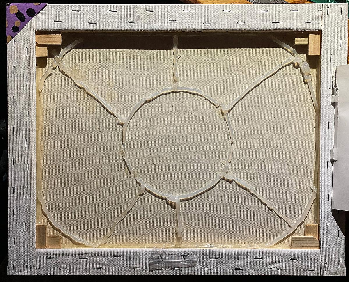

Next step is to glue the timber panel. I have a choice of
- balsa (10cm wide @ 3.4mm)
- round pine (10cm diam @ 3mm thick)
- the hexagonal sheets (pictured in a previous post)
I also put some hot glue on the back in the pattern seen in the attached pic.
I also plan to coat the back with water based glue diluted in a ~ 2:10 ratio.
Any advice is highly appreciated.

I've been trying to wrap my head around the fact you've applied hot melt and silicon to the panel to cure a problem you don't even know you have ?
Doing this could even cause the problem to start with ?
You have done the last resort first ? Even before you have attached the exciter.
I used my 6x4inch balsa with an exciter as a test panel first to see how it sounded,and then made a few adjustments.
The 6x4 ply worked petty well above about 600hz or so ,and sounded pretty good xo at this point to my TLS.
So I knew I had a good panel to start with.
It was only then that I attached the test panel and exciter to the canvas.
The panel worked pretty well until I had the brainwave to coat the panel with cascamite,which is very rigid ,but what I did not realise is cascamite is also very brittle and cracks in thin layers.
End of project !!!!
Although the panel sounds good at a reasonable volume ,if I try to turn it up too high the cracks start to let themselves be known
Prepare to make mistakes ,try to do as little as possible to start with and then if necessary after careful listening you can make small adjustments and then listen again to make sure it is really improving the sound.
It helps if you have two panels ,but keep one fairly basic so that any adjustments can be closely monitored to make sure you are going in the right direction..
There is a lot of trial and error but if done in small stages with small adjustments hopefully not too much damage should be done.
