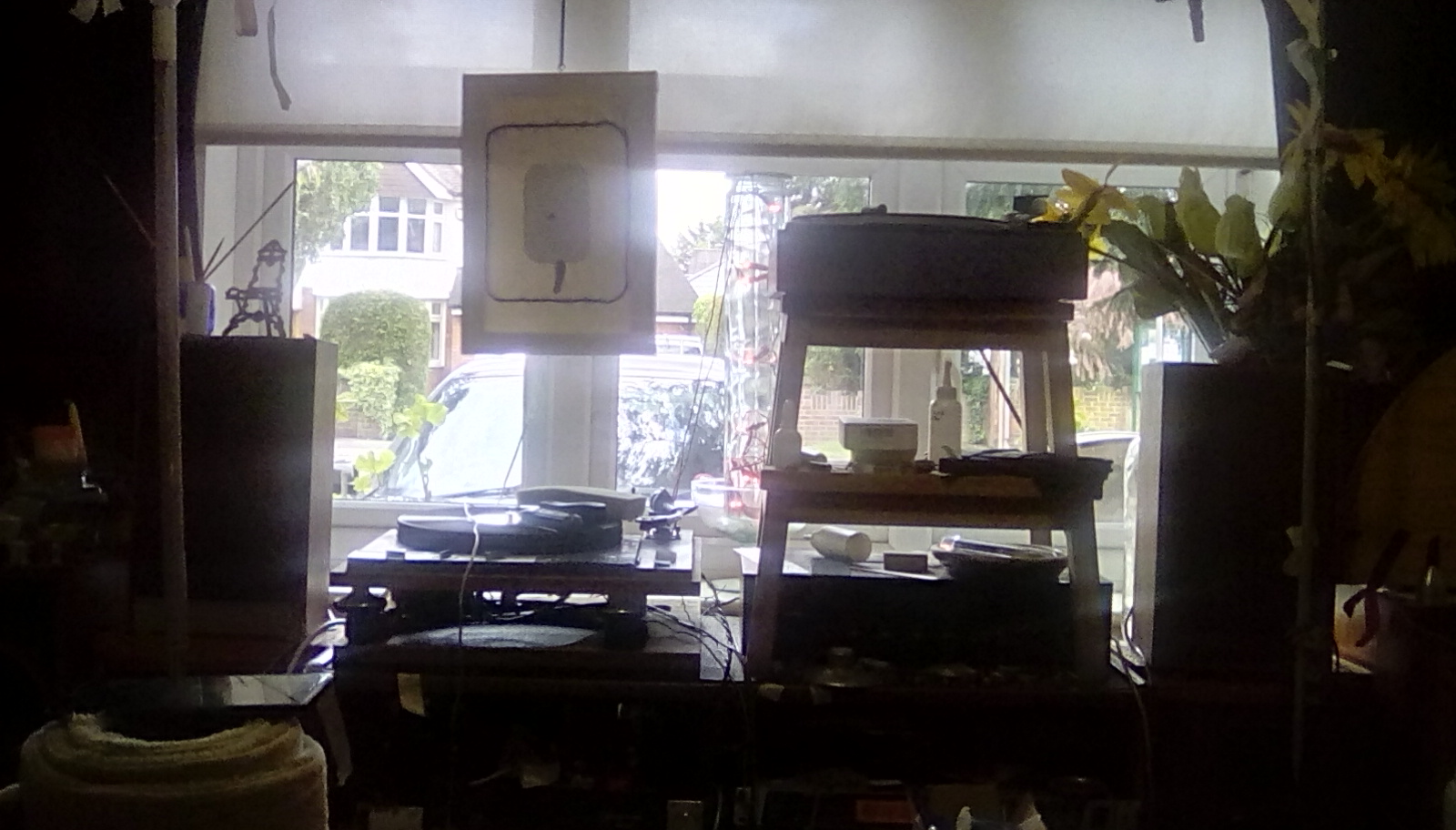

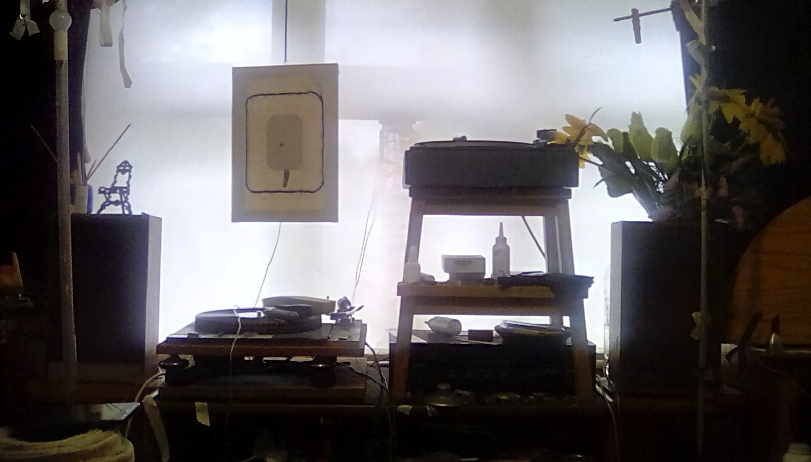

Art panel near window.
Jaxboy.
When I opened the blinds the panel kept turning around🙄
I did open the blinds fully ,but in the picture I didn't want you to see the dirty windows.
Which was pretty bad,I did not want anyone saying isn't it about time you cleaned those windows
Hope it gives you an idea of what to expect from the sound of an art panel near a window?

Jaxboy and sonner.
I have only built one canvas art panel ,so can only speak for that panel.
I'm sure there can be many variants on this design and as I say I can only speak for and demonstrate my design.
The panel was purchased from my local art store and was ridiculously cheap for 4 panels in a pack.
The balsa ply 6x4inch panel was also very cheap on eBay for a pack of 10.
All I did was round the corners as Can be seen in the last photos.
The canvas art panel was also pretty much untouched ,the frame is already raised at the outer edges so the canvas if free all the way up to the edges.
Nothing to flap or buzz against.
The canvas panels were already pretty tight so all the hard work was all done for me.
The only other thing I did was coat a large area of The panel in cascamite ,which is very rigid ,but I'm afraid cracked badly.
Which ruined the panel 😕
Your exciters magnets will need supporting at the back .
The problem with using a larger panel is trying to control the canvas.
I would imagine the canvas could start to wobble uncontrollably if too large?
How large that is I don't know?
Maybe a larger ply panel could help compensate and reduce the canvas area?
Or maybe something as rigid as cascamite but will hopefully not crack?
A lot more experimenting is needed to find the ideal size and materials.
So far it's not perfect and I'm sure there could be problems with the canvas stretching over time .
But for a quick cheap build it is a good all rounder with a very strong output down to at least 40hz (with mine) and up to 20k.
If more power is needed just use 2 panels per side(or more).
Steve.

Jaxboy.
There were a lot or questions you asked.
The microphone was 5ft from the Window with and then without blinds.
No caulking used.
My room is about 10ft wide and abut 25ft long and full of junk.
All of my dml panels fill this room with sound and that is with a 10watt amp!!
Admittedly I do use my TLS to help fill in frequencies below about 300hz this helps to fill in room suck outs.
Steve.

Jaxboy.
I should have said that the microphone was 4ft from the panel and the panel was 1ft from the window with the thin blinds in place as in my last pictures.
The microphones were not picking up most of the low frequencies ,I did try and eq this but the microphone still wasn't picking it up ,so left it out.
After recording it then converting it then uploading it then downloading it, it never sounds as good as my original recording,but hopefully it sounded ok.
Steve.
