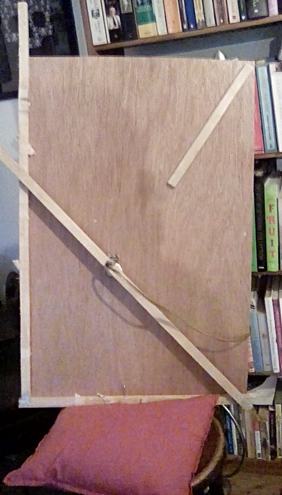

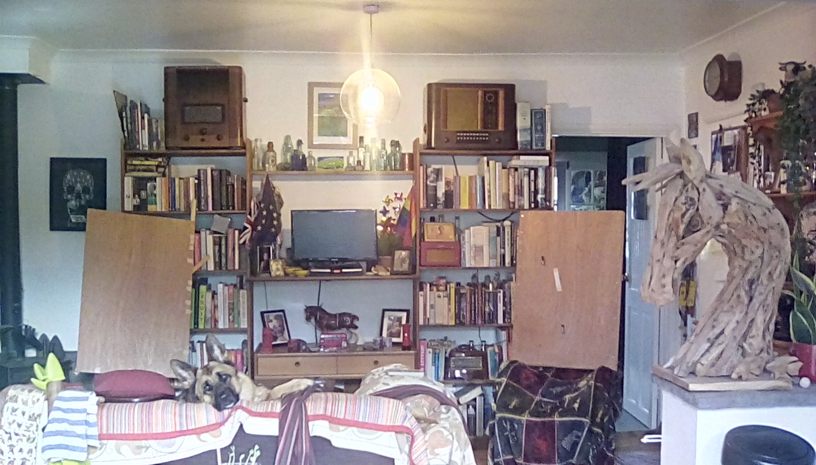

Pics of ply
The ply panels propped up on chairs leaning on the book case in my kitchen.
Not at its best ,but I just wanted to know if it would go loud enough.
My wife complained that it was too loud ,and what about the neighbours?
I informed her that this is nothing,wait until I set it up outside with a proper amp and player!!!!:D
it didn't go down well:eek:
Steve

The panel on the left was an experimental panel that I never finished,but it matches the framed panel in how loud it can go and sound.
I didn't want to lug one of the 6ft panels around.
I also recorded this before I read your last post.
Steve.
