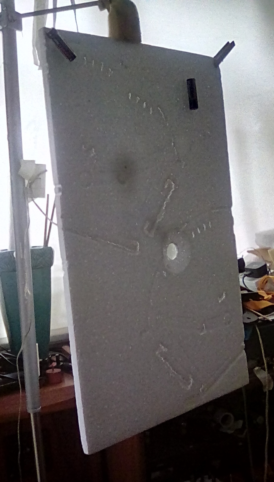

Exp panels
This is the smaller panel on the left that I have been recording,it was damaged when I found it,but as you can see,I have been using it for testing.

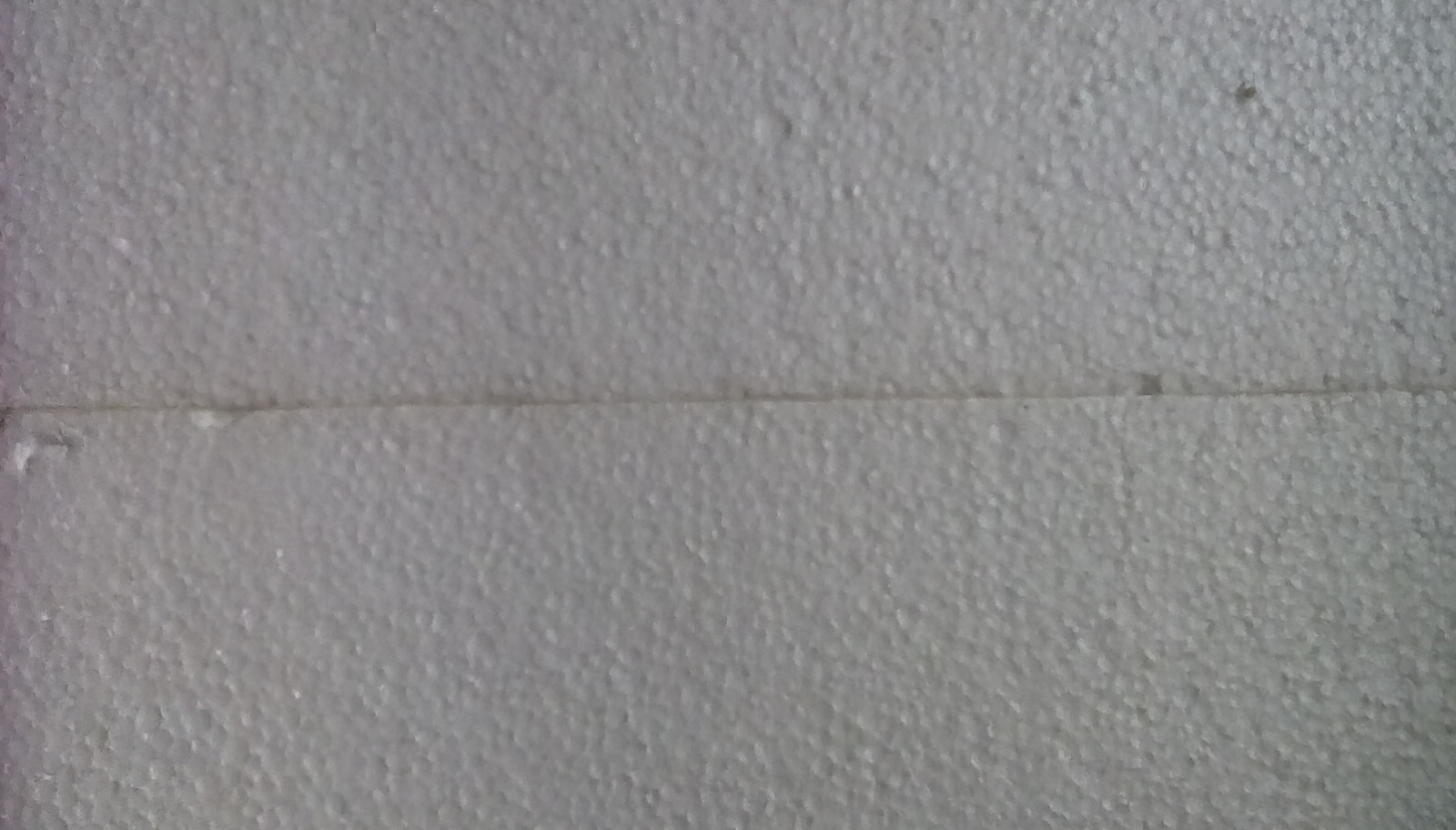

Also I have glued together the two small eps panels just to see what happens.
I used thick pva hoping to fill the gaps,but afterwards thought it may have been better to have scuffed the two surfaces and used thinner glue,the two fluffy surfaces would have filled the gaps better?with hardly any glue?
Oh well.

In the photo of the panel I used for recording,I used three AA batteries to reduce the dip in response in the 300hz to 100hz region,two on the front one on the back,and now sharply rolls off at the 100hz mark.
The clothes peg in the top right was to stop the corner buzzing .
I find the easiest way to mount the small eps panels is with an old dish sponge shown in top of the photo(they are softer when old!)This also stops the panel waving about ever time I walk by.
Steve.

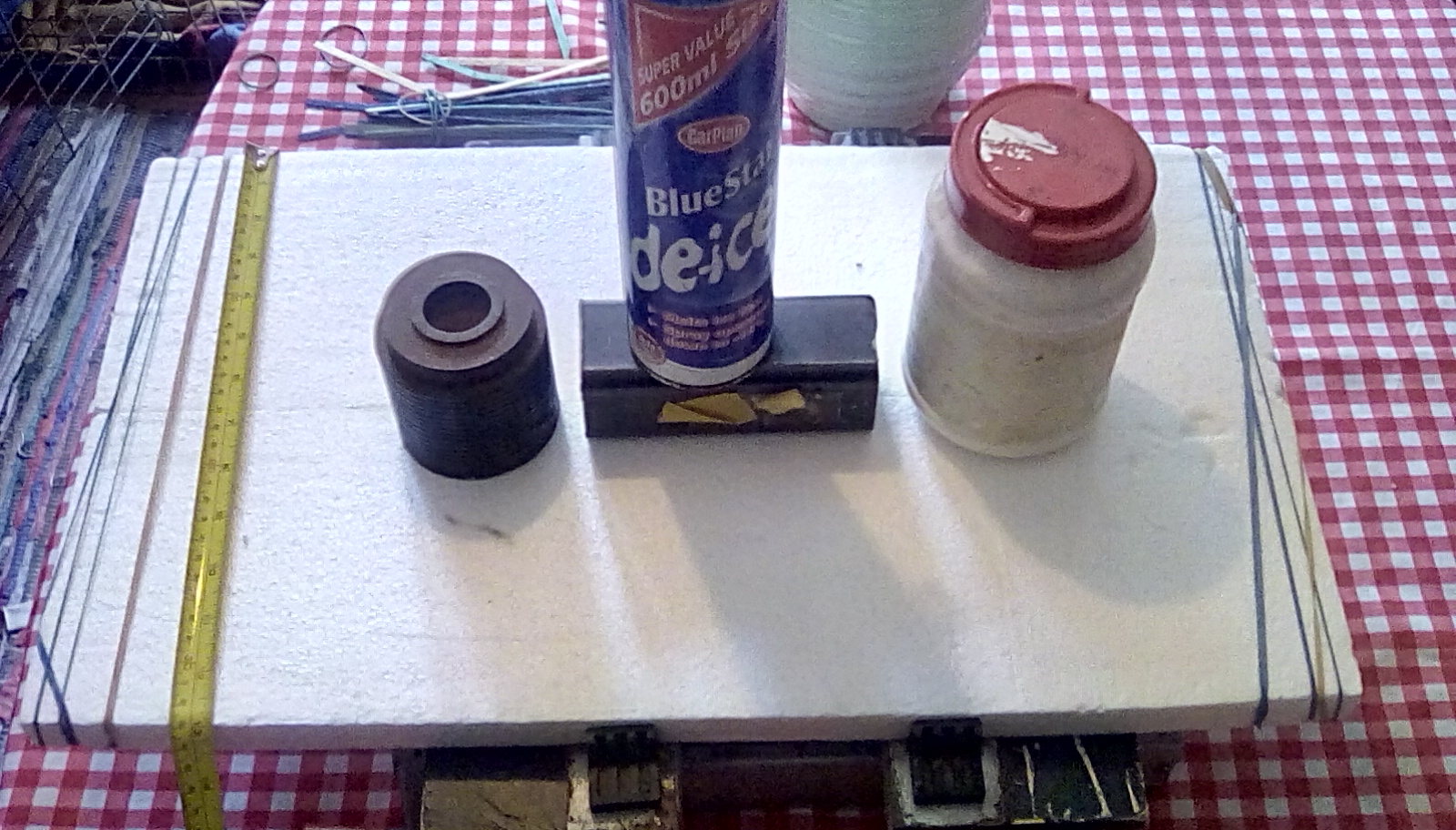

Two into one
The panels are now stuck together.
If I did this again I would definitely scuff the surface and probably use a 50x50mix ,pva especially when thinned will not readily attach to the surface of eps,it will form globules, I will attach the exciter in the monacor position which is the nxt patent,as I prefer the more central position for the exciter.
I will leave the panel for a few more days to dry before doing some serious testing .
A warning ,that this is for eps and not xps,as xps will seal the moisture in and not dry.
But you can scuff the surface of xps and also eps and coat with pva,which will absorb and harden the surface well.

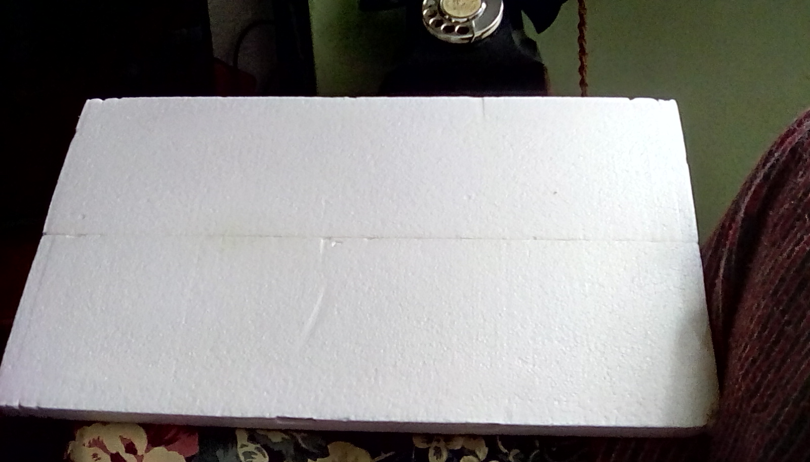

Two into one
This panel is slightly smaller than the one I have been using for the recordings.
It feels like a totally different breed of panel,this one is very rigid ,the other is so much lighter and is wobbly.
It will be very interesting to see how they sound and measure.
I will run them side by side and make comparisons.
I have slightly gone off track by using an exciter that has lost its foot,so the coil is mounted directly on the panel,not that I noticed vast amounts of difference in the past,but then I have not done identical tests panels(the cheep sell off exciters I bought years back have two problems ,one is the wires break ,causing buzzing then failure,the other is the foot comes loose,also causing buzzing)you can spend a long time pulling the panel apart only to find its the exciter!
I have sanded and coated the panel with one coat so far of 50x50 pva mix,I did round the sharp edges of the panel a little bit that's all.
I will now glue the foam sponge in place for mounting the panel and that's then finished.
Steve.

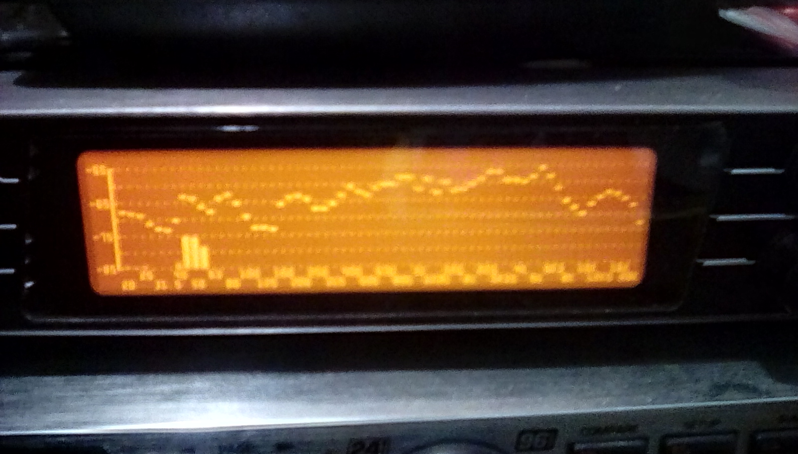

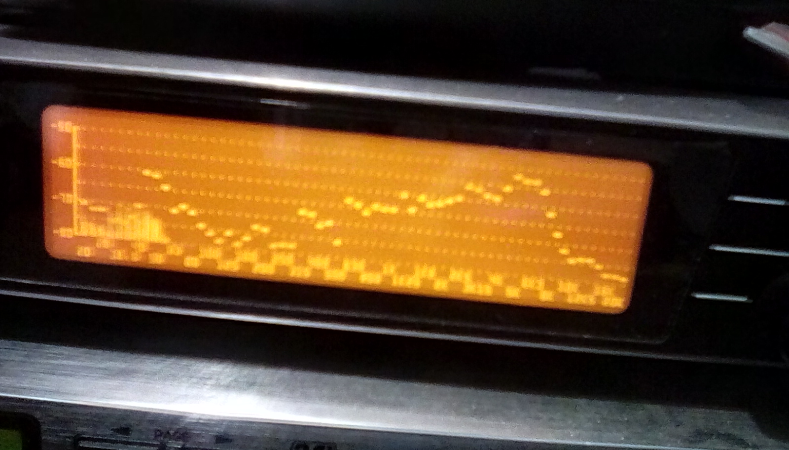

Something I noticed on the recording that is not that bad from my seating position was that the close mic recording of the sssssss sounds were more pronounced .
I tried to figure out why the mic was picking this out,I've tried putting my hands all over this panel but annoyingly it refuses to change its response .
I even held a very large cushion in front of the panel,with very little change,so concluded it must be to do with reflections.
I have noticed for some years now,that reflections can cause harsh sounds now and again,for instance a loud TA sound can give a very painful slap in my ears,but moving my head to one side ,the harshness has gone,damping on the wall sorted it.
I know all the experts say dml does not suffer from wall reflections,but in my experience they do,just in a different way.
I suffer more because my panels are only 2ft from the side walls,so I can get very strong reflections now and again.

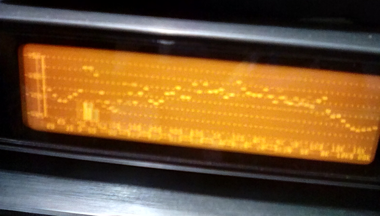

But anyway ,the difference in the response of these two panels might help show part of the problem.
The two pics on the left show the old panel ,first from the left side of the panel second in front.
The same for the new panel,the first from the left side the second in front.
You notice the rising response to the peek ,right where the ssssss problem is.
It is practically the opposite of the reflection response you would expect from an ordinary speaker.
This reflection could alter the in room response ,and I think that is what the mic was picking up from the position it was in ,close to the panel and wall.

I'll try and explain this a little better,I was in a rush when I wrote the last post.
The old panel has a very similar response from the side and front.
The new panel has a sloping response from the side,this was the worst case response just to show the problem,this response when recording was bouncing straight back from the side walls to the microphones,but where I was sitting it sounded ok.
The new panel has a very detailed sound,and is more efficient than the old panel,the image in the recording had drifted to the right.
As for the pva glue holding the two halves together affecting the sound waves going across the panel,I can't hear or measure anything nasty going on,looks pretty normal.
I have now coated the sides with pva ,will see if that makes any difference.
I will move on to see if I can improve the response a little, it should be possible to reach 10k with 25mmm eps before hitting the slope,usually!
I know the pictures are poor quality but they do show the shape of the responses well ,which is what I wanted to show.
Steve
