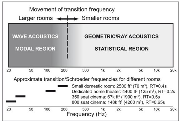

That depends on context. Let's say you have a panel that works down to 20Hz. When you place it in a small room you'll run into room modes that result in dips and peaks caused by long wave length sound waves interfering with each other as they bounce off walls, ceilings, and floors. It wouldn't be a drop in that case it would be interference. You generate the sound wave but it cancels itself out.
That means, in small rooms, you don't derive advantage from a DML that works at lower frequencies. Once you drop below the room transition frequency you might as well run normal subwoofers and use available low frequency design methods. Or, just use a single sub woofer with little control and call it a day.
All of our homes are small rooms unless they are 56 ft high, 56 ft long, and 56 ft wide or more. Or a backyard. OTOH, if you're in a backyard with no walls a DML doesn't supply advantage over cones because regular cone speakers aren't reflecting off walls or ceilings. Especially if your backyard is grass.
If your listening space is a small room the DML should help you with frequencies above the transition frequency. So design your DML for that range. Then do something different for the lower frequencies.

Thanks for your response, Bradleypnw. Do not all speakers, more or less, suffer from room interaction, whether they are DML, open baffle or closed box cones? I have one IB sub that I am happy with 80 Hz and under. And I understand that multiple subs will smooth the response, but my question is what to do above 80 Hz? Open baffle cones with the DML panel? I was thinking that the Yamaha NS30 design (DML in a deep open baffle, maybe with a BMR) might get it done without the cones.

Yes, all speakers suffer from small room interaction. That's the most important thing going on in home audio. DMLs offer a solution to the geometric acoustic region. Their room reflections aren't as highly correlated as cone speakers. They take advantage of your brain's inability to process a lot of "diffuse" uncorrelated reflections. As a result, your brain concentrates on what it can process so you interpret the direct sound and ignore the reflections.
Your room will probably be modal up to 200Hz. Another way of saying it -- maybe --is that modal behavior will dominate up to 200Hz then geometric behavior will dominate over 200Hz. If you use an online room mode calculator you'll see modes above 200Hz but those modes don't dominate your frequency response curve. In practical terms: modal below 200Hz, geometric above 200Hz.
In a way that really sucks because spoken voice is between 70Hz and 255Hz. Which means we have modal room problems in most of the spoken voice range. However, our brains do a lot of heavy lifting for us because our brains evolved to be really good at hearing spoken voice. That's why you can have a conversation with someone in in a tiny room and everything is ok.
You're dealing with a combination of the hard physics of sound waves and the soft way your brain interprets pleasing sound. Here's a video that makes a really good illustration of the way your brain will do a lot of heavy lifting for you with audio.
Green Needle or Brainstorm?🤔 What Do You Hear? - YouTube
What specifically should you do with the 80Hz to 200Hz range? I'd say treat it like the 20Hz to 80Hz range. Hand your DMLs off to cone speakers because the DMLs aren't taking advantage of your brain processing at that point.
