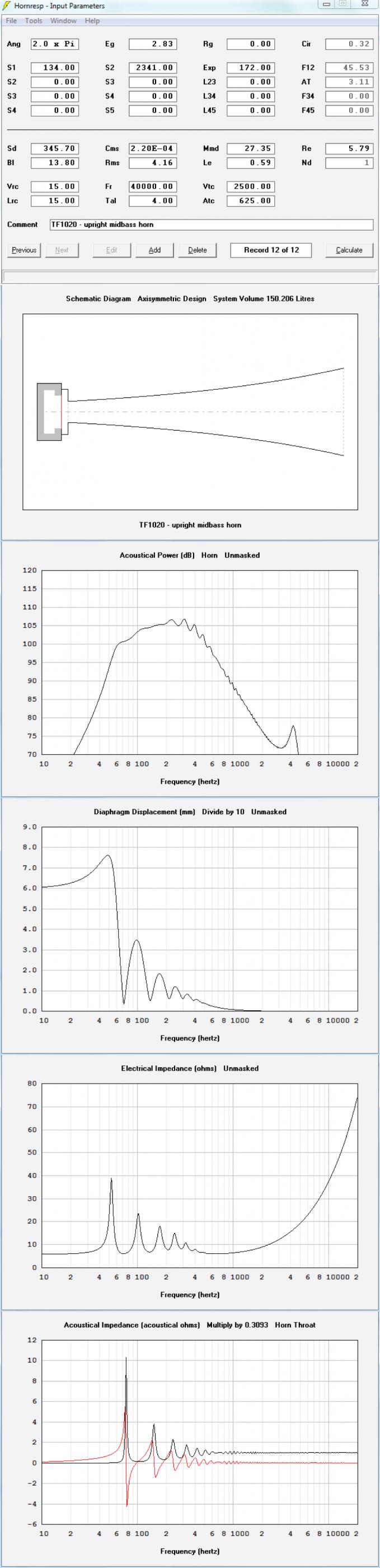

Here's a little something I came up with a while back for the Celestion TF1020. Essentially a somewhat compromised 100Hz front midbass horn. Vb is quite manageable IMO.
Power shown for 2.83V, but can take 8V before reaching Xmax at ~50Hz where unloaded, with output at 75Hz being 110dB, not too shabby. Note the sim is for 2*Pi space as well.
your TF1020 horn looks like a good performer vs Belle other than ultimate power handling and most horn folks aren't slamming a lot of power into their home horn systems - can you fit it into an ~ 9 cubic foot package?

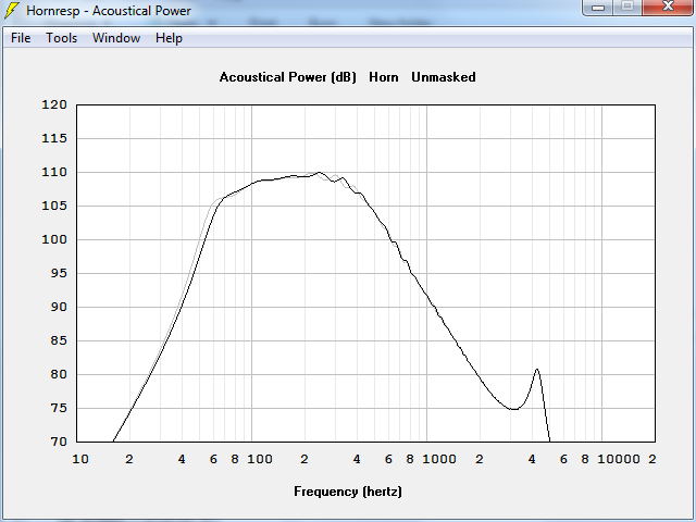

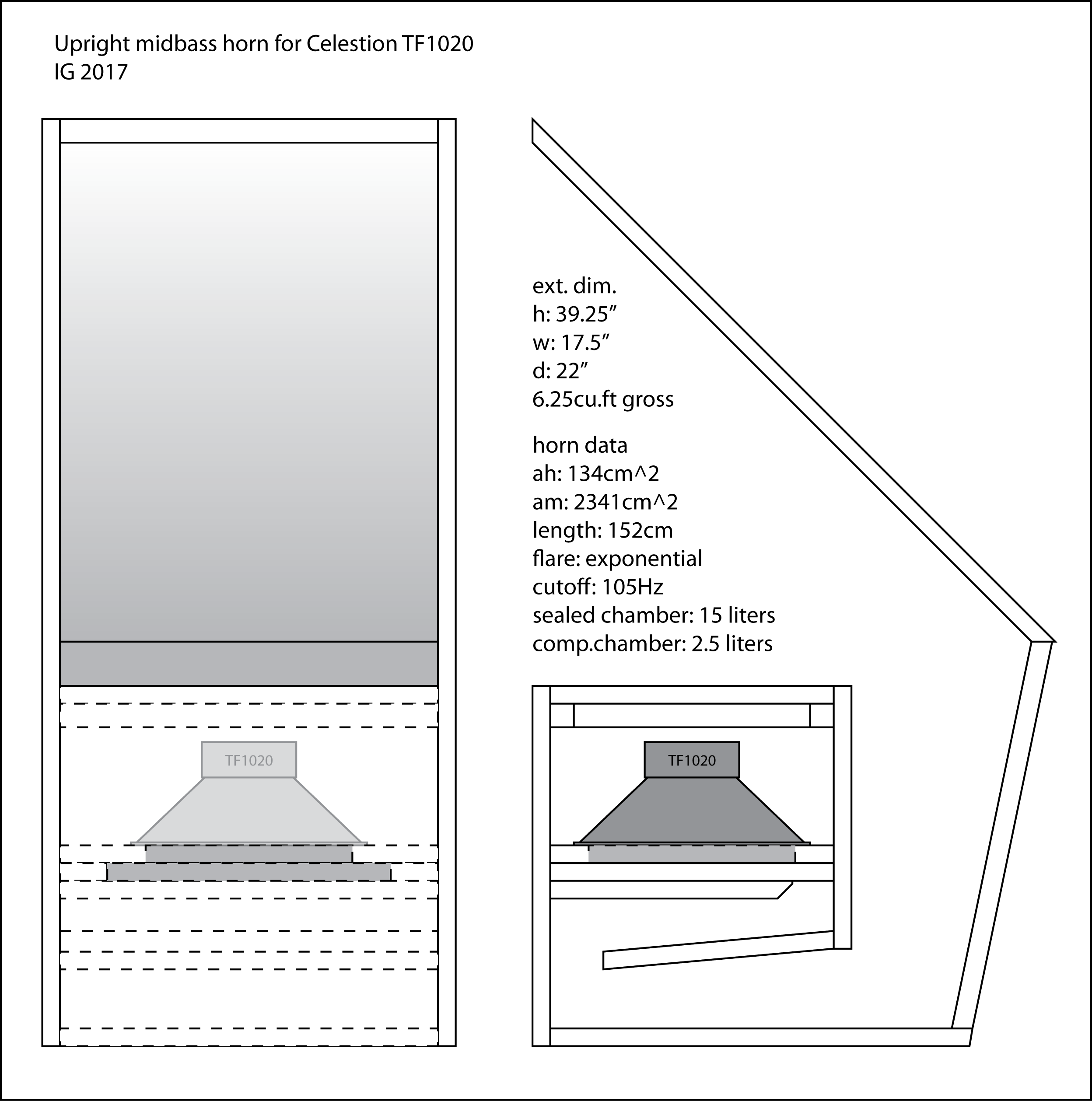

I fleshed out the TF1020 horn a bit more. I reduced length to 152cm instead of 172cm, but the rest is unchanged. Note the below simulation is for 1*Pi space.
Bold: 152cm
Light: 172cm
External bulk is 6.25 cubit feet. The exponential flare is accurate enough IMO. I could probably figure it out for a rectangular box, but I like this style of upright bass horn. Not drawn are mouth and internal bracing.

like its looks too - a couple of ~centered braces and it would be good to go. It would fit a corner nicely (and sims nicely too) - where to mount the midhorn ? what midhorn/driver combo might work?
Yeah, there just is no convenient flat top on which to set a midrange unit. The almost 40" height makes it a bit high for a horn on top as well. It would be easy to integrate an angled-down K-tube on the inside of the slanted top, but this can only really play down to 1.5kHz, so needs something for 300Hz and up to there.
using a solid state amp, we might yank up the 400-600Hz region a bit by pulling down Z with the lowpass filter. Hang sort of midhorn (make a "J" midhnorn ?) as you say - a K-tube could mount through the back panel - would it keep up with the horn-loaded TF1020?
It would keep up with a good driver and network. At home levels to boot. I wonder how the TPC tubes did in the pro applications they were used in by LEECH and others.

sometime - if you don't mind - put some dims on that drawing above - is it fully scaled?
