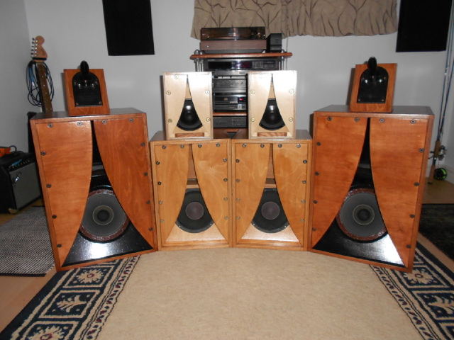

The two larger boxes below (Karlsonette and SK8) did well enough in 19mm BB-ply, with other drivers than pictured though. The smaller ones on top, K5 scaled-down from factory K8, never worked well, tried with high and low Qt drivers, not sure foamcore would have been enough to save them, but might have been an improvement.
I don't own any of those anymore (except the TPC Tubes), but sure had fun messing around with them.
