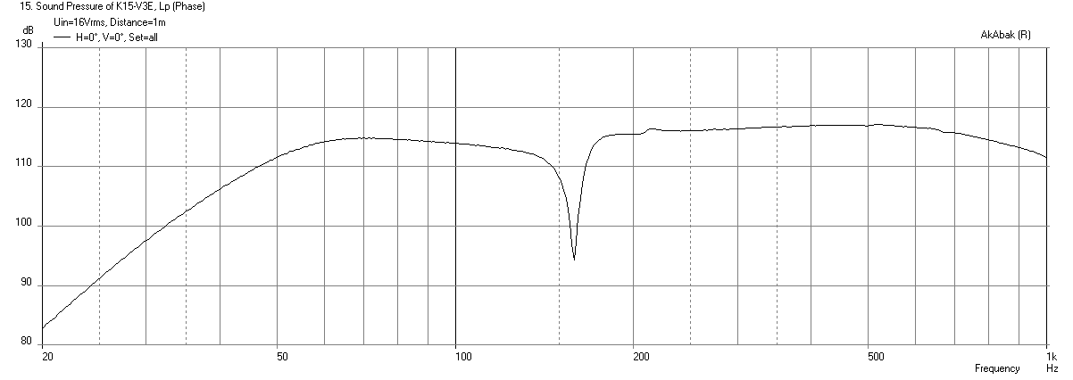

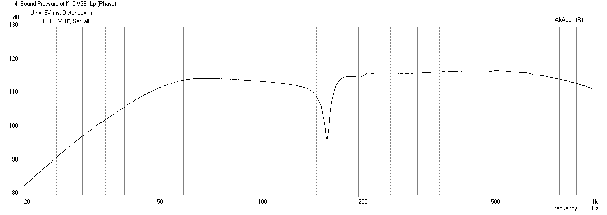

Hi Freddi,
Those params look ideal for a K, although my personal preference is not to use a traditional K scaled below 12in. Just doesn't have enough bass for me.
This is not so easy to answer without running some sims while adjusting the shelf.

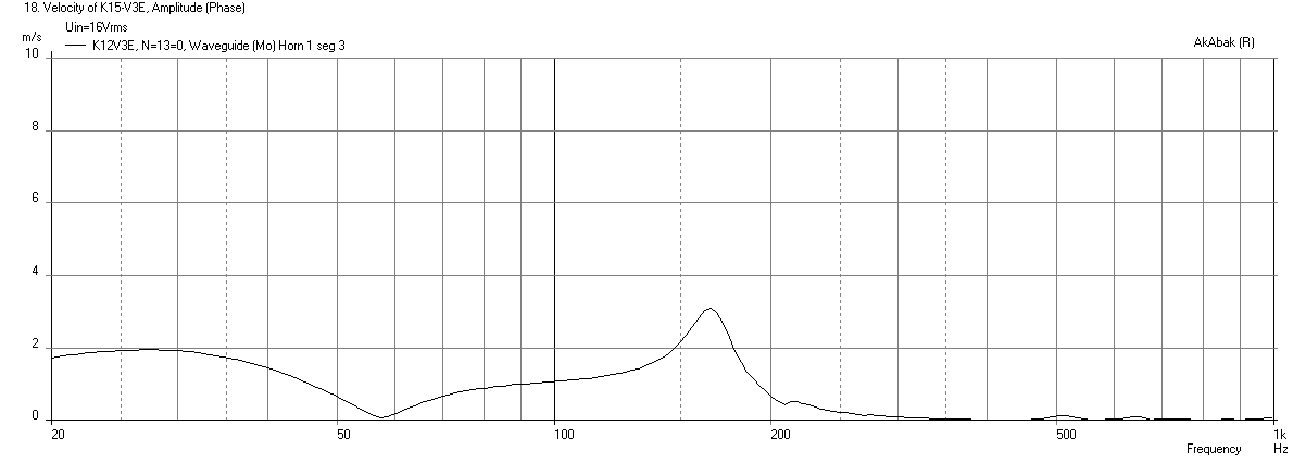

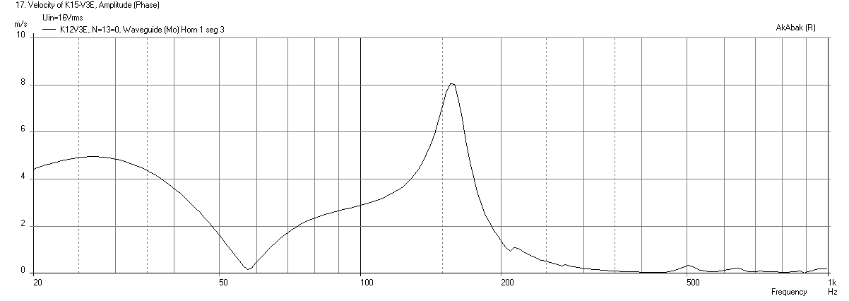

So I am running some sims with the rear shelf area set at 0.25x a nominal K15 shelf and one at 2.25x the CSA of a nominal shelf. These areas may not be practical in reality but we are looking at trends. (note that files show 0.5x and 1.5x but that is scaling applied to both dimensions).
The effect on frequency response is very subtle, the location of the first dip extends higher up for a larger CSA (smaller shelf). There is also a decrease in air velocity through that shelf so less audible chuffing noise. I am running sims with standard K15 and EV SP15A driver.
0.25x CSA shelf:
1.0x CSA shelf:
2.25x CSA shelf:
Velocity with 2.25x CSA shelf:
Velocity with 0.25x CSA shelf:
I even looked at impulse response to see if it affects dynamics - not visible in graphs. So, in conclusion, I see no benefit of having that rear shelf. It actually reduces bandwidth and causes chuffing.
what are your thoughts on K15 (and the old K12) rear shelf? (sometimes viewed as a lowpass filter in conjunction with damping material) When is it useful? What does it do?
0.25x CSA shelf:
1.0x CSA shelf:
2.25x CSA shelf:

a strong 10 inch speaker in the little 0.62X scale K15 produces graphs as so - these are relatively close, in a cramped room and one is away from room ways and elevated 28" from the floor. (Some of these have the mic below central axis) i think at this size, the K-coupler needs to be against at least one boundary with an ~98dB rated 10" speaker.
I'll try a K-tube on top and hear how it subjectively fares. The object with this tiny size is to see how it competes with typical front loaded "midbass" horns.

one more thing -= response of Beta10cx vs FE206EN in the 0.62X K15 sitting on the floor - note the CD's polarity was set "normal" per Eminence's recommendation - producing a suckout. I think they should have elaborated "normal" reverse polarity (which fixed the suckout) 🙂
Wings OFF - Near-cone and Near-port graph of 0.62X K15
speaker is a low Q 10 (Qts ~0.23, fs ~53) - there is a rear shelf with a tight gap spacing of about 1.5" or so. When the wings are added, the prominent peak is around 232Hz.
I should have added some resistance to modify Qes and will do to check effects of a weaker motor when get appropriate resistors or can get an L-pad to read consistently in one spot.
The rear shelf can be shortened somewhat to check effects upon tuning and port output.
At 0.62 scale, the rear chamber is around 0.86 or so cubic feet. A regular K12 will probably provide some useful LF extension in a manageable package.

note - the null in the near cone response ` coincides with the port peak up towards 300
