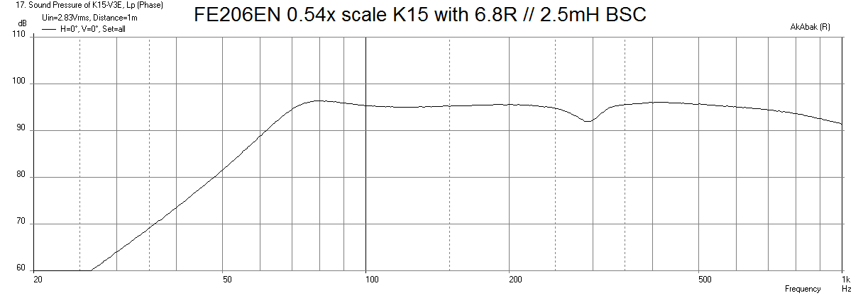

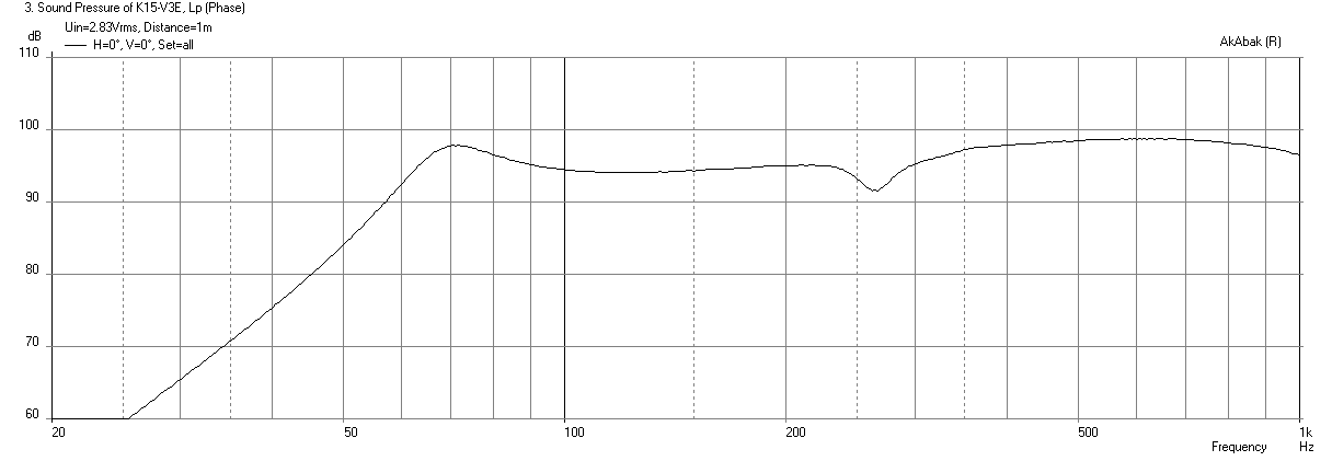

I ran a sim of a FE206EN in a 0.60x scale K15 and the response is not ideal. Although there is a deeper bass extension, there is a bass hump at the knee - not good for accurate dynamics and low group delay. Better is a 0.54x scale K15, and also use a 2.5mH in parallel with a 6.8R BSC to flatten the response. You end up with a very nice circa 95dB sensitive system with an F3 of 64Hz.
Here is what I used for TS parameters:
Here is the 0.60x scale:
Here is the 0.54x scale with BSC:
Note that a K aperture that ends in a sharp cusp is important, do not use a slot termination.
Def_Driver 'FE206EN'
SD=206cm2 |Piston
fs=45.0Hz
Mms=12.2g
Qms=4.57
Qes=0.194
Re=6.8ohm
Le=0.0525mH
Vas=71.0L
