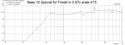

I'm eying a 10" for either a nice punchy K/X10 or Karlsonator 10
what's the best K that can be done with this speaker? I know it should work fine in a stock Karlson 12
Def_Driver Bass guitar 10 | Eminence 10 Qts=0.23, 3mm xmax, fs=52.22, 97.7dB
SD=366.1cm2
fs=52.22Hz
Mms=25.6g
Qms=2.94
Qes=0.230
Re=4.33ohm
BL=11.99Tm
Le=0.74mH

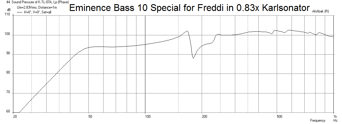

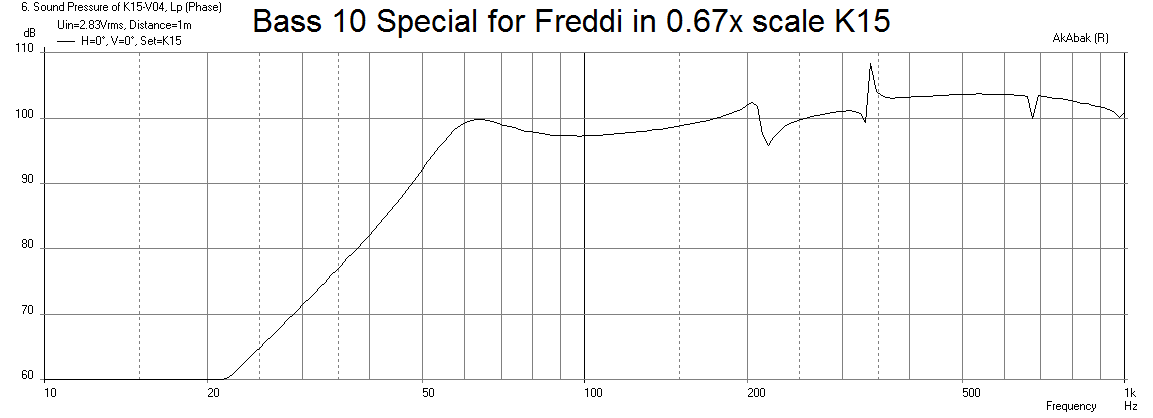

Here you go Freddi - 0.67x scale K15 has less extension but is punchier and flatter response.
0.67x Scale K15:
0.83x Scale Karlsonator:
FANTASTIC ! Many Thanks - that Karlsonator alignment has great bass extension- -Look at that same driver in the 0.7X Classic - If the rear chamber were only 6 liters as
in the sim below, predicted xmax would only hit 4.2mm at 28.3v below the passband and about 3mm at 100Hz.
