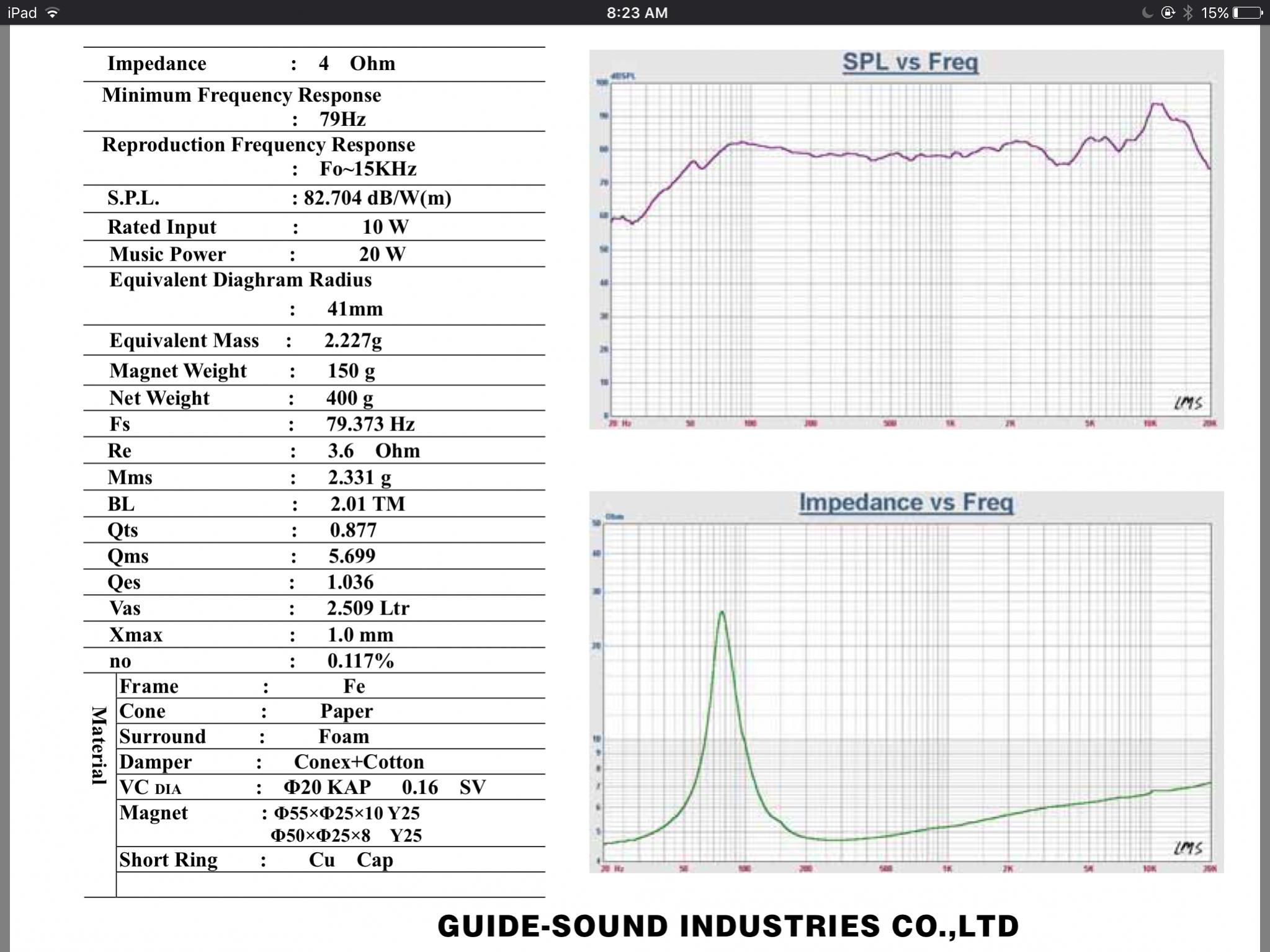

hey X - - are you pretty confident of your model to function with the port effectively shut off? There are cases of higher qts fullrange and things like car coax which should function well in in sealed back chamber K.
Is that like a KLAM? Or a K15 style with vent blocked off? Never tried that... Akabak should work well to predict a sealed K15. The issue with the above driver is the huge Vas.
that would be a sealed back chamber K15 type. btw, Karlson had a note saying sealed was appropriate for some speakers.
