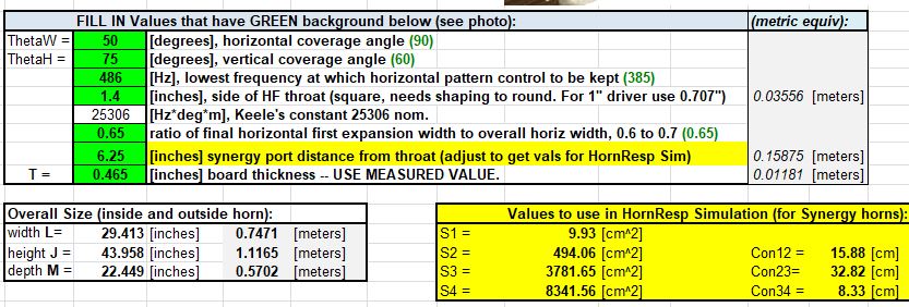

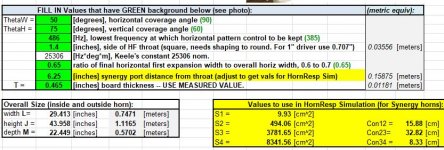

I realized i made a mistake in opening post re the speadsheet inputs.
That input snip was for the prototype i was using to get to syn8.
For syn8, I had to expand the size of the prototype a little to increase the bass-reflex port duct length.
The correct inputs and sizes are below.

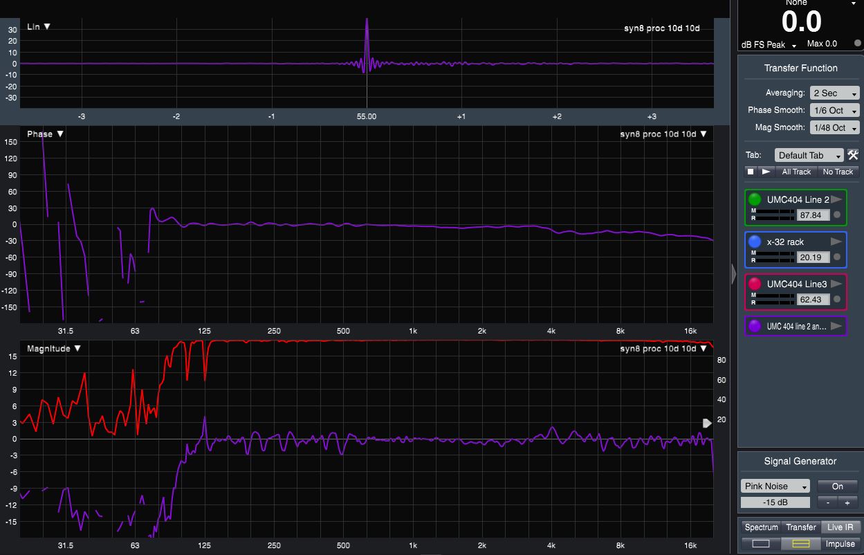

Here's an on-axis meas off the back of my deck at about 3m, early the other morning.
Had some low end boat noise in the background, as evidenced by red coherence trace. Polars of course won't look so good, but they are fine, and still under development when outdoor measurement conditions exist.

Room pseudoanechoic measurement looks very good! Synergy should have extremely smooth directivity anyway.
