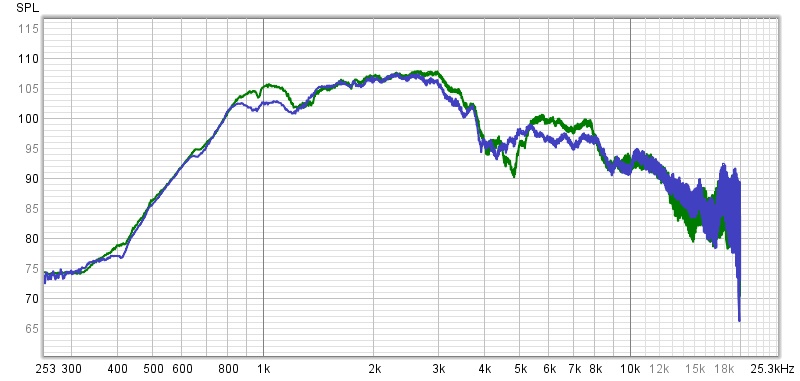

I tried both styles of throat on my 50x50 test box. Blue trace is Tom D style where the plate bolts to a 1"x1" square throat with a tiny bit of filler in the corners, green trace is the Bwaslo style from the spreadsheet.
The Tom D trace looks a little smoother above 10k. I overlayed the graphs so cannot be sure of exact spl as I measured them on different days, so cannot say whether the Bwaslo has higher sensitivity at 1k and 5k or lower sensitivity 1.4k to 3k.
Rob.
Cool Rob, kinda mirrors my comparisons......varying results with none of them clearly compelling.
I've made the deciding factor whatever shows the most consistent polars after correction. Iow, which behaves best, post tuning.
Btw, what type measurements were you making? Looks like a transfer function down low, and an RTA up high ????

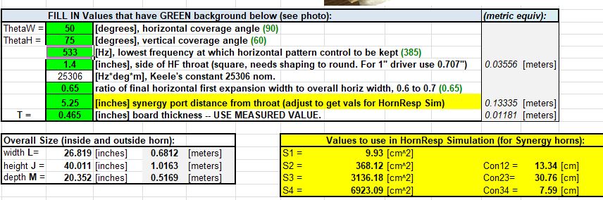

Is it possible lay hands on Mr Waslo's generous and excellent spreadsheet 🙂
Thanks TNT !
I see fluid linked you to the speadsheet.
I realized i made a mistake in opening post re the speadsheet inputs.
That input snip was for the prototype i was using to get to syn8.
For syn8, I had to expand the size of the prototype a little to increase the bass-reflex port duct length.
The correct inputs and sizes are below.

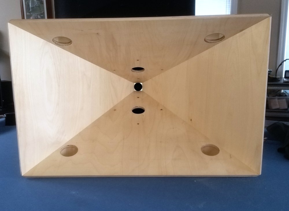

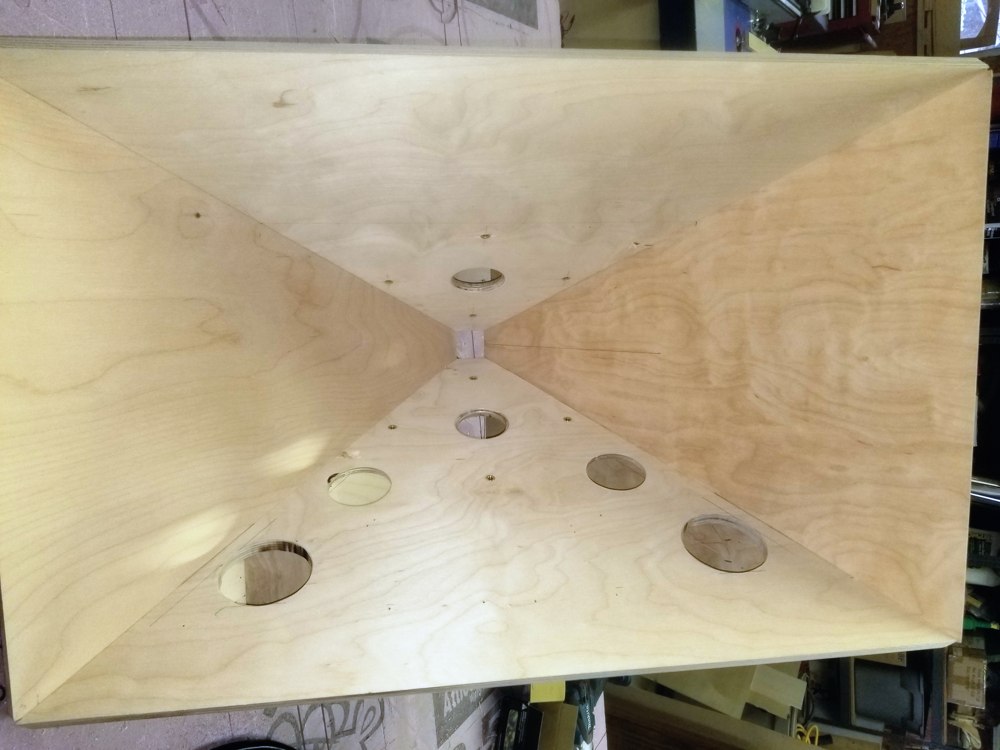

update...
added the secondary flares to syn8..
Still just tacked together with screws and a few brad nails, but i'm about to disassemble it and glue it up, and finish it....
because I REALLY like this one. (just like i did others before 😱😀
I like its pattern 75x50, better than the prior syn7's 90x60.
About the only thing i don't like better, is the use of two 8" drivers, vs 10"s in the prior.
Bass reflex ports helped get frequency response down to 100Hz, so i guess the only real loss is some extra headbanging SPL capability.
Turns out, i was right about suspecting resonances from the previous syn7's secondary flares, which are foam board wrapped with glass cloth. This guy.
It's not hard to hear in comparison to syn8's wood flares, both sitting on the same subs.
(it's not a matter of sub cabinet vibration effecting the synergies...it's airborn bass waves resonating the foamboard flares.)
Which is a real bummer....had great hopes for the light weight foamboard....but I'll only use the syn7 without the flares anymore.

Looking good, shame the foam didn't work. Hard to tell the size, is the new one significantly smaller?
Thanks !
The new one, 75x50, has a mouth of 44"x29.5"
The old one, 90x60, is 47.5" x 28.75"
So not too different in size.
One thing i don't understand, is why mouth sizes don't end up with the same aspect ratio, when the pattern ratio is the same.
What i mean is both the 75x50 and 90x60 have a H to V pattern ratio of 1.5x.
But mouth ratio for the 75x50 stays 1.5x, while mouth ratio of the 90x60 moves to 1.6x.
I thought the 1.6x ratio on 9the 0x60 syn7 was due to trying to have the secondary flares incorporate a tractrix curve.
But i see in Synergy Calc, the mouth ratio goes to 1.6x, even for straight-walled secondary's. Clueless why....
Anyway, i do like the H to V look of the new guy better 🙂

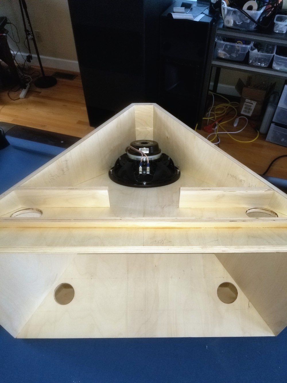

Hi Steffen, you're welcome and thanks for the kind words.
Chris A's K402 project was the inspiration behind my Syn7 version, the black one.
I tried to copy a tractrix like secondary flare, like a guy name Oohms did (pretty sure that's referenced in my syn7 build thread... let me know if you can't find it.)
I could see the AXI and four 8'' working awesome.
I also like the 75x50 for eliminating first reflections.
Since you don't care about weight, I agree with your plan to put the ports in the corners. Closer to throat the better.
I find centering the cones over the injection ports helps smooth and extend response, but i haven't really seen others report the same. Maybe because most other designs need the ports closer to throat than centering allows.
(Not having the advantage of a CD that can reach to 500Hz or below)
In the same vein re weight, you might want to even consider a 60x40, which will be a little heavier and deeper still, if it has the same size mouth as a 75x50.
I think the 60x40 is my favorite pattern....but that seems to run counter to most folks who like a bit wider i think.
Personally, I'm not at all concerned about driver sag for anything other than sub sized drivers. I've only seen one technical analysis (which i can't find or I'd link it), but it read like it is seldom a real problem. That said, i do rotate my horizontally lying 18n862 drivers in my PPSL subs annually.
Hope this helps !

Hi Steffen, sorry i forgot to reply to this earlier.
Thanks for passing on what you are reading about port locations under the cone.
I centered them based on a simple closed test box that allowed me to measure response as i moved a plate with a port or ports around, over the cone.
A single circular port centered kept winning, both in terms of response smoothness and better frequency extension, particularly on the high end.
I guess the tradeoff in a synergy horn is maybe mucking with the horn outflow more so than when ports are in the corners, but i can't say i've seen that happen. As far as i can tell, mouth termination seems to muck things up much more than port location.
I think i can picture what you're saying John Sheerin did...always love reading his work.
The reflex ports on the 8" were needed to boost low end response. My understanding is they have no horn loading whatsoever that close to the mouth and act as any normal reflex port.
I tried putting them in closer to the throat, but surprisingly it really messed up response. They are 5.4cm in dia. They and the ducts that feed them are simply the product of trial and error measurements.

Room pseudoanechoic measurement looks very good! Synergy should have extremely smooth directivity anyway.
I was wondering how port tuning works IRL. Ports I've never seen in synergys earlier... They might leak midrange sound as well, there's gradual phase rotation 180deg... Ports are opening so close to the edge, horn effect is minimal? But these issues are very difficult to measure!
I take it you're talking about the reflex ports and not the main port down in the throat.
Yeah, no horn loading at all. The duct area and length that feeds them, works just like any other reflex-port. I've read this is true for the DSL synergies using reflex ports too.
Measurements to find the reflex port size and duct dimensions were simply watching the response curve change as a i played with different port locations, sizes, and ducts.
I really didn't want to add them, but i couldn't get the response of the 8"s down low enough to mate with my standard sub xover usage at 100Hz.
That said, the build design with the cones on top and bottom and inside the side walls, makes it super easy to add the ports in the resulting cavity. And helps with bracing too.
I'm counting them a big win.
