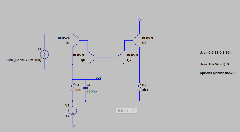

Help to comment this simple I/V
I am building a pcm1794 based DAC, which has a bias of 6.2mA.
I ever tried to build a I/V similiar to à la AD844, but failed with a really high THD, partly due to bad matching of BJTs.
Can you help to comment this simple, low THD but no PSRR I/V?
I just dont clear whether try this simple I/V or give à la AD844 another try.
  • SimpleIV.asc
    SimpleIV.asc
This is essentially the same as the one from Jan from 1989 :
Simple, high-quality I/V converter | Linear Audio NL
You are putting a lot of power through those SMD transistors.
So I would at least consider BC327 instead.
And you are relying on Q2/Q3 to keep the input at Gnd level, but they have a much lower bias than Q1/Q8.
So the input is not at 0V, but some 50mV.
There is no means of adjustment in your ciruit.
And as you say, no PSRR.
Also high Zout (=Riv), output coupling caps, etc.
But it is simple enough to make a quick build and see if it works for you ?
You will need well matched (hfe & Vbc) transistors to get optimum results.
Patrick
