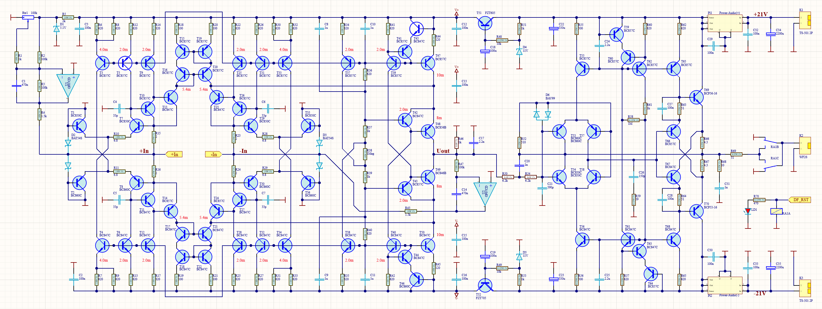

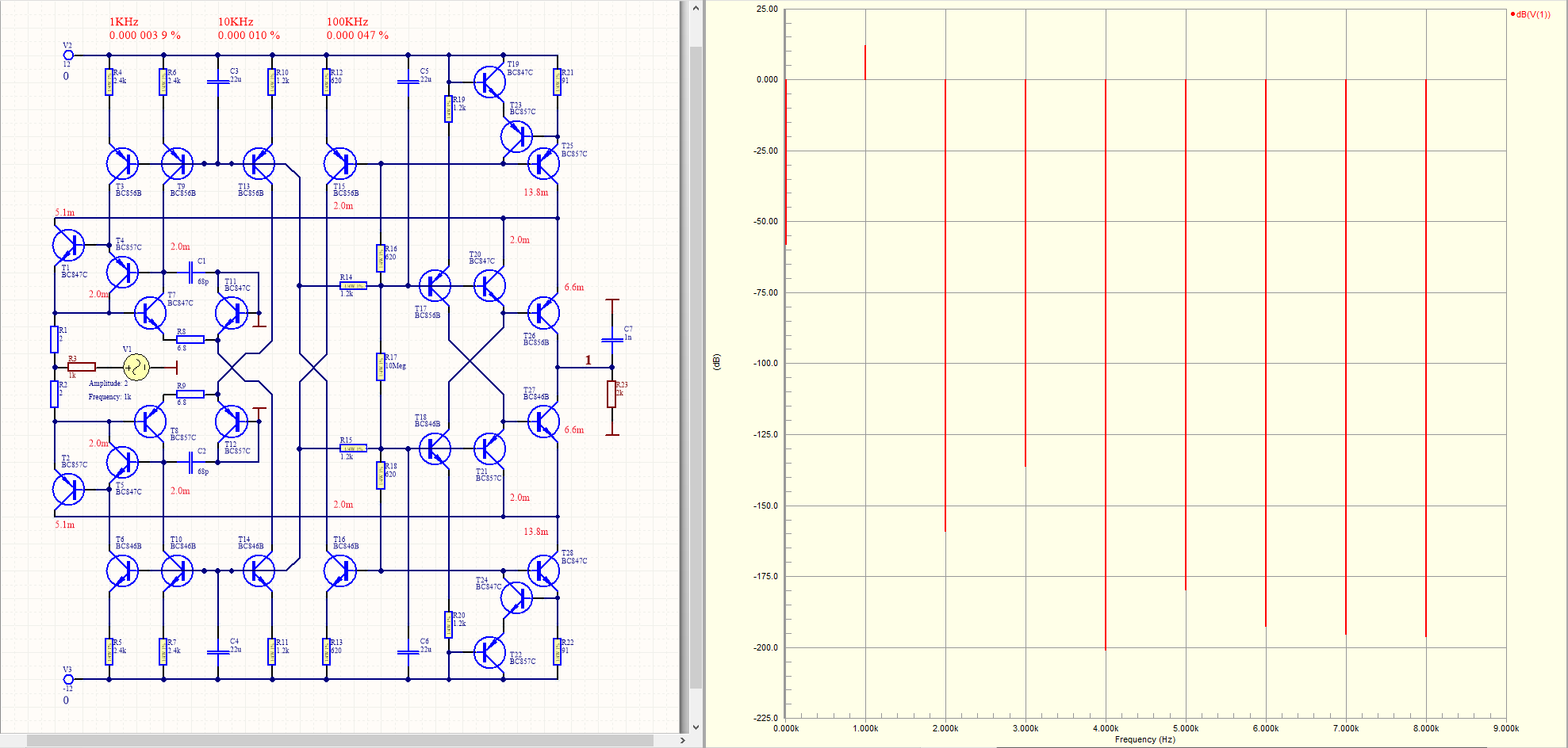

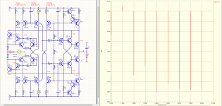

This is a real I-V converter.

> Naturally, this is done and live results are not different.
Then many congratulations.
Why not open a separate thread for this outstanding design of yours and show us all how to do -150dB without negative feedback ?
I am certain there will be a lot of resonance from this forum.
Patrick

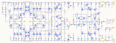

It will be fun to try this as an alternative output stage of the Pedja DAC with its AD844; thanks for the GB.
Can you please tell whether this i-v stage can also be used for an ES9038q2m dac with a differential output? For instance, would two per channel be required, with a mutual connection?
This is meant for +/-2mA max signal current per module.
Limitation is heat dissipation of the SMD devices.
So for higher signal current with a DC bias (e.g. PCM1794), you will need :
1) multiple modules in parallel per single ended output (PCB is designed for that);
2) a low-noise constant current source for DC bias.
It was designed for the likes of AD1862, PCM1704, etc in mind.
And not for high output current DACs, e.g. AK4499.
BTW a single AD844 can handle much less signal current (in Class A) due to its low bias.
