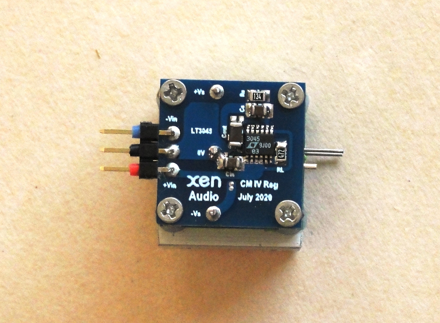

Hi guys.
Regarding a psu for these boards....
I am creating 4 rails, so 2 pos and 2 neg but using 4 times LT3042, so obviously each will have its own winding and rectifier.
Regarding transformers that I wish to order, I though about using small 'blue' encapsulated trafos. Maybe 6va so 3va per regulator. Is that enough or should I be upping the power rating.?

Nice copy.
But this is already superceded by something else :
