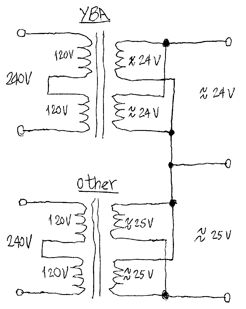

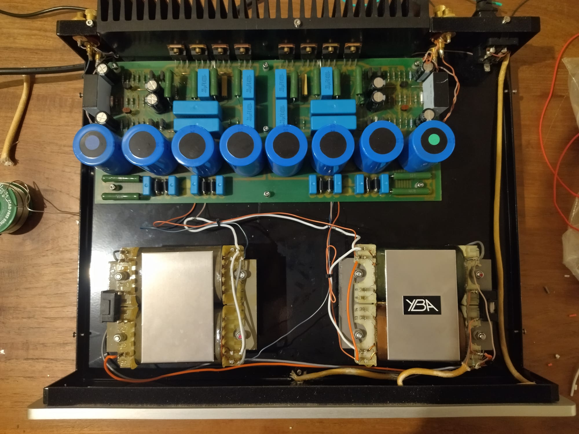

Michel, we have to double current, not voltage, surely I explained badly, my problema is to use two (slightly) different voltage trafo putting in parallel two windings per branch, not in series. If amp worked with one trafo at 25+25 volt, with two trafos it must work still at 25+25 voltHere is the revised drawing of how you should wire your actual transformers to have the same voltage on both sides.
In this situation of a stereo amplifier with originally 1 transformer but expanding with a second transformer one would use 1 transformer per channel. Not in parallel feeding 2 channels, where is the benefit in doing that!? And using 2 unequal transformers in parallel is silly. Using 2 slightly unequal transformers in 1 per channel mode is then also better (for a second reason).

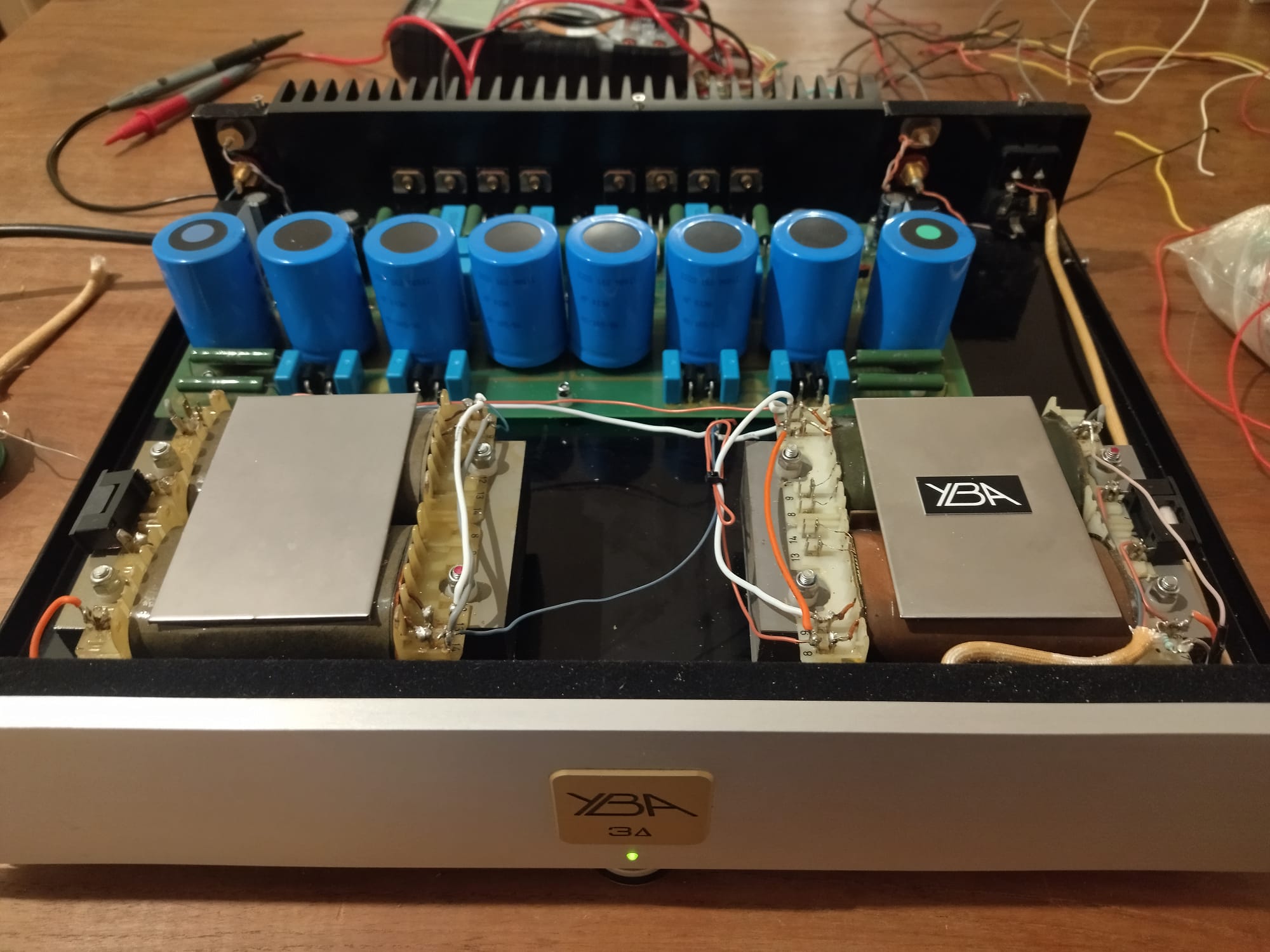

I was amazed when I saw this type of design, especially seeing that the structure of the motherboard would easily allow dual mono circuitry. The explanation I gave myself is that, if the nature of the audio signals were perfectly symmetrical in intensity and phase for both channels, then it would not make sense to put the two transformers in parallel and dual mono design would have offered a better separation between the channels, but since music is anything but symmetrical between channels, then a peak in current demand for one channel can use up the current reserve not instantly used by the other channel, not possible in dual mono design. I don't know if my assumption is true but I can guarantee that the addition of the second transformer (albeit with the problem of the voltage step) with the parallel secondaries technique has given a great improvement to the sound performance of this toy, which drives the CS2 .4 with extreme ease and fluency.In this situation of a stereo amplifier with originally 1 transformer but expanding with a second transformer one would use 1 transformer per channel. Not in parallel feeding 2 channels, where is the benefit in doing that!?
I think also that this hybrid structure (between dual mono and common supply unit) with separation just after the virtually unique trafo in two separate channels with individual bridges and levelling banks, helps much in channels separation.

Another thing I've found 'amazing' is that all internal cablage (minimal in effects) was made using the same wire tipology, a very thin single filament copper wire, for everything, power supply, audio inputs, audio outputs, 220 volts and led, everything with the same thin mono filament, which seems to have perhaps a good insulation material.
To this extraordinary 'uniformity' I couldn't find any explanation yet..!

You mean solid wire? This was in fashion in the eighties/nineties at some brands but it has drawbacks too. Electricians do not like it because it may break in time. It is not suitable for wiring in vibrating environments.
It is surprising how much current can be pushed through thin wiring. You know as the second transformer made the difference with extra possible current. The iron and copper loss tests at school come to mind 🙂 Paralleling different 3 Phase transformers with different clock numbers. Oof.
Sure, solid thin wire..! Somebody however already told me something about oddity of this amp's (or same brand others' too, maybe, I don't know) cablage. I must say the the sonic result is however really interesting, despite those things.
What may be the difference between this C-core and a R-core which maybe I've found in commerce? Are C-core replaceable by R-core maintaining the same good sonic results?Re sound: If you look closely at the picture in post 1, you will notice that the transformer is a C-core. Primary and secondary on separate bobbins. This results in a much "softer" coupling compared to a toroid, and it`s intentional to get the sound that he, YBA, wants. So, whilst it`s no problem replacing the stock transformer with a doughnut, it totally alters the timbre of the amp.

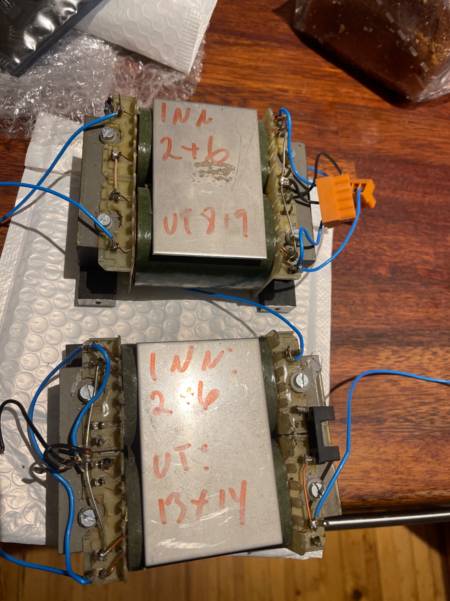

Thank you very much! I fear that yours are quite older than mine and for this may be different. Maybe I could think to substitute both mine with a matched new pair of R-core of pretty much VA (as 2x300), quite easy to find in commerce, and give amp an even more rock solid supply.pictures as promised. I have to identical ones
