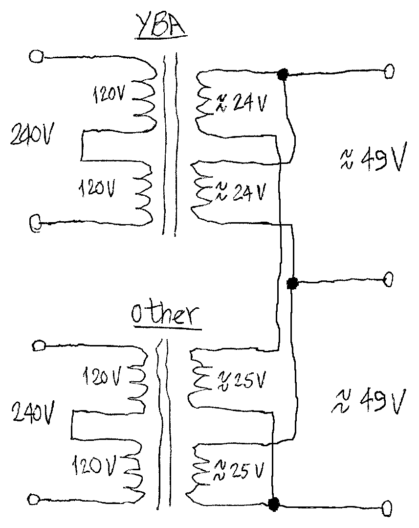

Post 2 shows two 24V windings in parallel, but notes 48V delivered, obviously inconsistent, so I'm not clear re what's actually desired.
IF ~ 48 to 50V is the objective, my suggestion was to series connect a 24V and a 25V winding to a 49V result; same with remaining pair, thus yielding two 49VAC windings.
Perhaps thread as already gone elsewhere. Sorry for any confusion.

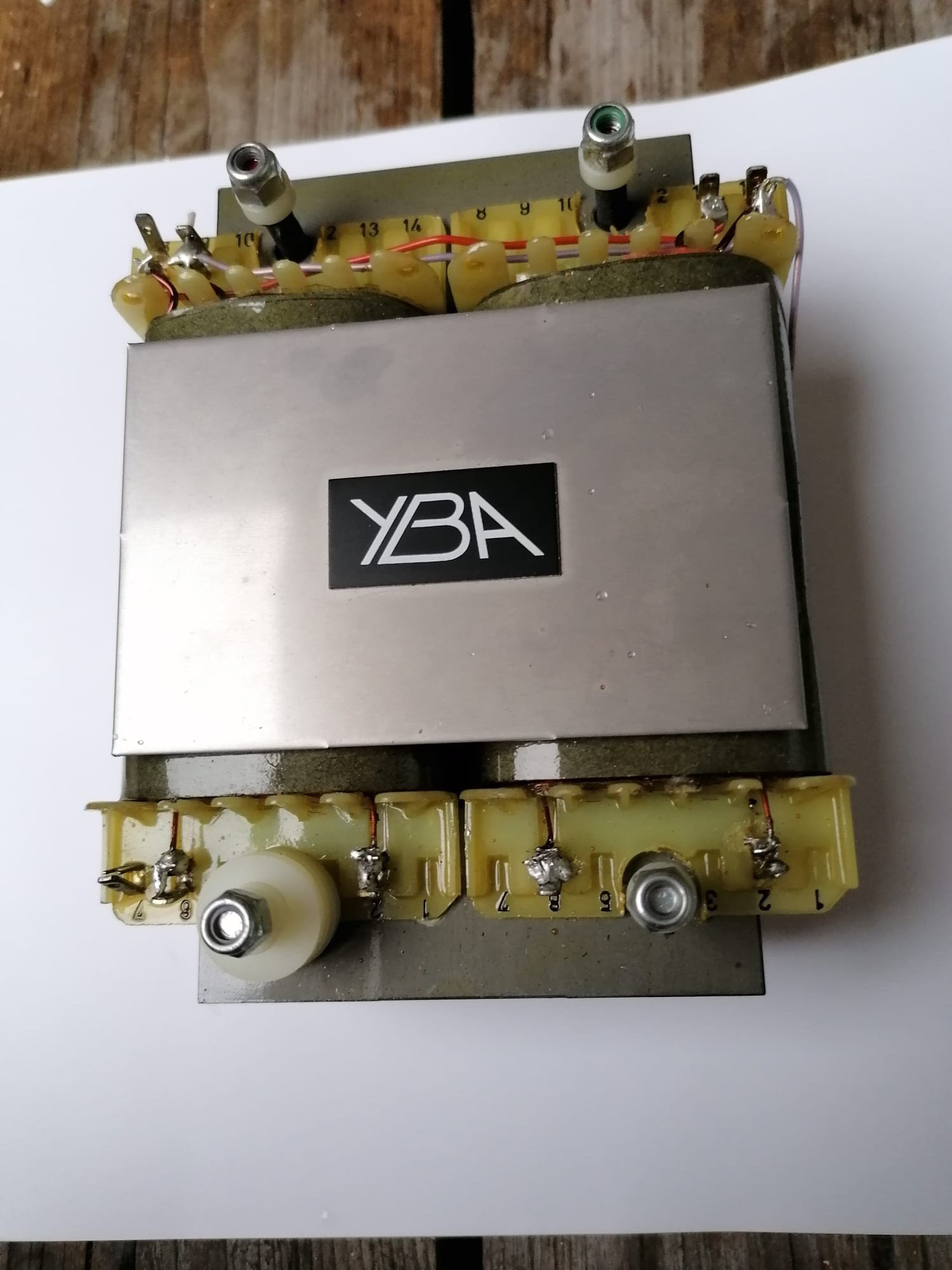

Re sound: If you look closely at the picture in post 1, you will notice that the transformer is a C-core. Primary and secondary on separate bobbins. This results in a much "softer" coupling compared to a toroid, and it`s intentional to get the sound that he, YBA, wants. So, whilst it`s no problem replacing the stock transformer with a doughnut, it totally alters the timbre of the amp.
Here's a more detailed picture of it. Very interesting opinion, in effects adding the second trafo has an unexpected positive sonical impact, is this tipology of trafo easy to find in commerce? As let's say 25+25 volt - 300 VA?
Already noticed in my following posts, the result is 24 volt or 25 volt per branch, because wiring is parallelost 2 shows two 24V windings in parallel, but notes 48V delivered, obviously inconsistent, so I'm not clear re what's actually desired.
The better result when adding the second transformer is probably due to the lack of current of just 1 transformer because of the low 3..4 Ohm loads. I would not worry too much about timbre as you seem to need current. According to Michel in post #2 many customers want the HC-DT upgrade which suggest the original transformer is chosen too light in power. You could experiment with a cheap switcher if the amplifier goes forward or backward.
Toroids are the last on the list to consider it seems. YBA is right. R-cores are about as hard to find as 2 original identical YBA transformers (I take you did contact YBA for that?). Choices narrow down to only a few options.

Hi I think you want to rethink the drawing. Had to look a few times but I am pretty sure 🙂RM,

Here is the revised drawing of how you should wire your actual transformers to have the same voltage on both sides.
