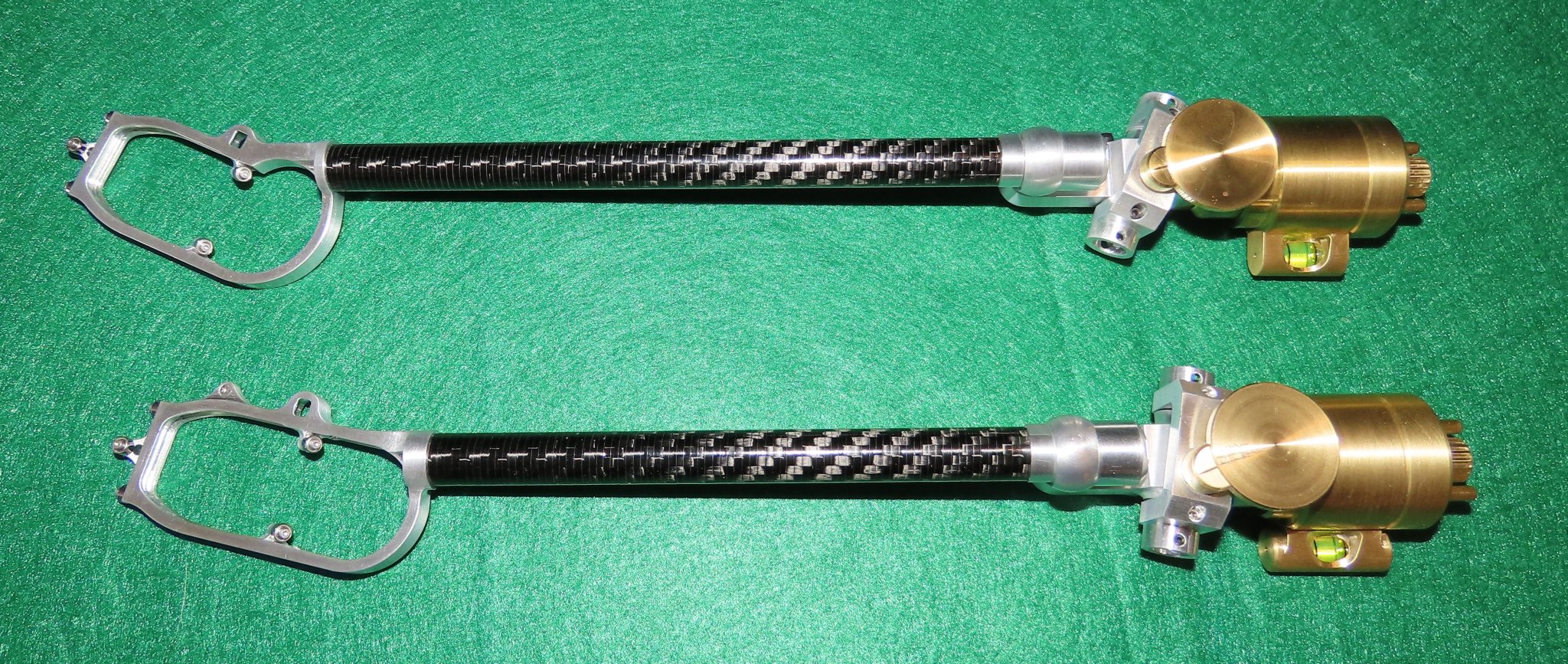

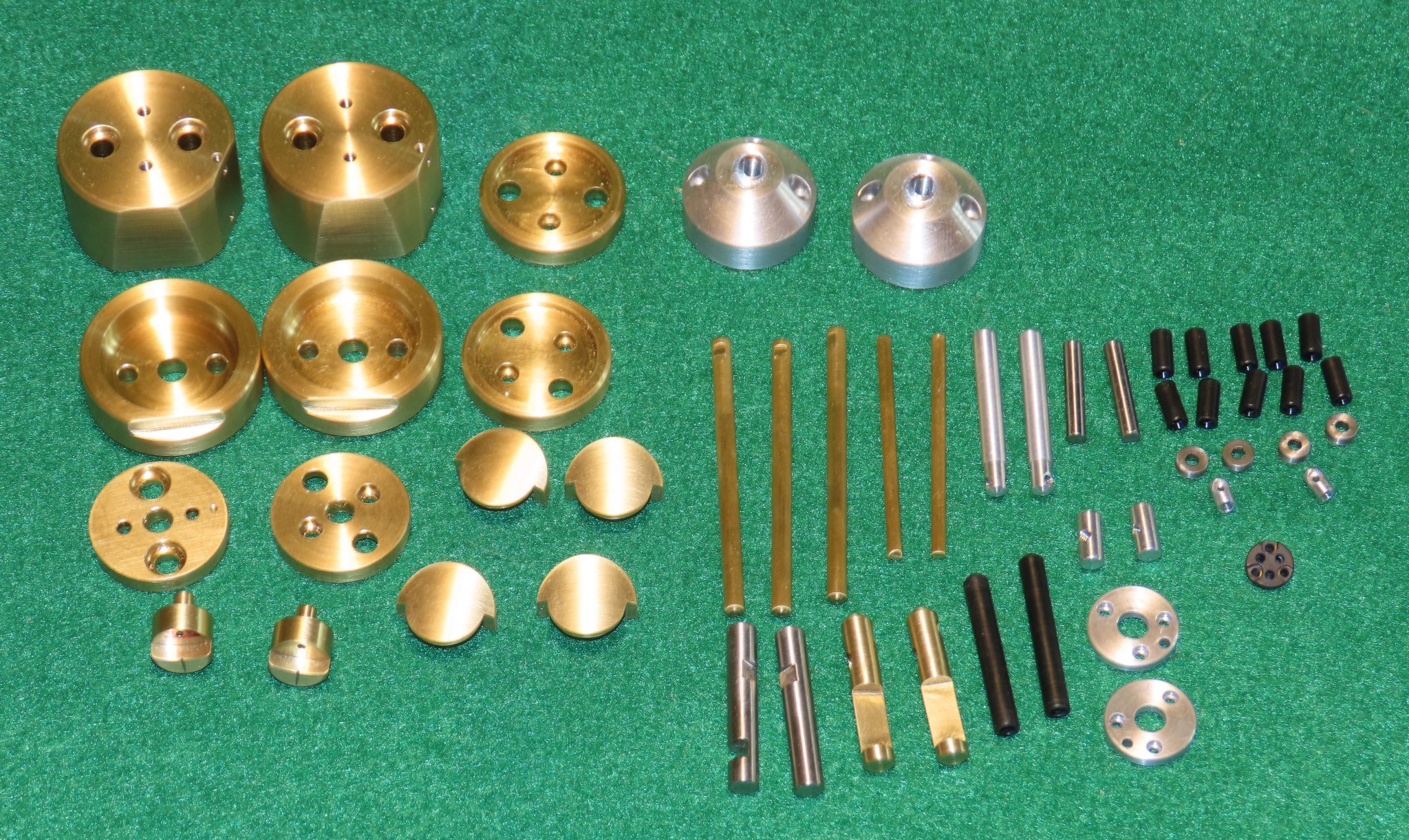

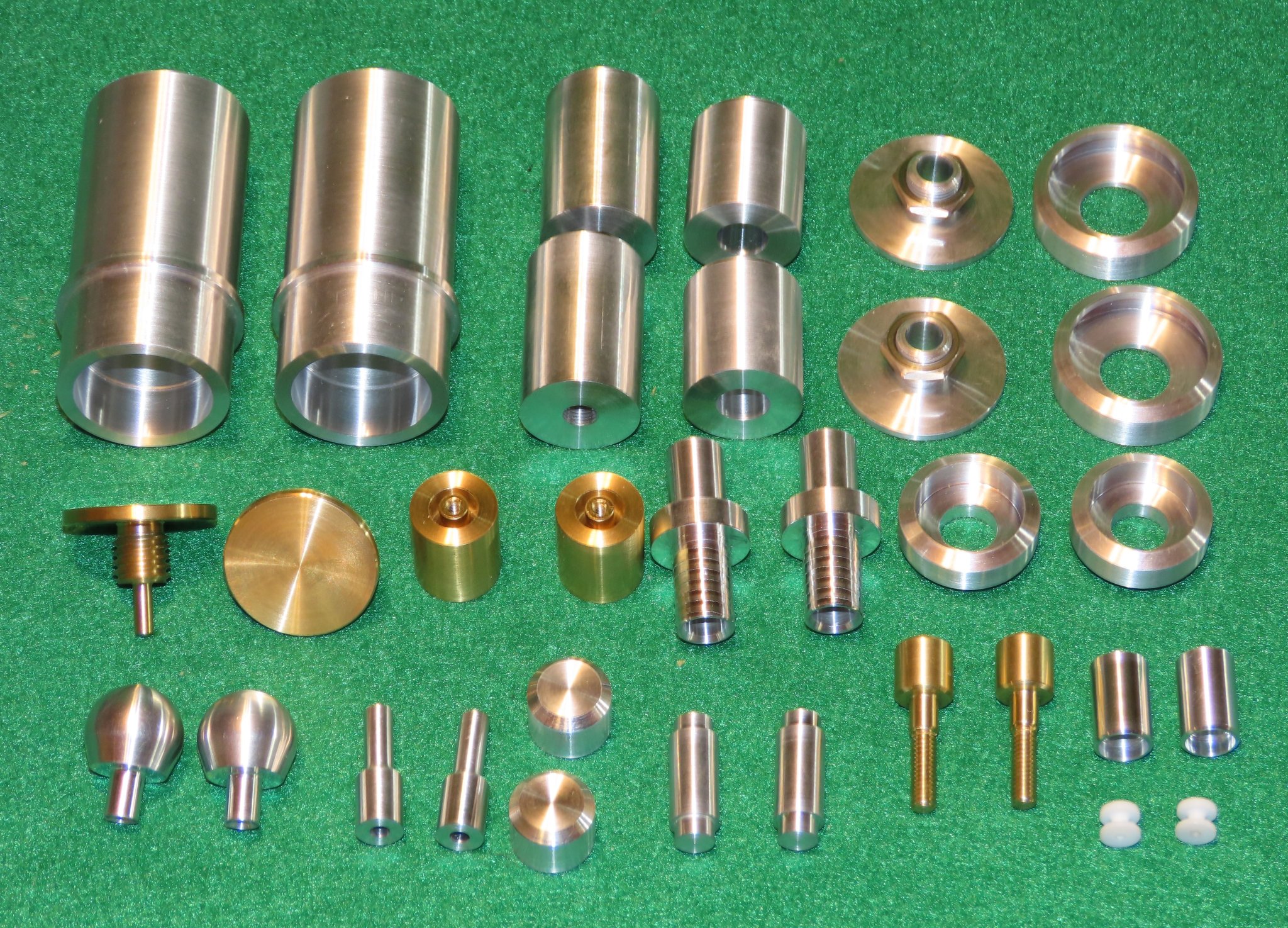

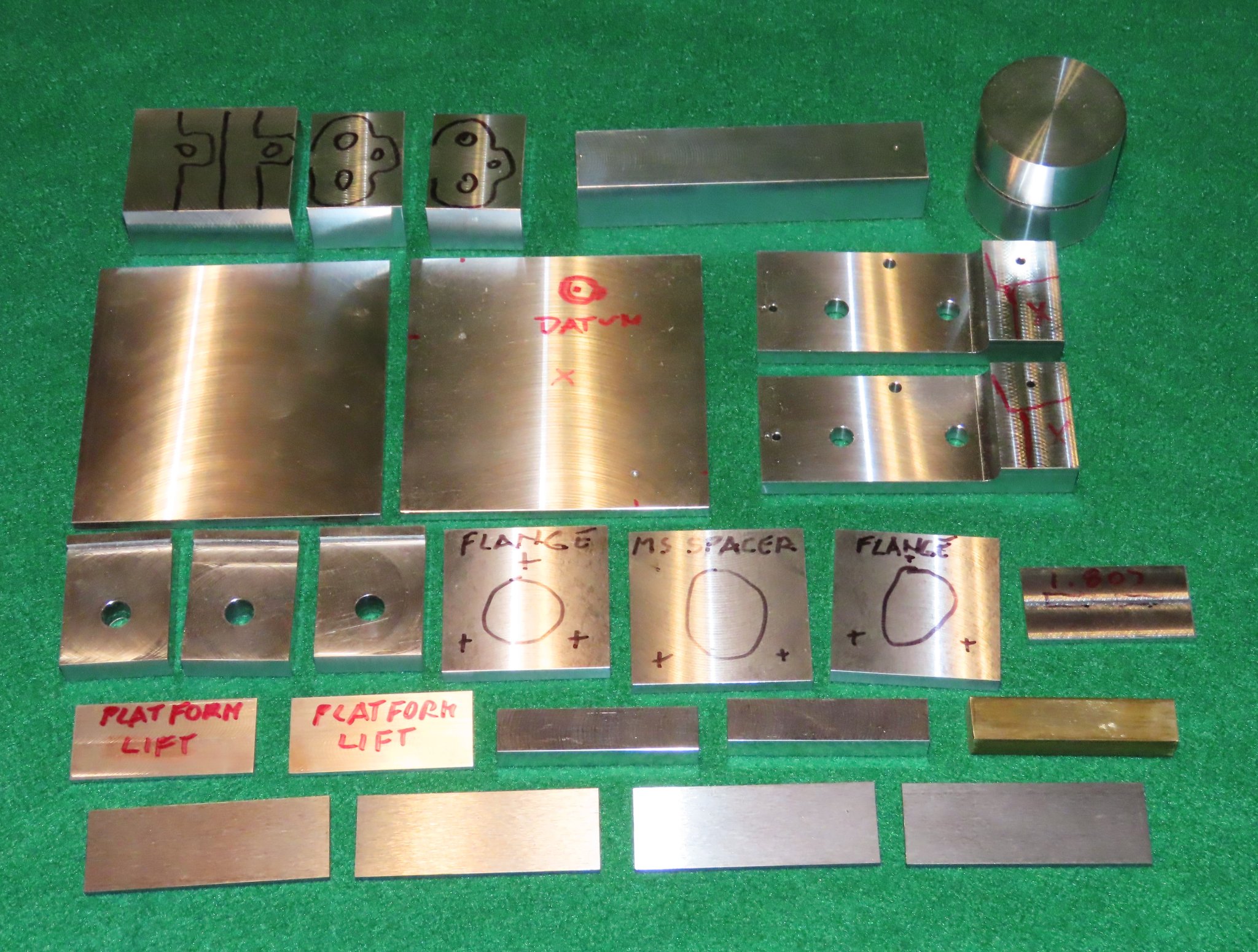

Hello everyone,
I have made great progress since I announced that I would build two improved tangentially tracking tone arms. At that time, I had finished all the CAD work and I was ready to start making hardware. Since then, I have ordered all the materials and off the shelf items. I divided all the parts to be made into four groups: 1), Lathe parts that I would make in my friends shop, using his lathe, 2), Lathe parts that I would pay another friend to make in his shop, 3), CNC parts that I would make in still another friends shop, using his CNC vertical milling machine and 4), parts that I would make in my own shop using my own Bridgeport milling machine. The parts in the first group are completely finished, while the parts in groups 2) and 3) require secondary work in my own shop.
The pictures I am posting, are from all four groups; some are completely finished and some need secondary operations.

A great project. Every part is like a work of art. I am curious about how you process these parts. Do you have modern CNC machining centers or do you rely on manual and semi-automatic machine tools?
Hi zincho,
Both. I have a Bridgeport vertical milling machine with a variable speed head and I have three friends who have CNC machines. The three friends are former colleagues at the manufacturing company from which I retired. I took one semester of CNC programming, set-up and operating at a local community college in Prescott Arizona. I can set-up and operate their machinery without them having to do it for me.

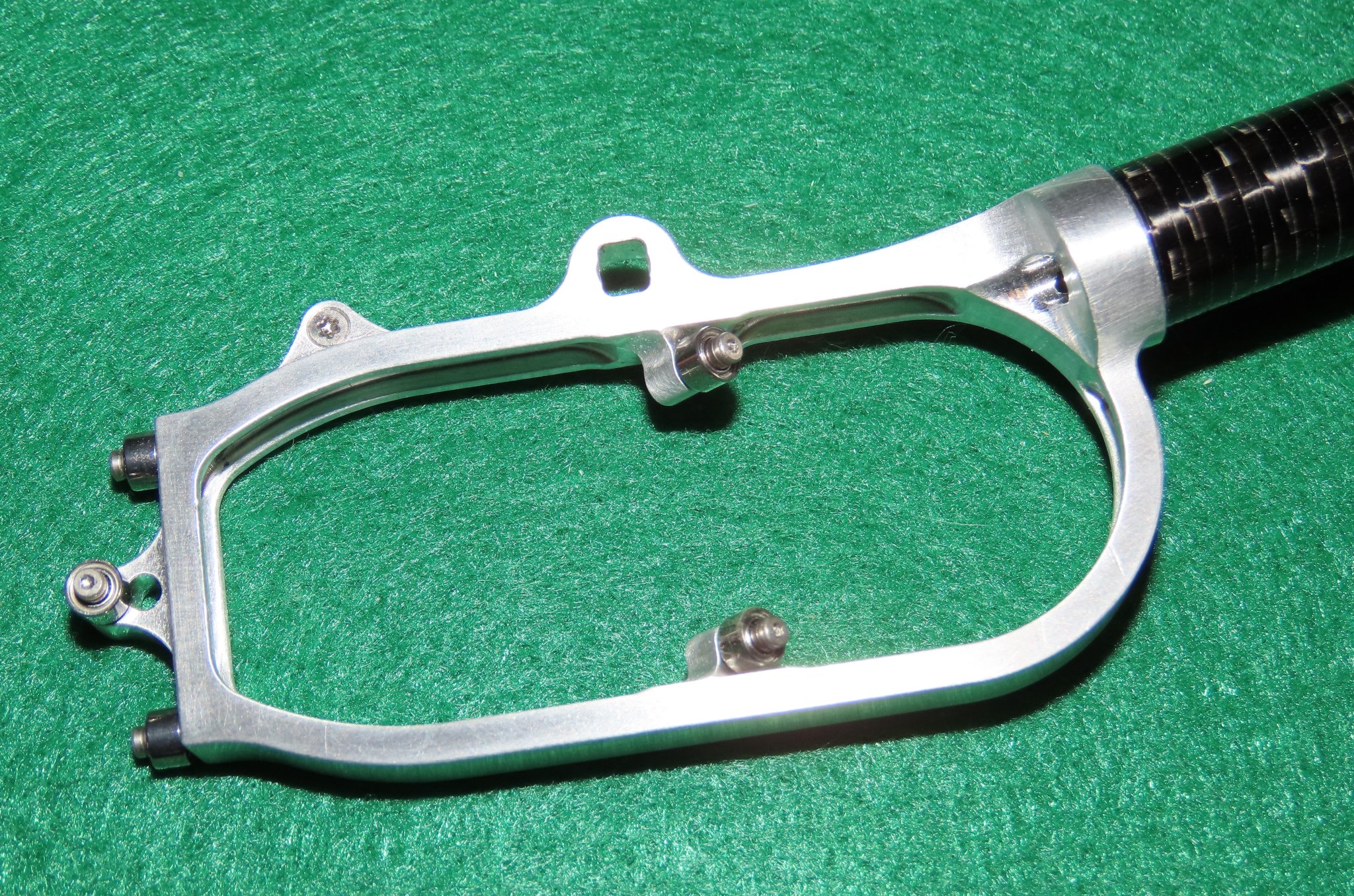

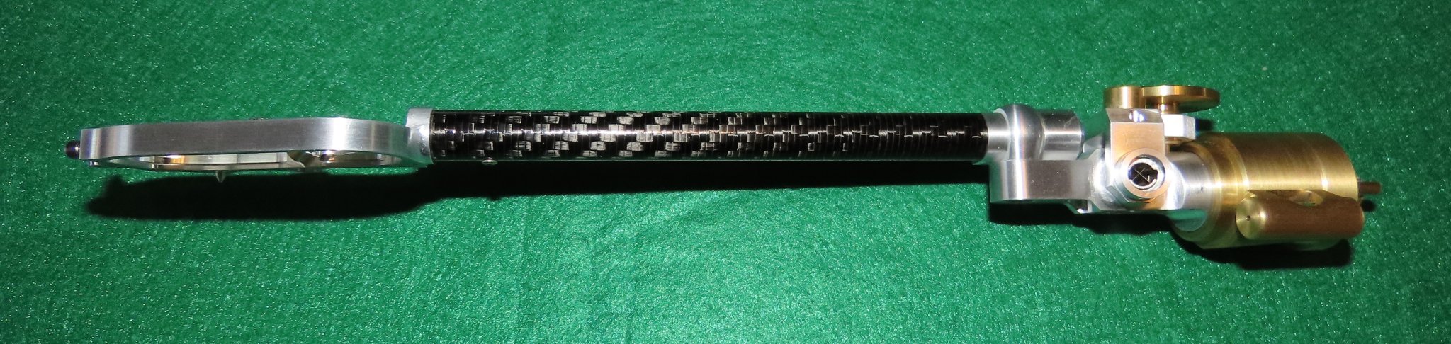

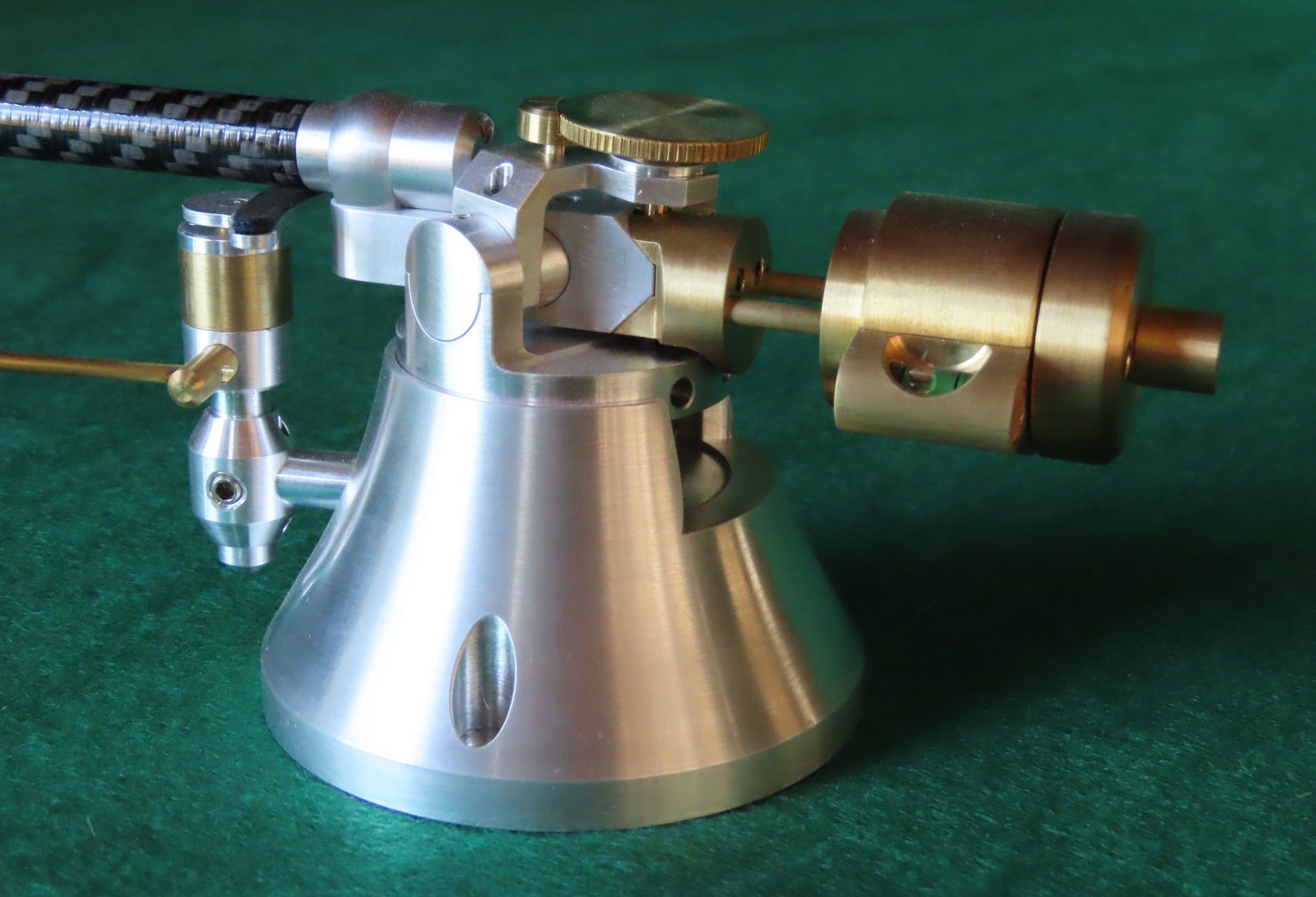

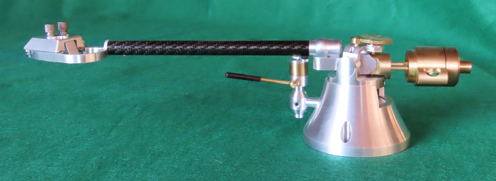

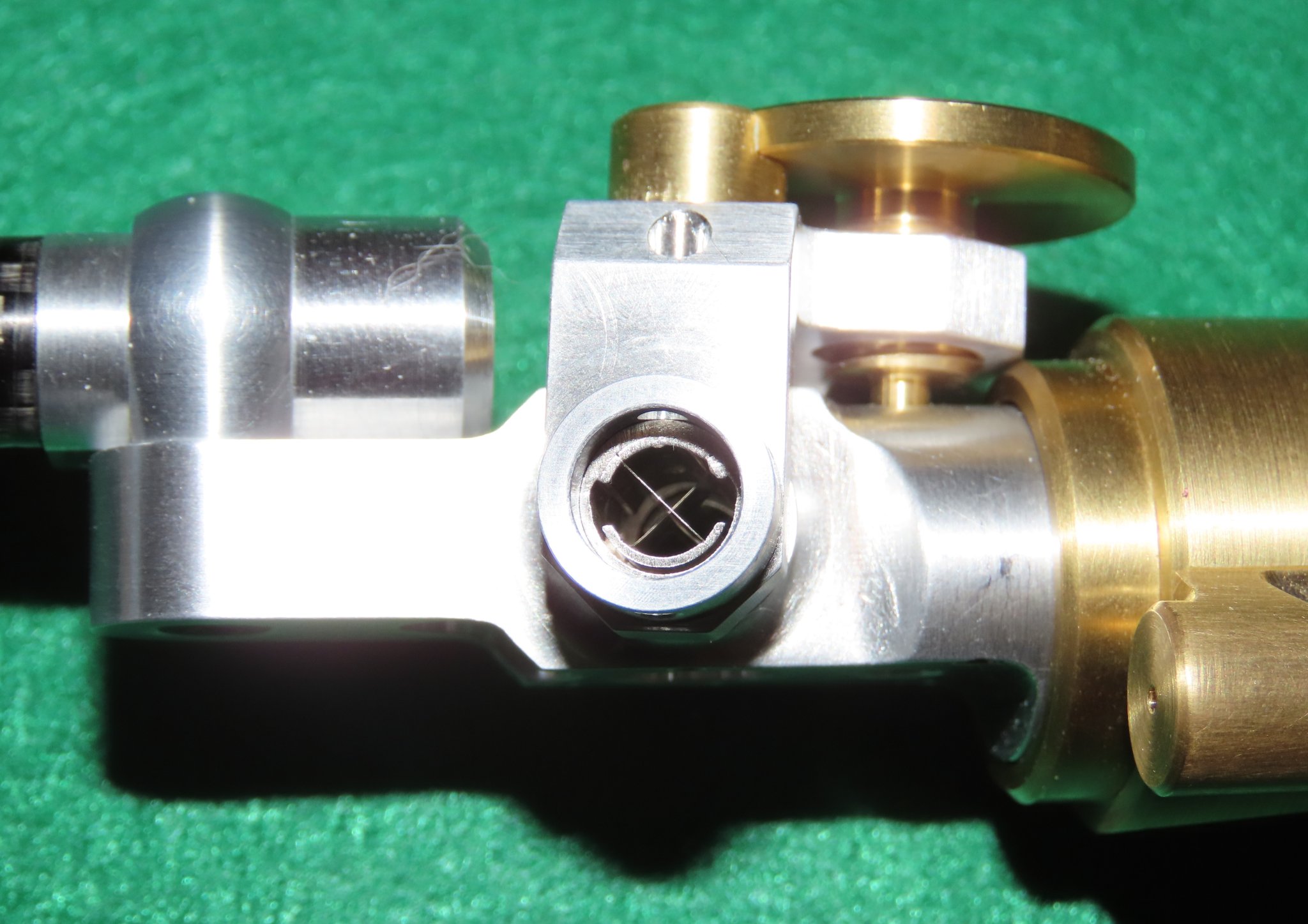

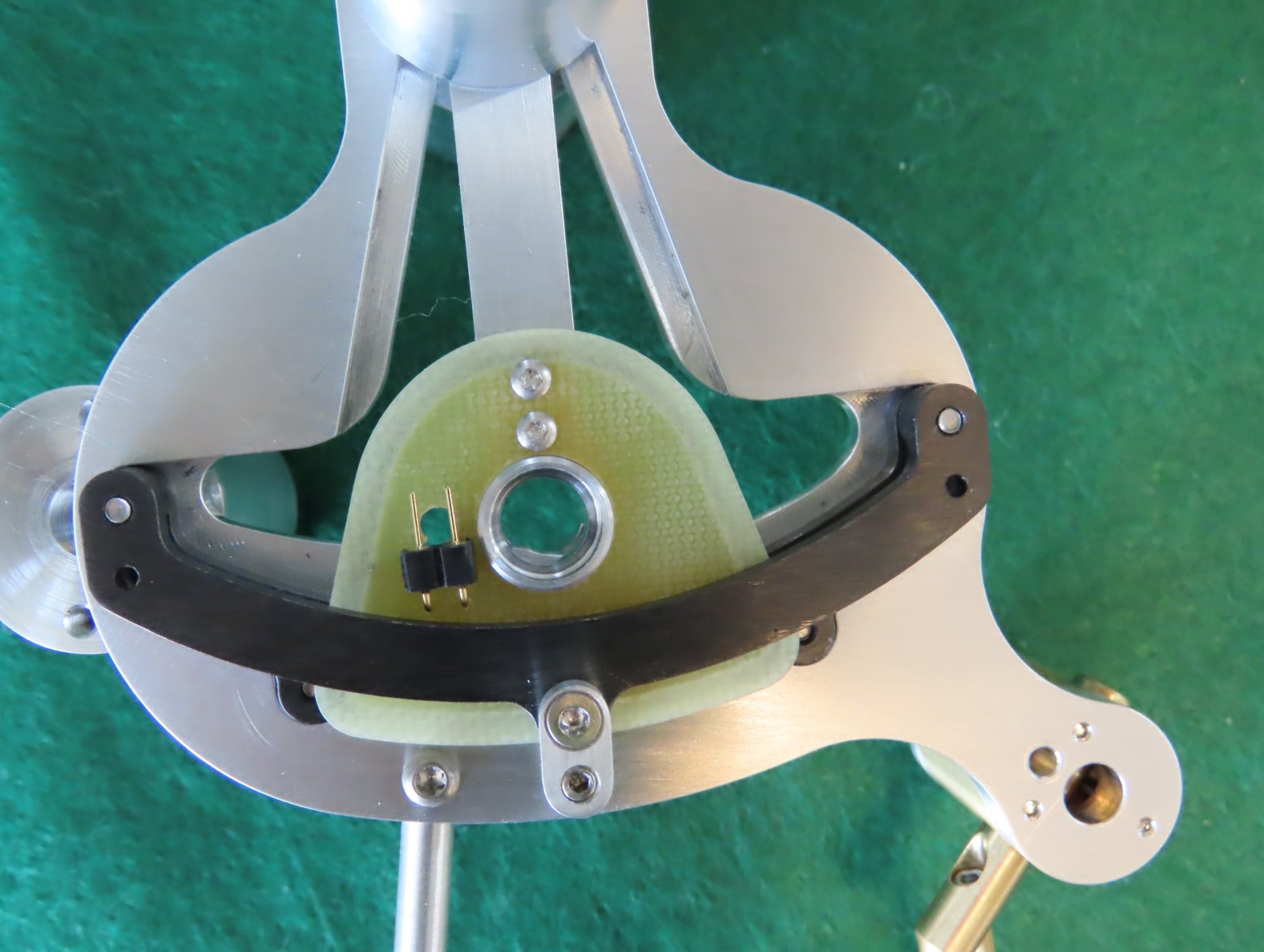

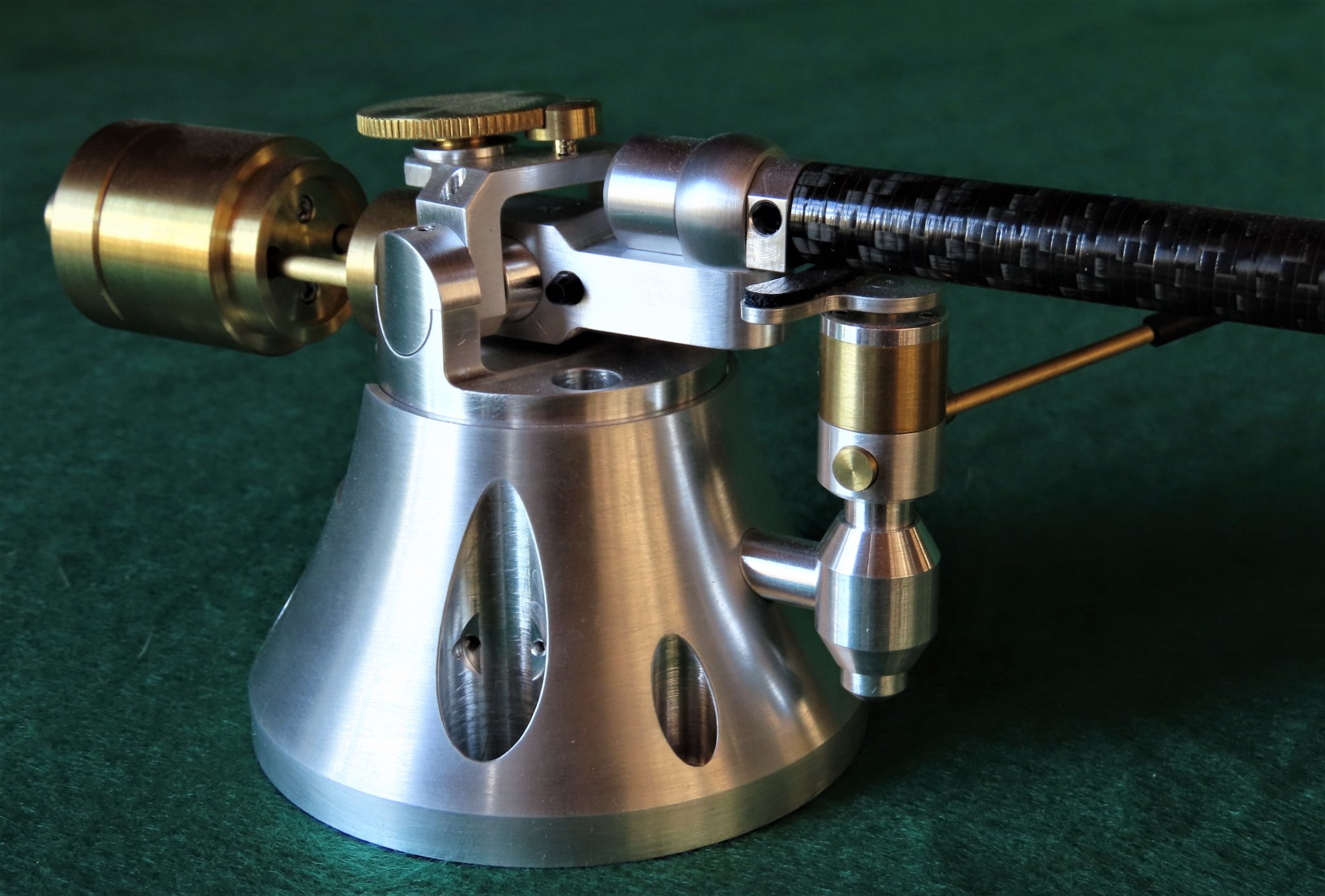

Hello everyone,
In 2022 while I was preparing my application for US patent, I discovered that, my design of the floating head-shell would also be of benefit to conventional pivoting tone arms. So, at the behest of a European manufacturer I designed and built five conventional pivoting tone arms with floating head-shells. The overall design incorporates certain improvements over my original 2019 tangential tone arm.
When I decided to build the new improved version of my tangential tone arm which is the subject of this thread from now on, I decided to include some of the improvements from the conventional pivoting tone arm.
The first photograph shows the conventional pivoting tone arm and underneath it shows my new and improved tangential tone arm. You will notice, that both arms have an off-set cradle. The off-set of the top tone arm is of conventional Baerwald construction while the off-set of the bottom arm is ~12 degrees.
You might rightfully ask, why a tangential tone arm would need an off-set head-shell?
There are two reasons for the off-set: A pivoting tangential tone arm's pivot has to be moved from point A to point B during the playing of an LP. If the tone arm has a straight head-shell, that distance would be ~1.6". By off-setting the head-shell, that distance can be reduced by close to 50%, resulting in a less bulky support structure. The second reason for off-setting the head-shell is that, it makes the arm "self-propelled" as it traverses the LP.
My 2019 tangential tone arm featured diameter 5/32" flex pivots, whereas in my improved version I doubled the diameter of the flex pivots to 5/16". They have the same spring rate but are sturdier and easier to handle.
The second photograph shows a side view of my new tone arm.
The third photograph shows a close-up of the flex pivots. I didn't give that away until now, but I twist the flex pivots to apply tracking force. The arm always remains dynamically balanced.
The fourth photograph shows the cradle, featuring a spike to set tracking force without resting the stylus on the tracking force gage. This website inserted the fourth photograph as if it were the first. WTF?

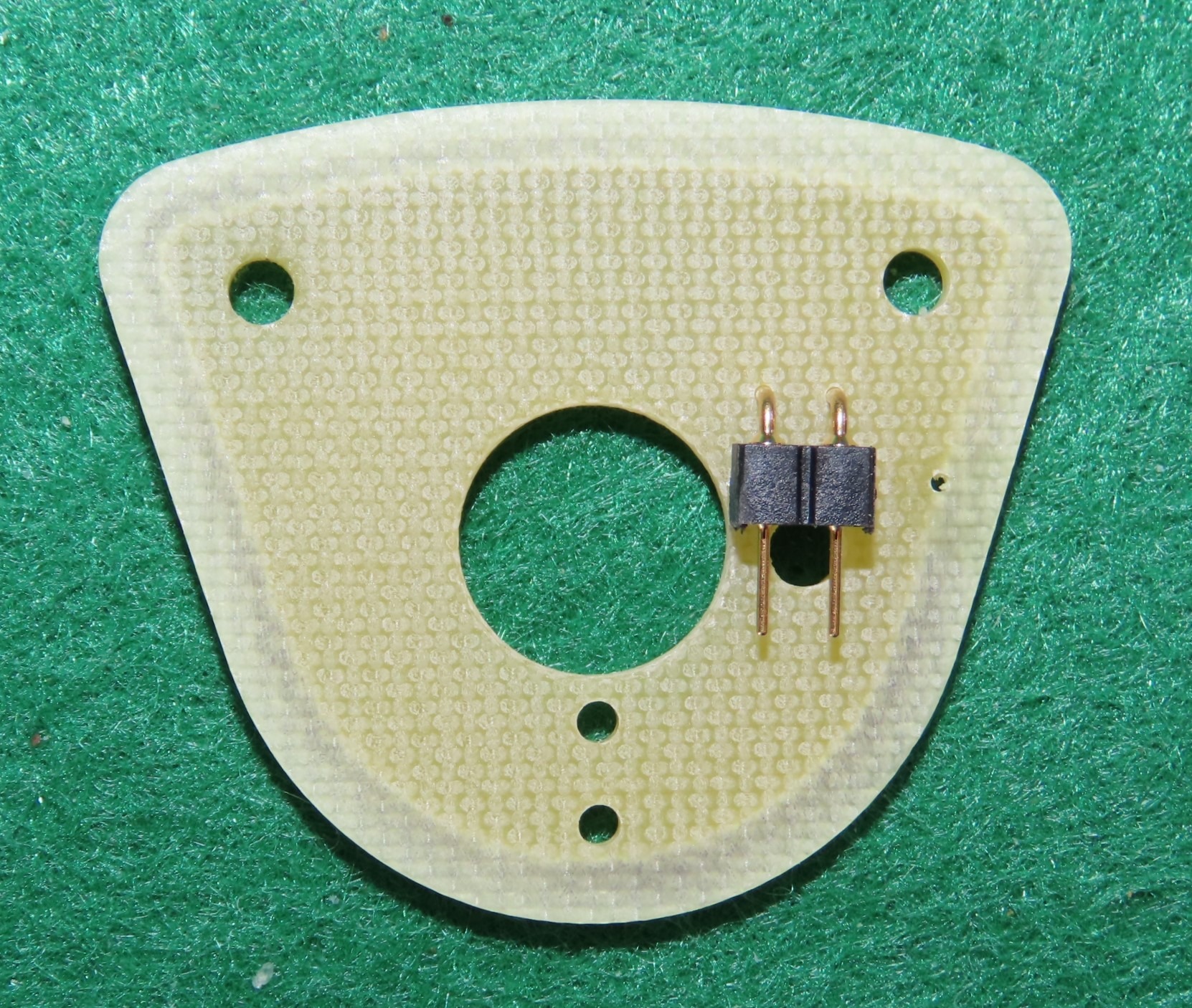

I have three CNC parts yet to make after which I'll do the wiring and the PCB assembly.

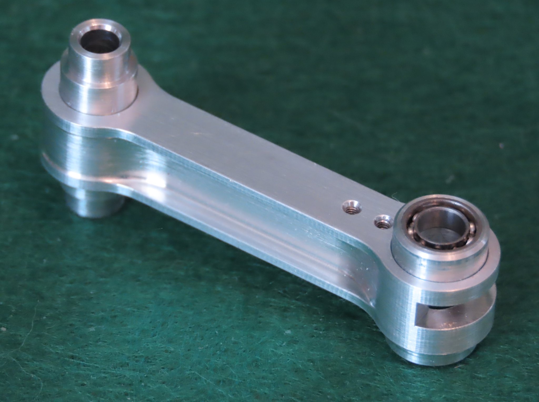

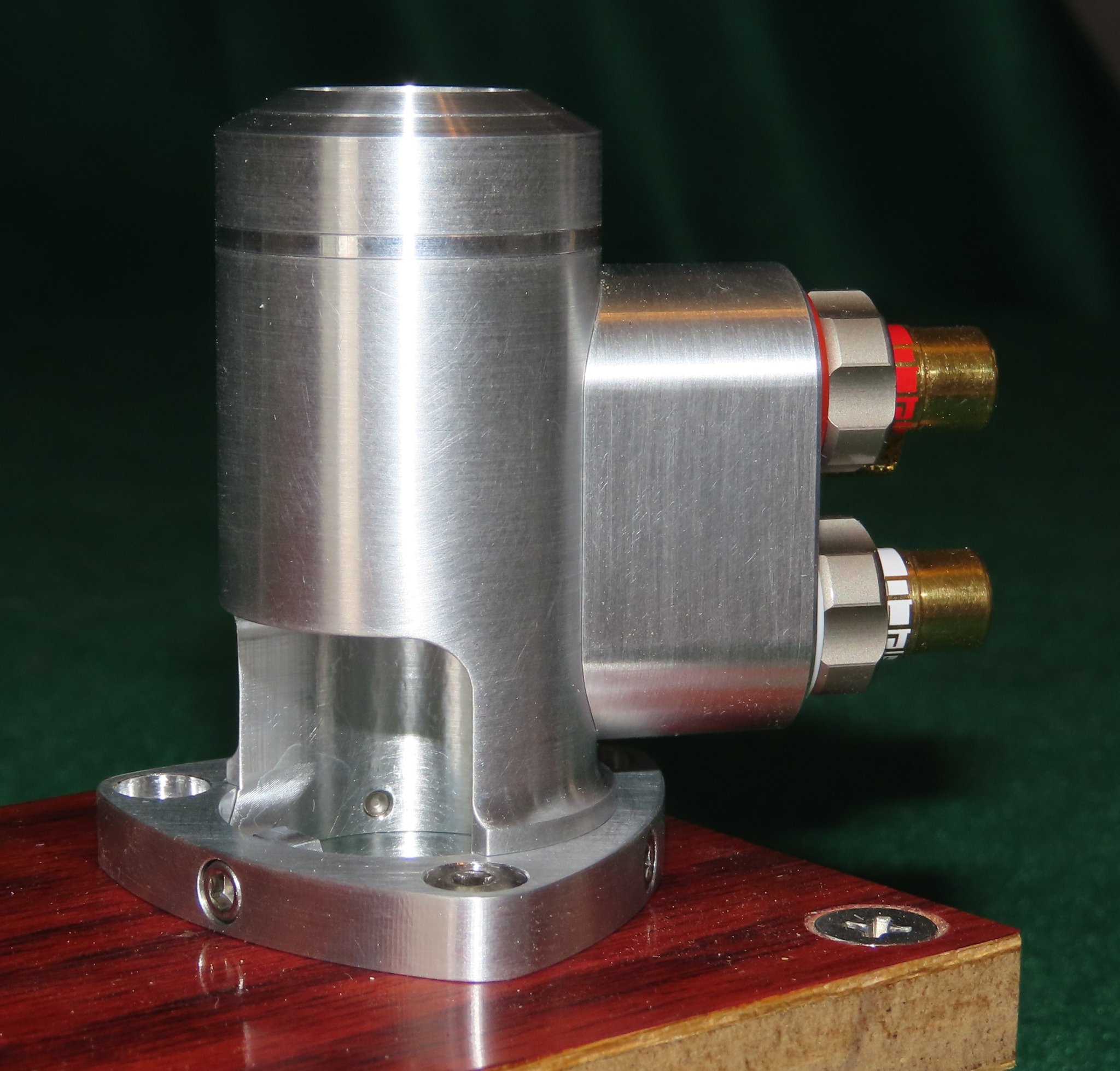

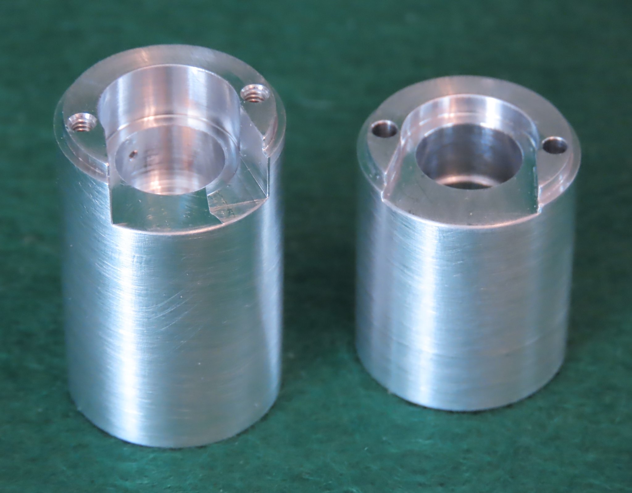

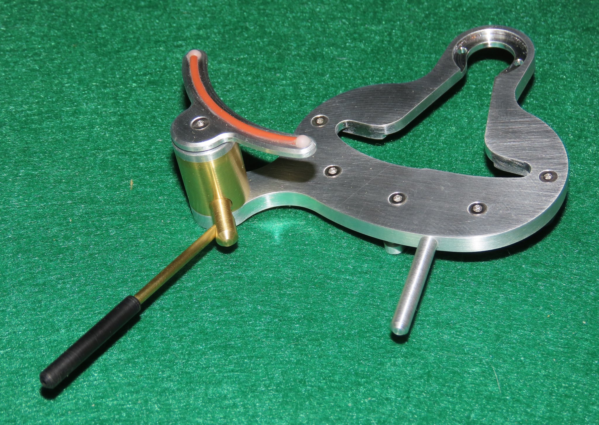

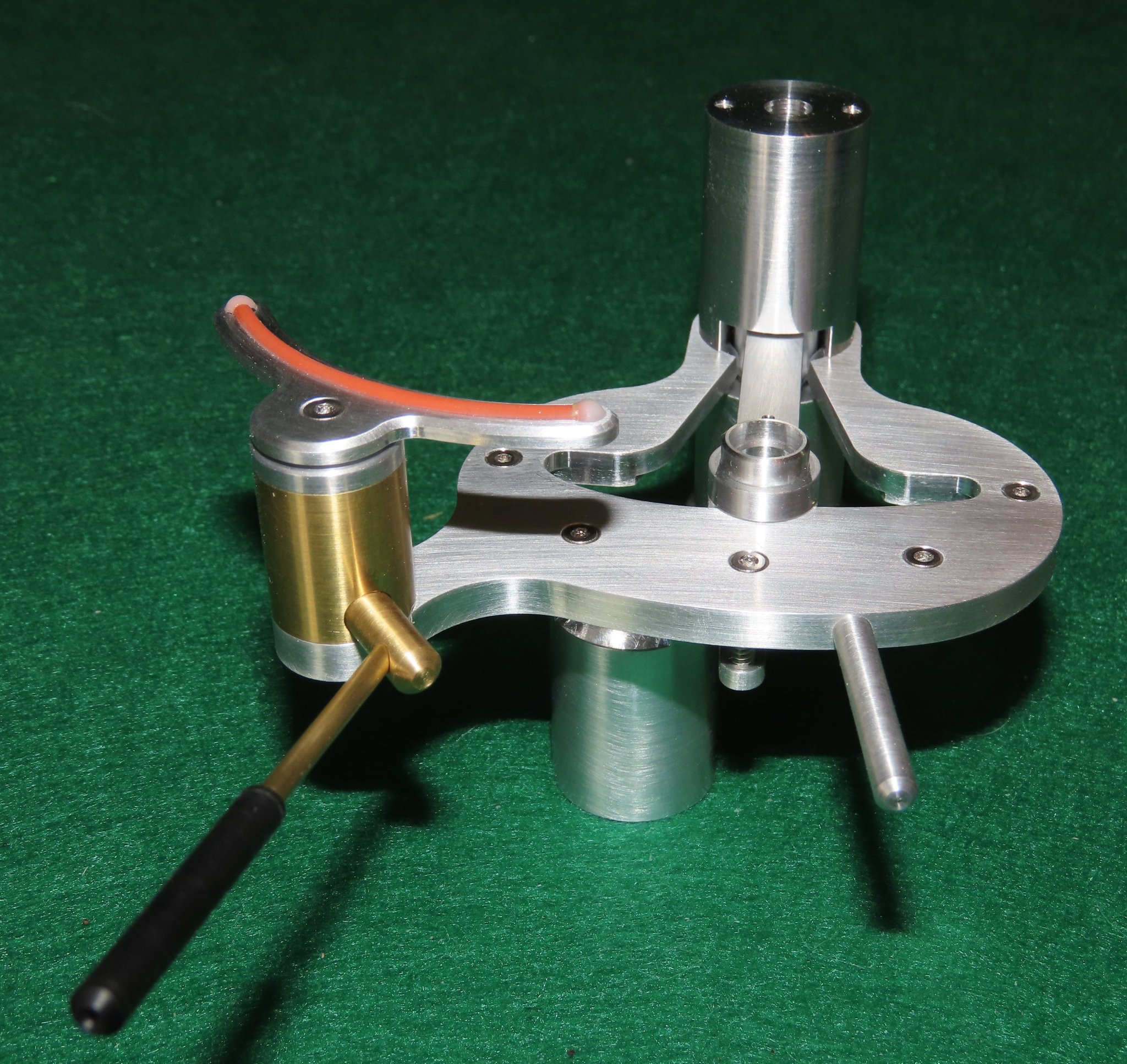

And tonight, I'll have a few more photographs for you:
This is the central column that is immovably fixed to the turntable's tone arm mounting board. the tone arm support structure will project from the window just above the mounting flange. The RCA connectors can be seen at the right.
This view of the central column gives a better view of the RCA connectors.
I call this the shelf assembly. It pivots about the vertical center line of the central column and is also designed to move up and down for vertical tracking angle control. It incorporates the all-important tracking cam which assures 100% tracking angle accuracy. It also incorporates the hydraulic tone arm lift and a handle to rotate the tone arm from an "at rest" to a "start of groove" position.
I call these two cylinders "trunnions". The short one attaches to the bottom of the shelf assembly and the long one attaches to the top of the shelf assembly. They enable the shelf assembly to rotate horizontally and slide vertically. They are supported by non-metallic bearings without play.
This is the beam assembly. The top and bottom cylinders at the left rotate in ball bearings within the top and bottom trunnions, on the same vertical center line as the shelf assembly. The ball bearings at the right support the cam follower which is guided/rotated by the tracking cam machined into the shelf.
This is the bobbin for the voice coil motor coil, which has yet to be wound. It is attached to the beam in the previous picture.
This is the complete shelf assembly. The aluminum cylinder supporting the assembly on the green felt, is not part of the assembly. I just don't know photoshop well enough, to remove it.
This is the shelf assembly as viewed from the bottom. The curved black oxide part is the bottom magnet carrier. There are two magnet carriers, one below the bobbin and one above the bobbin, the latter being only partially visible. The magnet carriers and the bobbin with coil are referred to as a voice coil motor. It is based on the Lorenz principle.
It is 1:46 AM. I am getting tired. More tomorrow.
