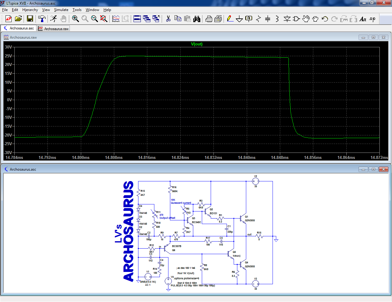

Here is the idea tested in sim, but the TIP41 stubbornly resists all tentatives....What if you delete the bootstrap at Q2 collector, connect said collector directly to the pos. rail; and instead bootstrap directly at Q2 base, and "harder" i.e. with higher current? This would throw away some positive swing headroom, but may be "faster" in the end?
That's a little harsh, imagine the Q3 fearing for its life ... what I meant was a "classic" bootstrap with a split resistor (R3 -> R3a+R3b), like f.e. 2k2+2k2 and the C1.
So the TIP41 is the reason for the slow pos. slewrate? What if (in sim) you replace it with the BD139 model? Should be faster. Or is the slow-ness elsewhere?
Yep.So the TIP41 is the reason for the slow pos. slewrate?
With a BD139, Tr and Tf differ only ~10%:

I threw a quick sim in online falstad sim and it confirmed my "theory" outlined in p.#34. (the diode thing etc). One thing that should be obvious is that the present ratio of R1:R6 isn't optimal, R1 should be somewhere around 2/3 of the R6 (needs evaluation ???). Like 6.8R for R1 and 10R at R6 ... or similar.
My ..err.. "masterpiece" used a opamp to drive the NPN "quad-totem"; and the bootstrap section per my recommendation and it seemed to cope well with 2 Ohm load at +/-15V volts supply, and cca 16mA standing current (with the marvelous falstad BJTs that never fail). Delivered +14.1x/-14.4x Vp before flat topping.
So the assumtion seems valid and awaits furher polishing from dedicated developers.

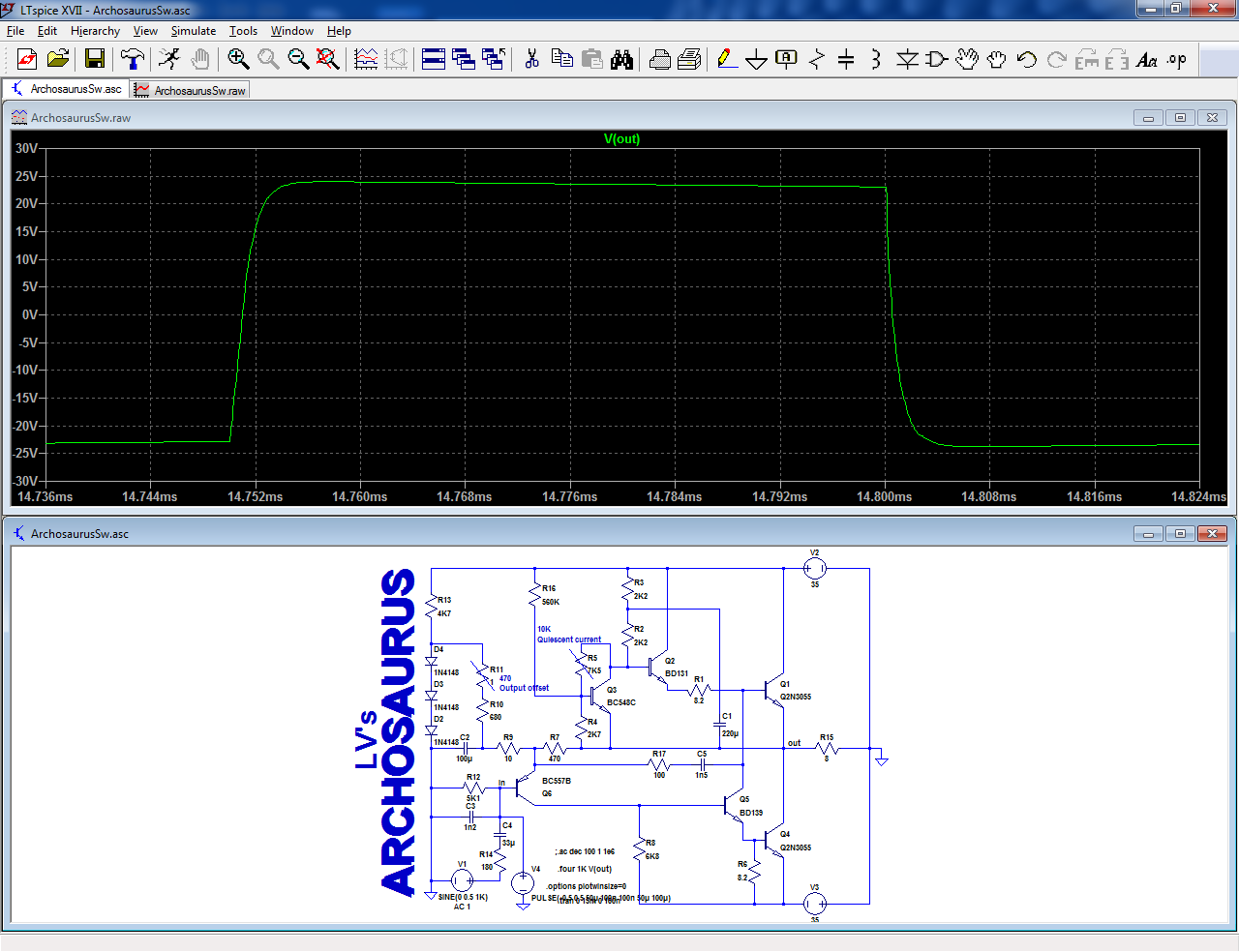

I shall post a single-supply version of the circuit (which is not going to be difficult, since it is natively so), and I'll try to come up with something that suits you (but it will be virtual, and other members may have other ideas)I do not have any center tap transformer under +-45 @ 1.5 A except +-17@100 ma for Archosaurus. Delete center tap connection, double the filter cap voltage, would the Archisaurus centerline stay centered? No DC servo that I see. So archosaurus is theoretical/desirable at under 50 wires, but power supply/case not in stock
The mods are relatively minor, and their main purpose is to allow a good time resolution (to see the edges in detail), without having to wait for ever for the average conditions to settle (there are certainly smarter ways to do it, but reducing large capacitors value is quick and easy).I think if the .asc file was to be posted it would shift the focus away from people making mistakes since from post 1 up to post 17 the basic structure of the circuit remained the same. There was a modification to this at post 30 and a further one at post 32. That leaves the early .raw files in need of an update.
Anyway, here is the "switching" asc file, also including a (dangerous!) speed-up trick.
The modified version suggested by Anti in post #32 is not included, because although it seems to work well, it does so by forcing the circuit to operate in class A, which is not desirable for a lean, class AB amp.
Using a BD139 in the initial circuit does markedly improve the slew performances, but not as much as with pure class A

Here is the asc and the BJT list of models I use (found on a wiki). You have to remove the bogus asc extension needed to bypass the forum limitation on txt size
