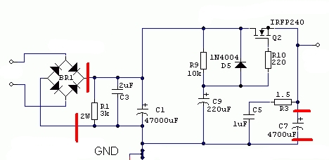

One way that I prevent turn on thump in almost any amplifier is to use a cap multiplier with a slow ramp up of output voltage. So in addition to providing ripple reduction of the power supply, it never has thump for turn on or off.
Pretty simple circuit (replace IRF610 with IRFP240 for higher currents) - this is design I got from Juma. I use this in almost all of my single rail amps now.

Can i just plug off the rectifier and pull in that little circuit before the regulator?
I suppose that would be what i can handle with my limited skills ;)
Can i 'recycle' the 4700µF cap on the regulator as C7 of the cap multiplier?
Best without screwing up the cap multiplier or the regulator ;)
I have downloaded the Juma sheme and tried to mark what i think to do (see pic)

I can't quite follow what you are trying to do :) in particular 'plugging off the bridge rectifier'.
For a conventional power supply you need in order from left to right, the bridge rectifier and suitable reservoir cap (47,000uF in your diagram which seems a bit big tbh). Then you could add the cap multiplier and following that your original regulator.
You need to ensure the regulator still has enough voltage to work with once the multiplier is added.

What i want to ask is where the right place for the cap multiplier is.
Between the regulator and the ACA or before the regulator.
The later one would be easy to handle.
Now i know. I will try to build that thing.

A cap multiplier added after a regulator will totally negate the final 'voltage regulation' of the regulator.
In other words the final voltage from the multiplier will vary with current drawn from the supply due to the finite impedance of the multiplier. That may or may not matter to you in this application.
Adding the multiplier before the regulator allows for increased ripple reduction (a good thing).
(Also remember that most voltage regulators like the LM1084 should not work into to large a capacitive load, 47 uF to 100uF is usually all that is required)

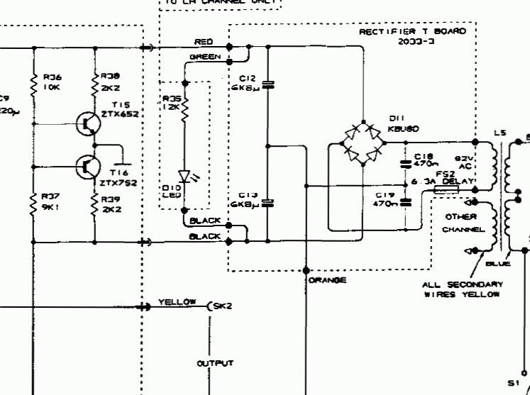

If you are interested in the virtual ground arrangement then have a look at the Quad 606 power amp. That is a 'DC coupled' amp using the junction of two series connected reservoir caps in the power supply as a virtual ground. The Quad achieves the correct DC balance between the caps not with resistors but with two small signal transistors.
