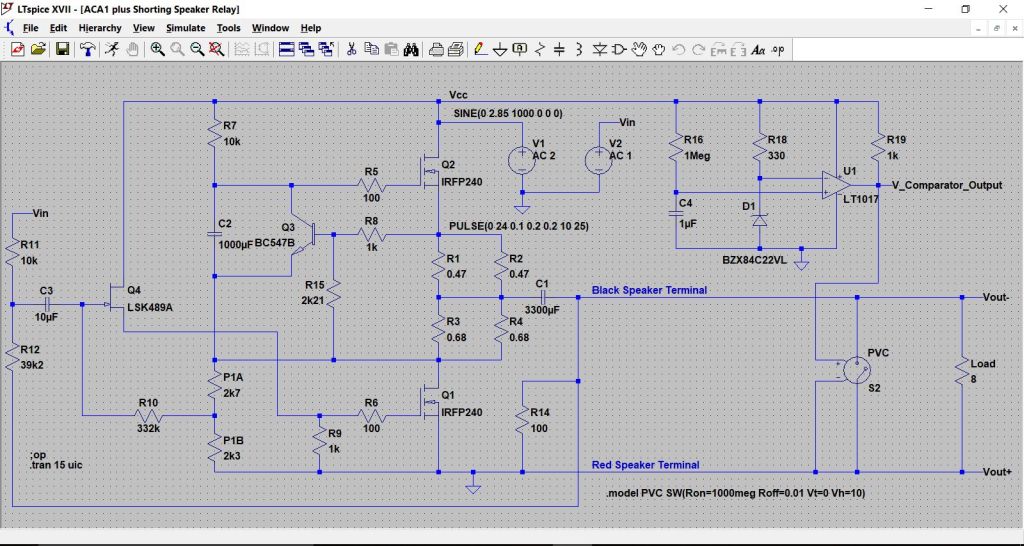

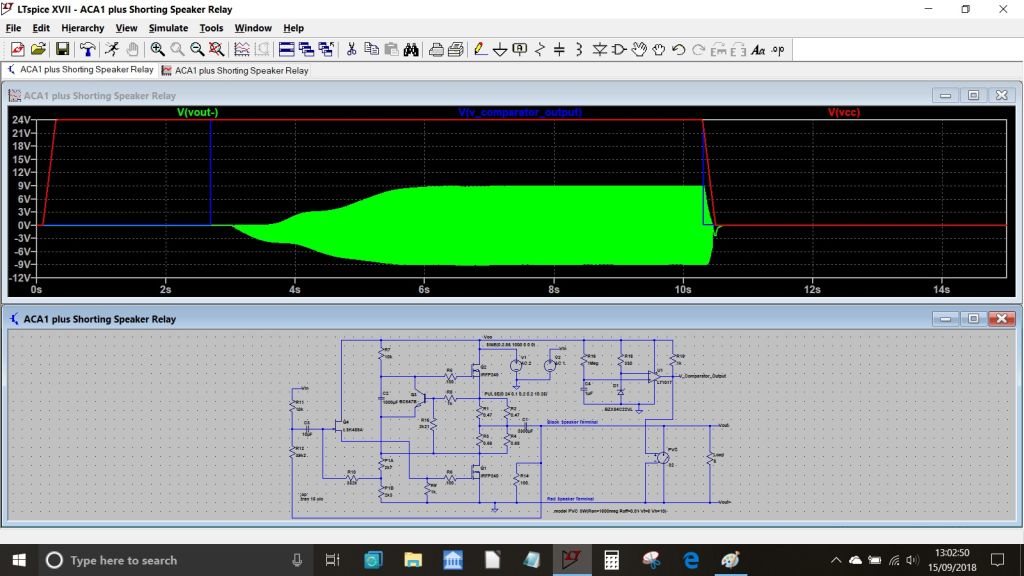

The idea of applying a short across the output at power on and power off could be viable.

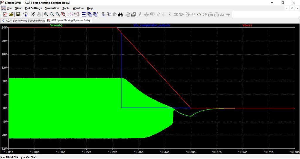

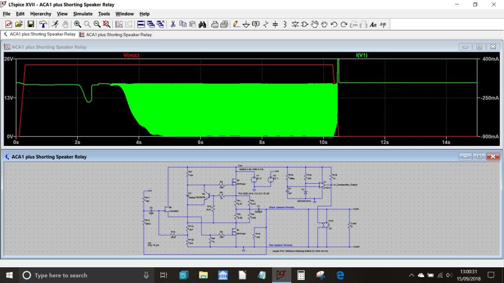

A check of the supply current of the ACA working into a shorted load is shown below. This was with an input signal that would drive the amp to clipping being applied. The peak current in this condition levels out at around 900ma per channel. So no problems as far as the PSU is concerned.
attachment.php
To simulate a mechanical relay I used a voltage controlled switch and set the properties at 1000meg off resistance and 0.01 ohm on resistance. Just as with the photovoltaic coupler, there is an unexpected glitch at power off. A mechanical relay that has its power removed will short the speaker as quickly as the contacts can close... which in practice should be plenty quick enough. The moment power is removed under full drive is also shown below.
attachment.php
attachment.php
A practical version would need the comparator output interfacing to the relay via a suitable drive transistor for which I often find the 2N7000 FET (or similar) to be a useful device.

Thinking about this a bit more... for those of you using the SMPS there could actually be far simpler ways of creating a silent start up (that's probably the easy bit) and also (with a bit of thinking outside the box) a silent shutdown.
The shorting relay across the output has to be silent at power on. It can't be anything else. That means a simple single transistor such as a 2N7000 FET powering the relay, and with a simple R/C delay on the gate would work. That is your silent switch on.
The relay closing when the ACA is switched off has to be accomplished very quickly. One possible approach could be to use a low voltage relay (5 volt) with appropriate Zener in series with the coil. As soon as the supply falls a little the relay will drop out shorting the speaker.
The above would be a unique (bit reliable) one off solution to the ACA using its recommended SMPS given that the SMPS output is both very tightly defined and that it will fall very quickly once the mains input is removed.
Don't forget the 'normal' power system for the ACA is;
smps -> chassis connector -> SWITCH (in the positive) -> ACA modules.
This means you will have both a permanent, and a switched 24v supply available inside the ACA chassis.
Therefore, a relay with a 24v coil, powered from the switch, should power down the instant the power switch is turned off.
Only leaving some sort of delay to be implemented for turn on delay.

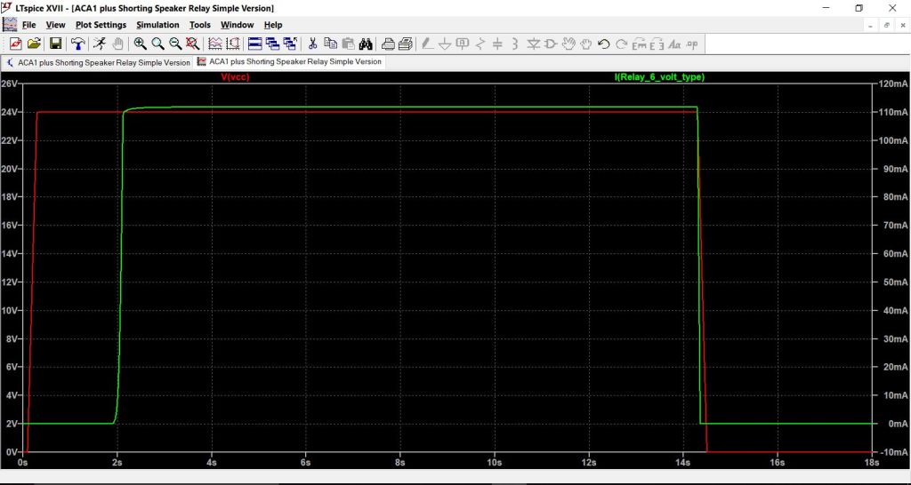

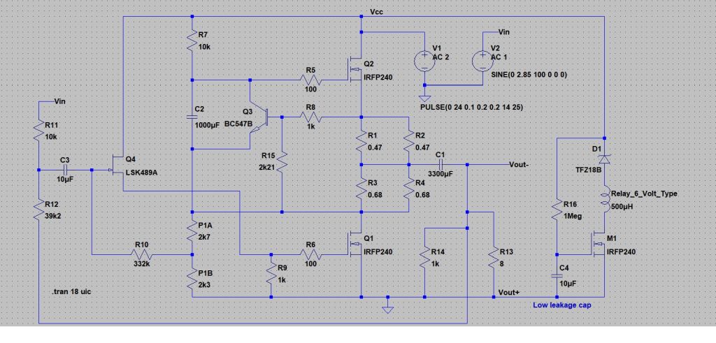

I looked at this a little more and this could be a winner... a simple circuit based on what I outlined above.
Here we can see the current in the relay coil vs supply voltage. Delay can be anything you want although bear in mind cap leakage currents vs current available to charge the cap. In other words a 10meg and 10uF electrolytic might not work as expected. Also a diode in inverse parallel (not shown across the timing resistor) would enable the circuit to be ready for action immediately following a switch off event. An inverse diode across relay is probably not necessary due to relatively slow transition times and the fact the FET already has an inverse diode 'built in', an unavoidable (but sometimes useful) function of the manufacturing process.

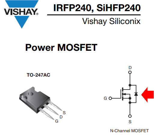

... An inverse diode across relay [coil] is probably not necessary due to relatively slow transition times and the fact the FET already has an inverse diode 'built in', an unavoidable (but sometimes useful) function of the manufacturing process.
Erm, not quite. The N-channel MOSFET has a large and robust drain-to-bulk diode, whose cathode (N doped silicon) is connected to the drain and whose anode (P doped silicon) is connected to the bulk and to the source pin. Unfortunately this diode clamps in the wrong (unneeded) direction. It clamps negative excursions on the drain, quite thoroughly.... but what we need is a way to clamp the positive excursion on the drain from the flyback event, when the MOSFET turns off and the voltage across the inductor jumps to (L * dI/dt) which is an enormous positive voltage. Since the IRFP240 is guaranteed to survive 200V on its drain, a simple <<200V zener diode from drain to source (i.e. ground) will do the trick. To name one example, Mouser has lots of 36V zeners in stock and LTSPICE has several 36V zeners in its presupplied device-model library.
Textbooks connect a normal PN diode across the relay coil but that's old hat and boring. Let's have some fun with an alternate topology that has the same parts count and the same parts cost, but a new and exciting schematic.

I was hazily thinking the diode would protect the drive transistor from inverse polarity (which it will). Any positive excursion would be dumped via the Zener into the supply rail.
The speeds the drive transistor switches at are so slow that I doubt there would be any measurable transients tbh.

This circuit won't have instant turn off in real life. Power supply capacitors won't discarge instantly...
Ok it might not disconnect within microseconds.
But even if the relay drops out within say 0.1 of a second that would be ok with me.

Edit, as I see the schematic, there's not really that much in the way of power supply capacitance on the ACA.
Maybe, just a thinking out loud here, installing a moderate size cap on the modules ps rail will help the amp shut down slower giving more time for any relay etc to be more effective ?
The trick is to mute the output while the (gradually falling) power supply voltage is still high enough for the amplifier to operate approximately correctly as an amplifier, and not operate as a dump a thump bumpster box. Judging from the 2nd-to-last figure attached to post #22, it appears you'd be completely safe if you let the supply voltage sag from 24V to 16V before activating the muting relay.

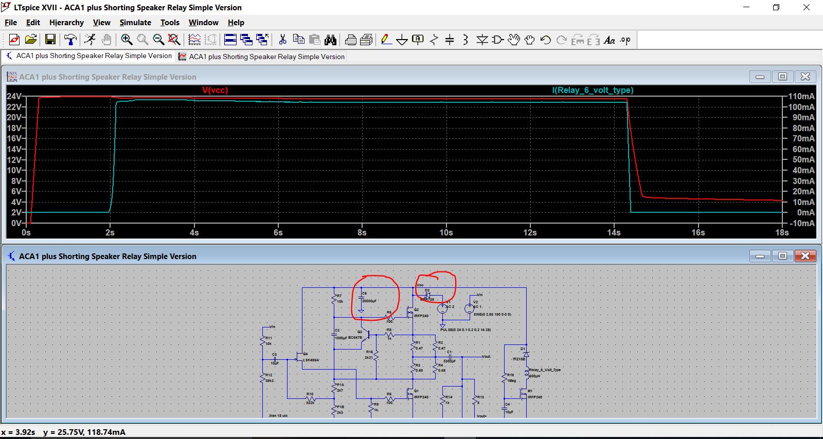

Indeed they won't. I set the fall time of the simulation to just 0.2 seconds which seemed a fair guess for a 'brick' type SMPS delivering 3amps. The fall time may even be quicker than that.
This shows an extra 20,000uF capacitance added to the rail (together with a diode to prevent the voltage source interfering with the discharge time).
There is no issue. Remember the reservoir caps in the SMPS will be very small indeed compared to the values we would use with a linear supply.
