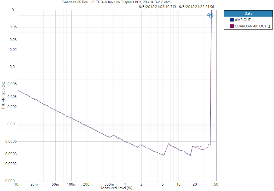

It's perfectly possible to build a speaker protection / turn-on thump eliminator circuit with MOSFET switches and floating photovoltaic drivers. That's what I did in my Guardian-86. I wasn't able to measure any meaningful difference in THD vs output power between the output of the amp and the output of the speaker protection circuit.
I would shy away from mechanical relays. As this guy demonstrates, they're not great for speaker protection due to their tendency to arc over, which causes contact wear (and resulting distortion) and may not actually protect the speaker. I'd certainly perform thorough testing on a batch of relays before committing to use one in production.

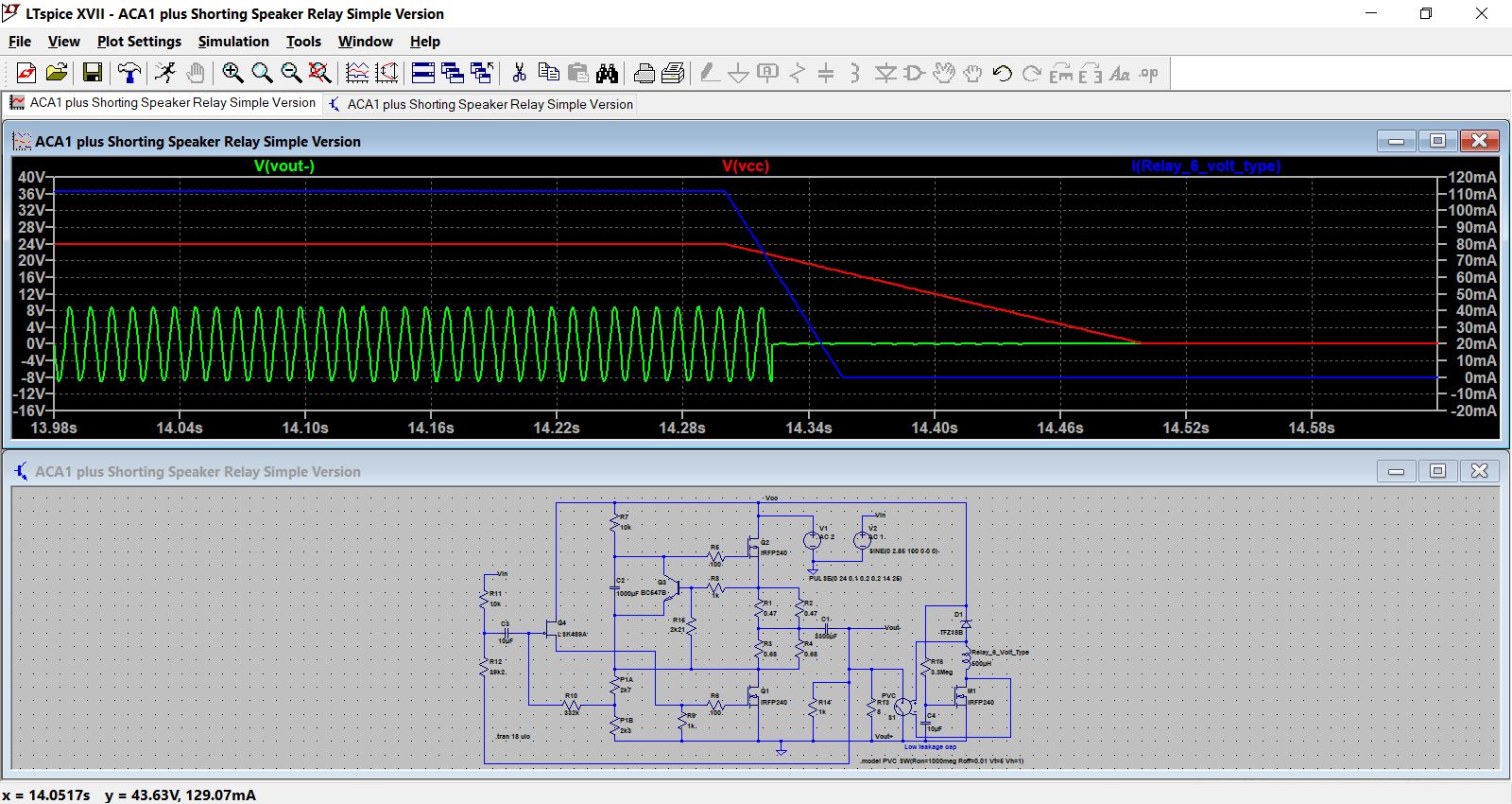

With many thanks to Hans Polak over in the LT thread and a little tweak of the switch simulation parameters and we have a great result. This is how the real relay would behave.
(I still don't understand why the simulated relay isn't behaving as I expect but that's one for tomorrow probably)
Anyhow, this simple version should give a silent start up and shutdown and is non invasive to the ACA.

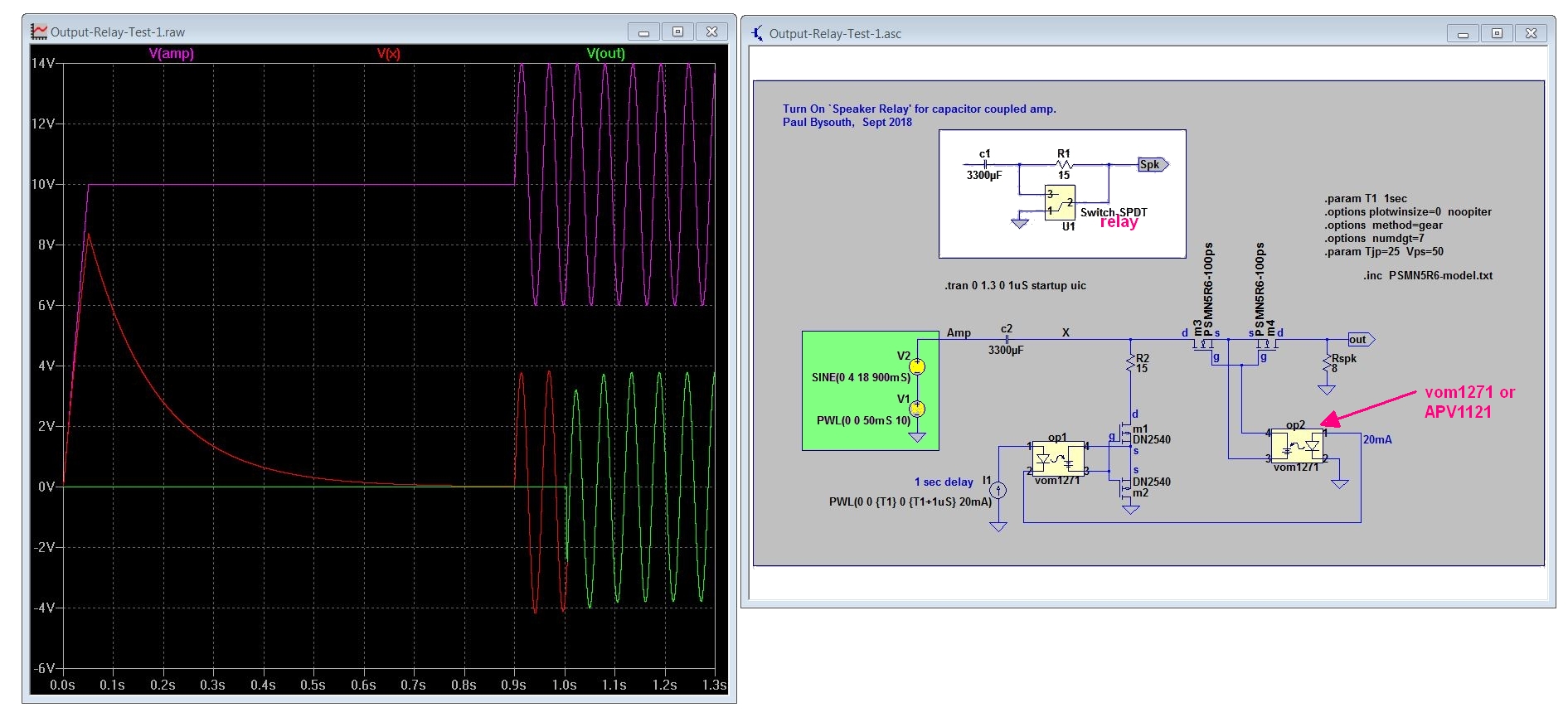

mosfet speaker `relay'
Relays suitable for amplifier outputs are large and expensive. Much better to use a pair of mosfets.
Attached is a scheme to:
- Short the output to ground with m1,m2 (via R2) to charge up the output capacitor, and
- Connect the output after a delay (via m3,m4).
In order that the output is shorted at power on, a pair of depletion mode mosfets are used for m1,m2.
The vom1271 photovoltaic generators create a floating 8v supply to turn m1,m2 off and m3,m4 on. vom1271 are in short supply at the moment, but APV1121 is equivalent. Note the opposite connection for the DN2540s. M3,M4 need to be low Rds on (<15 mOhm).
The size and cost of 4 mosfets and two vom1271 is about the same as a decent relay. Drive the vom1271's with 20mA after a 1..2 sec delay.
The small white box shows what you would use for a headphone amp.

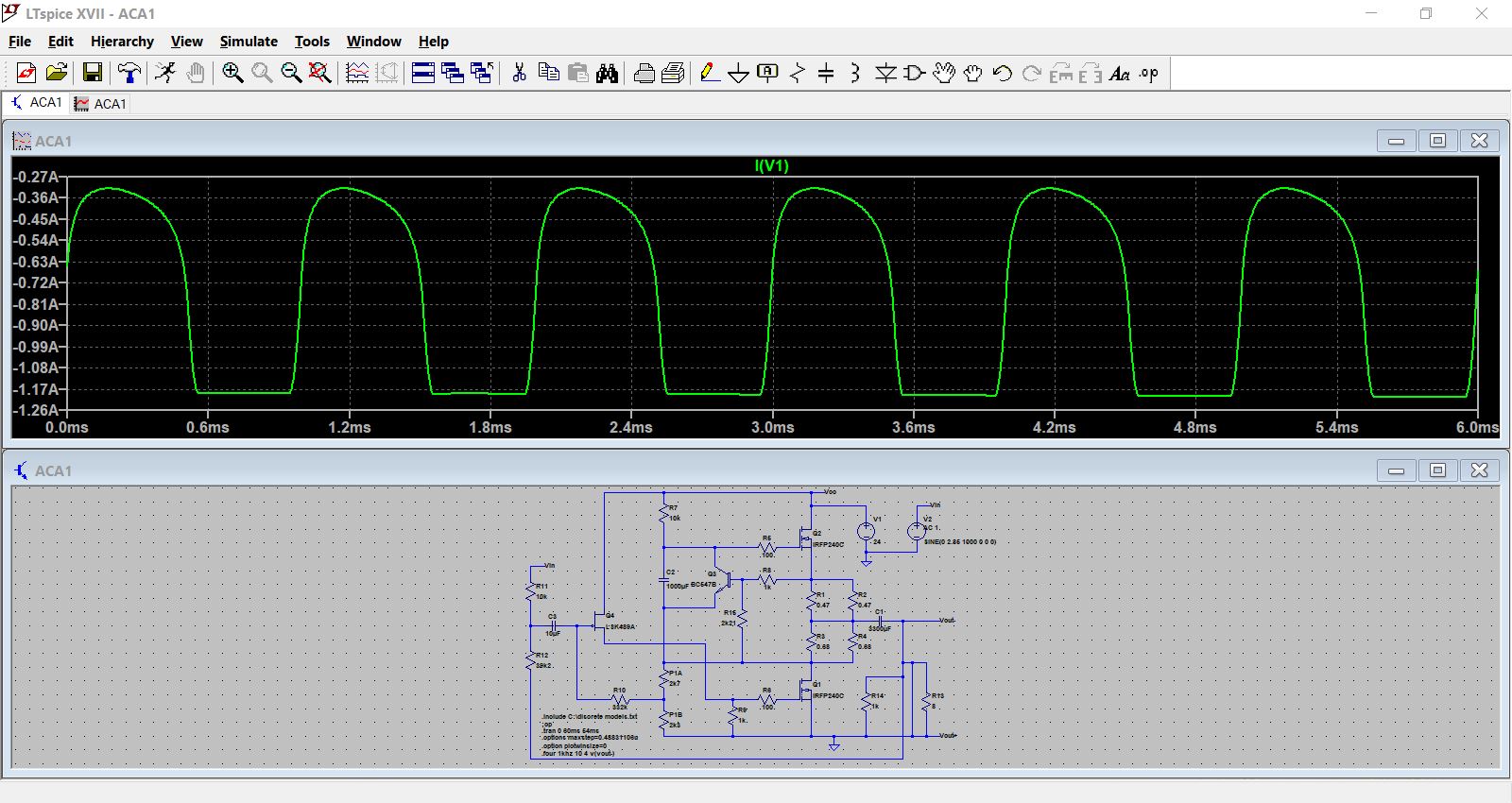

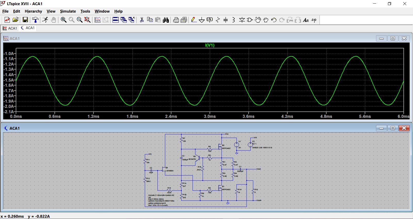

The short on the output shouldn't be a problem, even if the amp was fed with a very high input signal.
This shows the current draw of the ACA delivering its maximum voltage swing into 8 ohms. You can see the current rise and fall from the nominal bias current value. Second image is the PSU current when the amp is shorted.
The circuit topology of the ACA means it is inherently 'safe' working into a short circuit, Definitely DO NOT use this approach on a class AB output stage.
