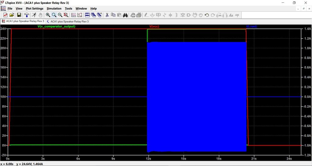

One quirk of the hugely popular ACA that seems to regularly get a mention relates to the strange noise it can make at power on and the loud thump that occurs at switch off. This kind of behaviour is actually 'normal' for pretty much any AC coupled amplifier. AC coupling here relates in the main to the large speaker coupling capacitor and the fact this has to both charge and discharge via the load (your speaker) when power is applied and removed.
It is also possible (you would have to confirm or otherwise) that the SMPS may 'ramp' up the voltage due to momentary current limiting becoming active at power on.
At this point I have to say I have never built an ACA and so ALL that follows is 100% theoretical, however those interested enough to delve a little deeper may find some ideas in amongst all of this on how to make it virtually silent.

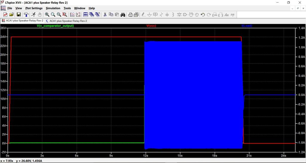

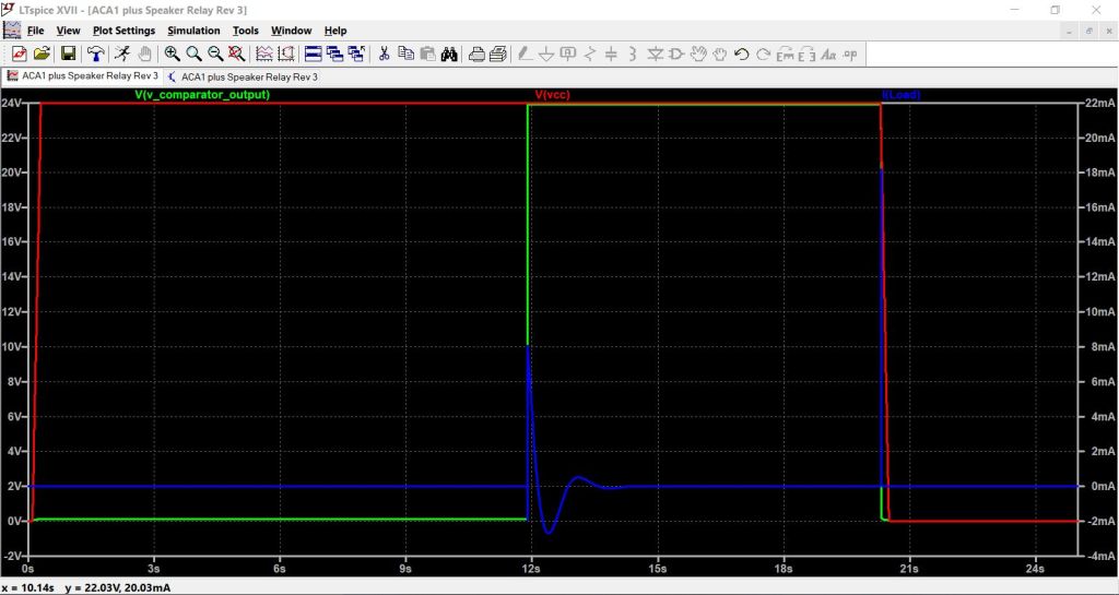

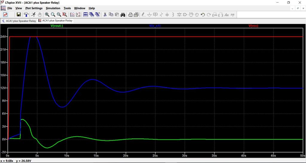

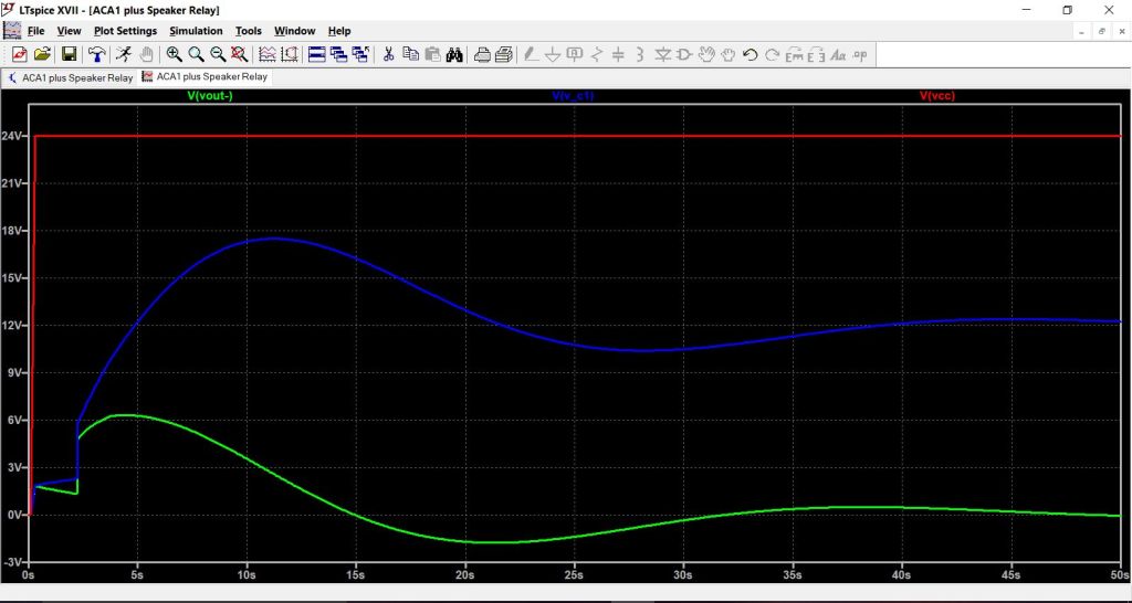

A graphical representation shows the problem. Here we have a simulation of an ACA showing the sequence of events as power is applied. The supply voltage and amplifier output voltage (the black speaker terminal) are shown with reference to the left hand voltage scale. The load current (your speaker) is referenced to the scale at the right. We can immediately see the large switch on thump and an even larger switch off related event. The ACA has no signal applied during this test.

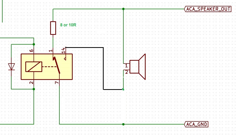

Is it possible to eliminate this and give a silent start up and shutdown ?

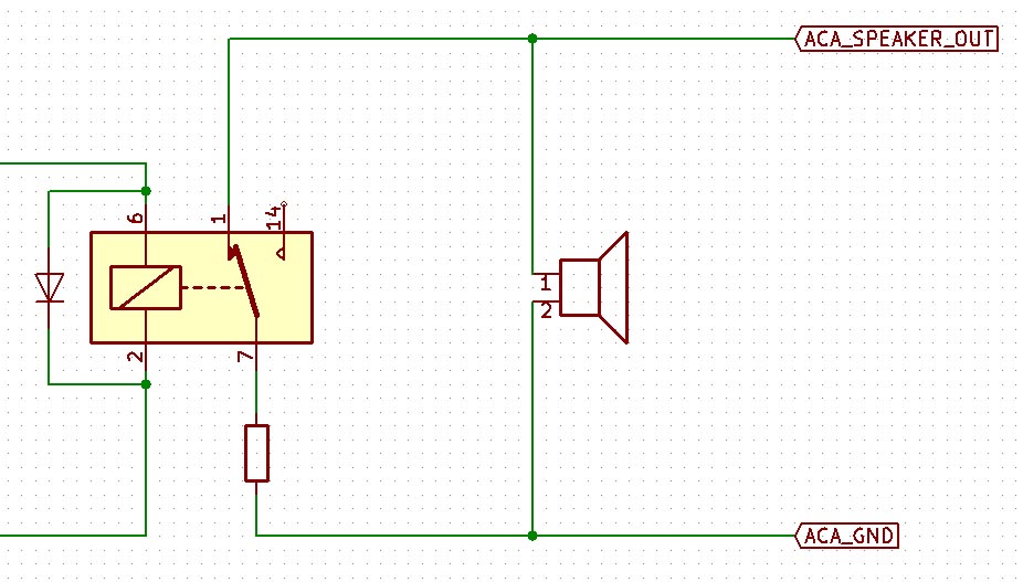

Using a speaker relay would be considered one possible route, however relays are a little power hungry and can suffer from contact degradation over time. This isn't some imaginery issue that happens to other people... its happened to me... and as witnessed by many threads on these forums it also happens to many others as well.

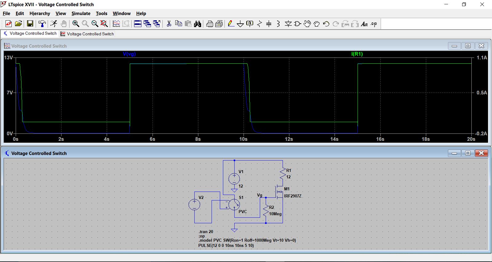

One real alternative is a solid state relay contstructed from two back to back power MOSFET's. These are becoming more and more popular because they suffer no degradation in use, and have a current switching capacity limited only by the FET rating. Voltage rating of this type of relay is again determined by the FET. The series resistance (what would be contact resistance in a traditional relay) is twice the value of the Rds of the chosen FET.
Downsides of the FET relay.

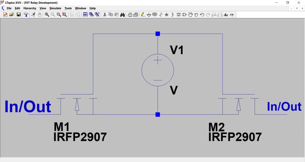

The following explores the FET relay in more detail and the diagram below is a practical relay constructed from two N Channel power FET's. The key to the relays success relies on the drive voltage V1 being floating. If that requirement is met then the relay behaves as expected and is truly bi-directional, just like a mechanical one. In this form the relay is suitable for speaker switching duty in both AC coupled amps and also DC coupled running off a dual supply.

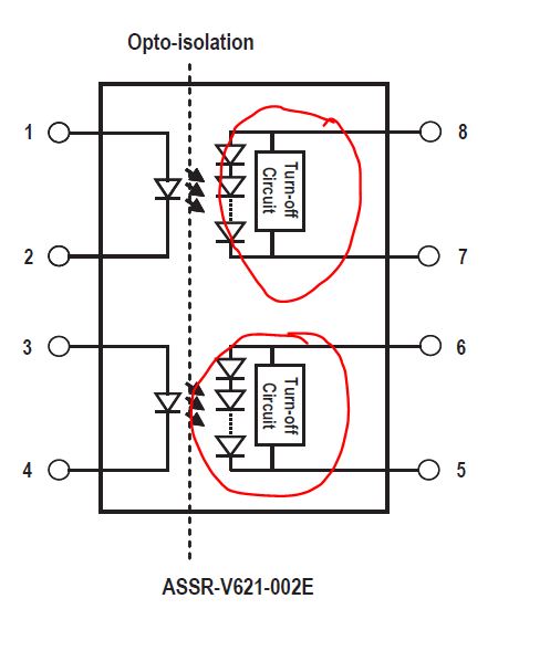

The floating drive voltage is traditionally derived from a 'Photovoltaic Coupler' which can be thought of as being like a tiny solar cell that is illuminated by an LED. When the LED lights, the cell generates voltage (typically 7 volts), and this voltage is applied as a floating source between gate and source to turn the FET's on or off. The whole thing is often drawn in a similar way to a standard opto coupler and packaged in the same manner. The on/off isolation of this type of relay is excellent at DC and low frequencies, and becoming worse at high frequency due to the junction capacitance of the FET's. In practice this is a non problem for our application because the load being switched is (relatively speaking) of very low impedance.

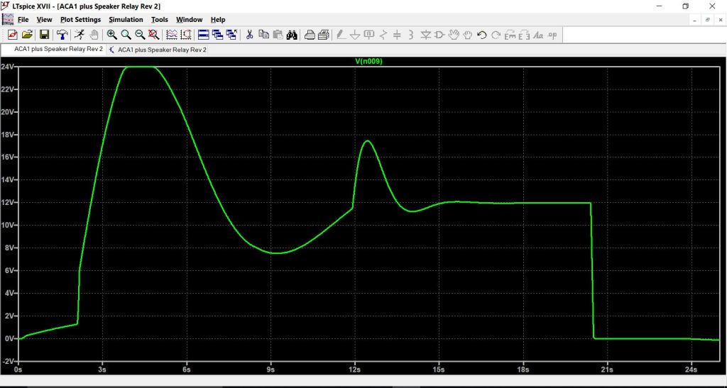

Before considering what may be possible we first have to look in detail at the problem we are trying to solve. Although it may seem obvious when mentioned, one real factor to be considered is that when the speaker is not connected, the time constant of the speaker coupling cap and R14 (whcih is the caps only means of charging) is large.
We can see that below. Here the speaker is not connected.
There is no easy way around this long time constant. Technically complex solutions would be to employ a low value shunt resistor to give a super quick charge time, the resistor then being switched out of circuit. In the ACA about the best we can do is to reduce the value of R14 and that is what is done here. Reducing by a factor of ten gives us something more realistic to work with, and now we could reasonably say that a delay of 20 to 25 seconds should give a much reduced switch on thump. The longer the delay, the quieter its going to be. Given the low power output of the ACA a 1 watt 100 ohm is more than adequate.

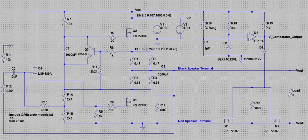

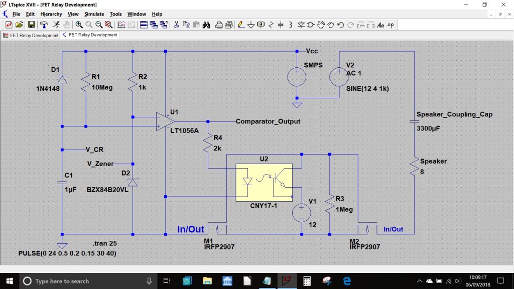

So having come up with a suitable solid state relay, and now having some idea of the delay needed the next step in the design process would be to construct some form of drive circuit for the FET relay. The ACA does us some favours here because of the fact it runs on a tightly regulated supply with very defined start up and shut down characteristics.
(I know the start up and shut down behaviour of the SMPS will be tightly defined, the trouble is that I don't know exactly what the numbers might be with regard to supply rise and fall times and so I'm going to have to make some assumptions)

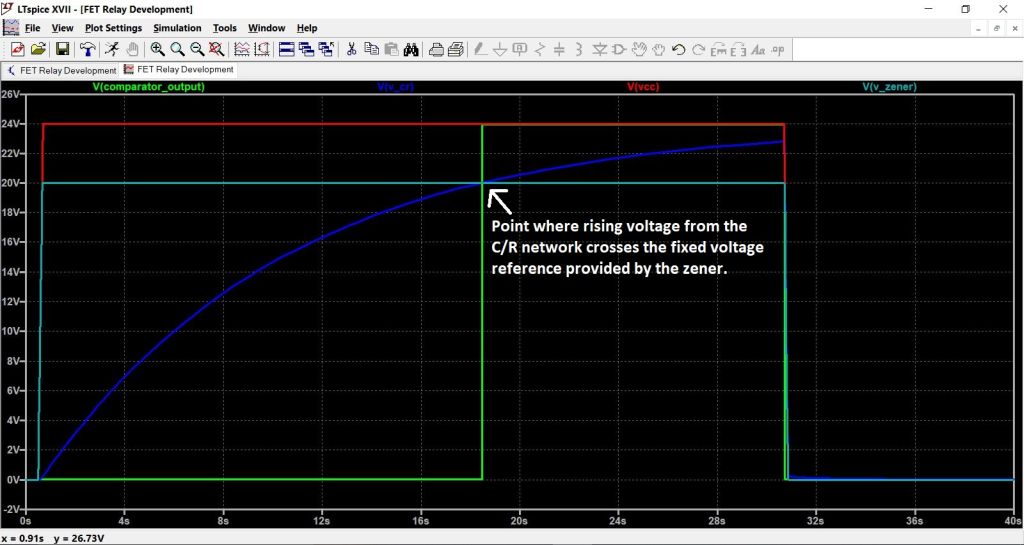

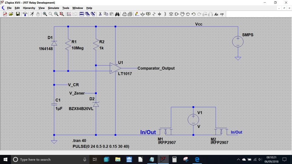

A simple comparator seems a likely possibility to begin the design and only one is needed because both ACA channels would share the drive circuitry.
So firstly we have to set up our supply rail in the simulation and for this I am choosing a rise time of 200ms and fall time of 150ms. Next we add the comparator and set an R/C time delay on the inverting input. The non inverting input is fixed at 20 volts by the zener diode.
The operation is as follows. When the supply voltage appears, the RC network delays the rise in voltage at the comparator input. It is the classic exponential charge curve. When this rising voltage crosses the fixed level provided by the zener we see that the comparator output flips from low to high. This voltage can then be used to operate our relay. The function of the diode is simply to dump the charge in the timing cap back into the supply rail when power is removed. This allows the circuit to be instantly ready to work again if needed.
Putting it all together.
The following shows the relay in the off state (that floating voltage source between G and S is zero). The upp er right voltage source represents the ACA and is a 4 volt peak sinewave (1 watt/8ohm) riding on a DC voltage of 12 volts. The plot shows the load current (leakage) which is pretty small.
Now we change the floating voltage source to 12 volts which will fully turn on the FET's. Again we look at the load current and can see that the FET's behave as if they were essentially a wire link or short. A near perfect relay.

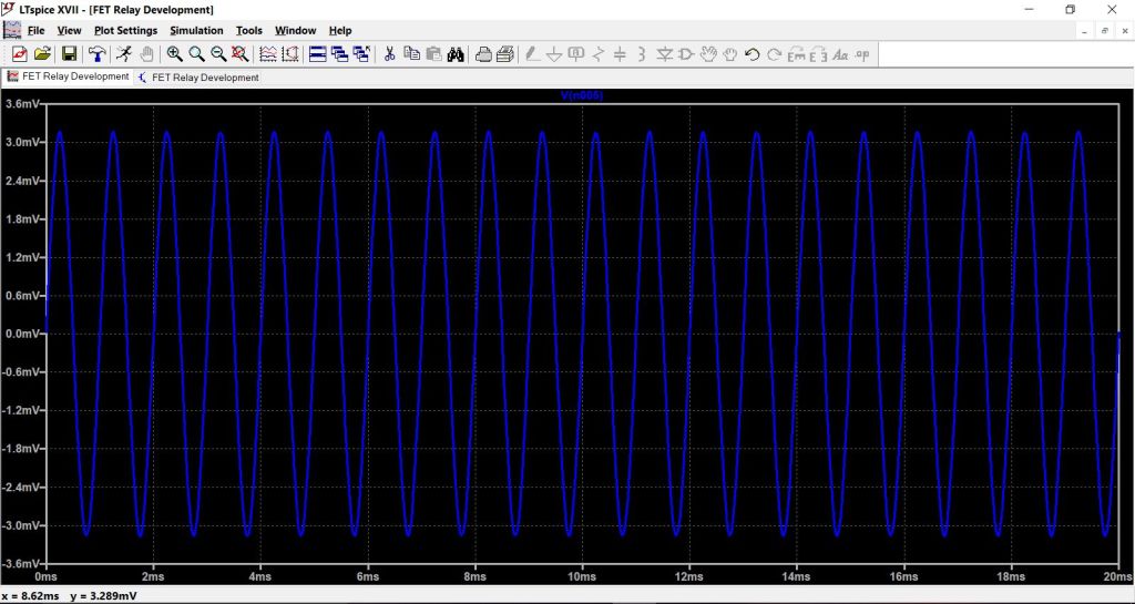

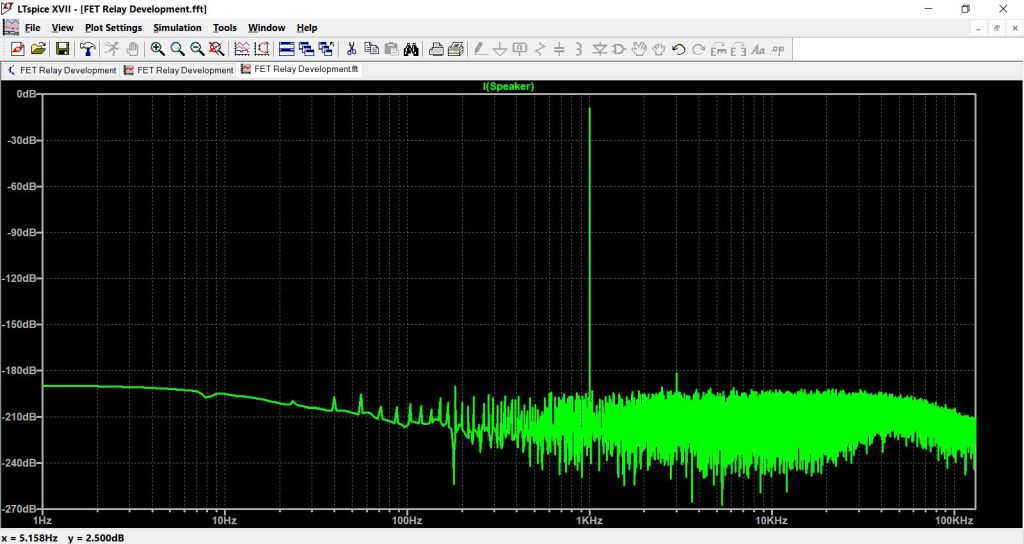

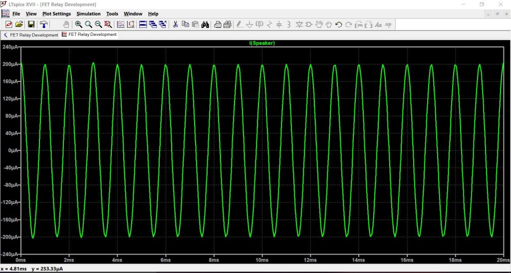

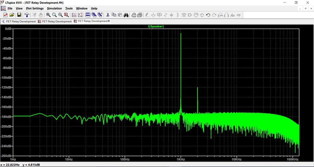

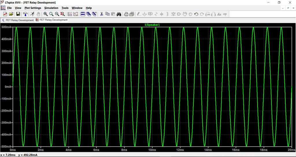

This is a distortion plot of the current passing through the load. The first example is with similar FET's, the second with dissimilar.

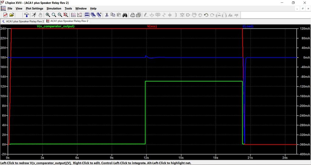

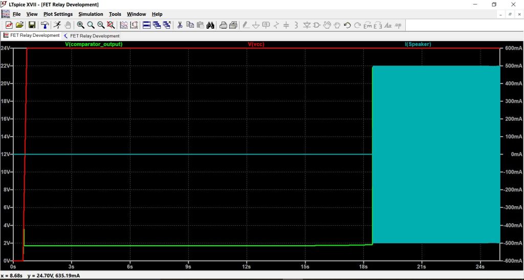

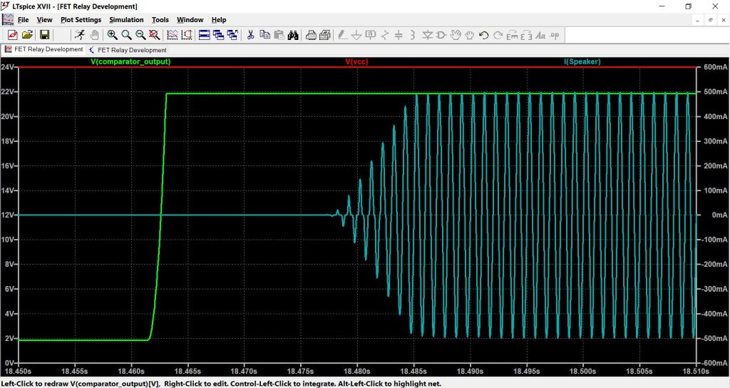

This shows the idea in action. The audio is muted until the comparator changes state, at which point the relay closes and audio is passed. The third image shows a close up of the moment the relay turns on. A practical relay using a photovoltaic coupler would need no other components apart from the coupler and FET's. The 1meg in the simulation is to stop the tiny leakage of the opto coupler model from interfering with the off state of the relay.
Testing the idea with the actual ACA simulation.
This is where issues come to light, however, these may be more down to the simulation than a real problem. Specifically, the main problem is seeing a switch off thump (current in the speaker) when the relay should be off. I know from having used these relays that they behave as expected and so I'm left wondering if the issue here really is simulation related.

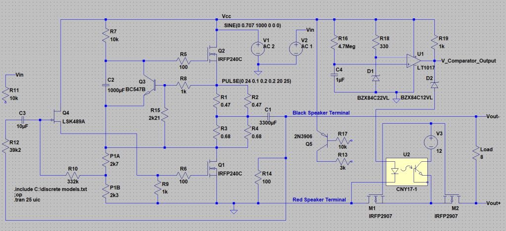

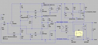

At this point we take a step back and redraw the circuit with a view to clarifying and simplifying. A different model for the opto seems to obviate the need for the 1meg resistor. In a real build it wouldn't matter anyway because the photovoltaic coupler is all that is needed. The comparator (LT1017) has an active class B output stage, however the current source ability is limited. This means we still need the traditional 'pull up' resistor to supply the LED in the coupler. A zener has also been included in the feed to the LED and this is purely to make absolutely sure the relay can not be forced into conduction due to any small glitches/transisions etc that may momentarily occur on the comparator output.

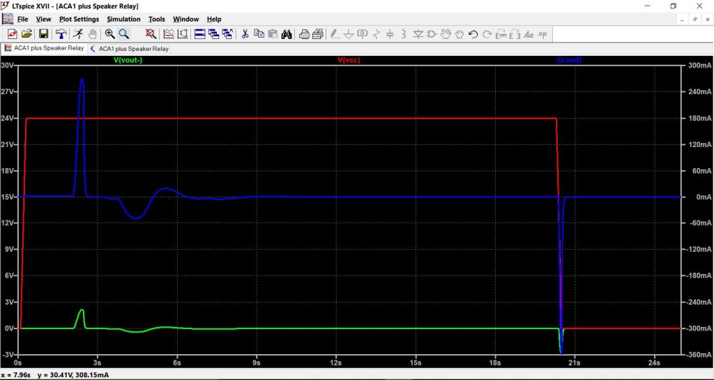

This shows our basic working circuit, and following on from that the voltage and currents at critical points in the design. You can see the supply voltage at the point of switch off together with the comparator output voltage and current in the Zener/LED feed. Note the speaker current. The small current pulse at around 12 seconds is solely due to the time delay chosen before the relay activates and 12 seconds is not long enough for the both the amplifier and its 3300uF speaker coupling cap to charge via the 100 ohm resistor (R14). How long a user would want to wait before the speaker was activated is down to personal choice.
Remember it is not just the 3300uF cap that is the problem here. The amplifier itself has a very long settling time, realistically around 18 seconds from power being applied as can be seen here.

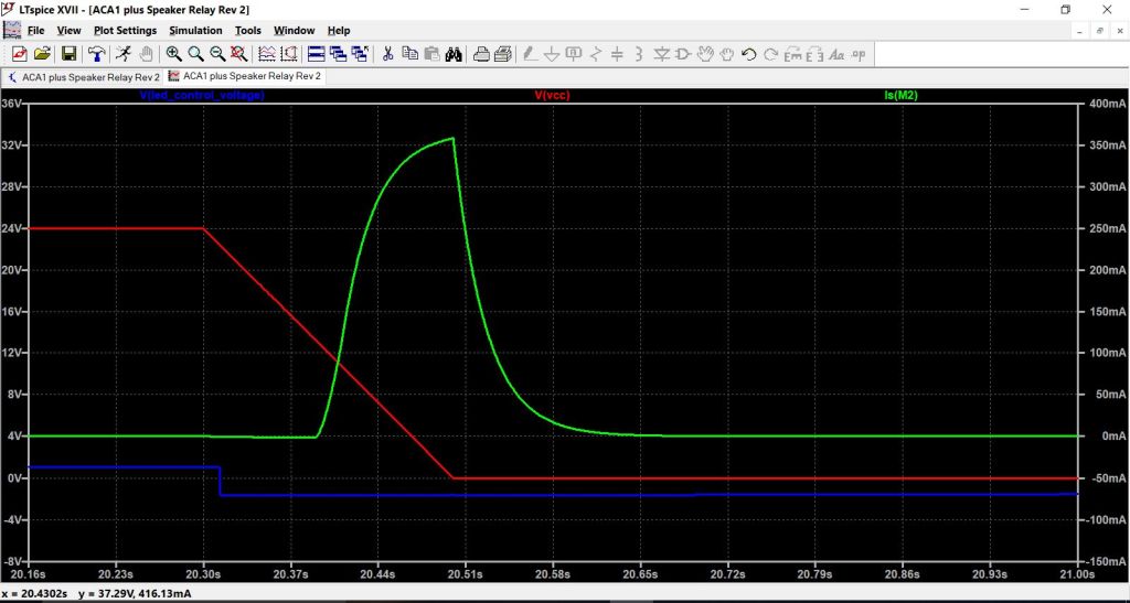

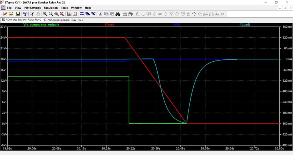

Now to the 'big' problem that may well just be a problem with the simulation. This shows the moment of switch off. Note the way the 24 volt rail collapses (one of my assumptions outlined at the start... I hope I have picked a realistic rise and fall time for the 24 volt rail), and in particular note how quickly and cleanly the comparator flips state removing drive current from the photovoltaic coupler. Once the drive current is removed, the relay is off and this is the puzzle/problem... the simulation goes on to show a current spike in the speaker that occurs after the relay is off. I have no answer to that besides saying that it shouldn't be doing it.
The big question. Is this current spike real or not ? If the relay were mechanical and driven by the comparator output voltage then the answer is a definite no, the relay must be off at that point in time and so no current can flow.
A real and practical solid state relay behaves like a mechanical one. So where does this spike come from ?
To elaborate on this further I took a plot of the current flow in the FET source lead and overlaid this with the relay on/off control voltage. The voltage on the LED assumes a slightly negative value... puzzlement over that... and so at this point I'm going to say that the behaviour of this in simulation is possible erroneous and that the a real photovoltaic coupler would work as expected.

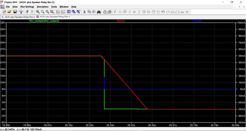

I have to say I was amazed at the result. Can we trust this ? The switch off pulse is minimal and the circuit very simple.

This is how the real coupler looks in block diagram form.

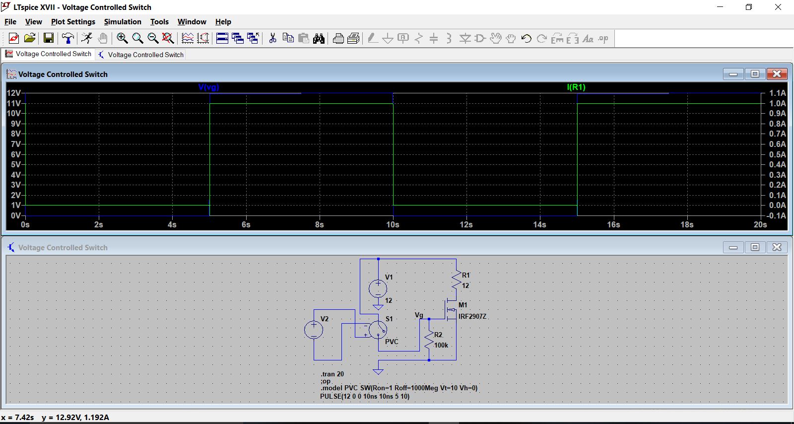

I rigged this up to try and see how the FET's behave when switched off. The switch supplying the gate has a 'nearly' infinite off resistance at 1000 Meg ohm. The 10 meg from gate to source discharges the gate capacitance.
Making the resistor 100k sharpens things up no end.

The problem, as I see it, is that you do not want output to the speakers during unstable phases. In other words, you only want output when (you know) there is stability.
With little theoretical electronics knowledge, I assume that a suitably low-ohm high-power resistor parallel to the speaker will provide an alternative path for the spike and make it inaudible. Left in place, this resistor would also make our music inaudible, so we only want the resistor to be connected to the circuit during the unstable phases.
According to the simulations in posts 1 and 2, spikes occur during start-up (ca. 2 sec after power is switched on) and during shutdown (it takes about 200ms for the supply voltage to drop from 24V to 0V; in the simulation the spike occurs when voltage has dropped from 24V to 15V).

If the resistor is placed into the ACA output circuit as shown below, the resistor is always in the circuit unless the relay is turned on. We now need a program that will leave the relay off for a few seconds after powerup.

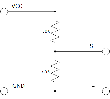

Note that arduino cannot handle >5V so we must use 2 resistors to make a suitable voltage divider. Using a 30k and a 7k5 resistor would be suitable.

Use the NC contacts of an SPDT or DPDT relay, to connect a 1 ohm resistor in parallel with the speaker terminals. Arrange the relay to pull-in "X seconds" after power on, which disconnects the 1 ohm resistor from the speaker terminals.
This shrinks the output thump by a factor of nine. 8/9ths of the thump goes into the 1 ohm resistor, and 1/9th of the thump goes into the 8 ohm loudspeaker.
You could imagine different choices of resistor value too.

Then why not do it this way? 8R to charge C1 once 'stable' the relay pulls and swaps to the speaker. Better still if one could make the relay pull in at switch on and drop once stable, then it would 'fail safe'.
- A possible approach to adding a silent start/shutdown to the ACA
