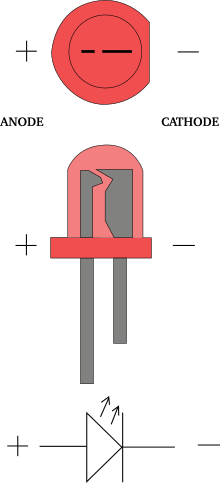

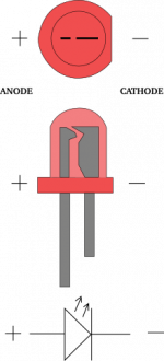

The housing of the led has a flat side this is the kathode side
see picture
Just a hint,if you turn an LED arround it won't light up!!! Which means that it's not the LEDs.
Many modern LED's don't conform to the old "standard" for lead identification. Just put it on a DVM on diode range. It will light one round, when it does the red lead is on the anode and the black is going to the cathode. The DVM won't illuminate LED's that have a turn on voltage higher than the DVM open circuit voltage but most common types will.

The led's do have a flat side.
Easiest way to know if the led is correct connected is flat side to min side.
I would just say that if there is any doubt then measure and prove it first. I have some "clearwater" red led's in front of me which have the longest lead as cathode and the internally visible led chip is mounted on the anode rather than cathode lead. The flat on these is still the cathode though.
If in doubt... measure 🙂
