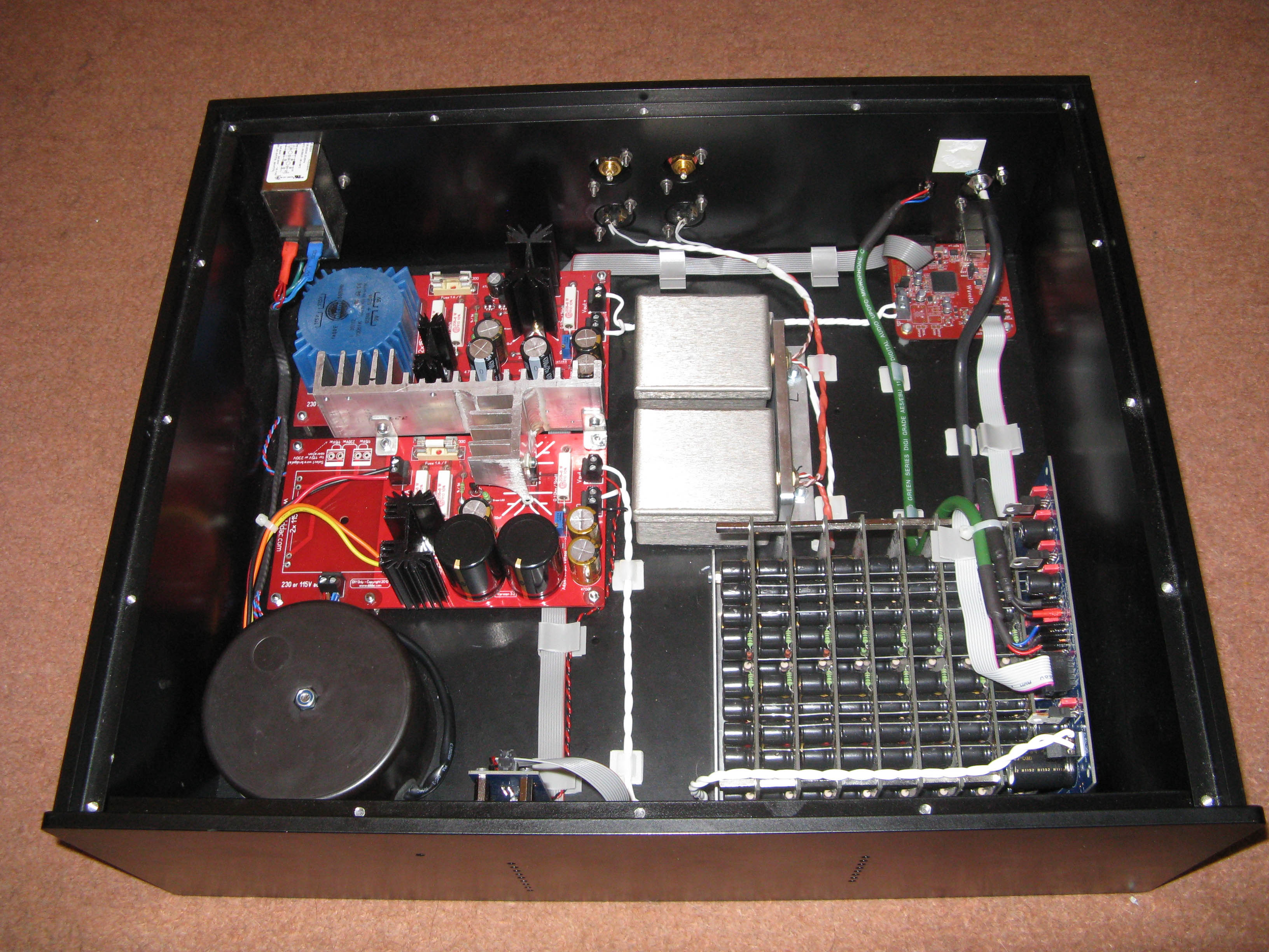

Thanks Doede! I built this one for a friend and will now build mine 😀
Always love the music!
Tidy job Simon. Is that an off the shelf case or something you've had specifically made?Finally the DAC is built...... 😀
Thanks! 😀
The case is from Modu and the exact one is here.
modu
I designed the front and back panels myself using the Schaeffer company CAD tool and service which was superb! You need to spend time learning the software tool but it was easy and soon got the hang of it.

I have now completed the 8 stack and after a week or so bedding in, it is now top of the class for sound quality 🙂
The power supply mods were interesting. I changed the 4700uf`s to Mundorf 10000uf and the 470uf to 1000uf.
I ended up keeping the Mundorf 10,000`s but put the 470`s as supplied with the original kit back as I found that 1000uf somehow made the soundstage smaller.
Maybe the decoupling properties of the 470`s match what the circuit needs.
I have found some Vishay low ESR capacitors part number; 678D477M025DM3D I will give them a try but I will be amazed if it can sound much better ….
Very pleased with the kit, Thanks for the design Doede 🙂

VERY nice work Alex. 😉 Which case did you buy please? Love the special heat sink, so did you make that?
Hi Simon,
I drew up the case and had a local engineering firm make it for me. It used 16 mm thick Alloy panels so cost a packet but is solid enough.
I made the heat sink using an extruded one cut to the size I wanted then I welded them together. It runs at 45ºC now instead of 75ºC.
I will be building another one with 16 stacks later this year but I will use the similar case to what you use as they are very nice looking.

With respect to the data on these screens there seems to be some confusion.
In SimonJ's instance the WaveIO supplies the sample rate / frequency data, this does not come from the computer delivering the audio signal. The Arduino interprets the control signals of the LEDs and renders text in their place.
Its quite possible to connect a screen to the BBB but that would not be providing information about the DAC, it would be information about the source.
Some of the software for these embedded players which are based on MPD server (such as volumio) offer the potential for the output of playback data (artist, title, duration) which would drive a screen connected to the GPIO headers of the embedded device.
What would be super cool is to combine the sample rate & frequency data from the WaveIO PLUS the playback state information outputted directly by the transport, all on one 20x4 LCD. The Arduino would then be used to implement the collation of data from two sources for display.
