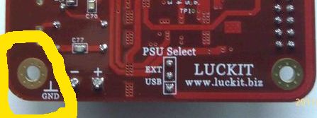

Hi Stijn,
Thanks for posting your results. It also seems you are a bit quick with conclusions, so let me react:
ad1 Using a large transformer does make a difference, as in Audio SQ, not always easy to understand why, but that does not matter. Claiming the smaller transformer cannot power 4 boards is totally wrong. It easily can. The higher heat has to do with the higher Voltage after the diodes with your new transformer. Just measure it, you will see. The Standard transformer also does 8 stacks, without any Problem. On Improvement of SQ that is anpther story and has to do with our beloved Audio Hobby tweaks😉
ad2 the groundplanes are NOT connected, so this cannot be the cause. Have you been using another 5 Volt supply at the time you had noise Problems? or did you powered the USB Board throug your PC USB bus?
Hi Stijn,
Hi Doede, Thanks, Second point first. Yes you are right my old PSU for WaveOI was of inferior quality. Thanks for clearing the ground plain question. What I don’t understand then is how the high frequency noise could have reach the analogue domain or do you think this could be attributed to jitter/bit recovery errors?
As for the DAC PSU. I , take your word for it that the voltage is higher after the rectifier compare with the old transformer, I can no longer measure before and after without swapping them out again. Logically however, I don’t understand how this could be, as both the old and my new transformer have 2x15V secondary winding (which I hadn’t stated yet).Therefore, in order to explain the increase in heat put out by the regulator would have been an increase in current, hence demand, hence my "assumption" that the old transformer wasn’t delivering enough. Also I made the other PSU “mods” before I swapped the transformer and the regulator heat sink stayed cooler at that time, so I can’t explain the increase in SQ that way.. I hear what you are saying about, it being the combination of.., but I’m still a bit puzzled, and eager to learn obviously, so please don’t take my questioning the wrong way.
