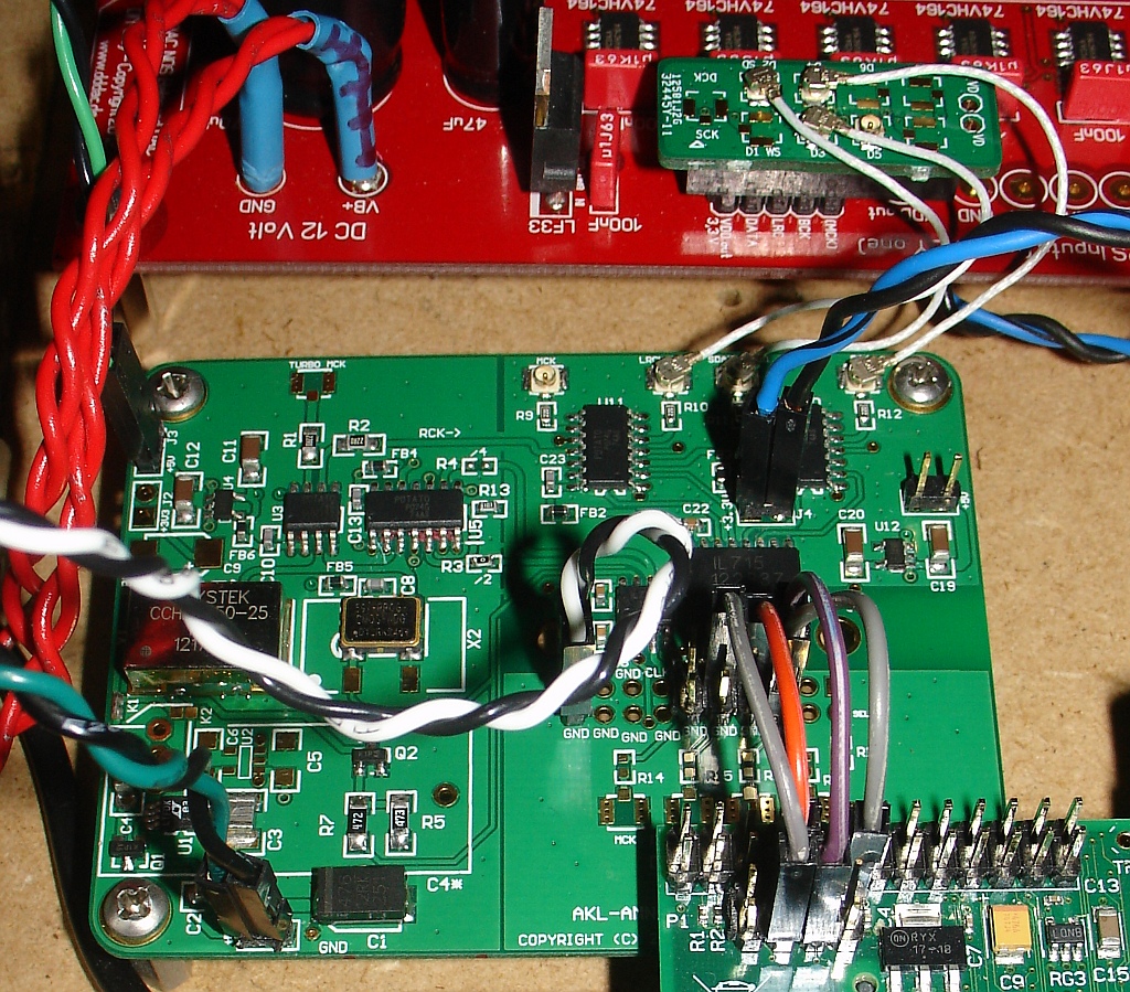

So far this is the best the rpi has sounded on my system, your mileage may vary...
I'm looking forward to clivem's wandboard implementation or Russ' cape for the bbb, as they do promise better sound than the rpi. But right now with the rpi, I'm happy!
Is the little piggyback board on the mainboard, what you are referring to as isolator, where did you get it? It looks like you are making your jumper cables yourself where do you get the female connectors? Thanks,
No, that's just a pin to u.fl adapter, since Acko's S03 only has u.fl out (it has pin and u.fl in, but only u.fl out). The S03 is both a reclocker and isolator. The input line isolator is to the right of the black and white twisted cable almost in the middle of the photo, you can see the chip says IL715 (http://www.diyaudio.com/forums/atta...m1794-waveio-usb-input-crystek_100mhz_s03.jpg).Is the little piggyback board on the mainboard, what you are referring to as isolator...
Ian made it for people wanting to use his FIFO board with a Buffalo III. I had a Buffalo IIISE and didn't need the adapter with it so I had it left over. It was not my idea to re-purpose it, I saw someone else do it in another thread. It's a very simple board, someone else in this thread talked about doing a similar board I think (http://www.diyaudio.com/forums/digi...imate-weapon-fight-jitter-75.html#post3084111).where did you get it?
Search ebay for "Dupont Jumper Wire Cable Housing Female Pin Connector Terminal 2.54mm" for the connector and "Dupont Jumper Wire Cable Housing Female" for the plastic housing (ebay links don't work most of the time in the forum). You can get nicer, gold plated ones from Mouser/Digikey (i.e., molex), but for testing and short term use, these work ok. From ebay you can also get 10cm and sometimes 5cm "dupont arduino cables", which if you are happy with that length you can buy ready made.where do you get the female connectors
.......From ebay you can also get 10cm and sometimes 5cm "dupont arduino cables", which if you are happy with that length you can buy ready made.
Thanks, I'd found the ready made cables I just didn't know what the female connectors where called. I'd like to make some custom length ones when I tidy up the cabling..(eventually). I hope Russ his BBB cape will do all the things you isolator board does. Those U.fl cables are a nice touch.
