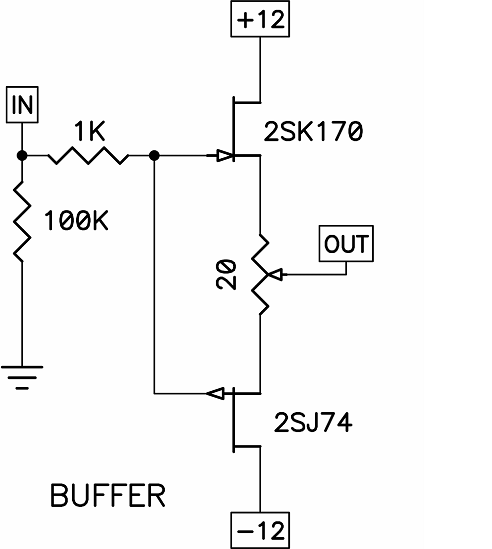

JFET Buffer Circuit

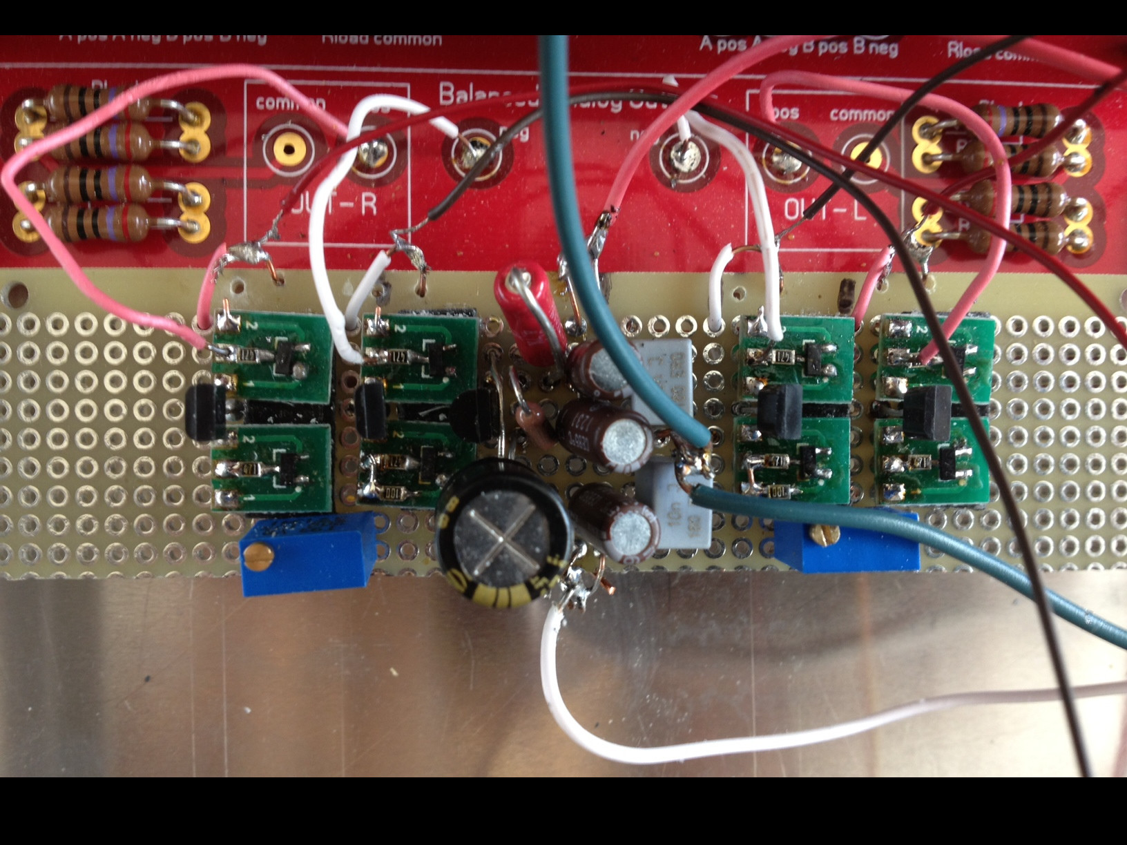

Attached are a schematic and photo of my BF862 JFET buffer. There is almost too much detail. I could hear the valves and mechanical linkage of a bassoon clacking on a Vivaldi recording through my Grado GS1000 headphones – something I have never heard before. The break-in period was UGLY at times and bad recordings are punishing. The best CDs sound amazing. I am going to test HF filter capacitors on the DDDAC outputs to try to soften the SQ a hair. I don’t need to hear each 0 and 1 from the CD. This buffer can pass a signal greater than 100 MHz.
This Buffer is for the masochistic DIYer. It requires testing and matching of BF862 JFETs. A negative power supply is needed. Surface mount components require more care. Nevertheless, a buffer is the only alternative for the person who wants to totally tweak out a single board DDDAC and drive an output transformer without compromising the musical experience. On the positive side, all semiconductors and resistors are inexpensive and available as SOIC-23 surface mount. The BF862 is only available as a SOIC-23. Anyone want to design a surface mount PCB for this buffer? I could provide a set of components with matched BF862s. Maybe Doede could drop the buffer circuit into the main board foil trace for optional use in a future revision.
The circuit uses the ZTX450 which is used in the highly acclaimed Pearl 2 DIY phono preamp to provide a constant voltage source for the 1st JFET gain stage. The ZTX450 makes the lower BF862 constant current load - more constant, and allows a more standard -12VDC power supply to be used. My prototype uses a mixture of surface mount and standard size components. The TL431 regulates the voltage to the base of the ZTX450s. The 20 ohm pot is used to zero out the voltage offset between the + and – outputs to the transformers.
If the ZTX450s and the TL431 and its associated components are eliminated, you end up with the Nelson Pass B1 direct coupled buffer design which should sound a bit more euphonic. It would be much simpler and fit easier into Doede’s main board. My 2SK170 version of this sounded great, but I’m a masochistic DIYer.

Buffer Explaination
dwjames,
The JFET buffer does not replace coupling capacitors or transformers - it is used to interface the DDDAC output with these devices. The Buffer load (JFET gate) to the DDDAC output is over 1meg ohm - almost nothing. The DDDAC doesn't see the transformers or capacitors or the load that they terminate to. Meanwhile, the Buffer follows the DDDAC output signal but provides its own power to drive the signal through these devices.
An electrical load can affect a signal source. The Cinemags interfere with some of the musical detail and dynamics from a single board DDDAC. Multiple boards help overwhelm the Cinemag and its load with a lower combined output impedance (ie stronger signal)
Its like the difference between a bicycle and military tank both moving at 20kph. The bicycle may be affected by the terrain, but the tank will move ahead unaffected. The Buffer is like a tank following the pedal speed of a stationary bicycle - both will operate uninhibited.
The Buffer pot adjustment is an opportunity to bring the DC offset even lower, but this is not the primary reason for using a buffer.
I hope this helps.
