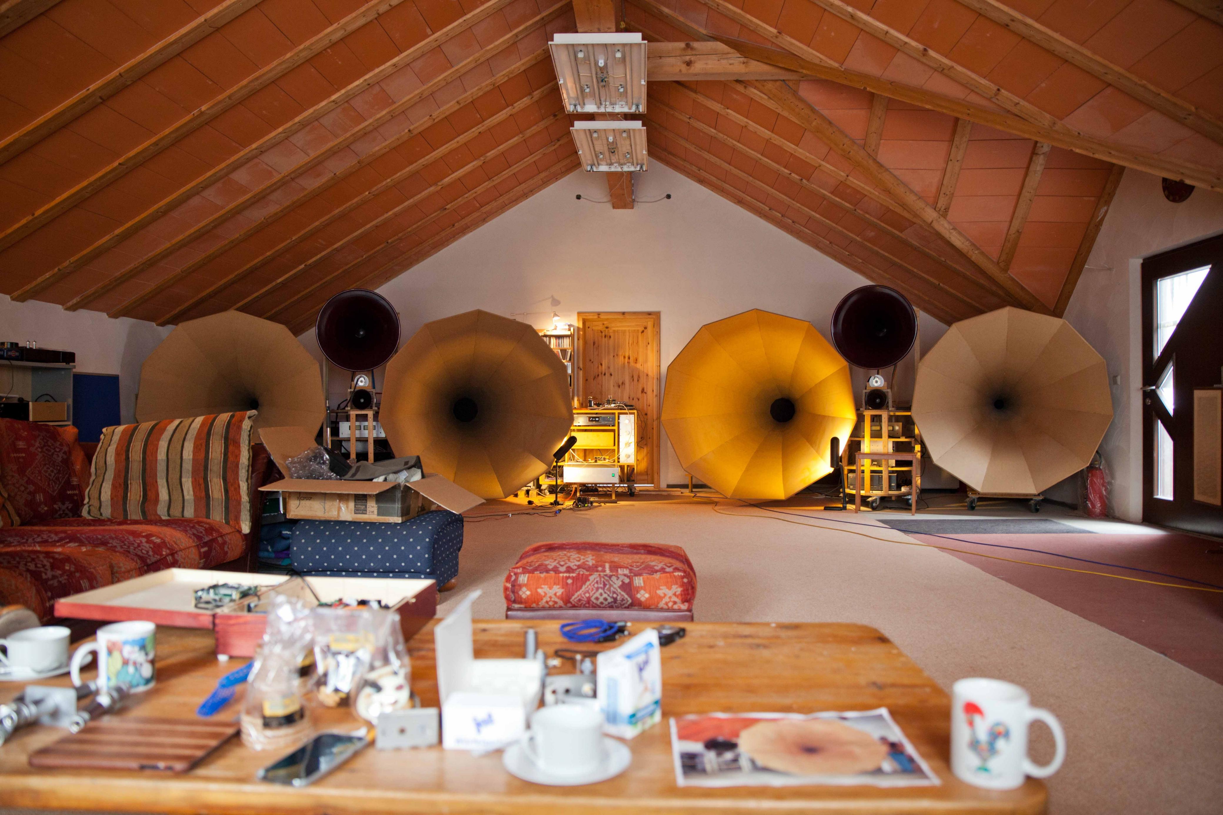

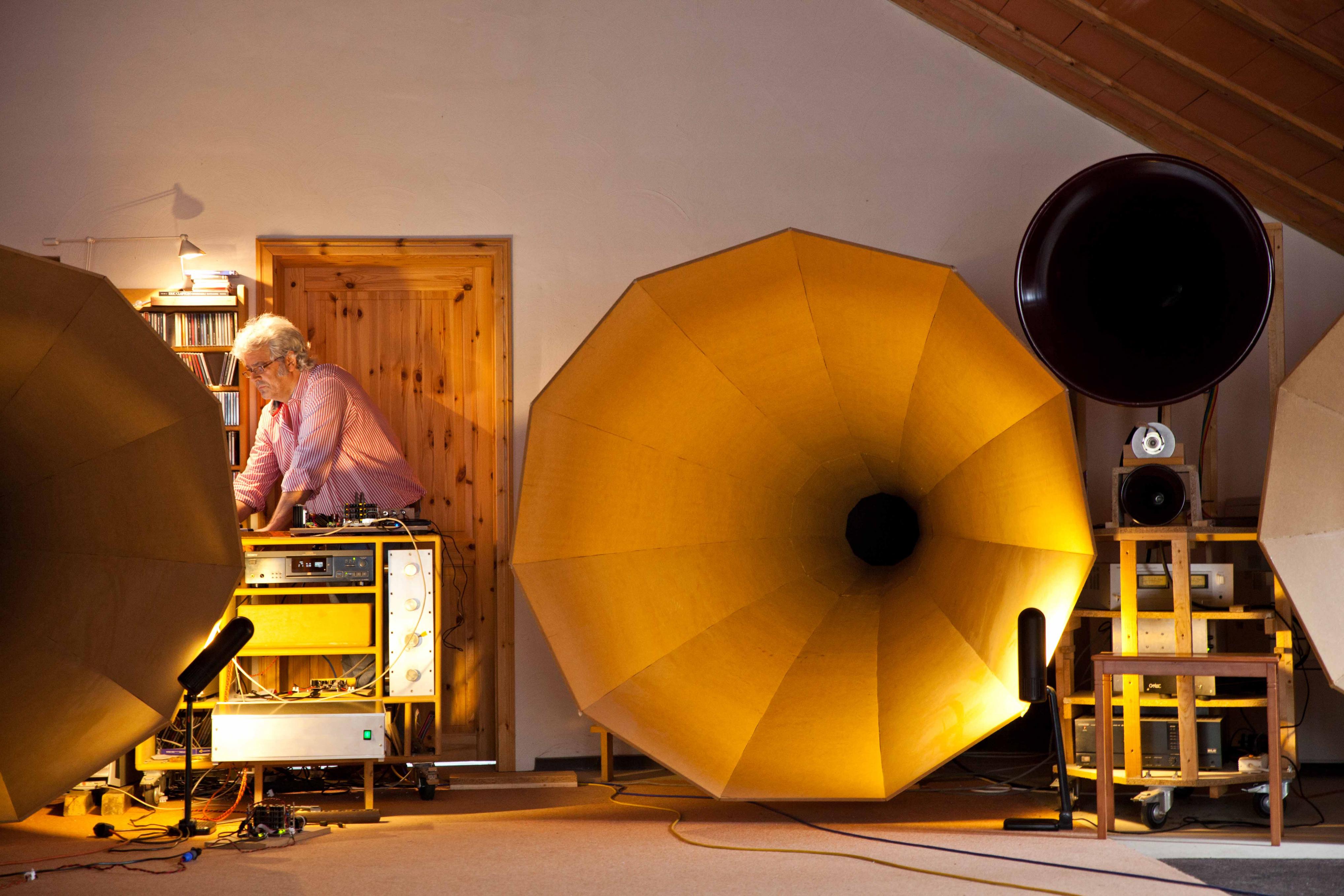

A note on Klaus his system: the listening room is very good, very nice acoustics, the Goto units with front horns are super. If I may comment a bit: I would love to hear this system powered with nice triode tube amplifiers.😛

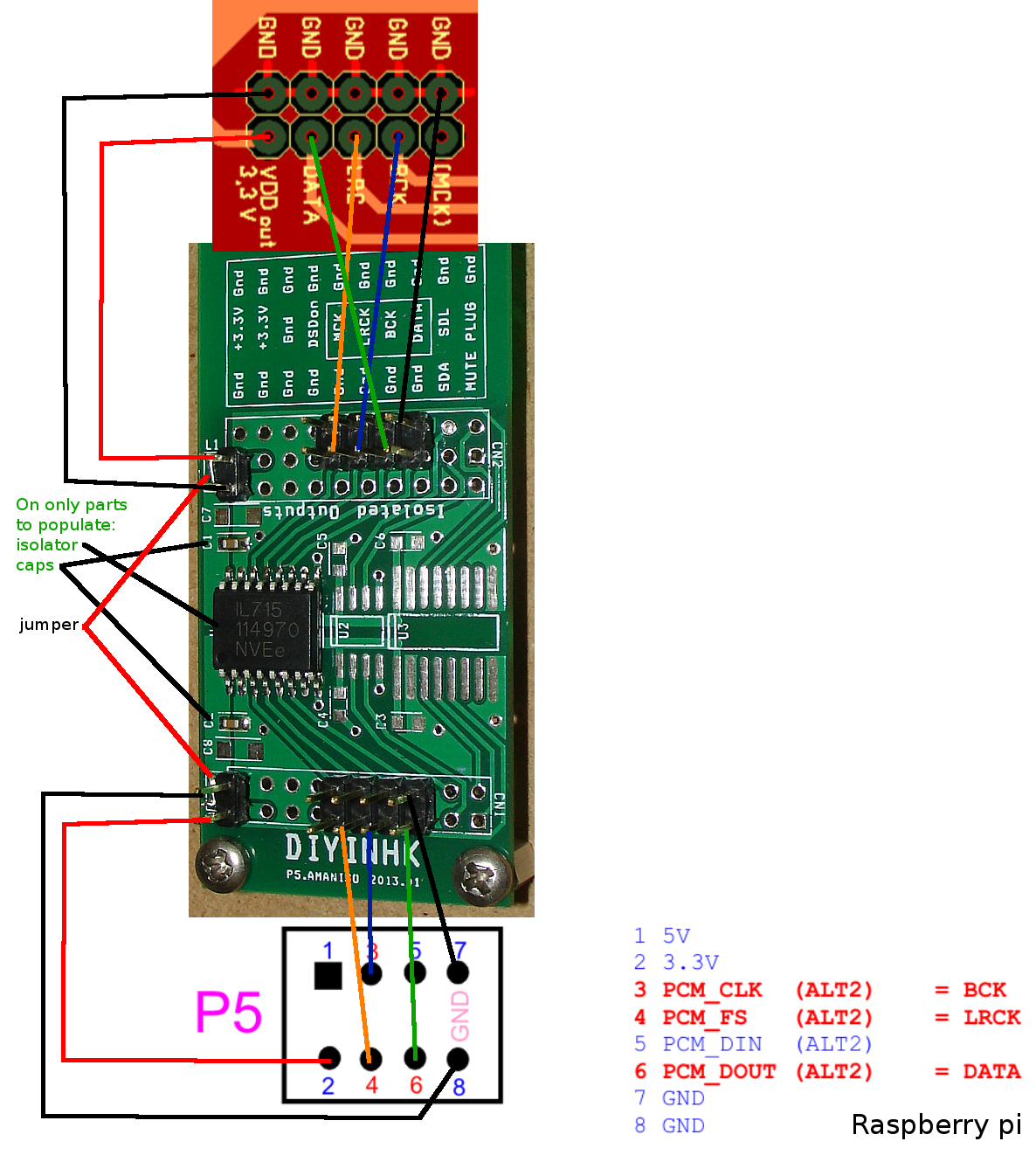

Also the ground of the Pi will be messy and this is directly coupled with the dac
I would suggest using a small isolator board between the pi and the dac, they are cheap and easy to put together - one NVE715-3E isolator chip ($10) and two smt capacitors ($1 max). You power one side from the 3.3vdc in Doede's m-board and the 3.3vdc out from the rpi p5 header for the other side. If you use the diyinhk board (2 for free + $4 shipping) I'd leave the chokes out, I thought it sounded better without them. Try it, you will be happily surprised. I posted previously that I'm using the Acko S03 now, nice improvement over the plain isolator. I'm now getting it changed to a single 100mhz clock (since it's async with the rpi) and LiFePO4 battery powering the clock (instead of the any of the three built-in options for different regulators). Until the BBB cape is done and allows RCK of the BBB, this I think is the best solution if you are using the rpi.

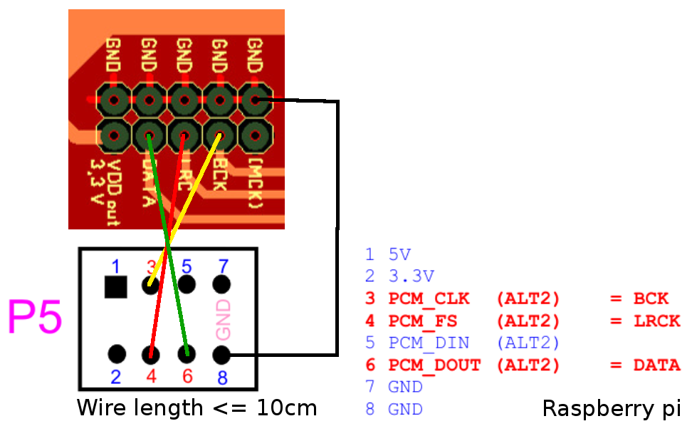

diagram how rasPi shall be connected correctly to the dddac via direct i2s
See images attached.
by the way, which OS and stream player have you used on rasPi? if the OS was tuned/modified to be mainly dedicated for audio streaming
Install volumio or rune audio on the pi and all the tweaks are already done. You *will* have to read up some on using ssh to connect to the pi unless you hook it up to a monitor for the little hand configuration you have to do. Search back on this thread for what you have to edit in volumio. I have not used rune, but I assume is similar to volumio as they were the same developers that forked their efforts.

thanks a lot!! i will try that ... i already sent you an email!
